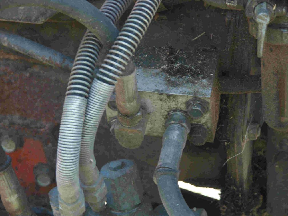

I am not quite sure what part you guys are talking about with the connection to tap into the hydraulic line from the pump. All 3 of my B7100 tractors have a small rectangular plate that is held on with 4 bolts built into the high pressure line from the pump. To power the loader from that you need to remove the cover that has the internal passage for the oil and build one without the internal passage from 1/2" cold rolled steel. Use the original for the spacing of the 4 bolt holes. Then drill and tap for pipe threads for the auxiliary lines. It is very easy to make. It seals with 2 O-rings on the inside.

You need a hydrualic tap block adapter
Part # 70070-00385 $73.26 U.S. price
Makes it real easy to run other equipment.

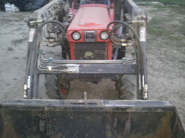

I've ordered and had most of my parts delivered in the last couple weeks. I have 2 parts that I'm waiting on. I had to get a new torch handle and tips to gas weld the lines together.
I'm using 3/8 x .49 seamless steel lines, I wanted to do stainless, but my stainless welding skills are not up for that task.
I'm doing 3 sets of lines for the third function.
After much review and measuring I ended up ordering the diverter block that Big Kahuna posted, The original piping on the Kubota is an odd size and I didn't want to mess it up, and I may end up going back to the external pump concept if it's too slow for my liking anyways.
The only thing I'm waiting on is I don't know what size fittings come out of the block, (3/8, 1/2, #6 SAE, #8 SAE).
Does anyone know the size?:confused:

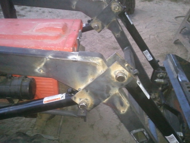

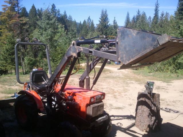

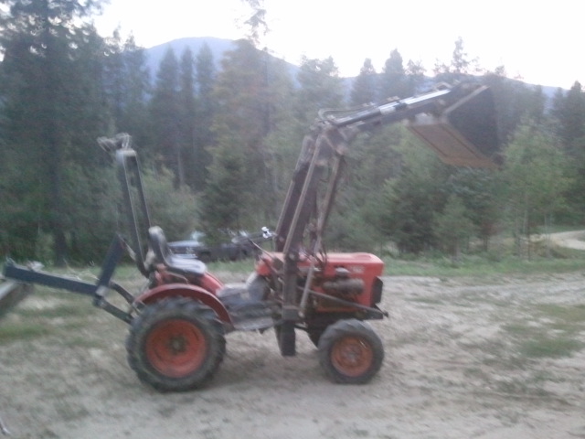

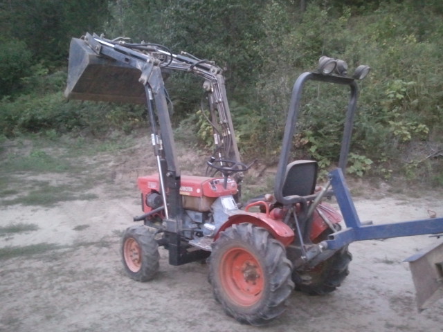

Been going like a mad man for 4 days strait, the result working loader.
I followed advice and shortened up the length moving the bucket closer, and redid the angle of the arms from 45 to 60.
Just need the welds cleaned up and a coat of paint on it, oh and two more rear support bars just to make sure I won't teak anything.
I took it out for a spin and dug some serious holes in a quick hurry, moved 10 stumps to the burn pile, and shuffled some equipment around.
All in all it works great, I'm going to need to get bigger tires on the back and new tires on the front.
The only part that is a negative is that it steers like a slug now, but I expected that with all the weight on it, That's the next mod, hydraulic steering, no not power steering, true 100% hydraulic! I have 3/4 of the parts already here for it.

Wow, nice job. That takes one hell of a fabricator, I wish I had your energy! Nice quick change multi-mount too.
Maybe I'll get some of my stuff done when it cools off a bit. Hopefully not too long from now. I just walked outside and it was chilly out, a cold front came through. Checked the thermometer, and it was 91* F at 11 PM. :eek: But that's better than a few weeks back where it didn't get down to double digits till after midnight...
Congrats on what appears to be a fine job. Looks like a really good range.
Oh, and where did you get your teeth? When I straighten my 2150 bucket, I want to add a toothed cutting edge. Without a tooth edge, the soil here might as well be concrete.
16,041
5,770
Well dayum,, that bucket looks almost as big as the tractor.. or is that an opitical delusion :D, An outstanding job my friend!!!

Nice work!! I like the steel hydraulic lines. How did you make such smooth bends and what did you use for the ends of the lines?
I bought a 3/8 and 1/2 bender used off of EBay for $12, they worked perfectly, no kinks or ripples!
I bought the line and spud ends and tees off of, Hose and fittings .com
The cylinders are from Baileys
The rest of the fittings and hoses came from EBay.

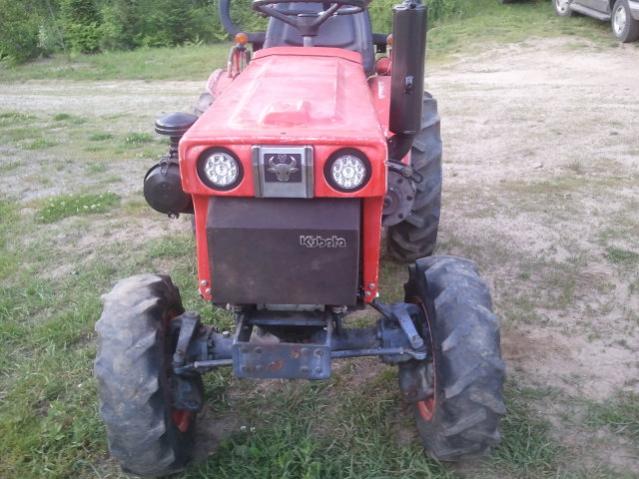

Sean, where did you get these LED lights, and did you have to do any modification to get them to fit? I need to replace mine.
I got them off EBay, someone out of China. I just used a hole saw on a thin plate of steel (could use aluminum) inserted the lights, and bolted the plate into the hood, they work great.

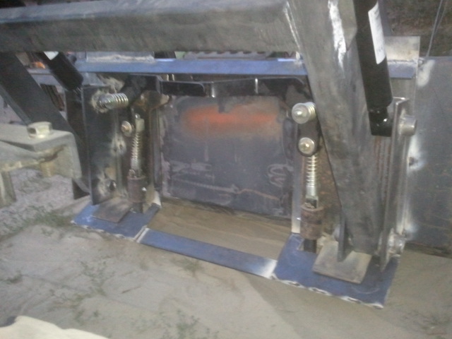

Did you drill the holes in the arms to lock them together?
I ended up welding stops on the back of the plates for mine to "lock up to".
I drilled them for that but never had to use it,I bent them to easily clear each other too. I also added the stops on the outside of the curves of the handle.
I wanted to mount my pivots close to the plate like you did but the bottom plate that sticks out hit the lift boom on full dump. Looks like that may have been a issue for you also because in the one picture with your bucket somewhat dumped it looks like its awfull close .
