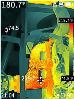

My questions:
1) Is 45F too big of a temperature difference between cylinders?
Just for fun and giggles, I investigated my B7100 (1994 version) exhaust manifold temperatures with a TIC. I set it to °F for consistency with your readings and turned on high, low and centre spot readings. After about 20 minutes of running:
180°F at #1, 220°F at #3. 40°F difference. Ambient temp 75°F.
I don't think you have anything to worry about. Ok, it's sample size of two, but thus far 100% of all D750 engines investigated show notably lower EGT at the #1 cylinder. <lol>

Torch, that is very interesting and reassuring. Thank you for taking the time to take the temps and post back.
Best Regards,
Larry
