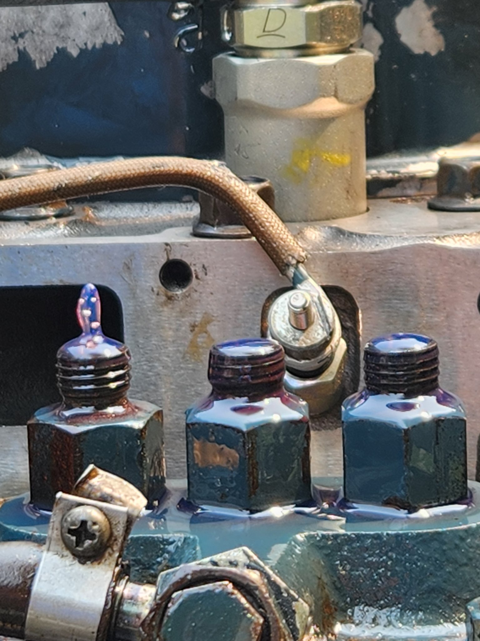

Before I went any farther on my diagnosis of the low compression after a rebuild (265, 280, 295) I ran my B7100 for about 15 minutes pulling a lightweight driveway drag. It is so dry here that there wasn't really much of a load. The tractor was hard to start and blew a lot of gray smoke at startup. The smoke cleared up after about 20 seconds with just a little puff of black when I went to full throttle pulling my drag. It performed well and it seemed to have ample power.
Still not happy with the smoking on startup I checked the injector timing and found it to be retarded. I removed one shim from the injector pump and the #1 piston is now lined up with the 1F mark. I also replaced the glow plugs because they took about 45 seconds to turn a dull red. The new plugs turn bright red in about 13 seconds. I hoped the timing change and glow plugs would help with the smoke at startup. It did start a little faster but still smoked a ton.
I then checked the valve timing, the compression and the exhaust runner temperatures. Timing did not change and was still at .007 and the compression went up in all cylinders to about 330 psi. Still not good but a little better. The exhaust runner temps were 145F on #1 and 195F on #2 and #3 and the radiator was 190F at the top and 135F at the bottom.
Because of the low temp on Cyl. #1 I suspected a fuel delivery issue (I have all new injectors from Oregon Fuel Injection) and did a "fountain" test and all 3 injectors. They all spurted the same amount (below). Then I swapped the #1 and #2 injectors and Cyl. #1 was still 145 F.
I would think a pump capable of injecting fuel at 2,000 psi would squirt a pulse of fuel higher than that but I don't know. I then installed a new fuel filter and the injection pump output was still the same.
Still thinking it may be a delivery issue I removed the outlet hose from the fuel pump and only a spurt of fuel came out with every rotation of the cam.
My questions:
1) Is 45F too big of a temperature difference between cylinders?
2) Should the injector pump output look like the output in the picture at WOT?
3) Does anyone know what the output of the fuel pump should be or if it puts out a pulse or stream at WOT.
4) Should I just keep running the tractor for an hour or so and see if the compression numbers go up?
I'm truly appreciate any input on my ramblings. Thanks, Larry.
My questions:
Don't mistake volume for pressure. Pressure only increases when volume is restricted and the discharge can be calculated by Q=K(P^-2), which can be rewritten as Pressure=(Volumetric Flow/K)^-2 (where K is a constant dependent upon fluid density, temperature, orifice area, etc. ).
In English, the pump is designed to deliver a small volume into a very small orifice. Removing the pipe to the injector can be thought of as a massive increase in orifice size and therefore a massive increase to K resulting in a massive decrease of P. The result, as you saw, is a small fountain rather than a massive spray.
And yes, the pump puts out pulses, which would likely look like a solid stream at WOT unless viewed with a high-speed camera.
As for the temperature difference, first of all how did you measure it? If you are using a non-contact "laser" thermometer be aware that they don't just view the spot, they average the temperature within an expanding cone. I assume you are counting #1 as being the front cylinder, closest to the radiator and fan? Any chance the cone is including space in front of the engine? The most accurate way to measure the EGT would be with a contact probe type instrument followed by a Thermal Imaging Camera showing spot temps.
Did you ever get your valve timing issue resolved? Reading back through this thread I saw you adjusted the fuel injection timing by changing shims, but that doesn't affect valve timing.

Torch: "Don't mistake volume for pressure. Pressure only increases when volume is restricted and the discharge can be calculated by Q=K(P^-2), which can be rewritten as Pressure=(Volumetric Flow/K)^-2 (where K is a constant dependent upon fluid density, temperature, orifice area, etc. ).
I understand what you are saying. I thought I read in another OTT thread that the injection pump could pulse a stream 3" to 6" in height but maybe I misread that post. I was hoping that the small squirt that I got was indicative of a worn pump but I imagine the only way to tell is to have it shop tested.
Torch: " As for the temperature difference, first of all how did you measure it? If you are using a non-contact "laser" thermometer be aware that they don't just view the spot, they average the temperature within an expanding cone. "
I used a laser thermometer and a thermal imaging camera and my readings were pretty much the same with both devices.
Torch: "Did you ever get your valve timing issue resolved? Reading back through this thread I saw you adjusted the fuel injection timing by changing shims, but that doesn't affect valve timing.
Correct, my injection pump timing was off and I corrected it.

When you did the Fuel pump fountain test, did you have the injectors or glow plugs out of it?
Doing it with compression (slowing spinning) will lead to small fountains.
You would know if the injection pump is not putting out enough fuel as it will not reach a good top end RPM, it will stumble when you accelerate.
If you think it's an issue do a pressure test on the pump.
