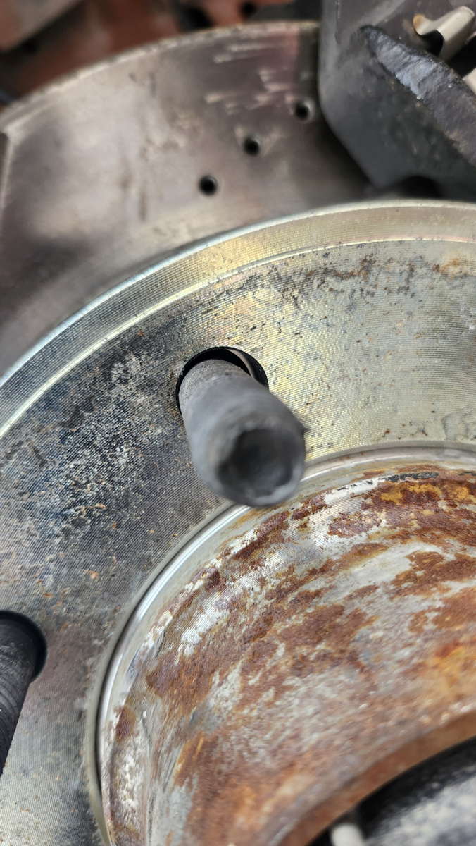

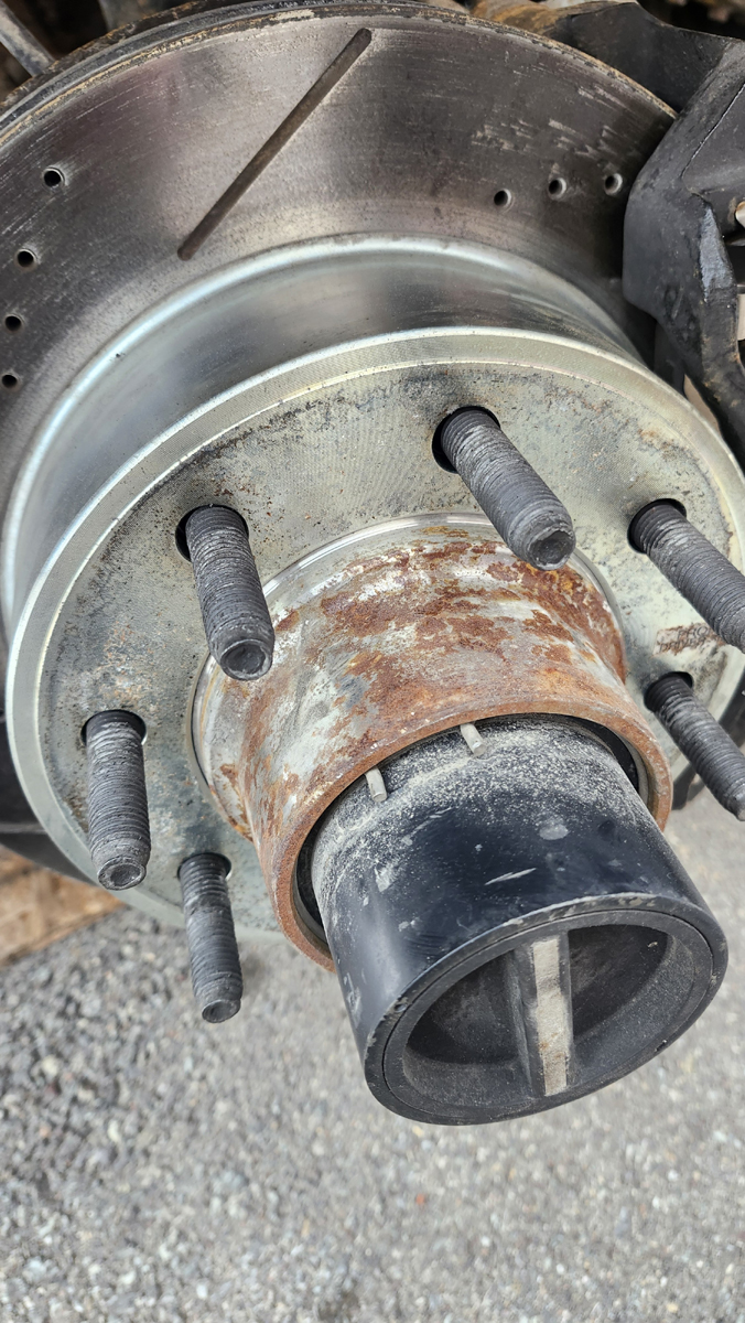

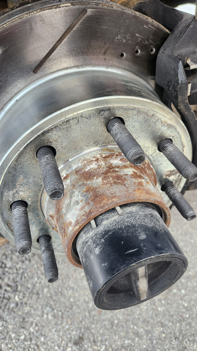

One issue I need to address with the F-250 is an intermittent soft "thump" when braking, and thought it was something in the DECKED drawer system sliding around. But after removing various things and realizing that I can feel the thump in the floor of the truck, I figured it has to be something related to the brakes themselves. I'm not able to reproduce the "thump" on demand and it seems random enough that I haven't been that concerned about it.
Last year I replaced all four rotors and all sets of pads using Power Stop products, and even replaced the front calipers with Ford remans from NAPA. This was done around 5,000 miles ago with no issues until recently. Around 4,000 miles ago I replaced all the soft brake lines too with teflon lined stainless steel hoses and flushed all brake fluid and power steering fluid and bled all the systems. The brakes were the best they've ever been and still seem to work well.
This afternoon in 20°F weather I removed the front driver's side wheel and looked around. I've done too many brake jobs to count over the years and have replaced many sets of rotors and pads, but I can't remember if the "slop" of the rotor over the wheel studs is normal. I can spin the hub and the studs will move in the rotor holes and I show the two extremes below. So now I'm wondering if the rotor is moving during breaking, not always but sometimes. I should have checked the lug nut torque values but forgot to do that. The spec is around 150 lb-ft and it would make sense that the rotor could rotate relative to the studs if the torque wasn't high enough since it's clamping force that prevents the rotor from slipping if the holes are oversized. Does this amount of play of the rotor on the hub seem normal or are the holes oversized?
Another thing I noticed is that there's some weird smudging on the rotor but I can't feel it at all. It looks like I should be able to feel it but it's silky smooth.
Can't say I ever recall seeing wear patterns like that.

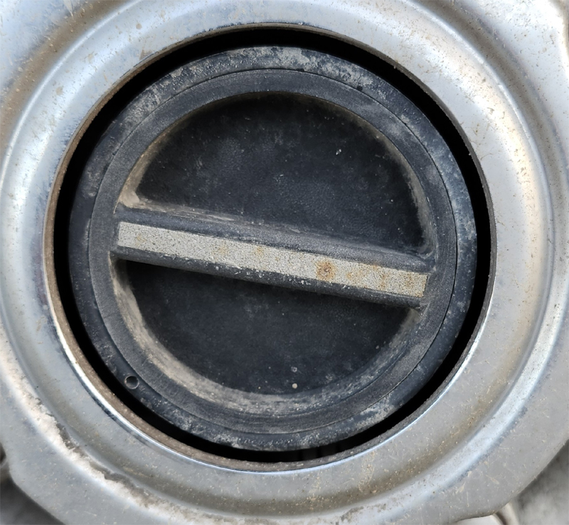

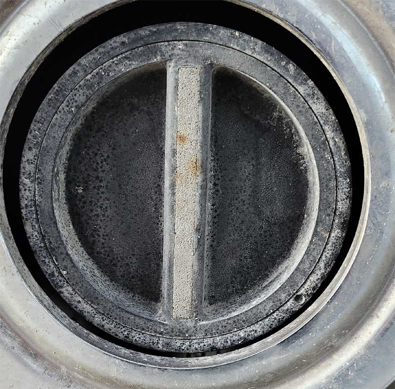

I added images below of both hubs in the AUTO position (unlocked) and the dimple is obvious on both hubs, but if there was ever an arrow with AUTO and LOCK it left the chat a long time ago. I've owned this truck since 2018 (bought from a friend/original owner) and I've never seen any markings on the hub.
Driver side hub.
Passenger side hub.
