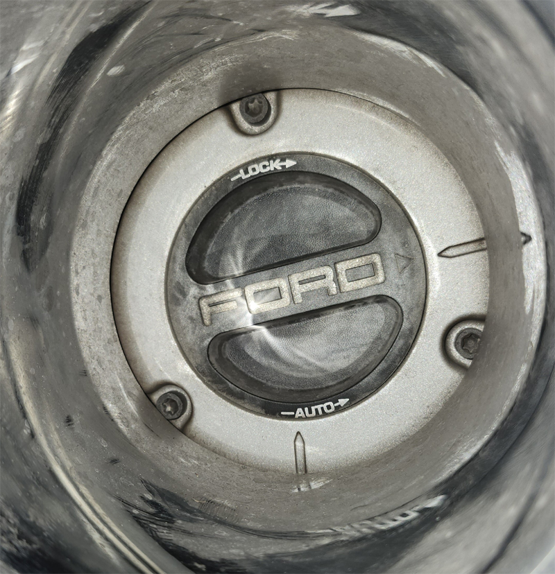

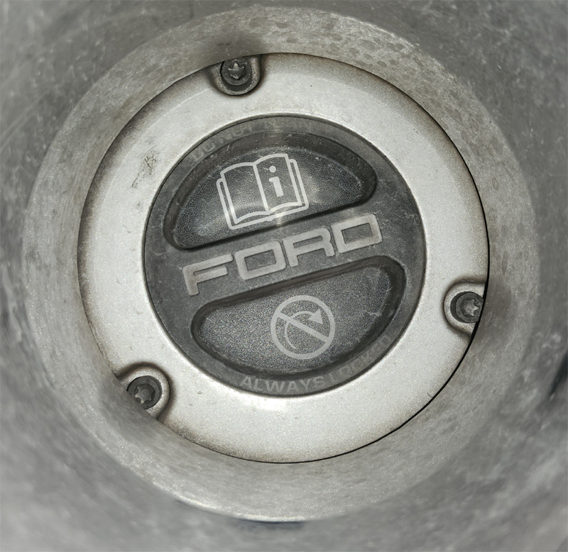

I jacked up the front of the truck this morning and confirmed some things. First, both hubs are a little "sticky" but the driver's side one is worse, and clockwise locks the hubs and counter clockwise unlocks them. I'll take a good look at the hubs in a month or two and either service or replace.
This got me thinking about the F-450, and to my surprise it only has one locking hub up front, and that's on the driver's side. I've never seen that before. The passenger side says "ALWAYS LOCKED" on it. :unsure:
Driver side.
Passenger side.
Driver side.
Passenger side.
Rotational hub. There has been issues with them making grinding noise in 2wd then they replace it with a real hub.

Both of my Fords have (had) auto/manual hubs up front. I have always left them in auto, so from memory I am not sure the proper direction of rotation / markings. Both had E locker and I believe a limited slip diff (I am not sure what the actual differential make and part is though?). But I do wonder if type of diff has something to do with whether one or both hubs need to be engaged manually as @McMXi is sharing/showing on his chariot.
that being said I prefer the manual shift lever that my first Chevy had and also that my current FJ has.

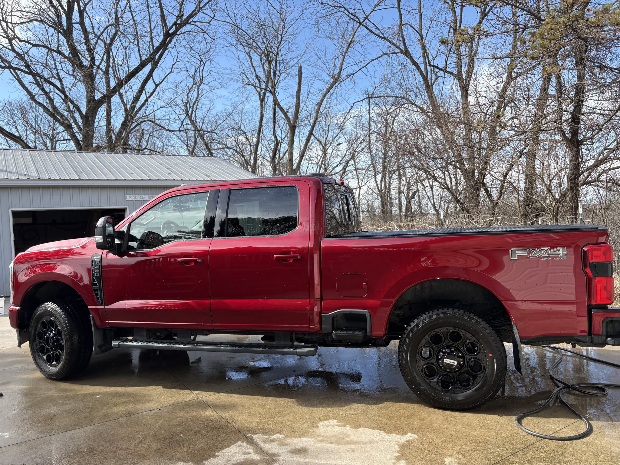

I guess I am not really adding much to the truck thread…so only thing I do know is i gave my girl her first bath since I got her (we have had cold since we got her (Zilla) in December) and now that weather has broke, the only thing I can say is that’s a whole lot of lady…she is big girl and I needed longer arms to rub her down than I did with the F250. Zilla is thick in all the right places and slick in all the right places. A whole lot of lady…
8,356
11,757

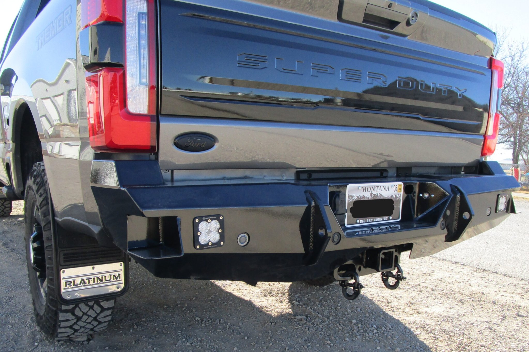

Beautiful truck you have there. It's a nicer red than my F-450.
Talking of nice trucks, I placed an order for a TDK rear bumper the other day to match the TDK front bumper that I bought for the F-450 last year (and have yet to install). The rear bumper should be available for pickup in Moore, MT the week of May 18th. Here's a photo from TDK's website showing the rear bumper.
I didn't want the corner steps (currently on my Ford rear bumper) and didn't want the clevis mounts but did add the back up sensor holes. I didn't add holes for lights, but I ordered Baja Squadron Sport Work/Scene lights shown (directly from Baja) along with Baja Squadron Pro Spot lights and Baja Squadron Pro Amber Driving/Combo lights for the front bumper which is set up for them. Baja sells a really cool interface between their lights and the factory upfitter switches but it's not a priority at the moment. The reason why I didn't add holes for the rear lights is that I plan on finding a piece of box section to fit around the lights shown and cut perhaps a 1/2" thick section and weld to the bumper once I've decided where I want the lights to go. I want to protect them and I don't see them being protected as shown. I'd rather have them recessed, and box section is the best way to achieve that.
Thanks.
Oh my that’s a stout bumper…I love the shackle mounts…I wonder those will be knee knockers?
Regarding your parking sensors I assume you would have to transfer those over, correct? (Hope the tabs don’t break when you remove from original bumper).
by the way I checked my hubs this morning and both passenger and driver side FR Hubs are manual/auto. So it is not leaving one locked. The way I am understanding. The passenger side has setting for manual or auto and indicates the direction to turn to lock the hub. (Mine is different from the pic you showed above). I would suspect there is a difference in the differentials between yours and mine.

Thanks.
Yes, one of the reasons why I elected not to add them. Also, I'd rather pull from the receiver. I have a bar and shackle that slide in the receiver if I need it.
The parking sensors will move to the new bumper, same for the front too. I removed all four from my F-250 when I replaced the rear bumper a few years ago and had no issues with them and they were 20 years old or so at the time. I doubt that 2024 sensors will be a problem.

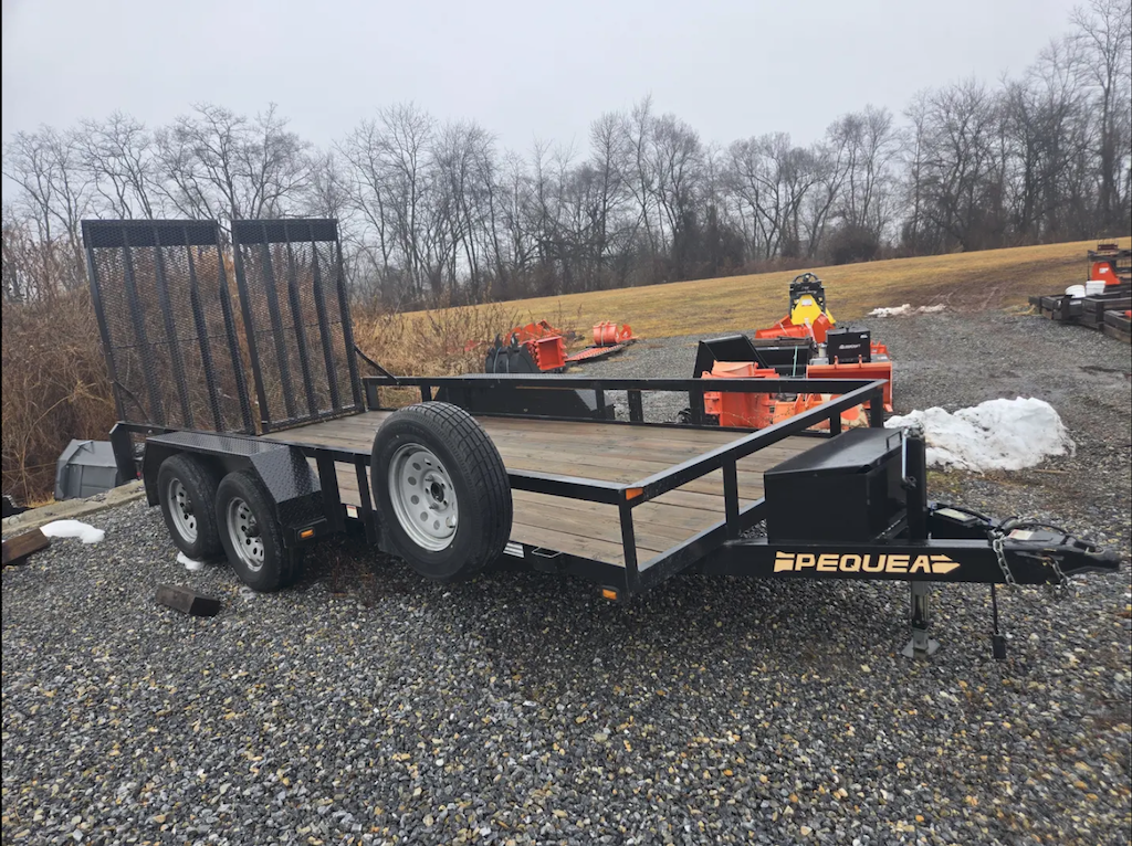

I'm picking up this PEQUEA 8016T to haul around my new Kubota ZD1211L mower. I think it’s going to work out good.
Here are the specs on the trailer:
16' Utility / Landscape Trailer / 7000GVW / twin 3500 pound axles with brakes on both axles / 2 -5/16" ball hitch / front toolbox / 6' Heavy Duty 5 rib mesh ramps / drop leg jack / 205/70R15 tires.
Good call on the toolbox, spare tire and DUAL beaver tail ramps…I’ve not seen the dual beaver tail but I suspect take some weight off. Good call there. 👍
Looks like a ransom note with that font ... and with the random selection of font size too. Are you in a cabin in Montana? What have you done with Nancy Guthrie? 😂
Looks like a decent trailer though.
I didn’t know how to spell the trailer manufacturer’s name so I cut and pasted it and when I did it changed the font of the stuff I typed 1st. :geek:
You gave me a good laugh this morning! 😂
Are you sure the coupler is 2-5/16" though? Looks like 2" in the photo which would be more typical for that size trailer. Just wondering.
