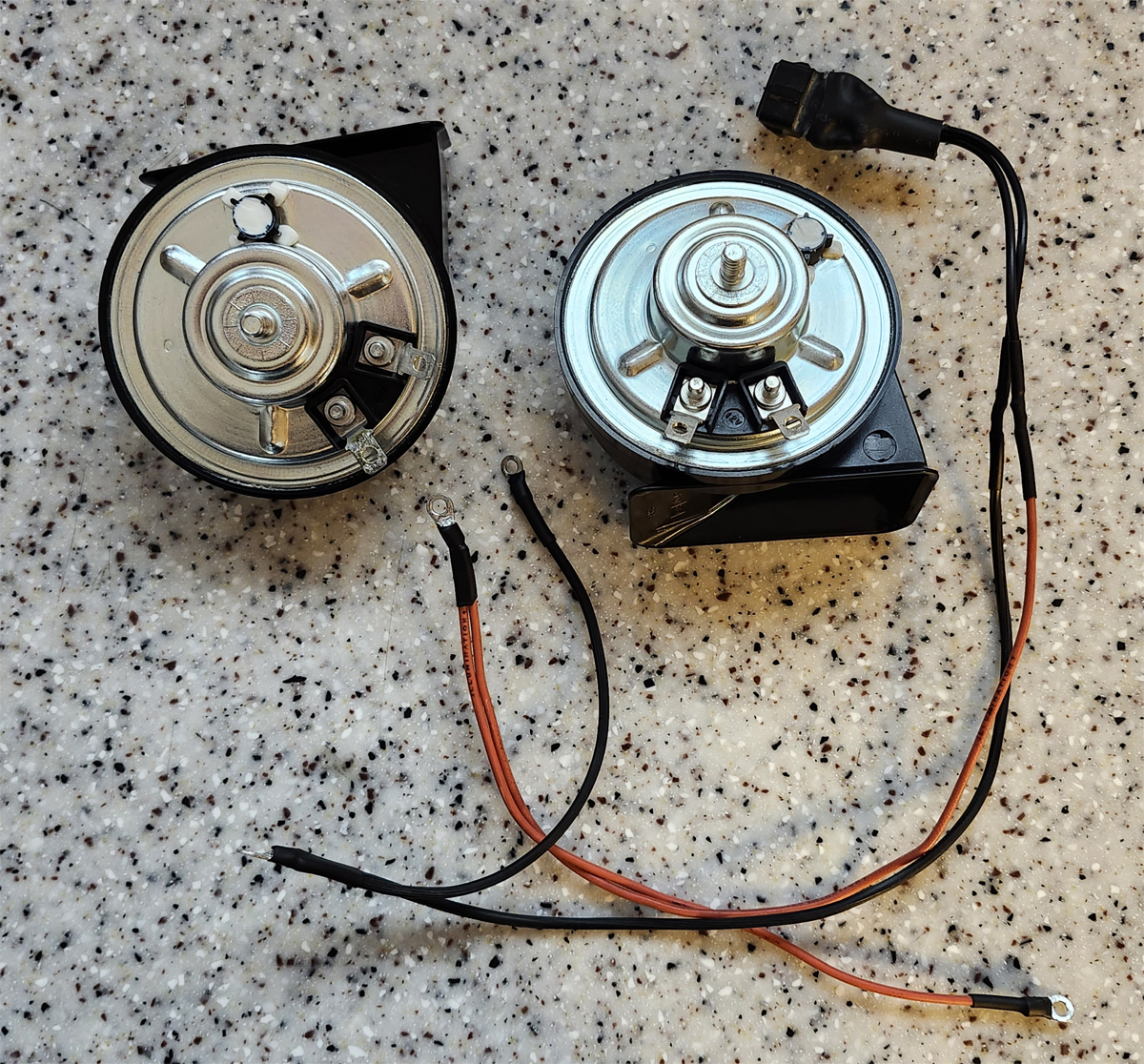

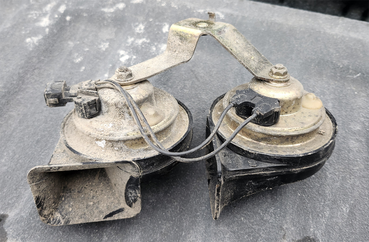

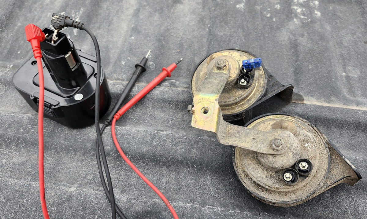

I solved the horn issue! I figured that a short in one or both of the horns was the likely culprit so I removed the passenger wheel well liner and removed both horns. I used a 15A fuse in series on one of the terminals of each horn and powered each one from a 12V power tool battery. One horn worked fine and the other immediately burned the fuse. Turns out the cleaner looking horn has an internal short. I did measure resistance across the terminals but they were both around 2 ohms so not sure how else to confirm that one horn is bad other than by my Mickey Mouse "waste a fuse" test.
I rerouted the wiring harness from inside the fender to the engine compartment and plugged the good horn into the connector and the single horn now works without blowing the fuse. I need to be driving above a specific speed for the cruise control to engage so will test that feature tomorrow when I head to town. I have no doubt that it'll work fine, since as I mentioned earlier, it's on the same 15A fuse as the horn.
I plan on going aftermarket with replacement horn(s) and not installing them inside the fender well where they're concealed by the liner. It's a pain to access them there so will make a custom bracket and relocate the horns to the engine compartment away from heat and moving parts of course. If anyone has any recommendations on better (nicer/louder/cooler) horns then let me know.

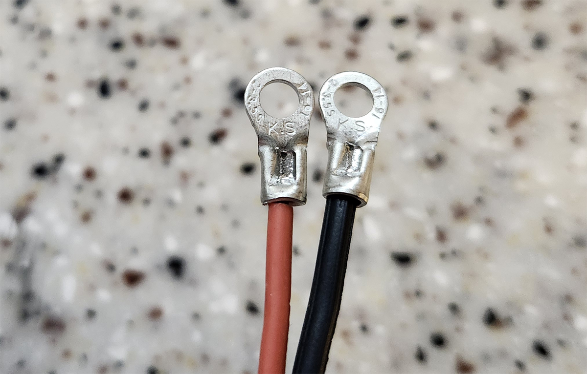

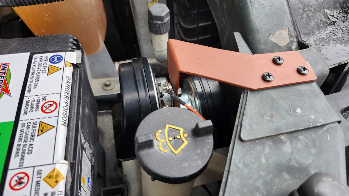

I took off on a 600 mile road trip this past Sunday and the truck was awesome! I found a good "clean" and dry spot in front of the passenger side battery for the new horns. I drilled and tapped three holes in the radiator support for 10-32 screws and completed a temporary horn and bracket installation prior to the trip, and they sure are loud!
I wanted to keep the factory horn wiring and connector in place, so modified the old horn wiring connector to use the existing factory wiring. I didn't like the push on spade connectors on the new horns so drilled holes in the four terminals yesterday to allow me to use ring terminals and 6-32 screws/nuts. I crimped, soldered and heat shrank the terminals on the new wiring harness and attached them to the horn terminals using the screws and lock nuts and they're not going anywhere. I completed the bracket, painted it with primer and have everything installed. I'll paint the bracket black in the spring.

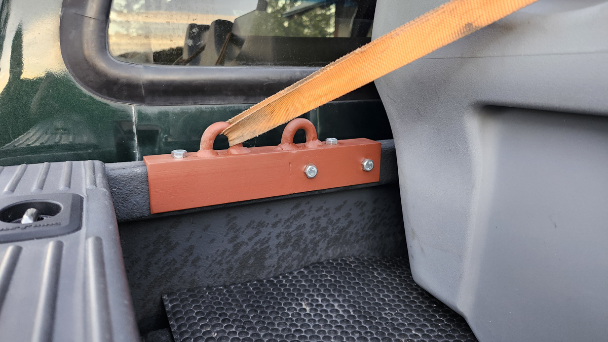

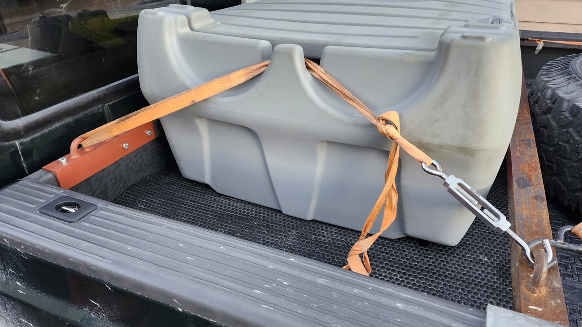

I have a road trip out to Portland, OR and back in a couple of weeks and wanted to get the JohnDow 58 gallon fuel tank sorted out i.e. secured in the bed. I'd rather buy diesel for $3.25/gallon here than over $5/gallon in WA and OR. I can complete the entire 1,350 miles with the 32 gallons in the fuel tank and 58 gallons in the transfer tank. That said, I will probably stop in Idaho on the way out to top off the truck, and probably stop in Idaho on the way back.
I also like the idea of keeping the JohnDow tank full in the winter months to act as 400lb of ballast just in front of the rear axle. The DECKED draw system adds a couple of hundred pounds, and in combination with the transfer tank it'll help with rear traction.
I had made a couple of short angle iron brackets with the idea to secure the tank in the bed with steel that would bolt from the front of the bed to the cross rail that I added last year. I decided to modify that plan and extend the short brackets and weld on some loops so that I can use a strap or rope to hold the tank in place. I don't want to be messing with straps, ropes or steel in order to get the lid open. Both anchor points are very solid, and the turnbuckle makes tensioning the straps easy. However, if I can find an appropriate ratcheting strap I'd get rid of the turnbuckle idea. I wish someone made a ratchet rope i.e. a rope rather than a flat strap.

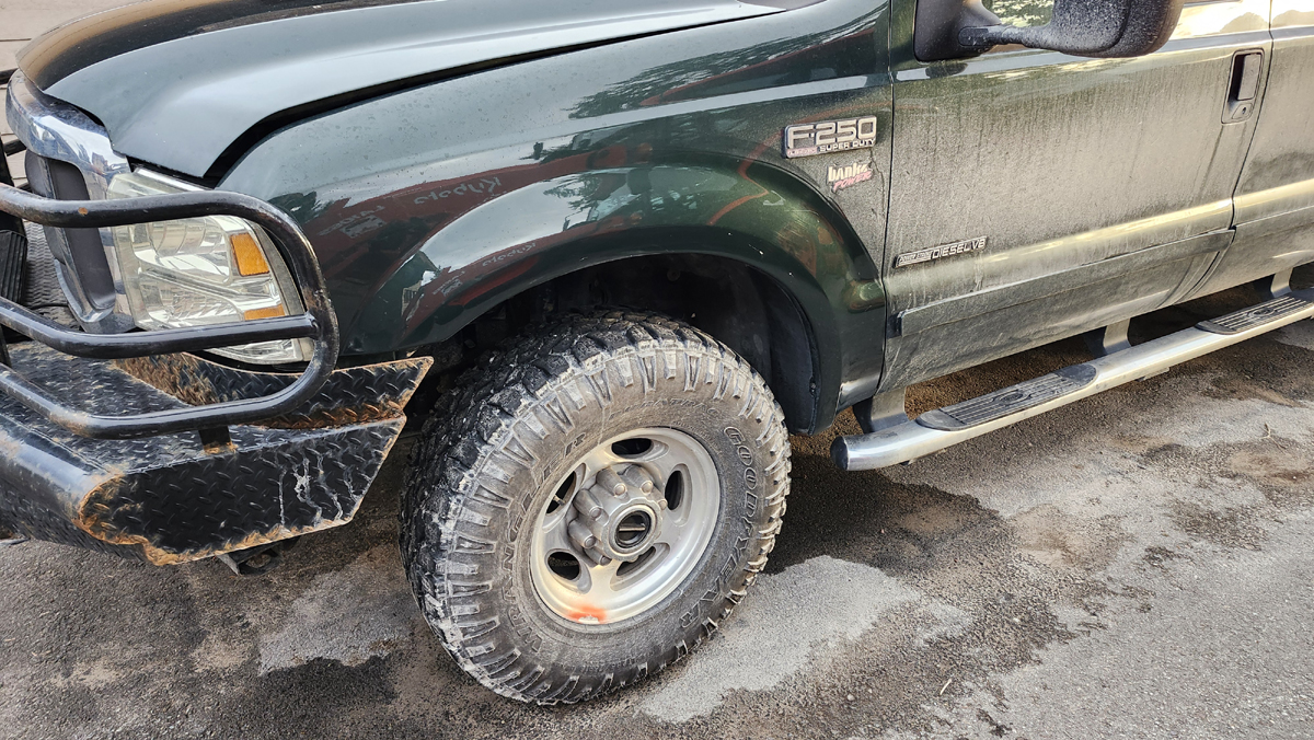

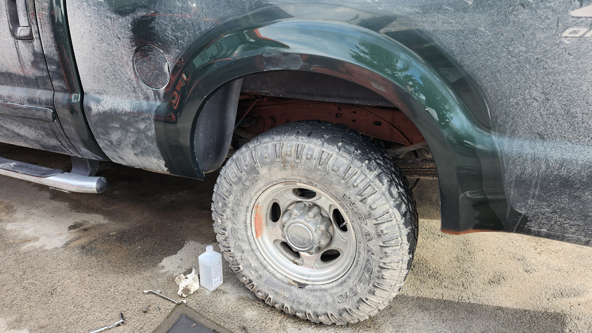

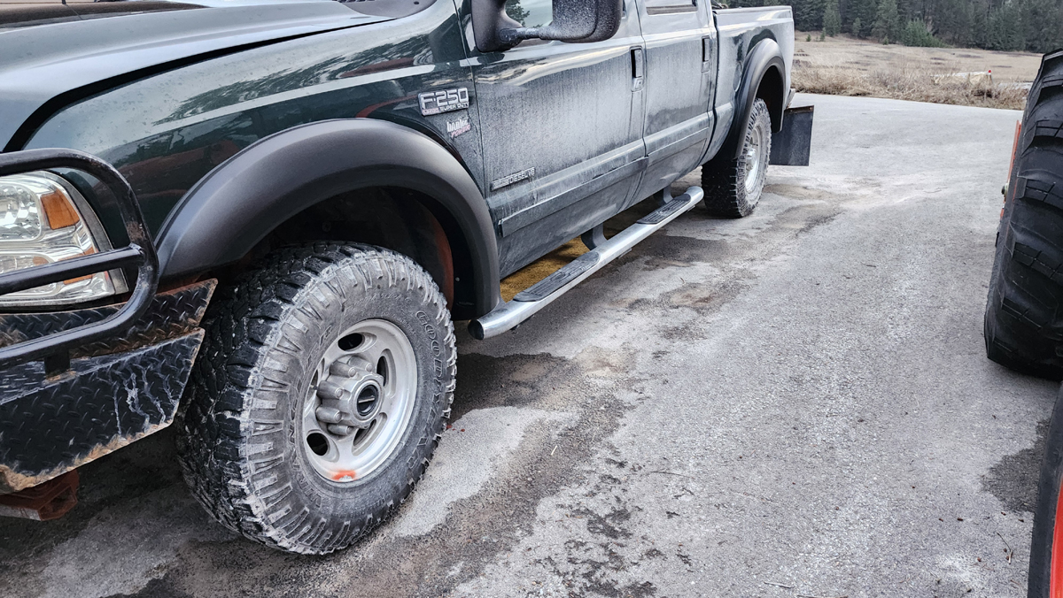

One more upgrade today that I should have done years ago. I added Bushwacker fender flares to the F-250. Someone had opened a door against the left rear fender at some point leaving an obvious dent, so the new fender covers that and also should reduce some of the over spray from the tires. I've had Bushwacker fenders on my Jeep TJ for years and like the product and these one don't disappoint.
I also sprayed some primer on the frame in the wheel wells where it seems to be more exposed to road salt. In addition, I painted any spots on the fenders that looked like they needed it. I like the look and the function of the fender flares.
Been installing Bushwacker flares on all my vehicles for years now. I drive mainly dirt roads and gravel coming off the tires quickly removes the paint at the edge of the wheel wells, leading to rust. Gravel doesn't seem to affect the Bushwackers, even after thousands of miles. And yes, they help with keeping mud off the doors and windows!
8,356
11,757
Amazing photos!!
I can't stand anything fake such as the fender extenders with the faux nuts. 🤮 Same goes for the wheels/tires with fake bead locks.
The Bushwacker fender extenders on my Jeep are awesome!
