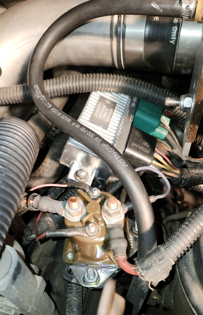

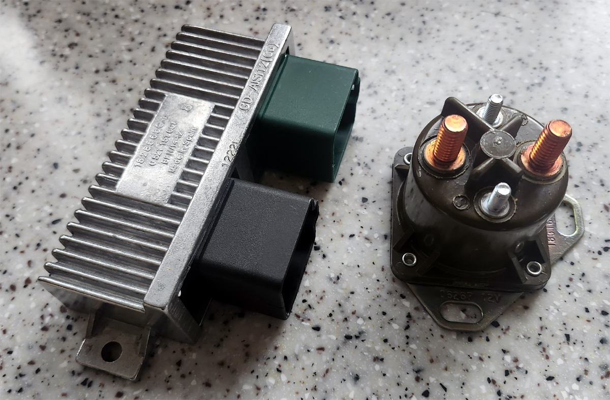

RockAuto were true to their word and FedEx delivered a package to me this afternoon containing a Motorcraft glow plug control module and glow plug solenoid. Order placed on Wednesday afternoon, parts received Friday afternoon and installed late Friday afternoon followed by a 20 mile test drive. Ford has changed the mounting plate and dimensions of the glow plug solenoid so I had to modify the existing bracket in the engine compartment which took more time than actually swapping out the two components.
No check engine light coming on, no codes showing up in the DP-Tuner tuner and the truck is running like a top. It sure feels good to have this F-250 back on the road. Looking forward to the new windshield on Tuesday, and I'm going to give the cab a good vacuuming and cleaning this weekend. I'll try starting the truck tomorrow morning without plugging in the block heater and see how it does. The check engine light was coming on with the key turned on but before engaging the starter, which convinced me that the glow plug control module and/or the glow plug solenoid had failed.
There appears to be a heating element in the intake that's connected to the solenoid, so in addition to energizing the glow plugs, the solenoid also enables current to flow to the heating element. It's no wonder that the truck has been so hard to start on cold days when it's not plugged into the block heater. It feels good to get this resolved myself and for little cost. I enjoy having a project vehicle to tinker with but also one that requires no work. This truck has been awesome, and to think that it's 23 years old and still an excellent vehicle. I hope I can keep it running for many years to come.

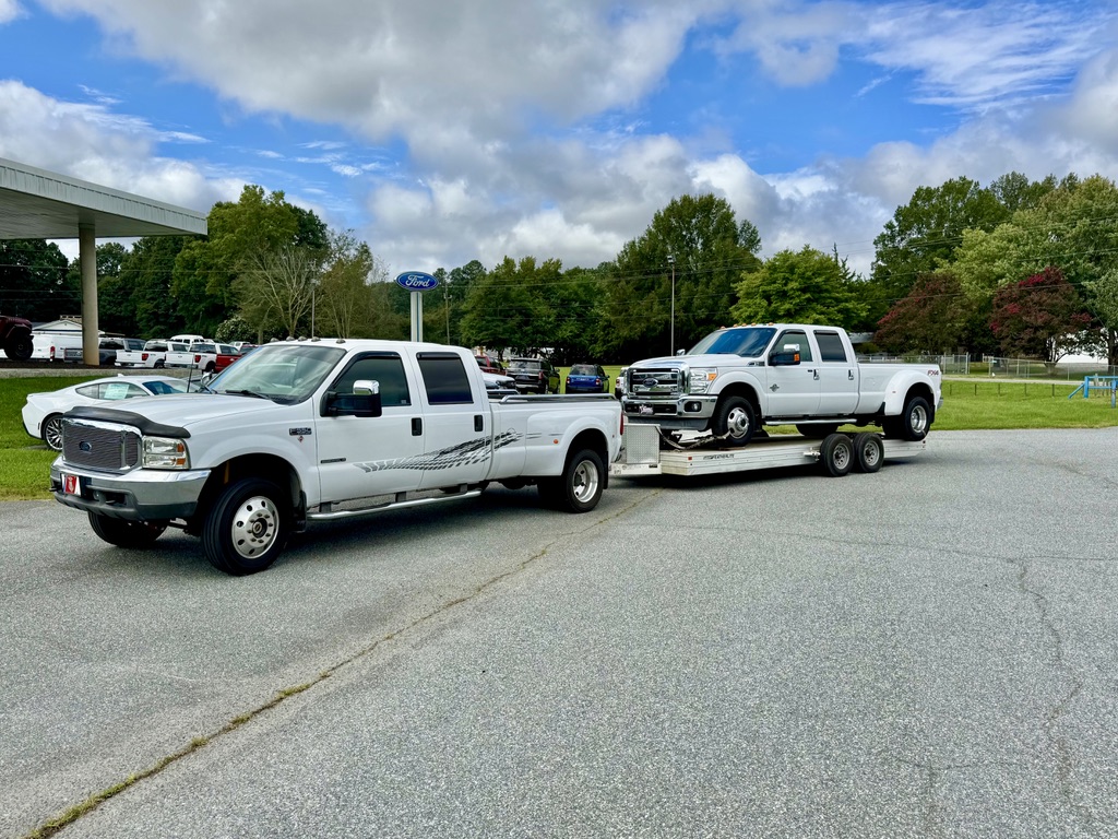

I purchased my 01 F-550 used in 2003 with 7k miles, I now have 135k. I have done some stuff to improve reliability but still have stock injectors. I get tempted to buy something newer but have not pulled the trigger yet.
Here is a photo of my truck towing my Father In-laws 2012. His starter went out and destroyed the flywheel in the process.
7,603
10,575
Here is a photo of my truck towing my Father In-laws 2012. His starter went out and destroyed the flywheel in the process. View attachment 165460
Great photo there. Looks like your FIL and you have similar taste. Interestingly, the rear fenders on my '24 F-450 look more like yours than your FIL's.

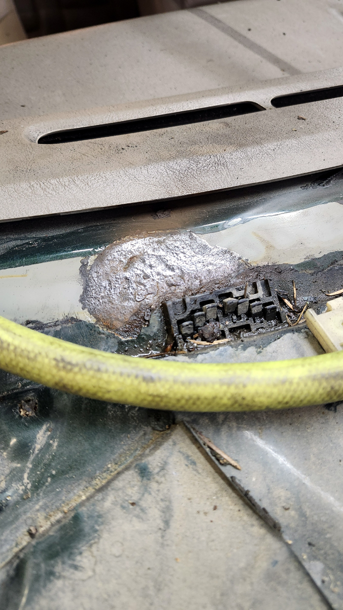

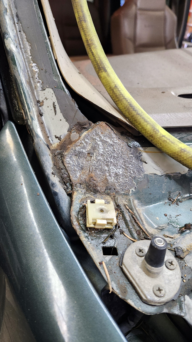

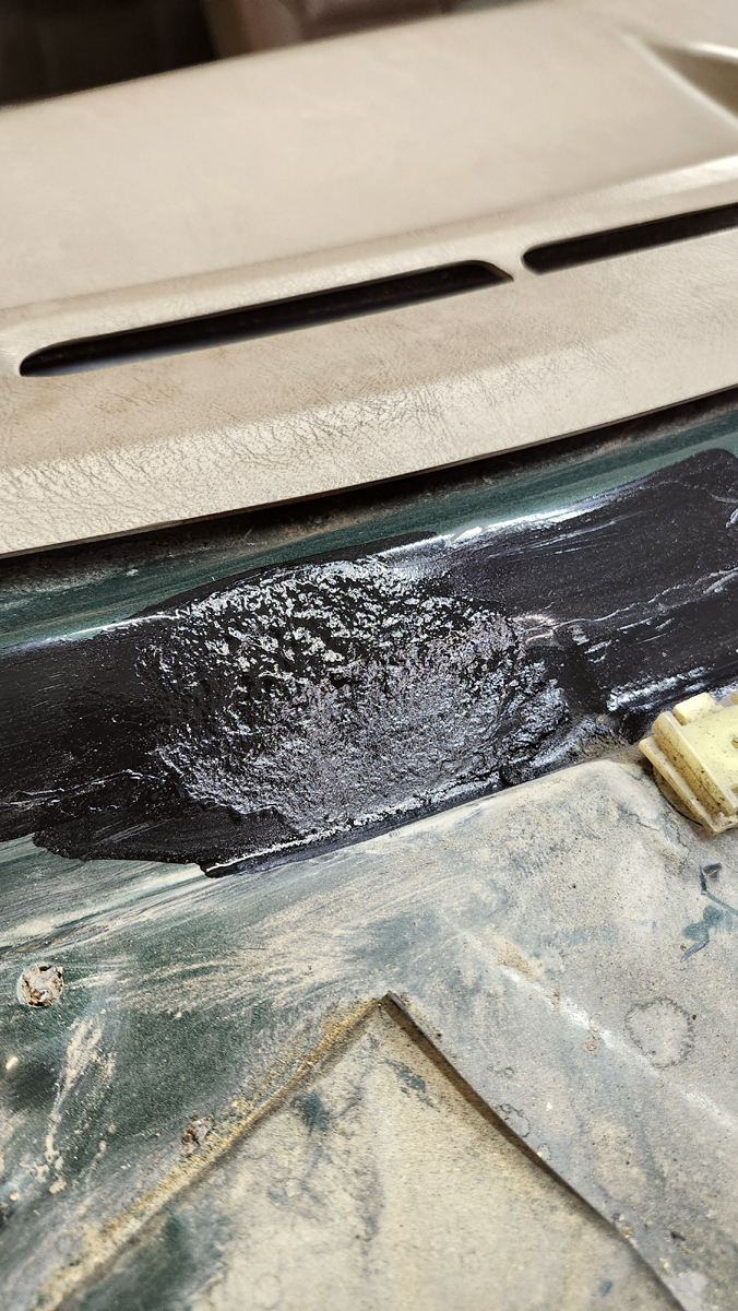

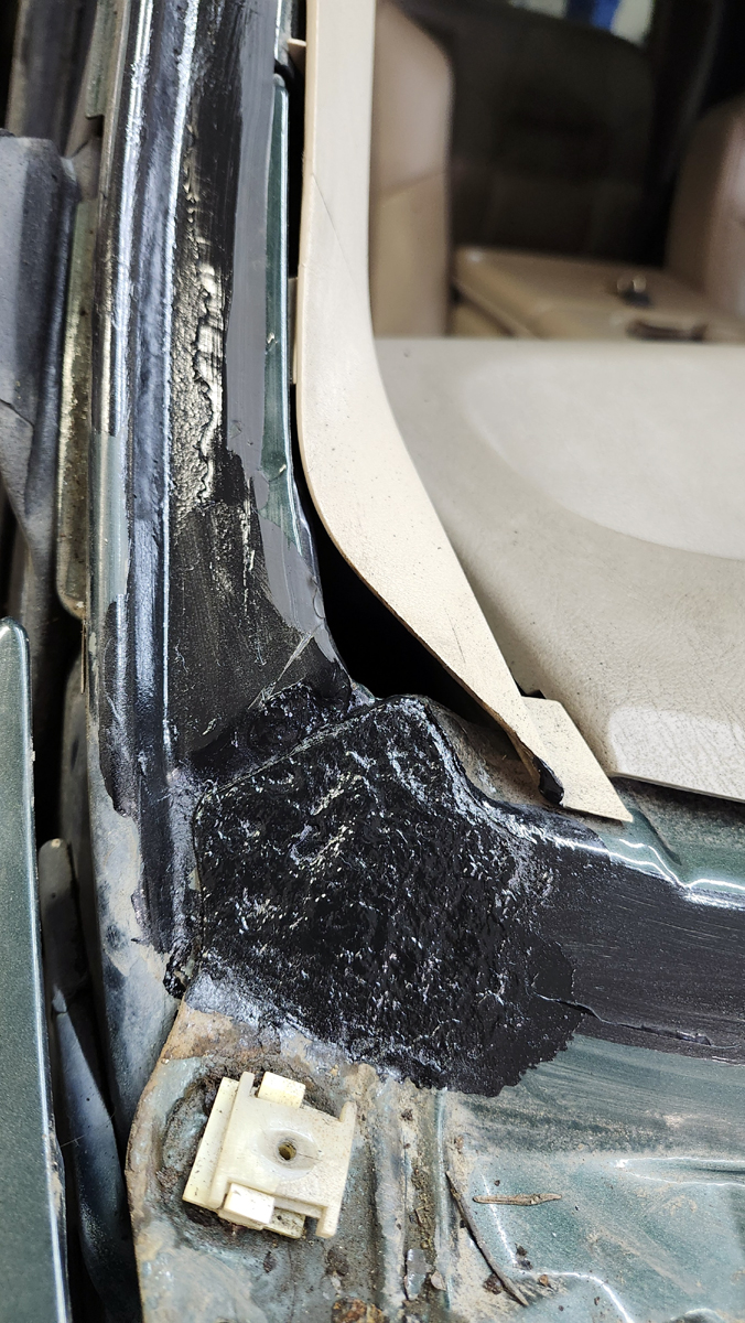

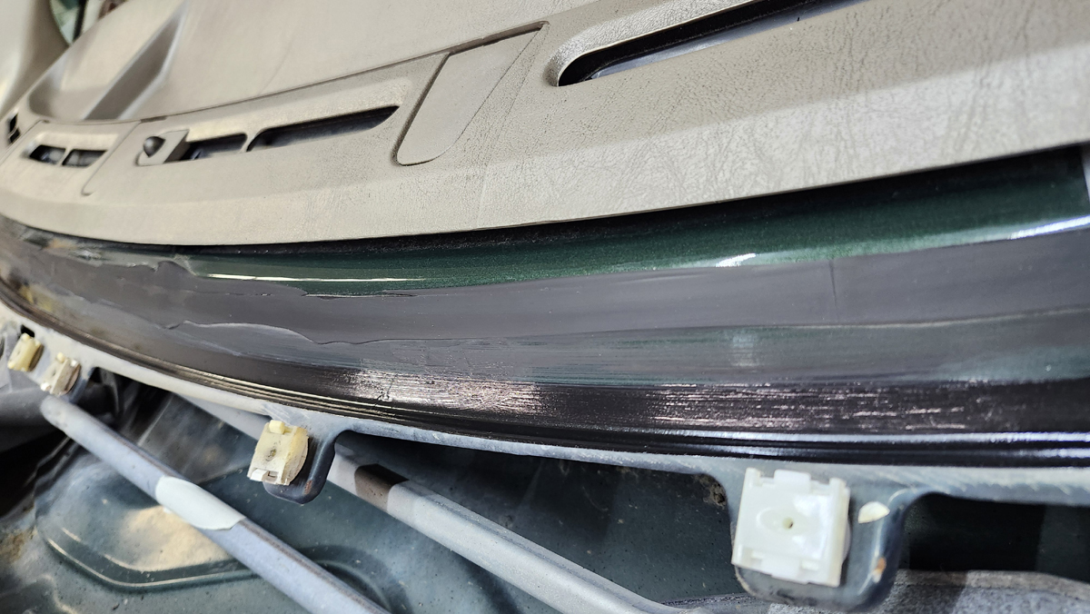

I got a new windshield installed in the F-250 this morning and as @biketopia mentioned, it was good that I picked a local shop with a husband and wife team doing the work. They went above and beyond and I did my best to keep out of their way as they worked.
Some revelations were that the windshield had been replaced at some point prior to 2018 but it wasn't done well according to the shop I used. There were spots where it was obvious that the glass was installed over unprimed/unpainted steel. There is some corrosion present and the installer used a small wire wheel on an air tool to remove most of the rust. He then applied two coats of primer and did a nice job overall but he mentioned that they're not a body shop but just trying to do a decent job of installing glass. He also applied two coats of primer to any exposed metal around the perimeter. The owner mentioned that if Safelite or similar encounter corrosion like this they won't continue with the installation.
The problem with this sort of corrosion of course is that you can't see it until you remove the glass. The plan is to have them come out to the house next spring to remove the new glass so that I can take a couple of days to do a really good of repairing/treating any bad spots. They'll come back and reinstall the glass when I'm done. If I want to keep this truck on the road for years to come I'm going to have to address problems such as this.
They did make a bit of a mess inside the truck with all of the grinding and such, so I stopped at an Autozone on the way home and picked up some Armor All wipes and spent 30 minutes in the parking lot cleaning up the cab as much as possible. I bought and installed new Bosch "mono" windshield wipers while I was there. The new glass sure is nice so I hope it remains that way for a while.
Looks Good! We had to do something similar on my dad's truck. I used the same glass guy we use on our fleet. They came to the shop and popped the old one out, saw the rust and corrosion from the poor install, and left me with some instructions and primer. I cleaned it up really well, primed it, and they came back the next day to install the windshield. My only word of caution with them coming out to pull their new one in the spring is that it is very well plausible that it will break upon removal. It is really hard to remove a properly glued-in windshield; it can be done, but just be prepared.

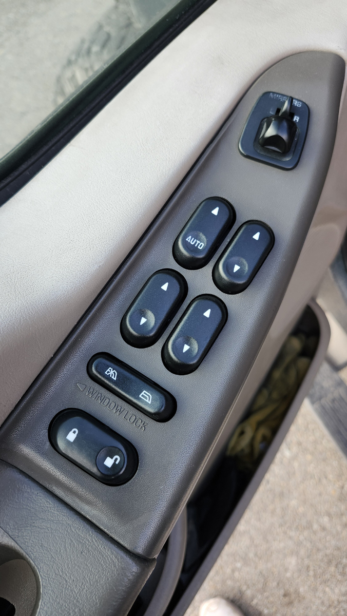

I'm close to having the last few gremlins worked out in the F-250. The first issue that I solved today was intermittent problems with the front passenger power window. Sometimes the window will go down but won't go up which isn't an ideal situation at any time, but in the winter it's a real problem. In my haste and laziness I did a search online for the most likely cause and a common theme was a failure of the multi-function switch on the driver's side. Power goes through the switch to the other three doors so it seemed like a plausible explanation and an easy fix.
I ordered a new (better) switch from RockAuto for a little under $87 which showed up yesterday. I installed it this morning and the passenger window appeared to work, until it didn't. After a few down/up cycles it stopped working. Then I figured that I should actually do some troubleshooting!
I have three factory service manuals including a book of electrical circuits for the truck and quickly determined that the front passenger switch was getting power at the appropriate time. I then used a 12V power tool battery to power the window motor at the switch and it worked up and down repeatedly without issue but the voltage was around 13.5V from the battery. I figured it must be a defective window switch on the front passenger door so I removed one of the rear passenger window switches which is identical and tried it up front and the window worked as it should, until it stopped working after a few up/down cycles. WTH!
I removed the door panels, front speaker and plastic protective film and looked at the window motor. I removed the connector at the motor (both of them) and cleaned them. Then I sprayed white lithium grease on the tracks of the window regulator where the guides slide and used the power tool battery again to lower and raise the window a few times. I noticed that it moved a lot easier, a lot faster and it was smoother. After reinstalling the door panels and window switch and powering the window down and up many times I'm convinced that the problem was friction in the regulator and not a bad multi-function switch or a bad window switch or a failing window motor. Time will tell if the problem is solved, but based on multiple cycles without issue I'm guardedly optimistic.
Here's the new multi-function switch that I didn't need. Even though it was an unnecessary expense, on the upside it's a nicer switch than the one it replaced in that it has the labels on the window lock button which are not present on the one it replaced. Also, I now have a properly working spare in the form of the original switch.
