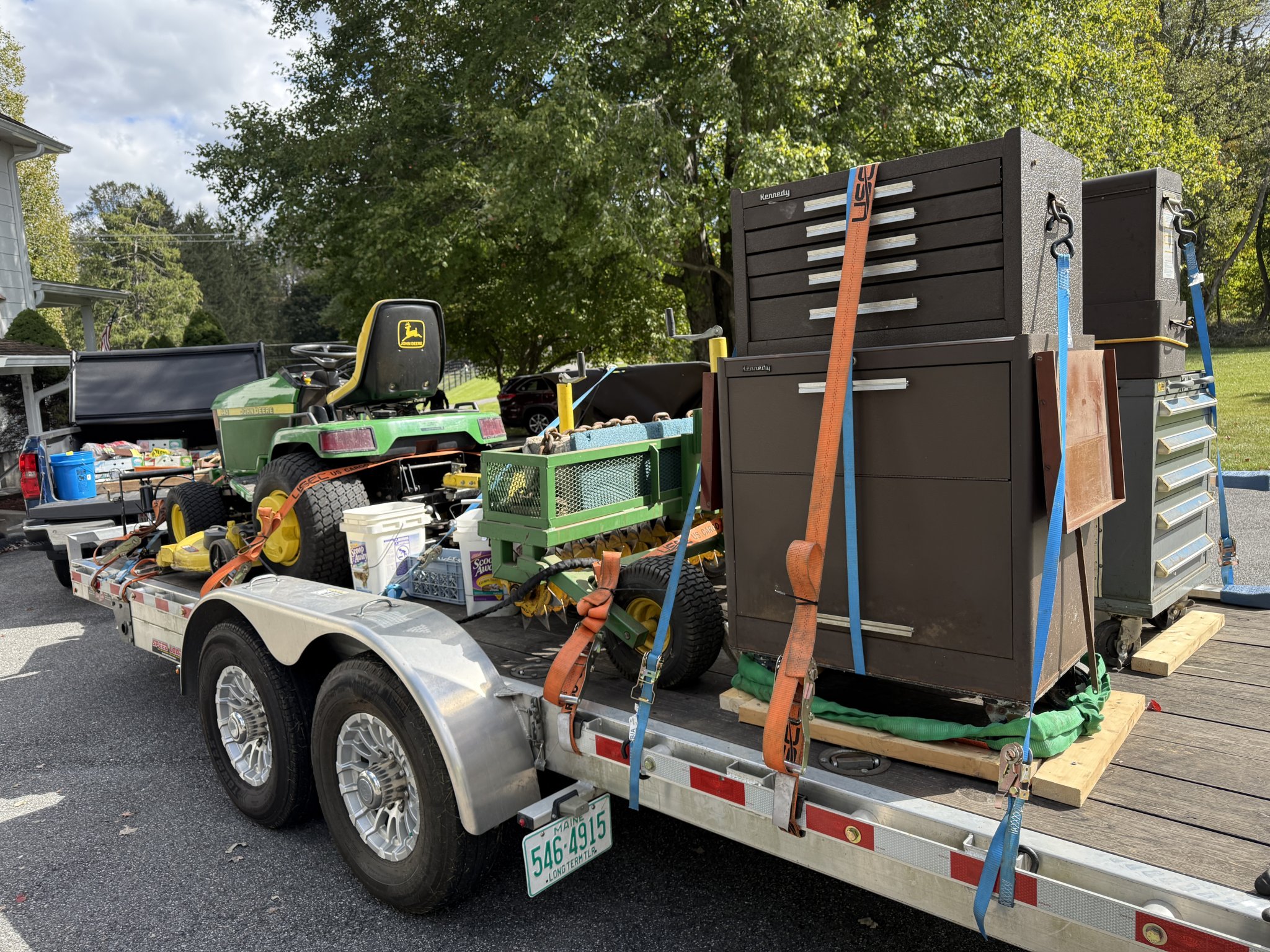

My recent haul, selling the tractor, attachments, and many tools for an elderly family friend.
Nice set up…from the pics the axles seem like pretty far forward…. Or are my eyes deceiving me on the axles front of the center of the deck? (Looks like a purpose built car hauler?) 👍 nice set up with the power tilt and winch.

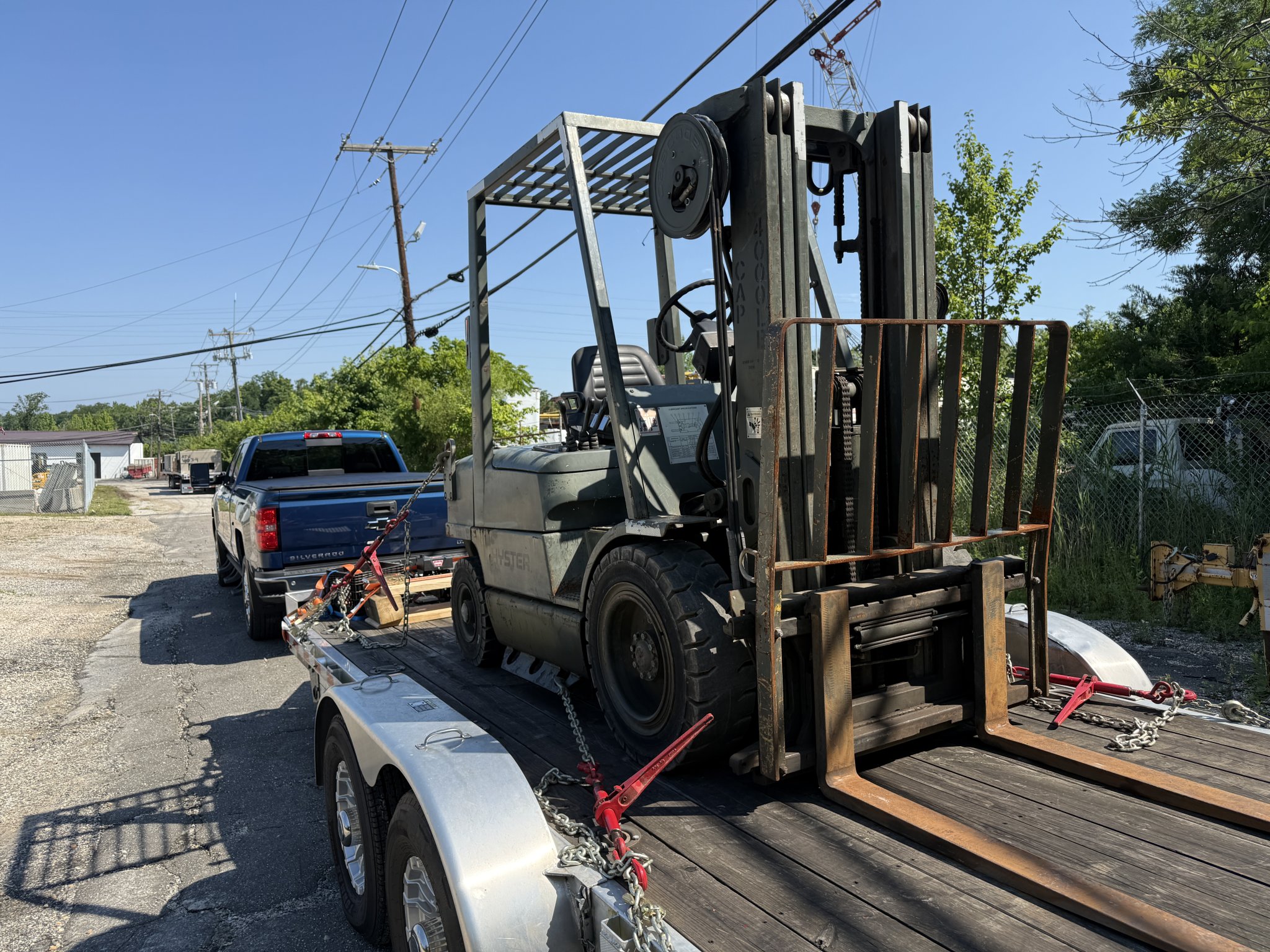

Hauling my NTM forklift:

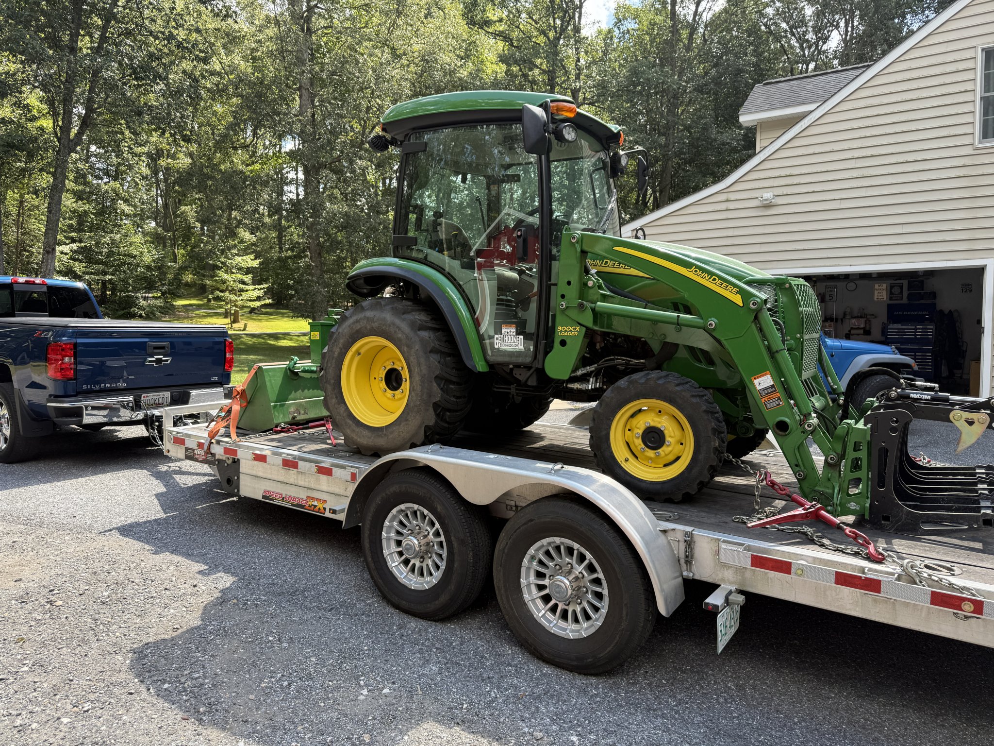

My tractor:

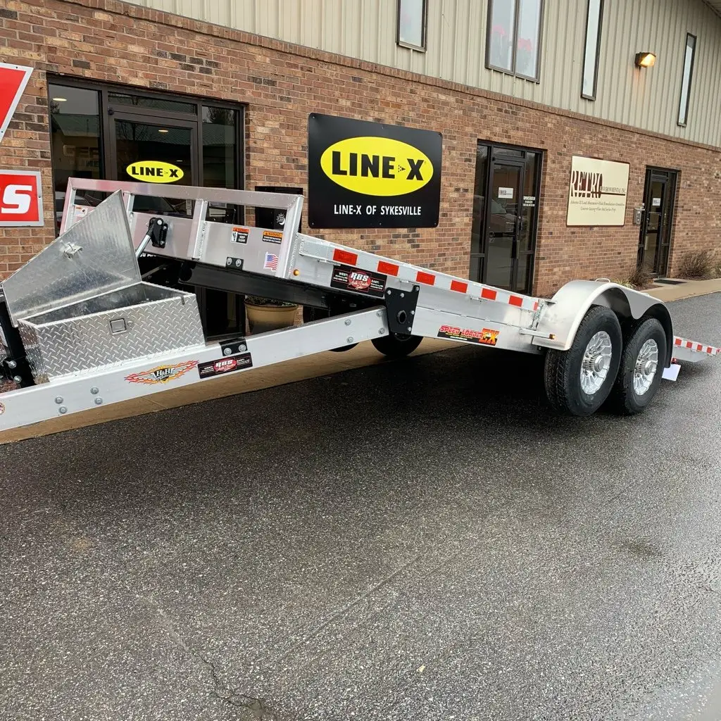

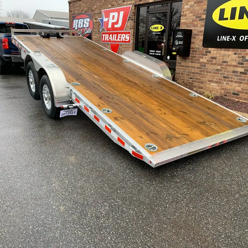

They are about in the middle. This way there does not need to be two full 'frames' like many other tilt decks. This leads to a steeper loading angle, but lighter trailer. My understanding anyway...but I'm not a trailer engineer. It is light on the front, so you do need to have weight forwards when using it. I have a Weigh-Safe hitch to help with that.
Heres two tilted pictures:

Whoopsies…I must have gotten a little too worked up over the power tilt and tie down rings in the deck. Very nice. 👍

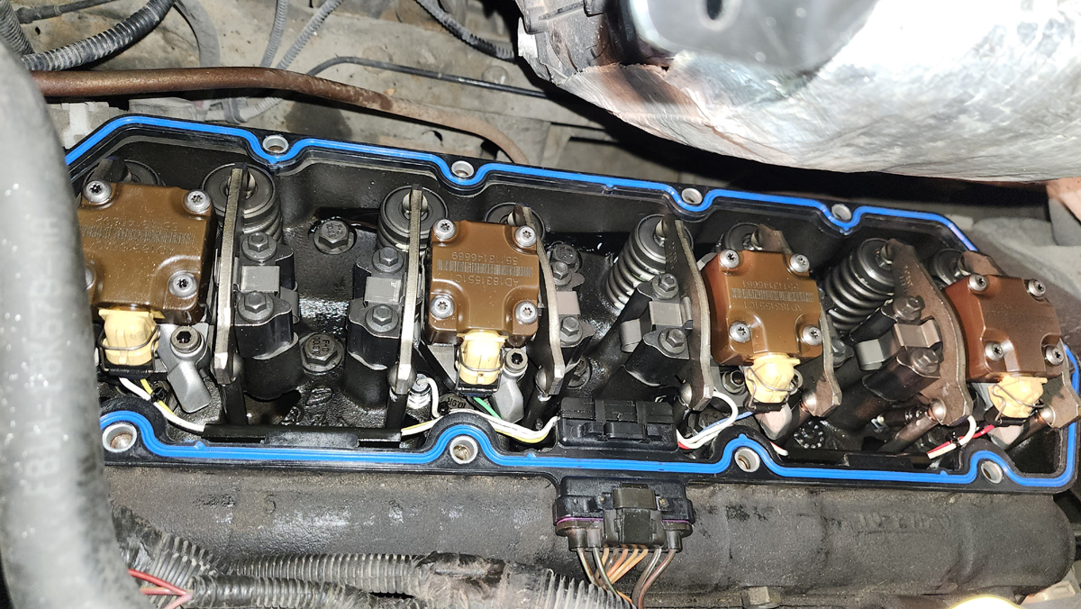

A couple of weeks ago I removed a bunch of stuff such as the air filter housing, air intake, inter cooler tube, etc., and managed to remove the driver's side valve cover. I replaced all four glow plugs on the drivers side and installed a new FEL-PRO valve cover gasket. I also ordered new gaskets for the crank case ventilation housing. The valve cover gasket has a connector built into it for the wiring harness that runs to the injectors and glow plugs.

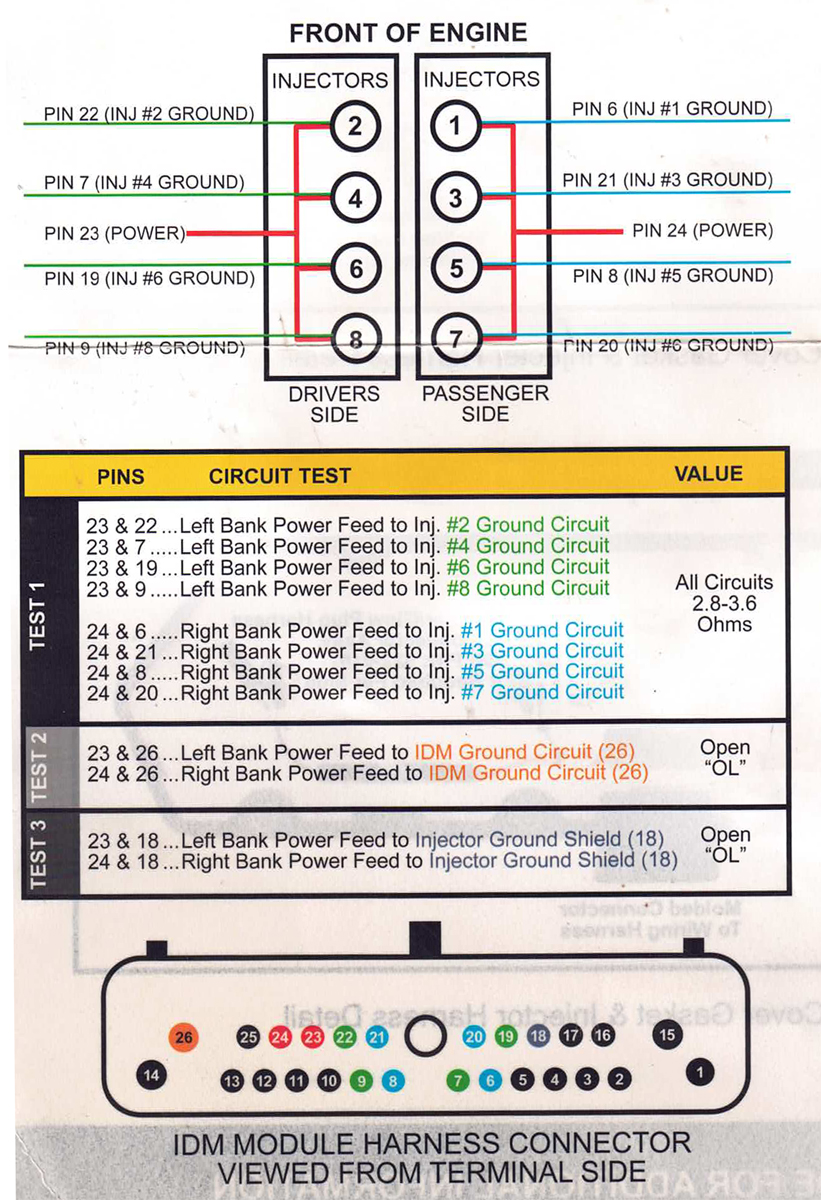

I followed the instructions and measured the resistance for each injector at the IDM connector and the results are shown below in blue. The values are supposed to be 2.8 to 3.6 ohms but clearly I'm not getting that. I haven't changed out the passenger side valve cover gasket or replaced the glow plugs but will be getting to that tomorrow.

Test 2 and test 3 above are critical tests in terms of the IDM so I confirmed open circuits before starting the truck for the first time in over a year. I was surprised by how well the truck ran given all of the missing components. Next up is to complete the glow plug and valve cover replacement on the passenger side, and then reinstall everything that I removed.

I managed to replace all eight glow plugs, and with the new batteries the truck fires up in an instant now with hardly any smoke, even at sub 40F temps which it has struggled with in the past. I had forgotten a post I made last year in which I stated that the DP-Tuner programmer reported a failed IDM and I confirmed it when I got home with an automotive scanner that I have. So there's no doubt in my mind that the IDM did indeed fail but I'm not sure if bad batteries caused it, or time, or vibration, or moisture etc.
The glow plugs have been in the engine for over 23 years and close to 180,000 miles so they've done well and it's not a bad job to replace them. Hopefully these will last another 20 years or so. They're cheap enough at something like $7 each, but no doubt a shop would charge a lot of money to replace them. I like FEL-PRO products and the truck now has a couple of FEL-PRO valve cover gaskets which are shown below. You can see how the wiring harness passes through the gasket.
I'm taking the old F-250 on a road trip this Friday so I have some things to button up before heading out. This truck had the #8 injector mod when my friend owned it, along with a fuel pressure modification, and I noticed this morning that there's a drip at one of the push on hoses that goes into or out of the regulator. I'll address that today too.
Glow plugs are interesting things. They're simply heating the air in the cylinder prior to fuel and more air being introduced so that the autoignition temperature is reached during the compression cycle. Does anyone know if they actually glow red when energized, and does the amount of current going to the glow plug depend on the location of the piston in the cylinder or the timing? If a cylinder is at BDC and starting the compression stroke, it'd have the most air volume and be the most critical so I would think that the glow plug in that cylinder would require more current. :unsure:

They do glow red. Put 12v to one of the ones you pulled. They run off a single relay so they all get the same juice. The relays are known to fail so if trouble starting comes your way diagnose that first. I think it’s on the passenger side of the engine bay.
