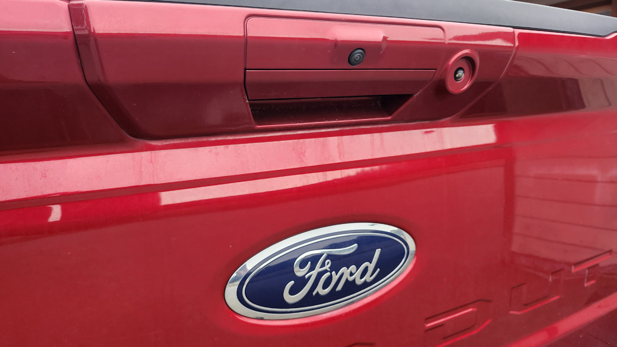

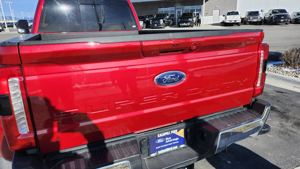

I have a handle in the tailgate which you can see in the photo below that I took at the dealer when I first saw the truck. I also have the tailgate step which I've yet to use. The step has a fold up handle to assist stability when getting on/off the tailgate. There's a button on the underside of the handle that if depressed quickly (at least twice) will automatically lower the tailgate. There's a button in the cab that works the same way.
GrumpyFarmer
3,593
5,241
Thank you. That explanation makes sense. I must have misunderstood either what salesman said or how the handle worked. I’ll find out first person soon enough unless the chip shortage holds things up.
The tailgate does not have a typical latch handle configuration like you're probably imagining. There is a button that signals an actuator inside the gate to release the latches and lower. The same system has been in use in SUV lift-gates for at least a decade.
I can see the point of power down on a tailgate such as when backing up to a gooseneck trailer, but I'm not sure about the usefulness of a power up feature.
When I added the DECKED toolbox I lost the ability to see the gooseneck ball in the bed so plan on adding another camera at some point, perhaps under the rail and protected in a steel housing. There's a provision for an RV camera on the main 12" screen so I'll need to figure out a few things in order to get that done.
Thank you. That describes what feature I believe I saw on lot as a standard feature.
