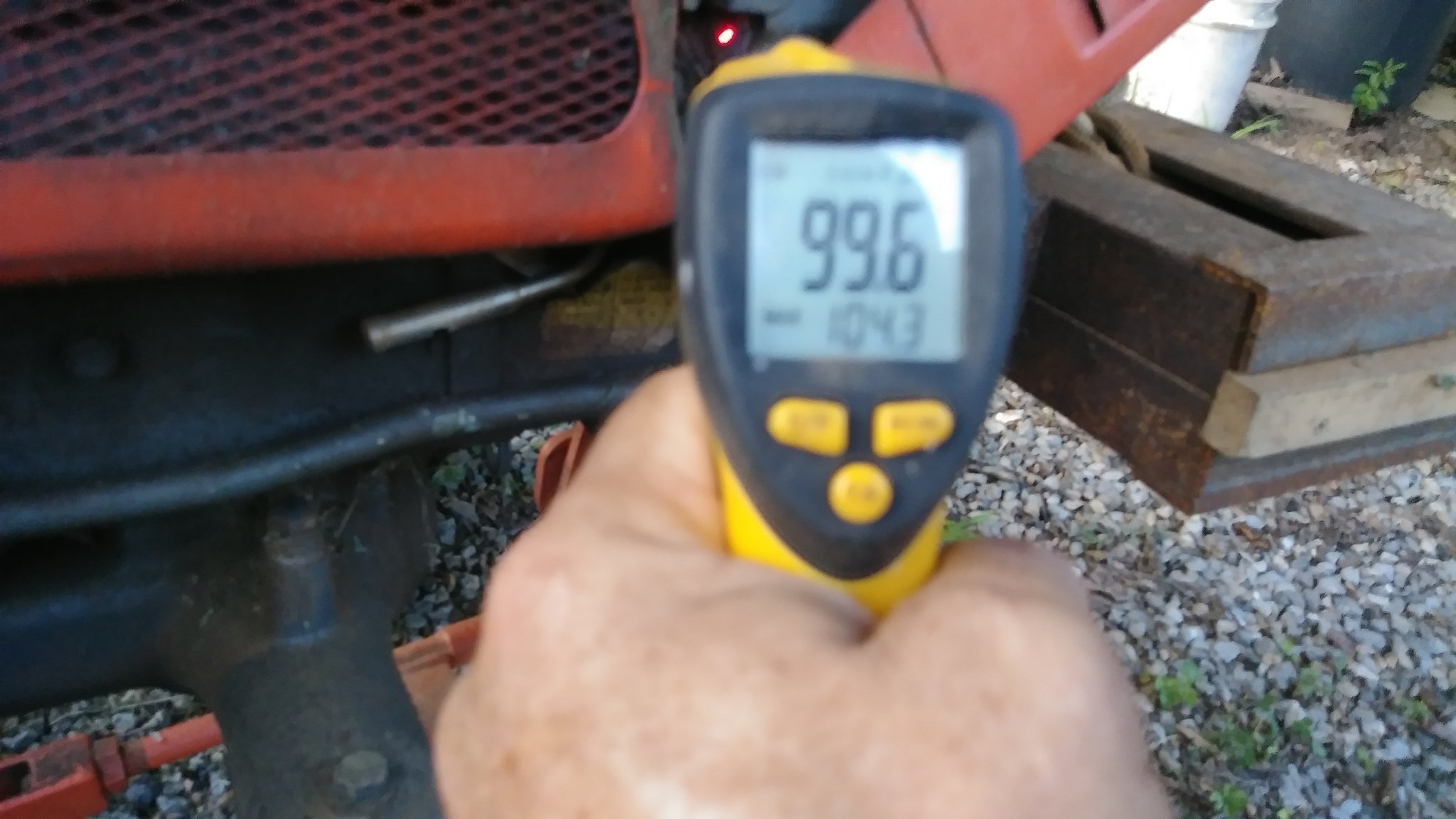

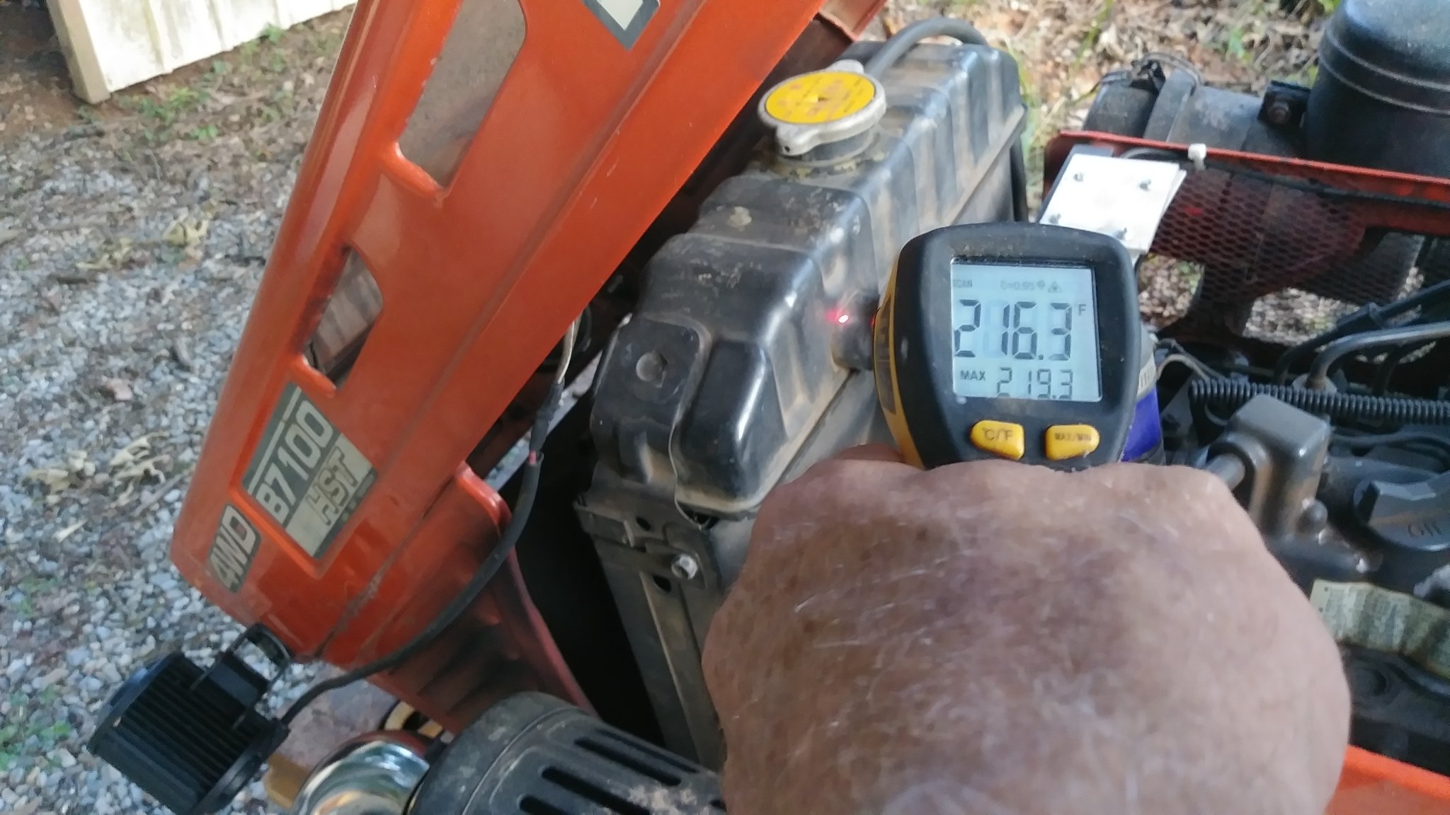

IN a perfect world ............ on a hard working machine, the top of neck of radiator is gonna be 200-220 F.......
210 is ideal, but......
bottom is going to be 100F less or better. 2018-08-16 19.59.01.jpg 2018-08-16 19.59.33.jpg

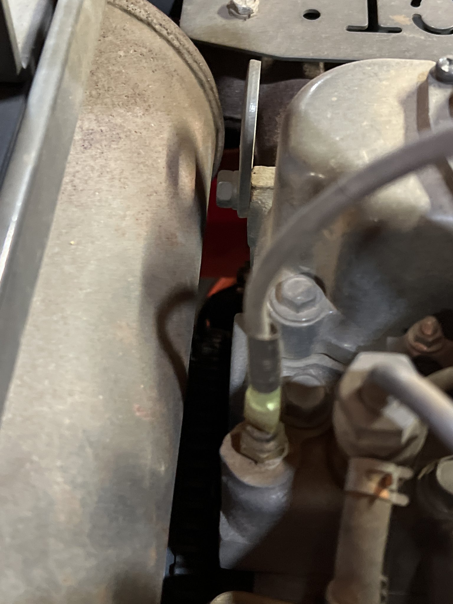

Evan Williams - you have a different engine, but this is the sending unit on my BX2360. Up front opposite fan. Might be similar. Connector pulls right off.
