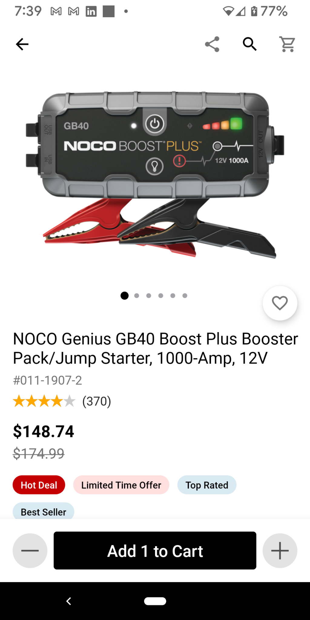

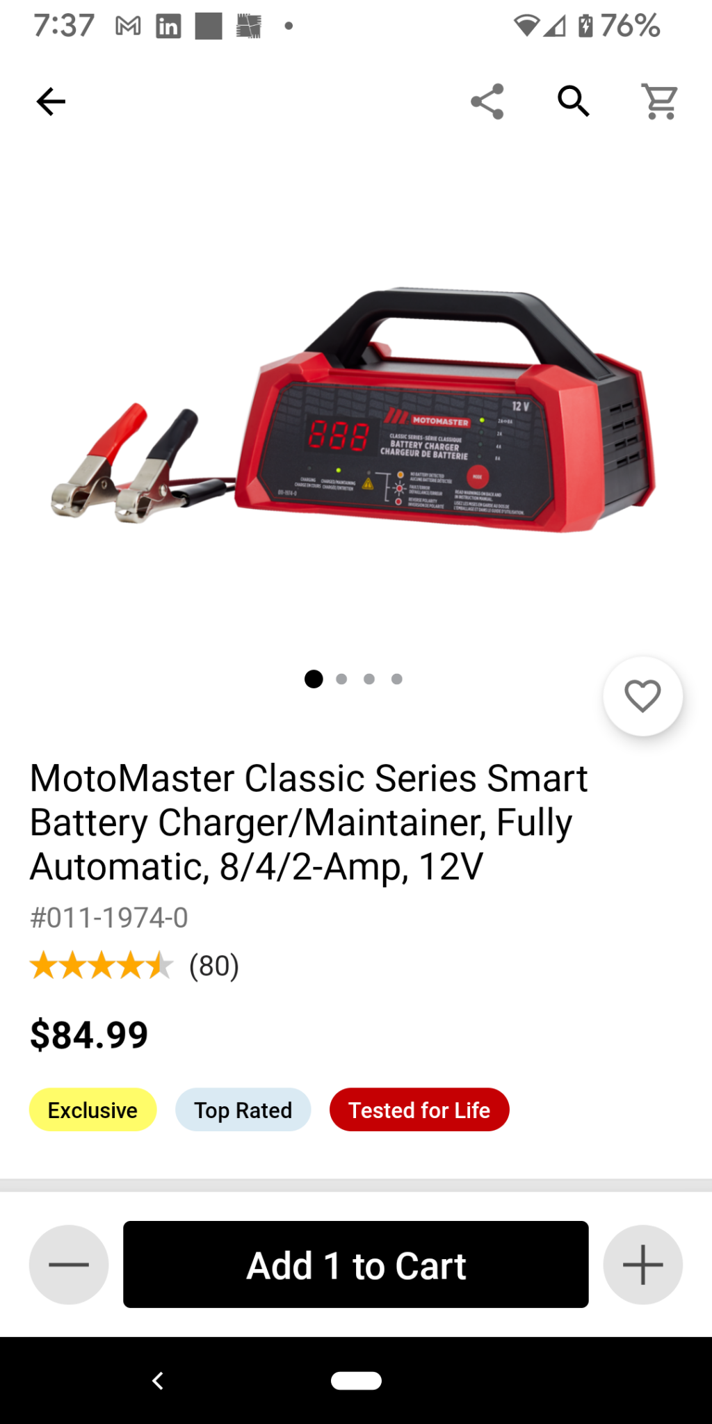

Since.i do.have a charger and always wanted a battery pack. Would the latter work now or do I need a proper 2/4/6/8 amp charger? The latter appears best Price/ performance available now.

You could use the small charger to bring the battery back up over time, but it will take a while.
The battery packs are nice to have in case of emergency, but the larger amp battery chargers are better for a dead battery.

Use the old school charger to get your battery volts back up.
The newer battery chargers are finicky about supplying voltage to batteries with low voltage while the old school chargers just charge without issue.
You can buy one of the smaller boosters if you'd like.
