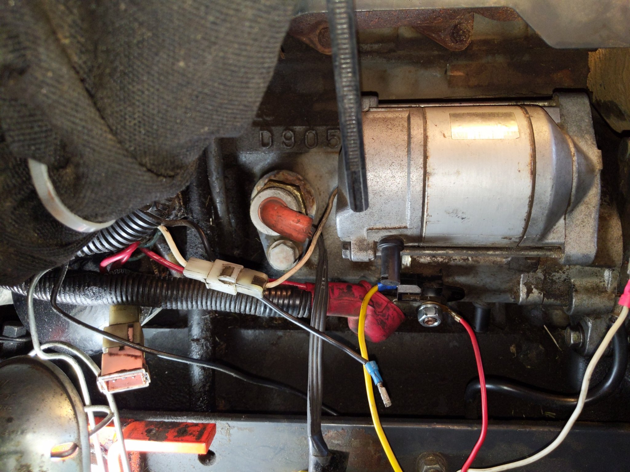

For some reason it wasn't showing up for me at first, but is now. If you still can't see it, the last picture that I posted that has the two green lines, and asking if you connect those two....
It is the wire on the bottom left of the picture, behind the yellow and behind the frame.
yup delayed but yes a ground wire from something I think unrelated. It's that other black mystery wire I wonder about. I bet these threads will help a ton of BX guys with the relay issue after I'm dead and gone. ;-)...

Picture showed up late... oddly enough. That's a ground. I had wondered and reached behind and it goes to that bolt on the frame. It's the other black wire that I plugged into the starter that I don't really know much about.
Assuming this is how you have it wired still, move the yellow wire to the starter where you have the black plugged into.
Disconnect and touch the red wire to the starter's battery terminal.
Does it crank over?
Does it crank over?
Yes!!!

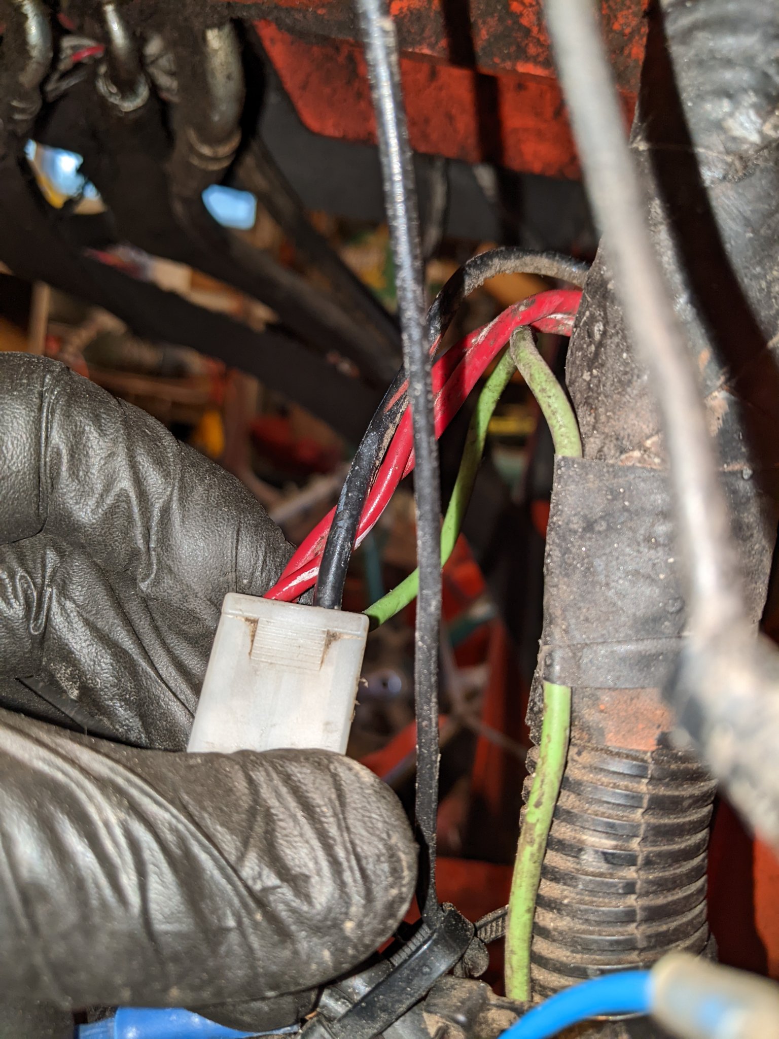

Do these wires and plugs go to your ignition switch?
If so, can you clean them up and take a better picture showing all of the colors on both sides of the plug?

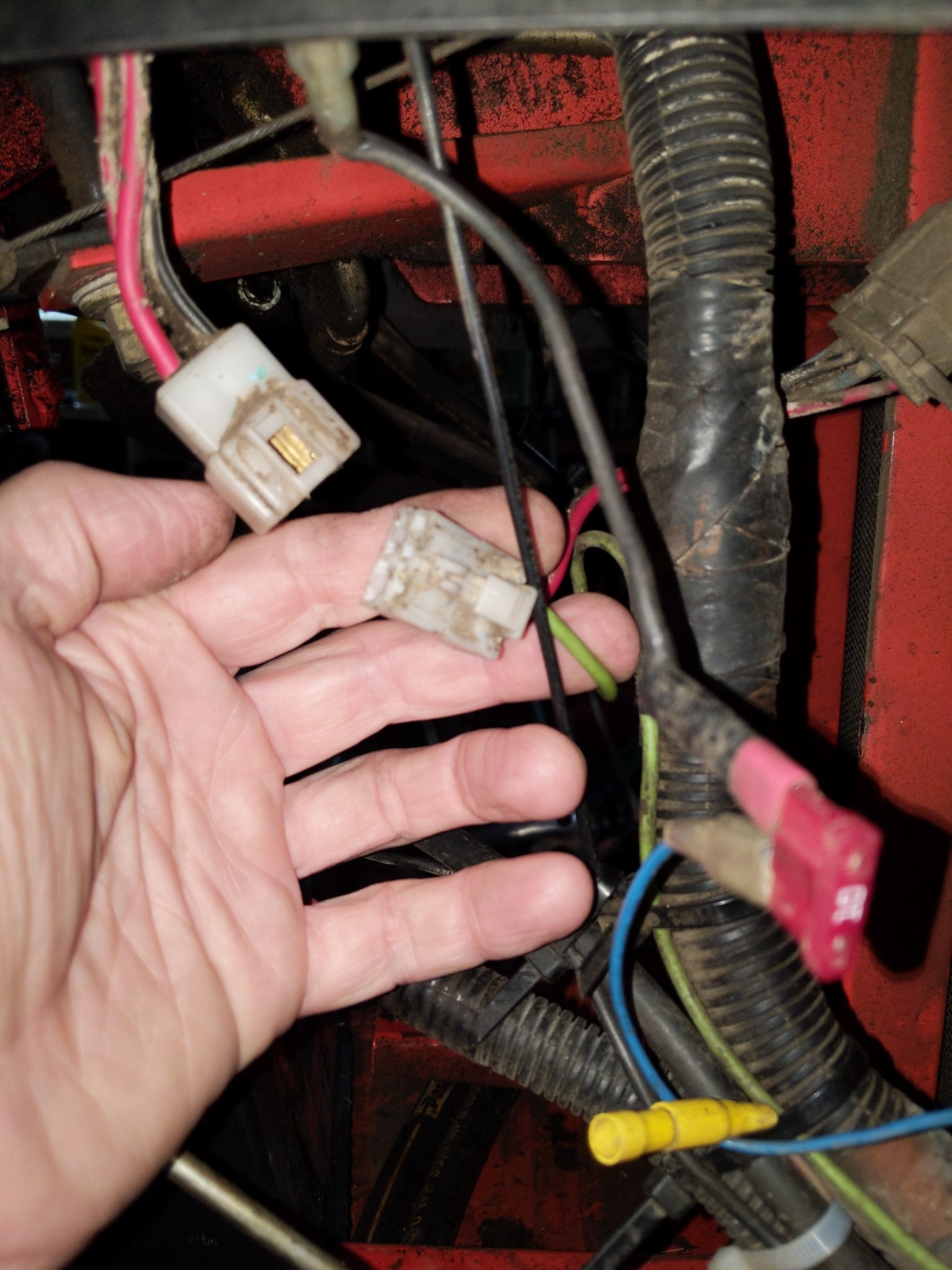

If I were Kubota, I would have ran the "start" wire along with the main cable.
Can you pull back the plastic split loom and see if there is a wire hiden in there?
I will double check but I don't think there is more than one wire in it.
Yes that is under the dash disconnected from the ignition switch. The green one comes out easily but by feel I reconnect it when I reassemble. I will go take a picture to show all colours more clearly of all 4 wires.

If you can't get a clear picture of those wires, see if you can tell what colors they are. According to the wiring diagram you posted, you should have a:
Red
Red w/ White Stripe
Black w/ Red Stripe
Black w/ White Stripe

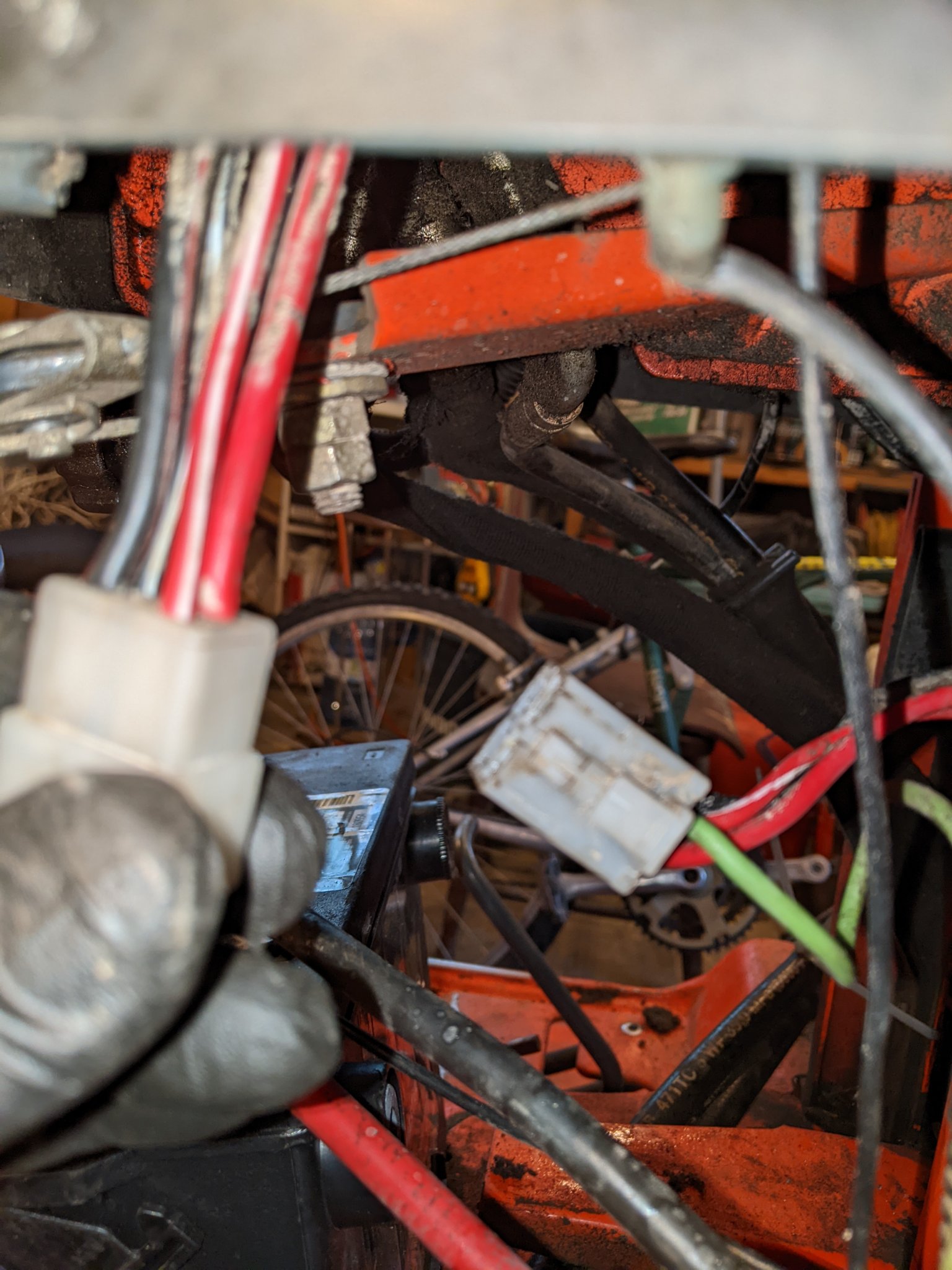

Under dash all 4 wires from both side of that connector.
The additional pic is how we left the relay wiring but should I not revert back to the previous permutation which I hopefully remember or can find from notes here. ;-)
It is hard to tell, but it looks like the Black wire with a white stripe is across the plug from the green wire. Is that correct?
Don't change anything on the relay wiring yet.
