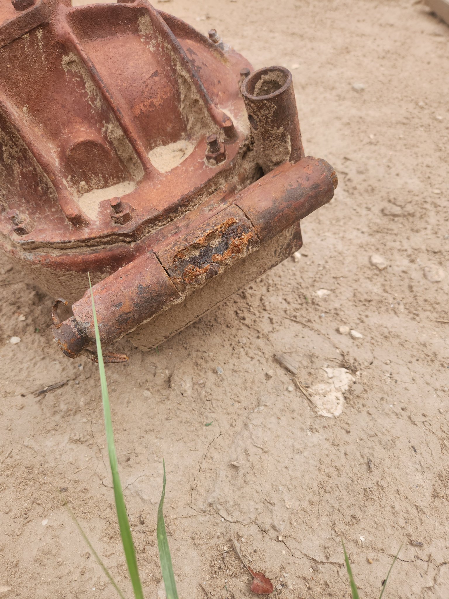

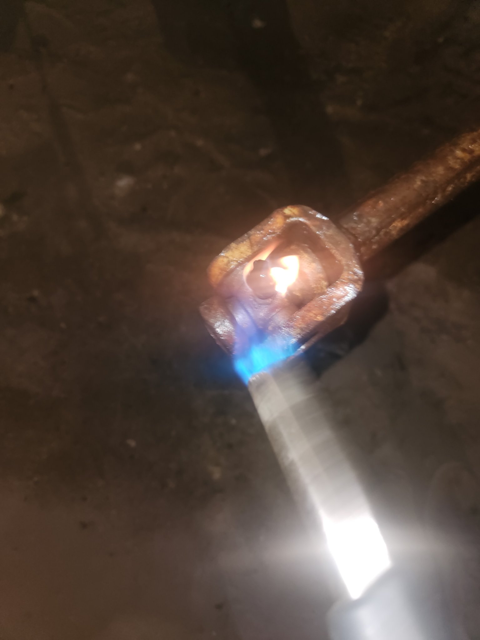

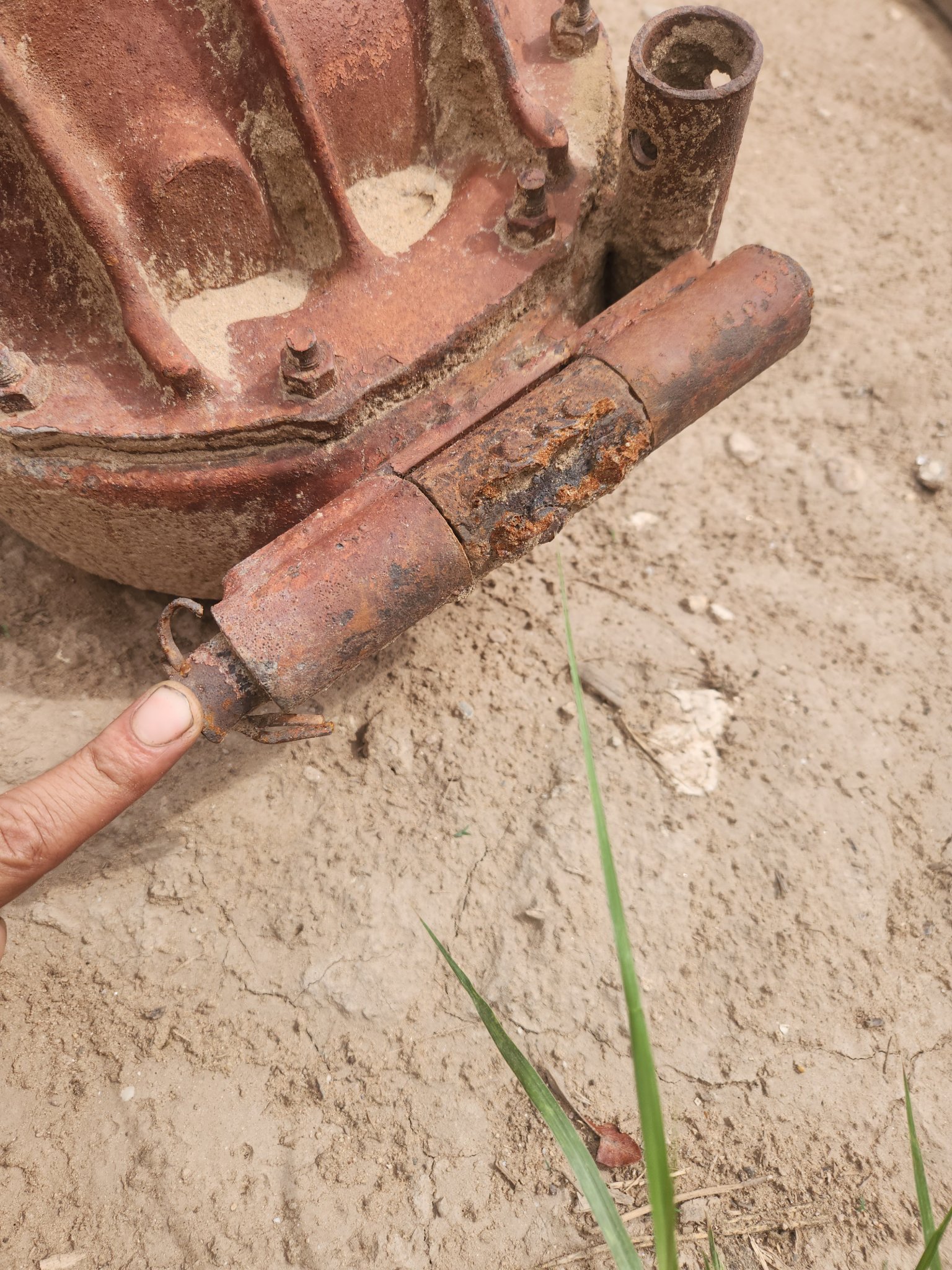

Heavy duty post hole digger, goal: hit the broken weld with grinding wheel, weld on a new hinge
I point to stuck hinge, tried soaking in diesel, hit it with torch, won't budge
This hinge being stuck broke the weld

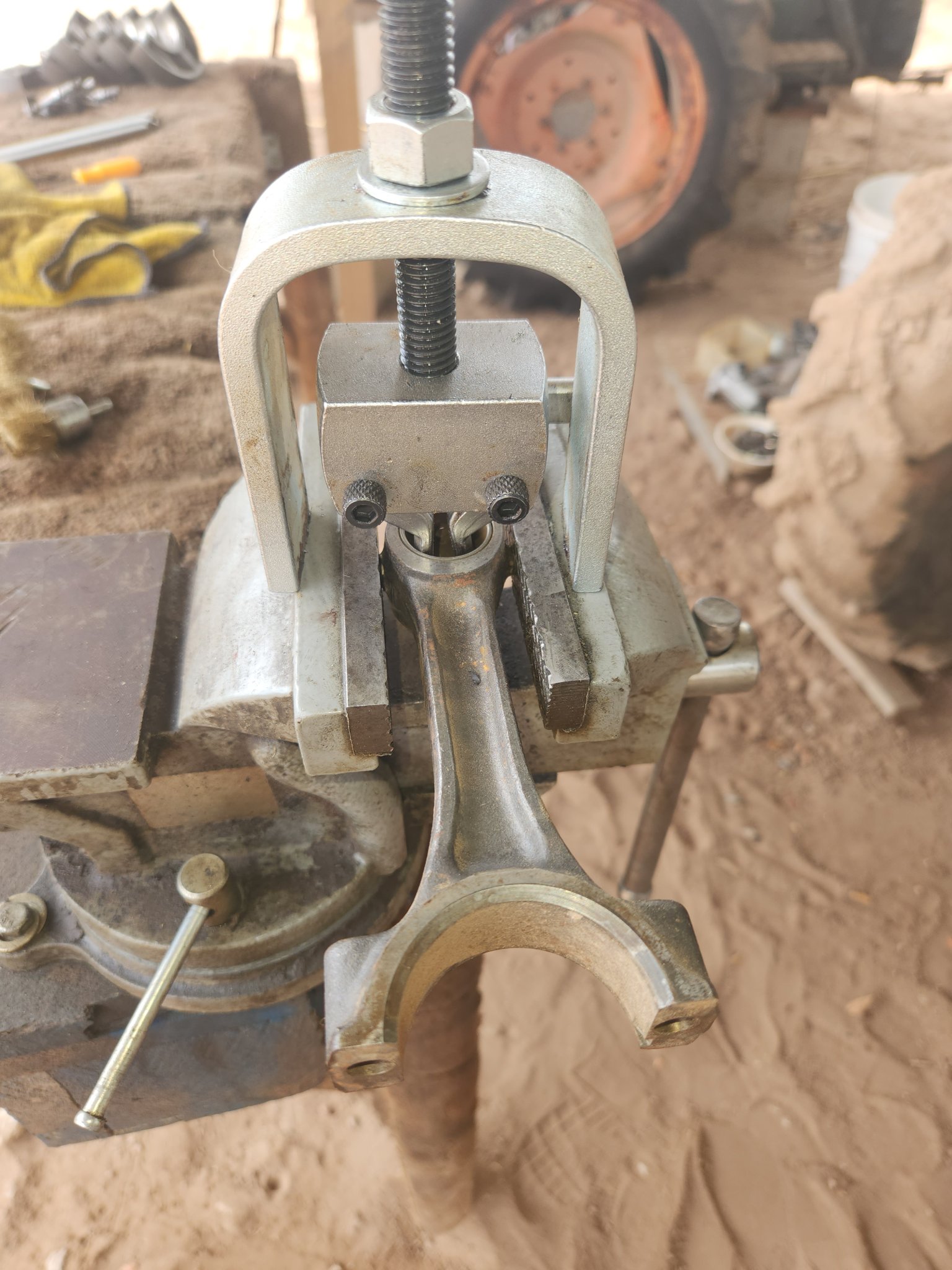

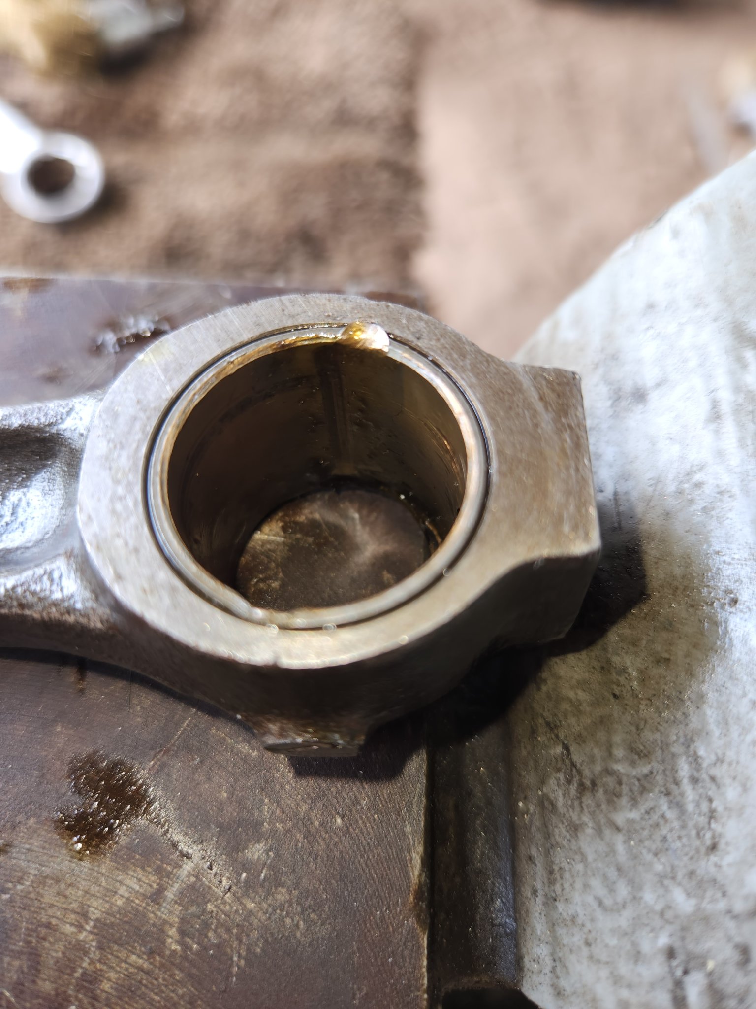

Another task: try to use that tool that pulled out pilot bearing, to

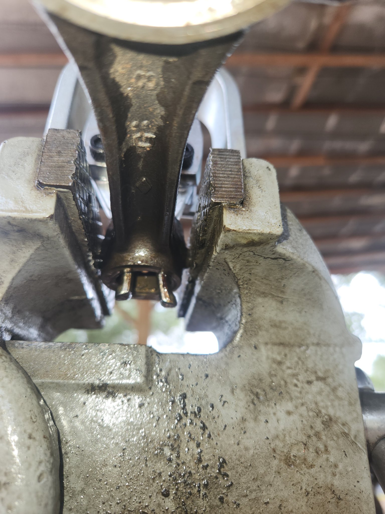

Finangle that tool on these connecting rods and try to remove damaged wrist pin bushing with new wrist pin bushing
now i go try remove those wrist pin bushings
Setup trying to pull bushing
Spray with diesel, hit with torch aiming at the connecting rod
Underneath, teeth gripping
2nd attempt
Did not work, caused damage to bushing
Not the right tool for the job
Video showing you why this tool not correct

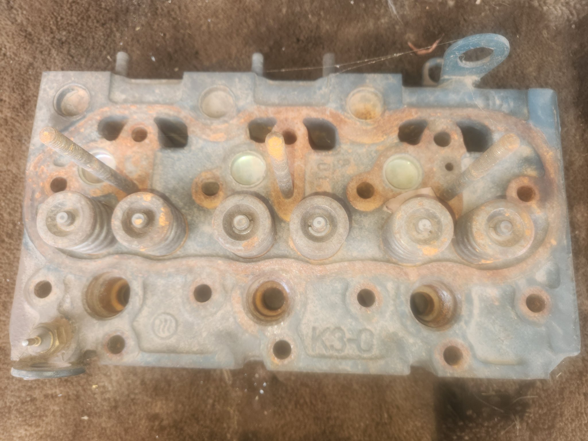

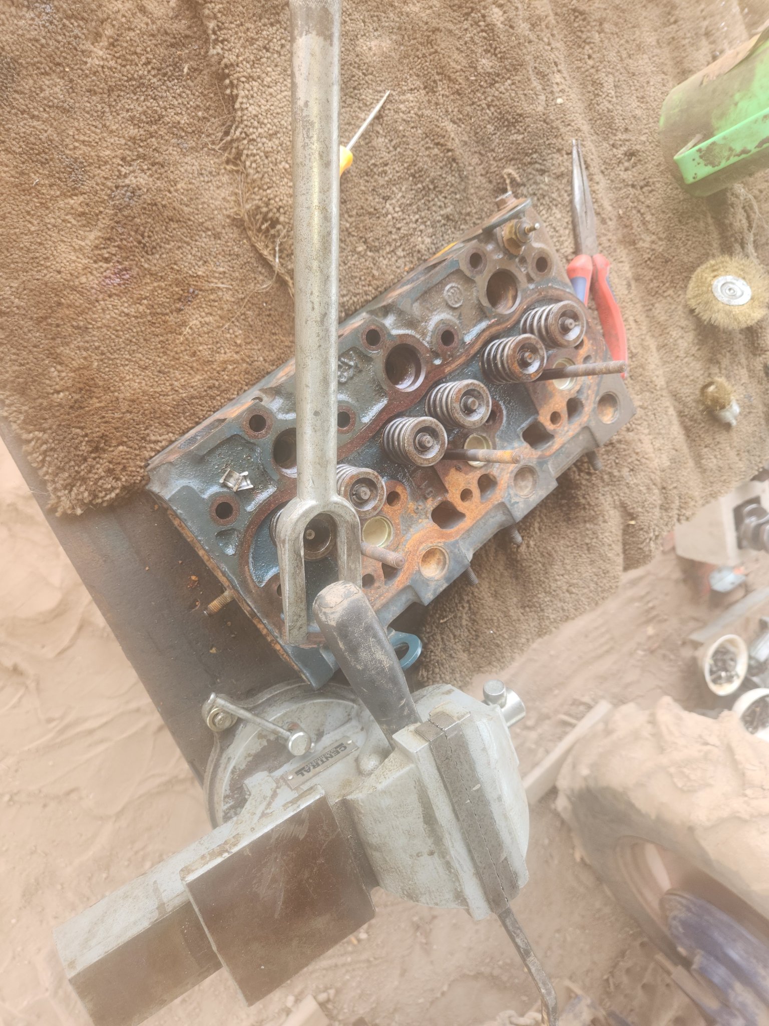

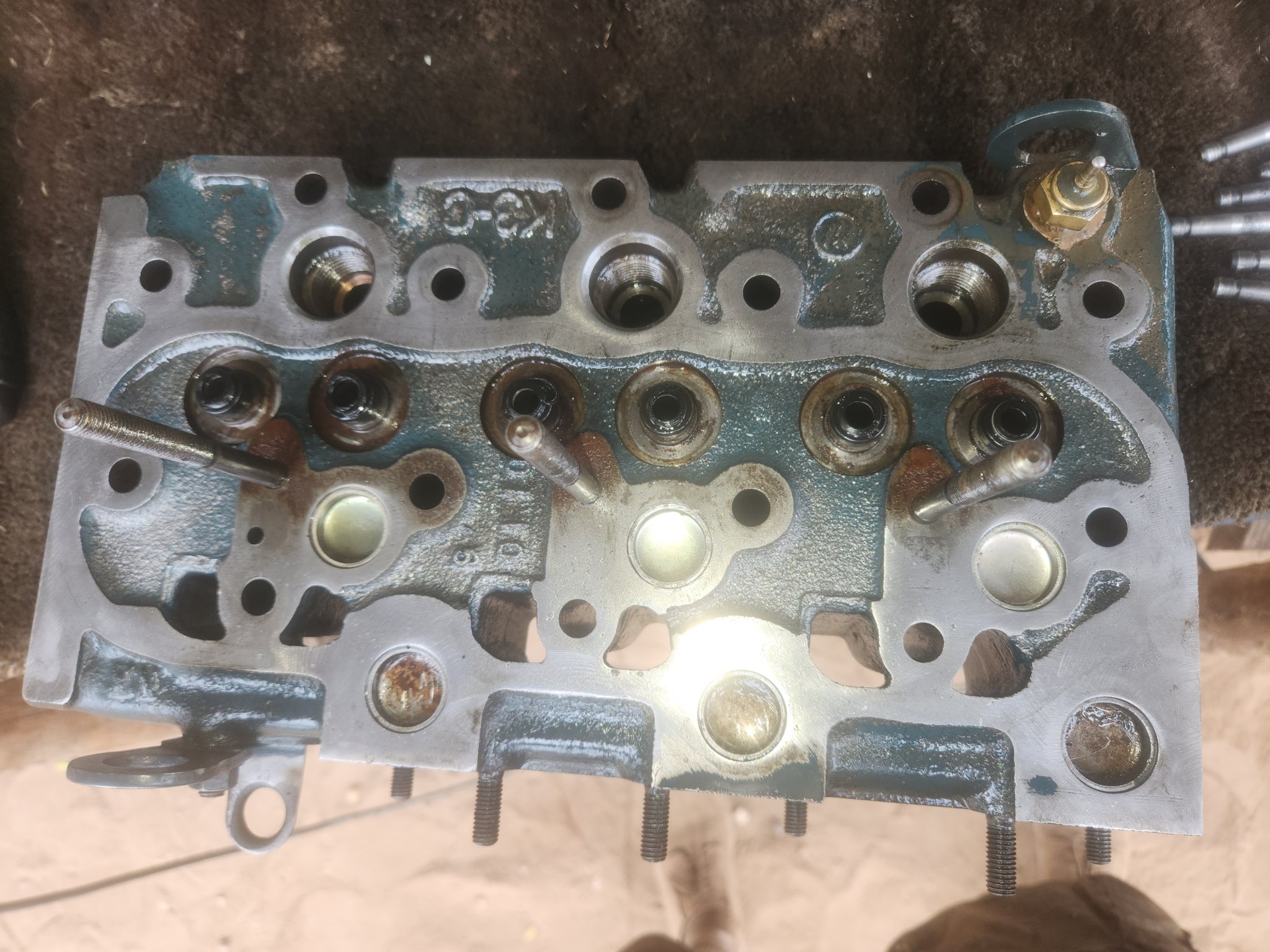

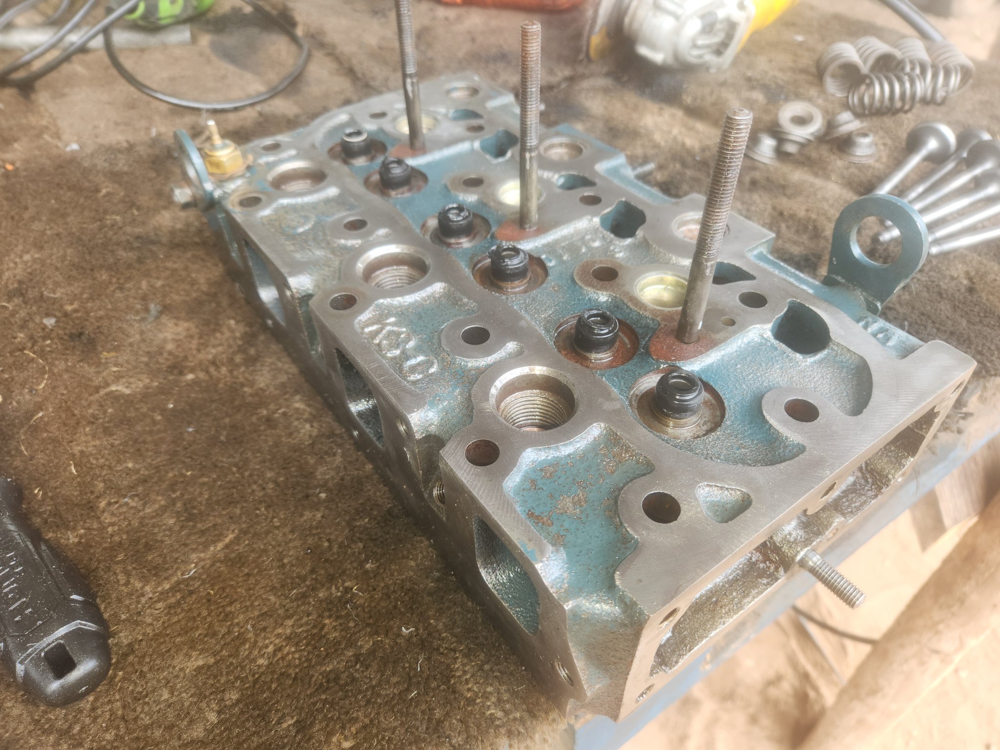

Rebuilding head with 2500 hours

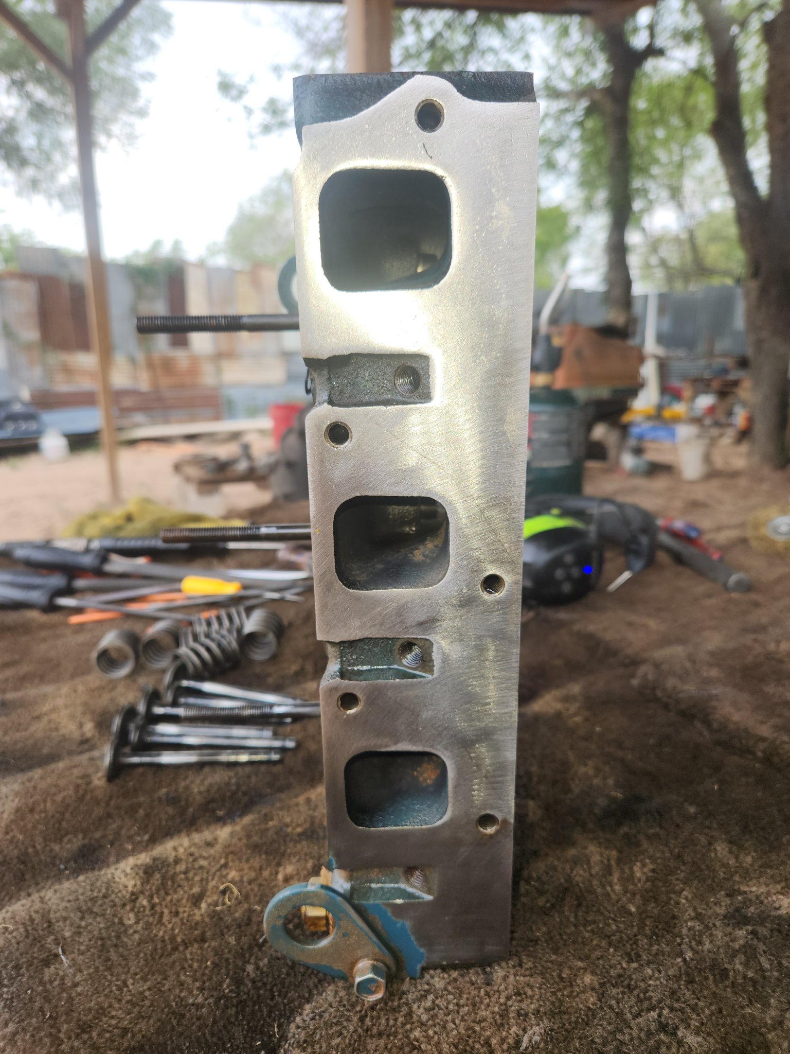

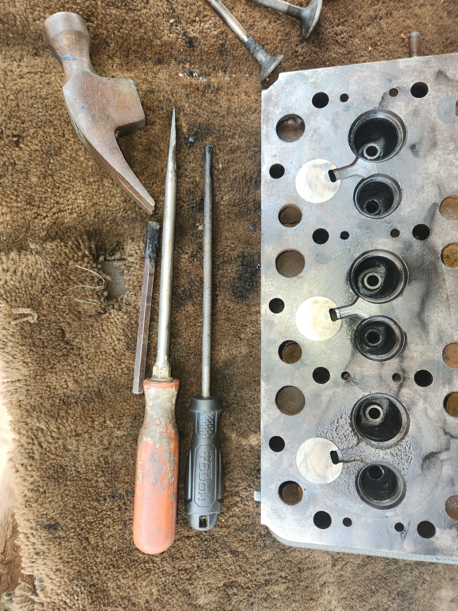

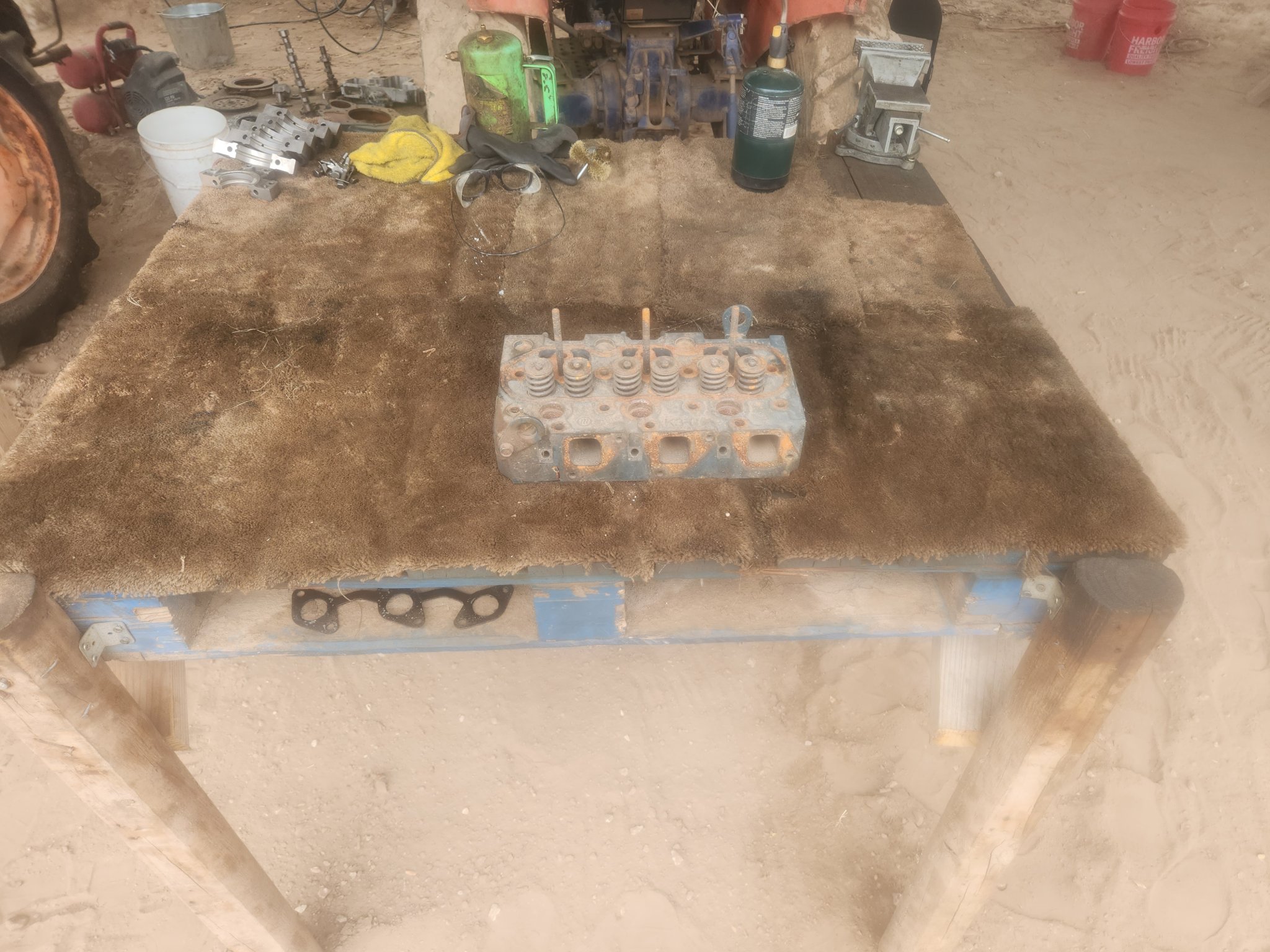

Leveled ground with rake, cleaned up table get ready to rebuild head
Pictures of it
Last picture: exact setup for pushing down springs, left hand pushing down tie rod separator, right hand with pik removing the holder, wear glasses

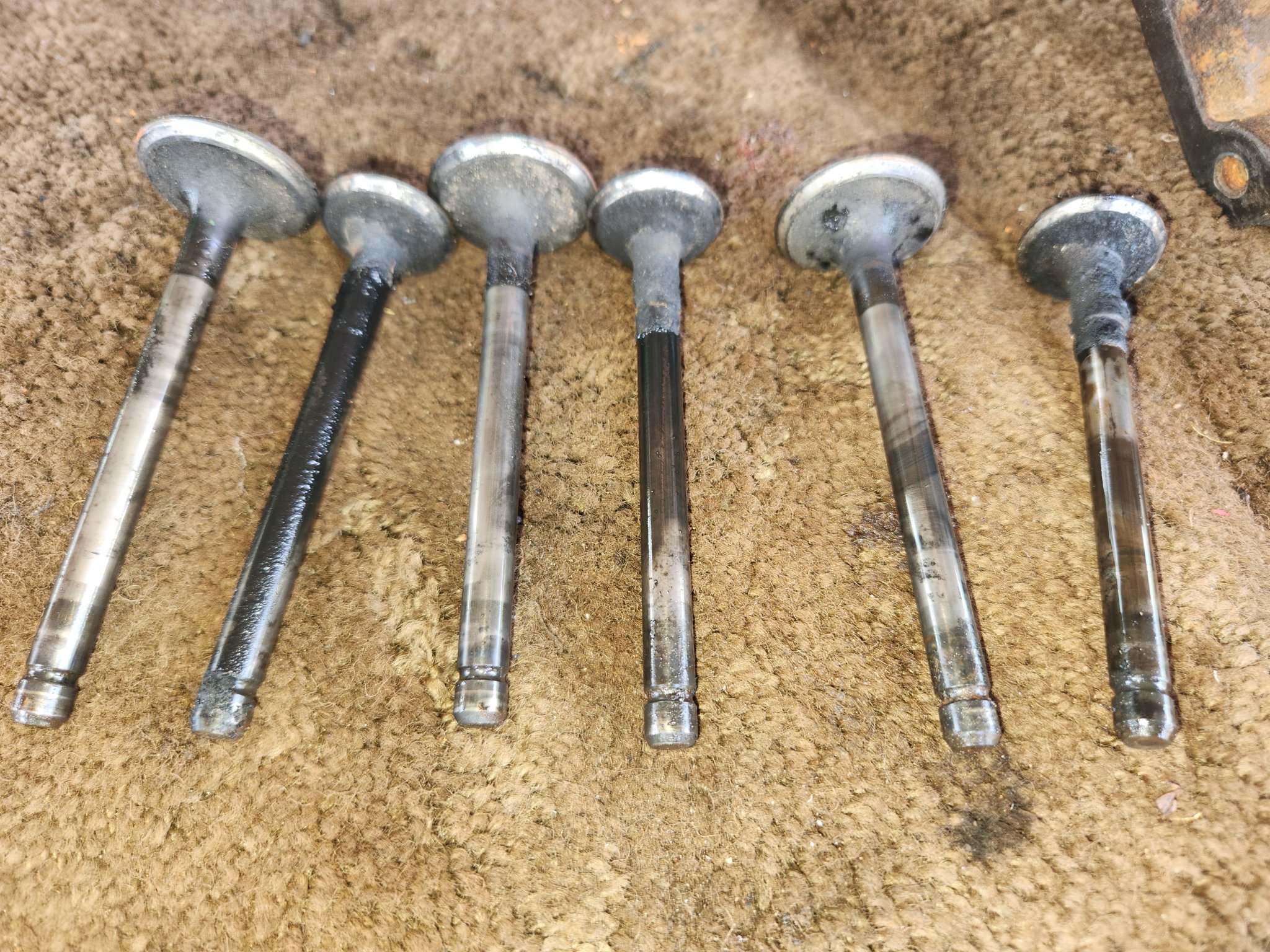

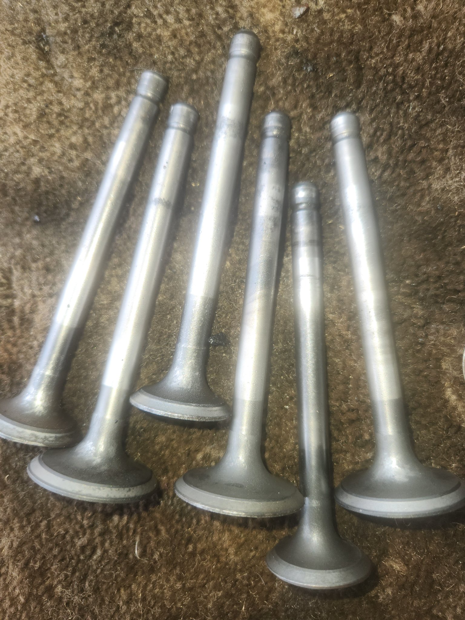

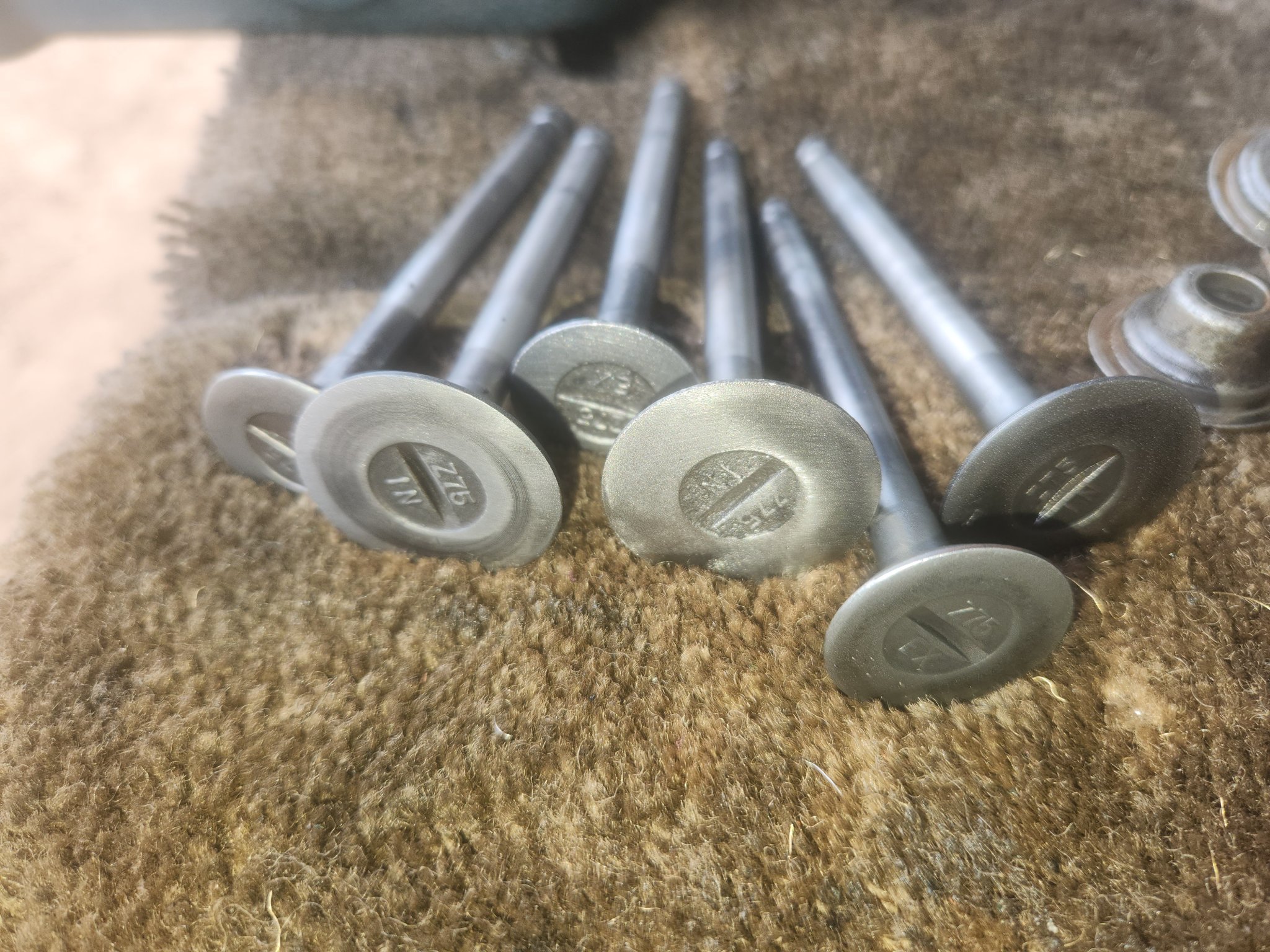

Finally got the valves out, they were stubborn, very stuck
The smaller holes are fully clogged on all 3
The valves with the pitting metal were most seized, most stubborn
Now: hit all sides of block with abrasives soaked in diesel, experiment with the flap disc sanding

When it comes to those wrist pin bushings you're going to need at least a 20 ton hydraulic press and the correct bushing driver. Your best bet may be to take them to the machine shop and let them change them.

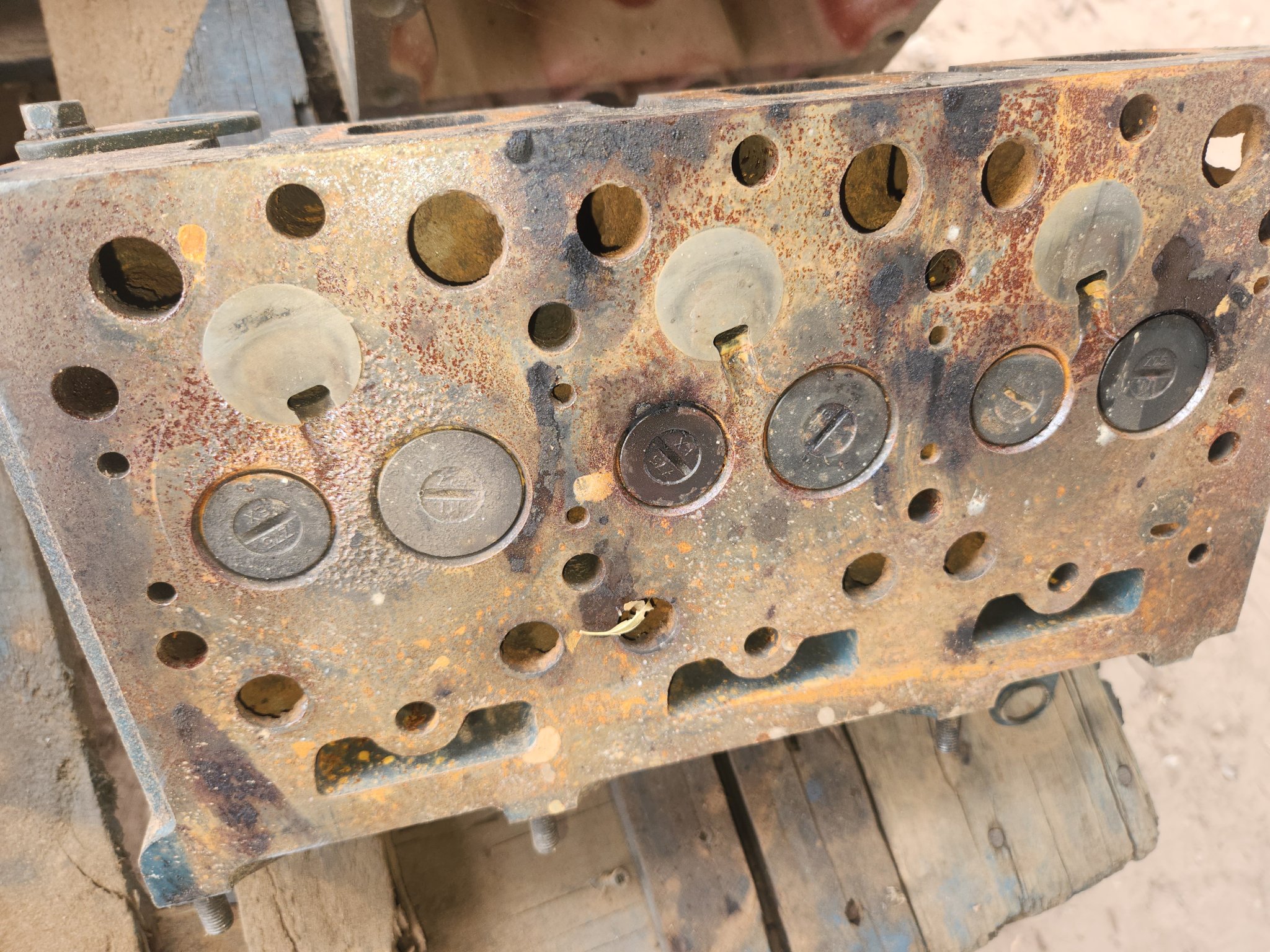

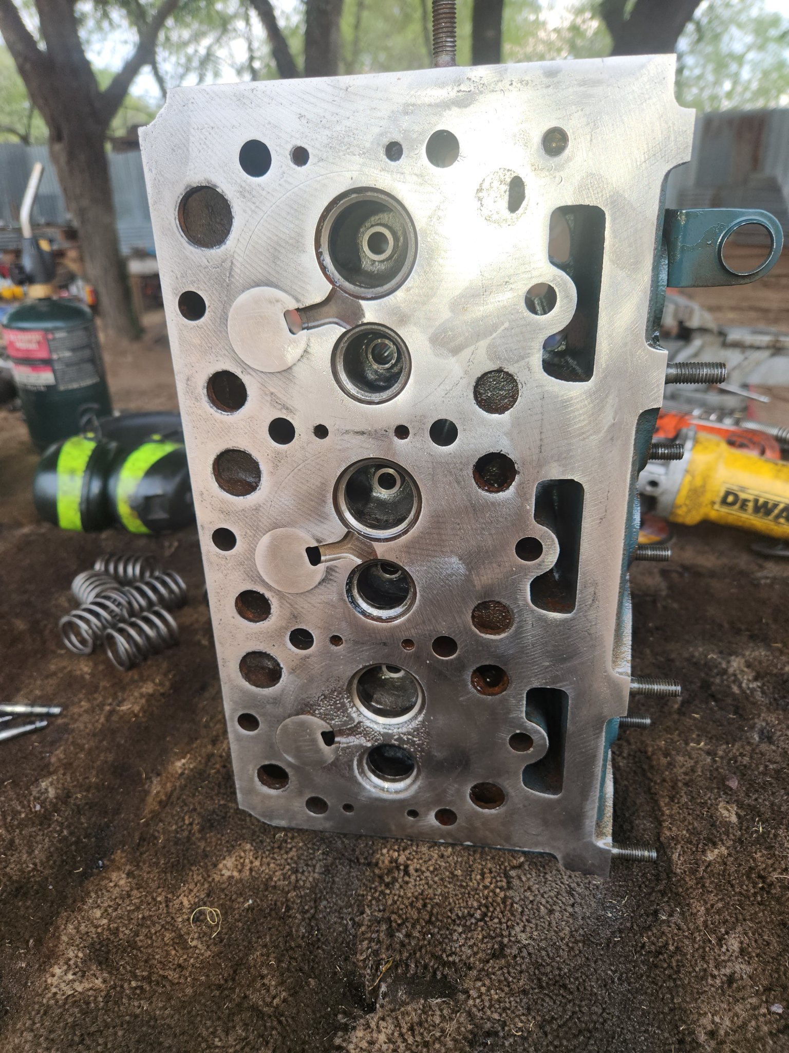

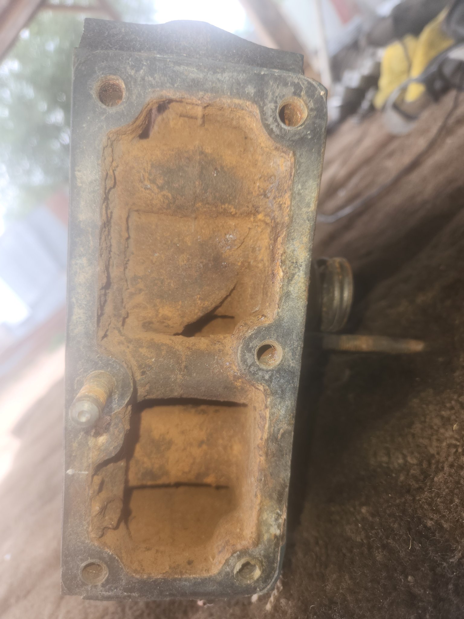

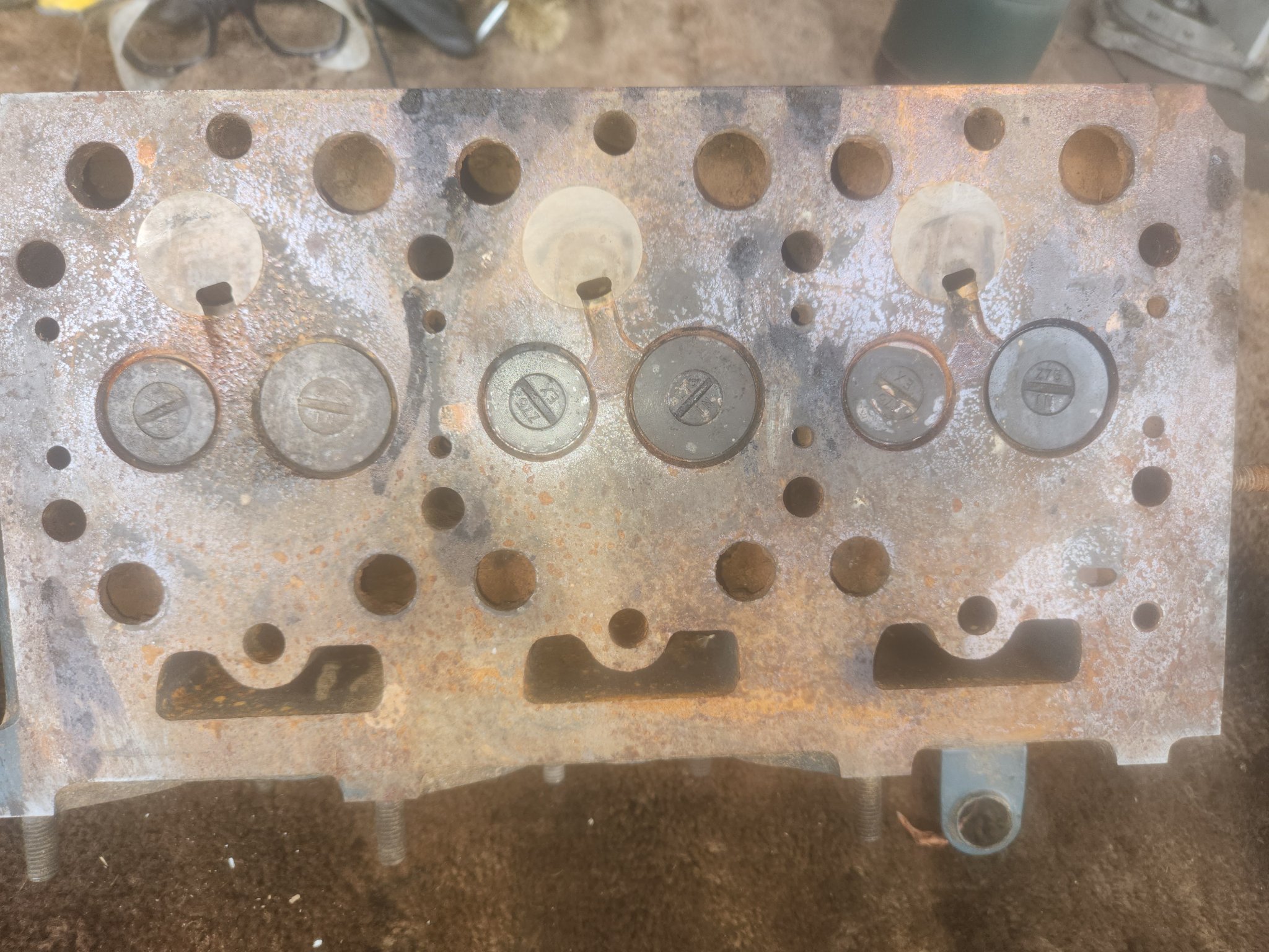

Hit the head hard with abrasives
Files and chisels breaking away at the buildup on the block around essential passageways
Best way to break down crud: chisel and a small hammer chipping away at the crud lightly, not digging into block
Hit with diesel, then compressed air, then flap disc 80 grip on all flat surfaces
Using smaller front facing wire wheels getting all holes, spin both direction
Using round file going through all ports filing away the crud, dip file in diesel
Hit with parts cleaner

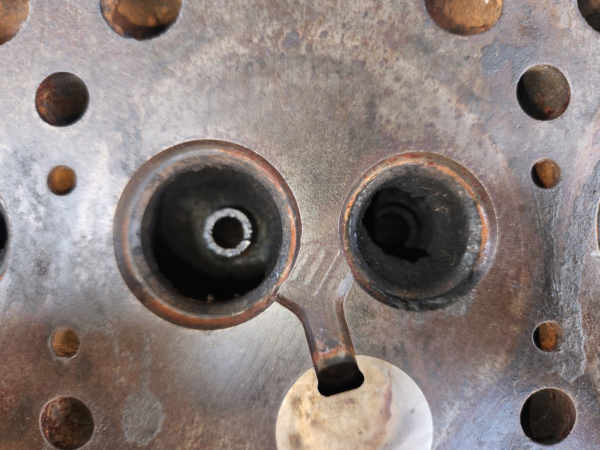

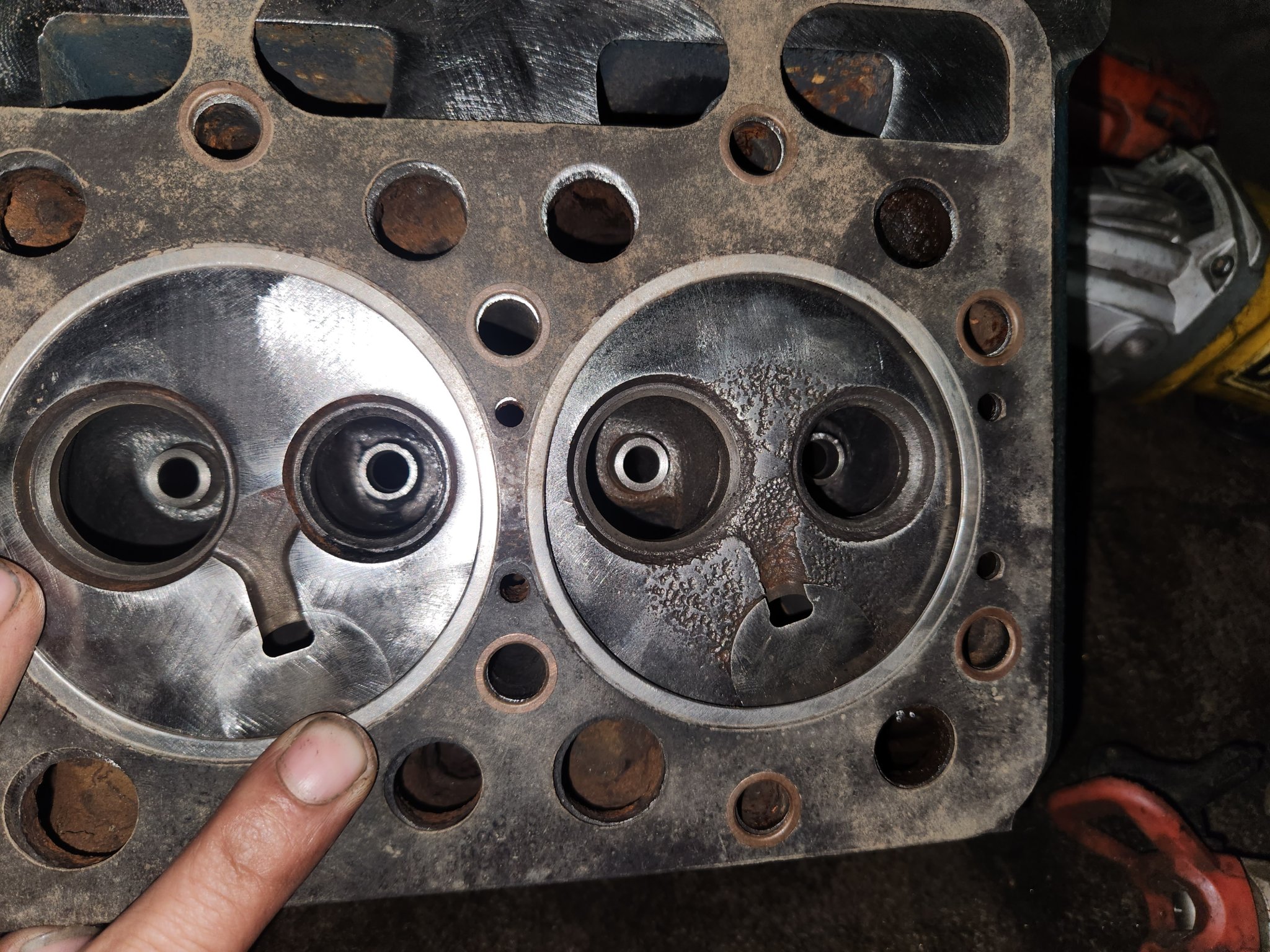

Jim L.
Jun 18, 2014
868
170

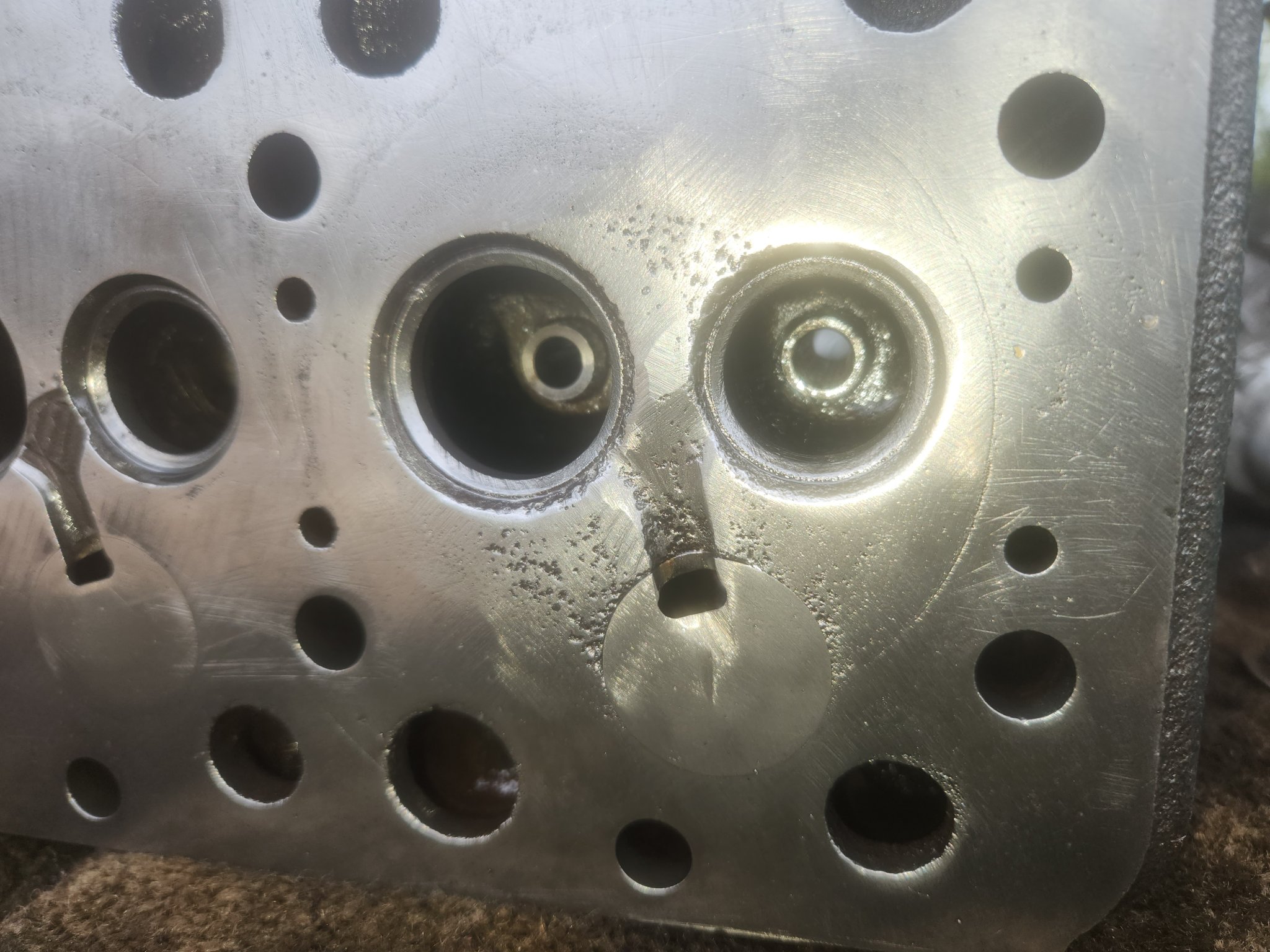

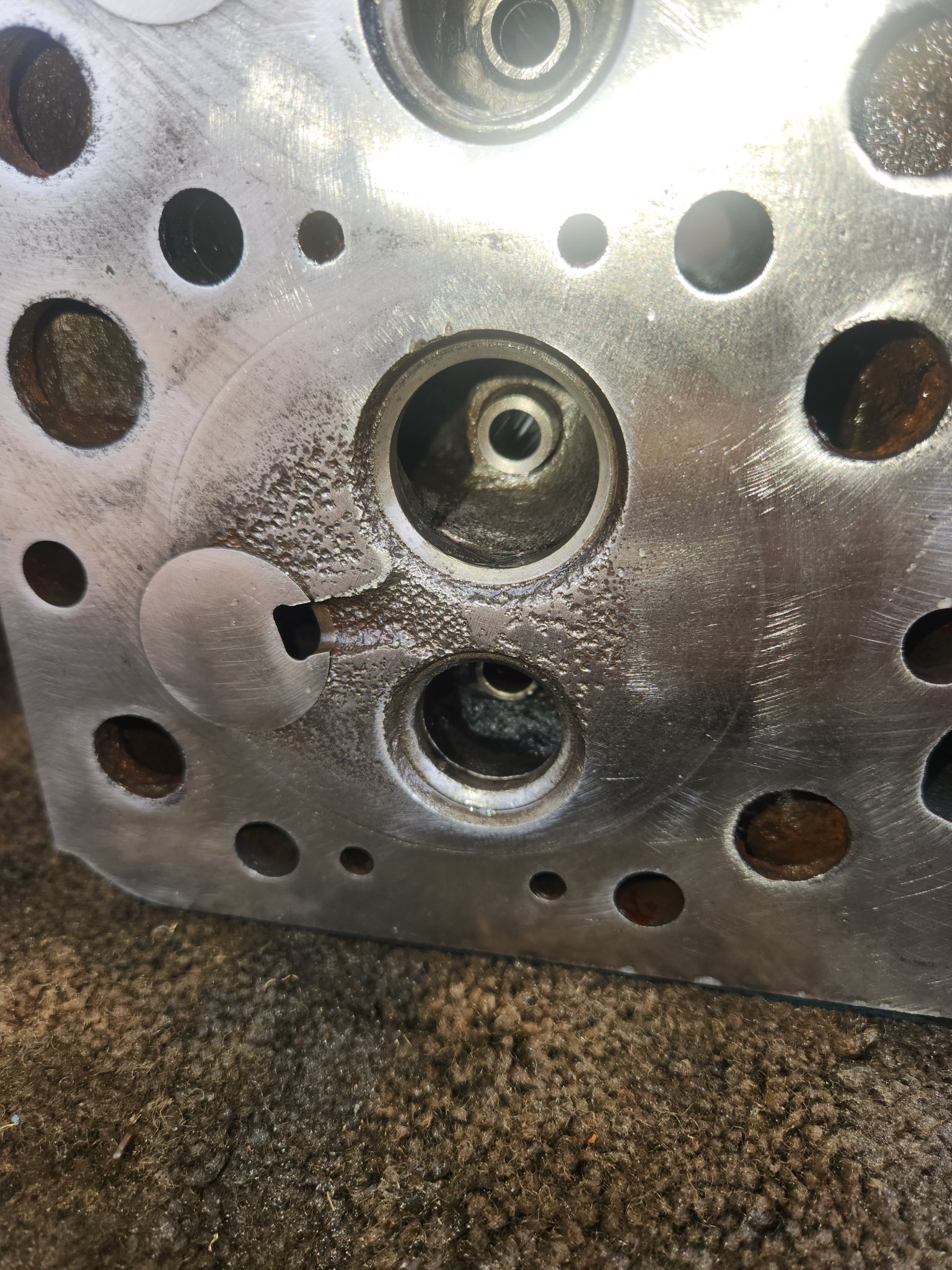

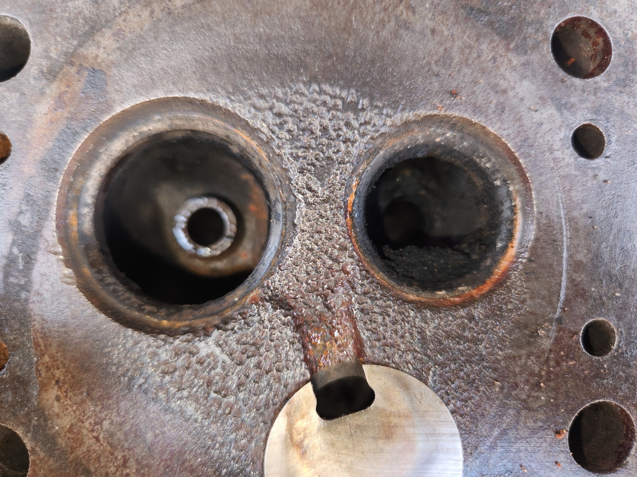

By your picture I see that you also noticed the pitting on the cylinder head. Wonder if that could be caused by coolant getting in.
Otherwise, nice job on cleaning up!

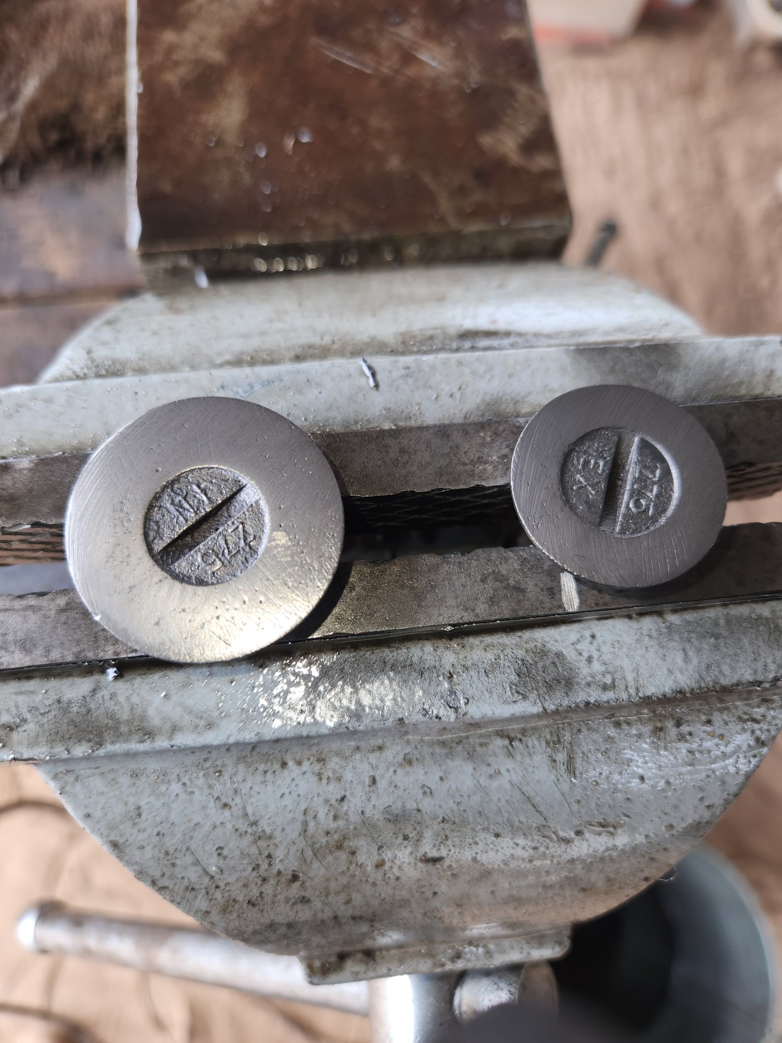

Vlach7
L47 305DT JD500C
Dec 16, 2021
379
272
Frazier Park Ca

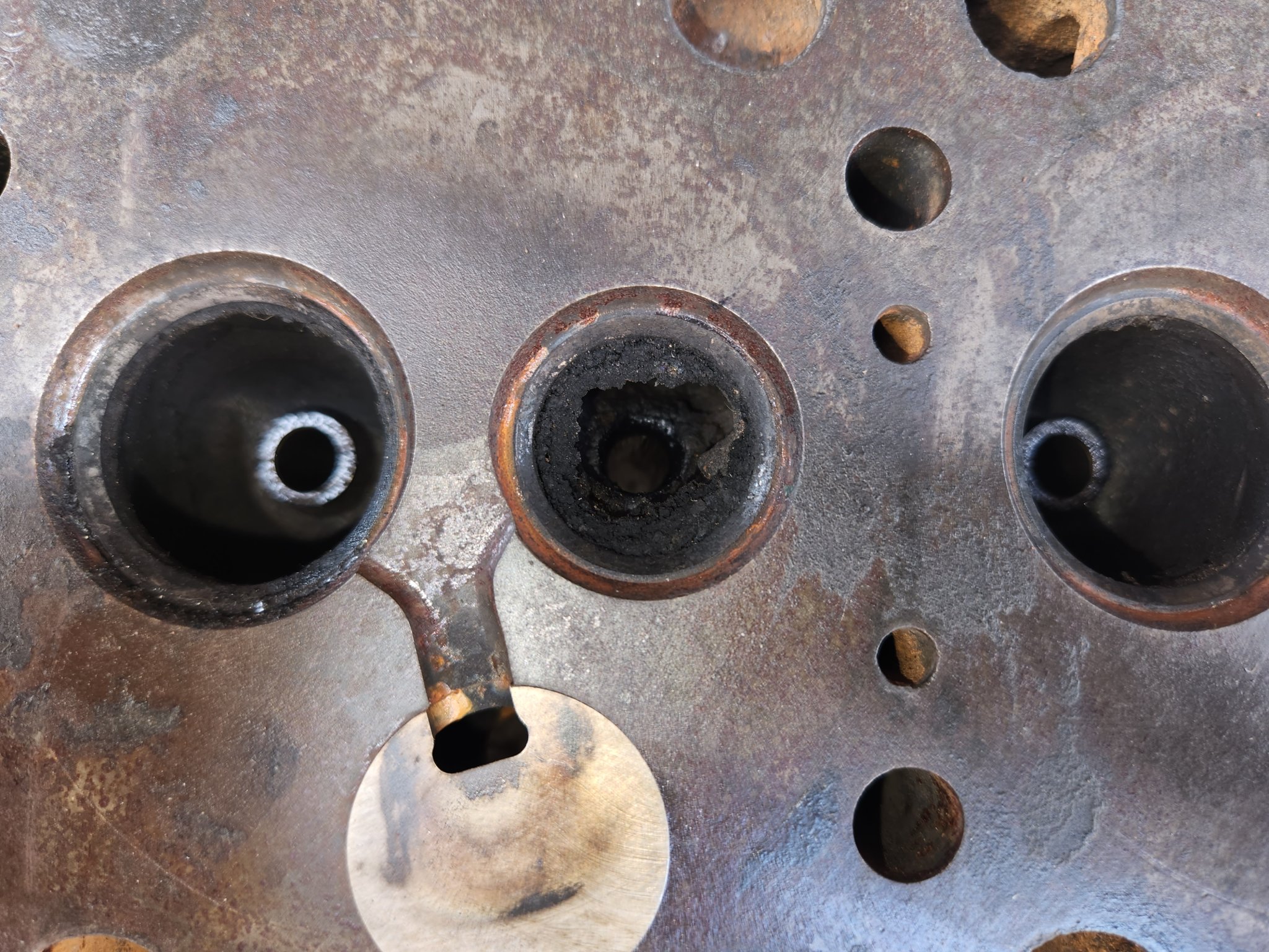

2 of the valves looked different than the others.:unsure:
joesmith123
L295DT, BX1500
Mar 18, 2023
296
140
earth
My theory as to why it pitted: the ports on that rear cylinder were so clogged, it put pressure on the head and separated it from the block
Causing explosion to escape from where they belong, causing the permanent damage to the head
(My theory just on instinct)
Yes, I think explosions were escaping their designated area, and caused permanent damage to those two valves
I still have yet to hit everything with wire wheel, this was just first cleaning to get the big crud
Plan with the pitted head: plane it as good as possible, then get a good gasket, and then see what the pressure test says
I think a good gasket will do the job and I will be hitting the seat of the valves HARD with everything so that valves sit flat
Yes, ktrim said I need press ten pages ago, I need to see how others do it and and emulate them

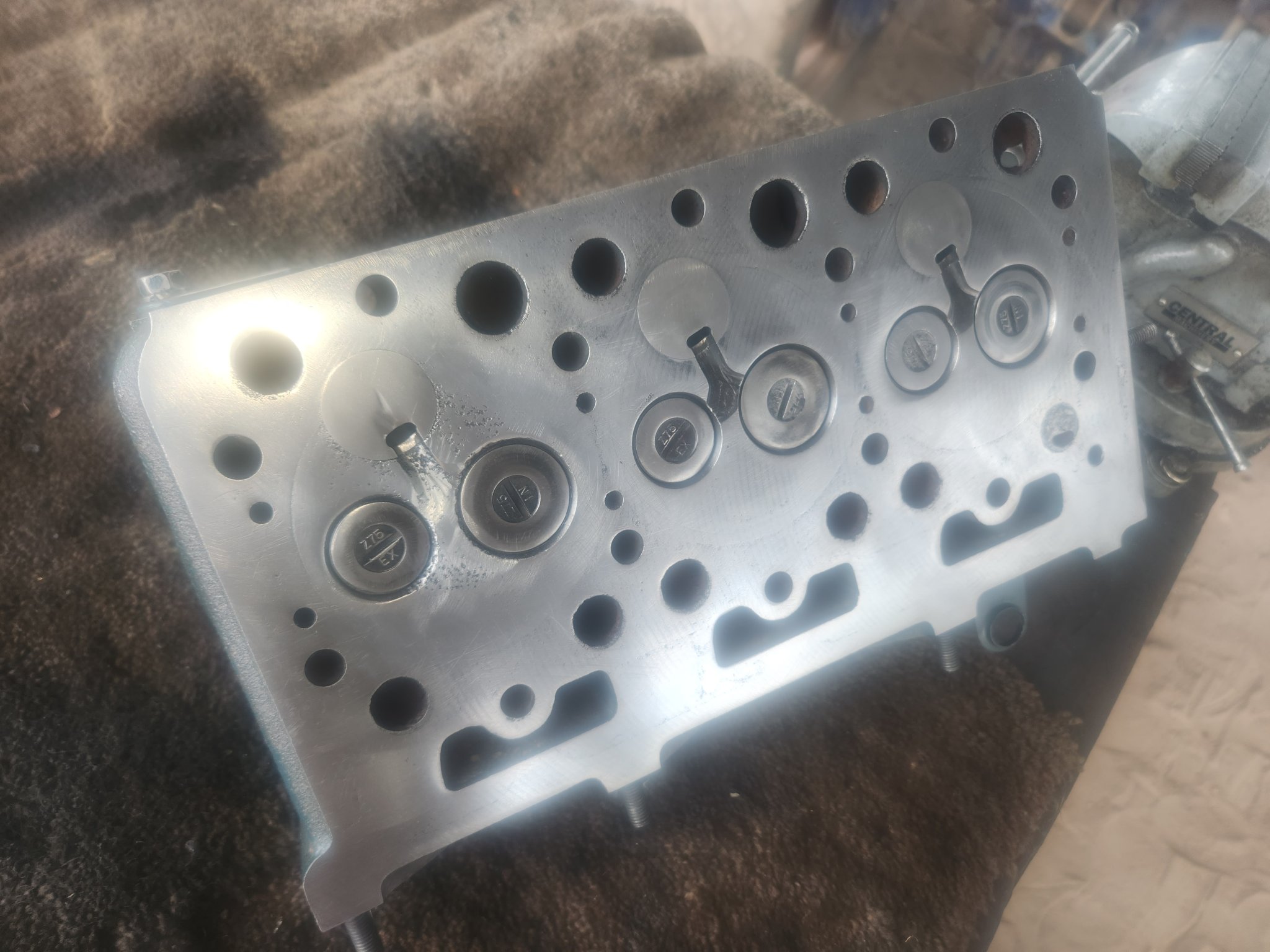

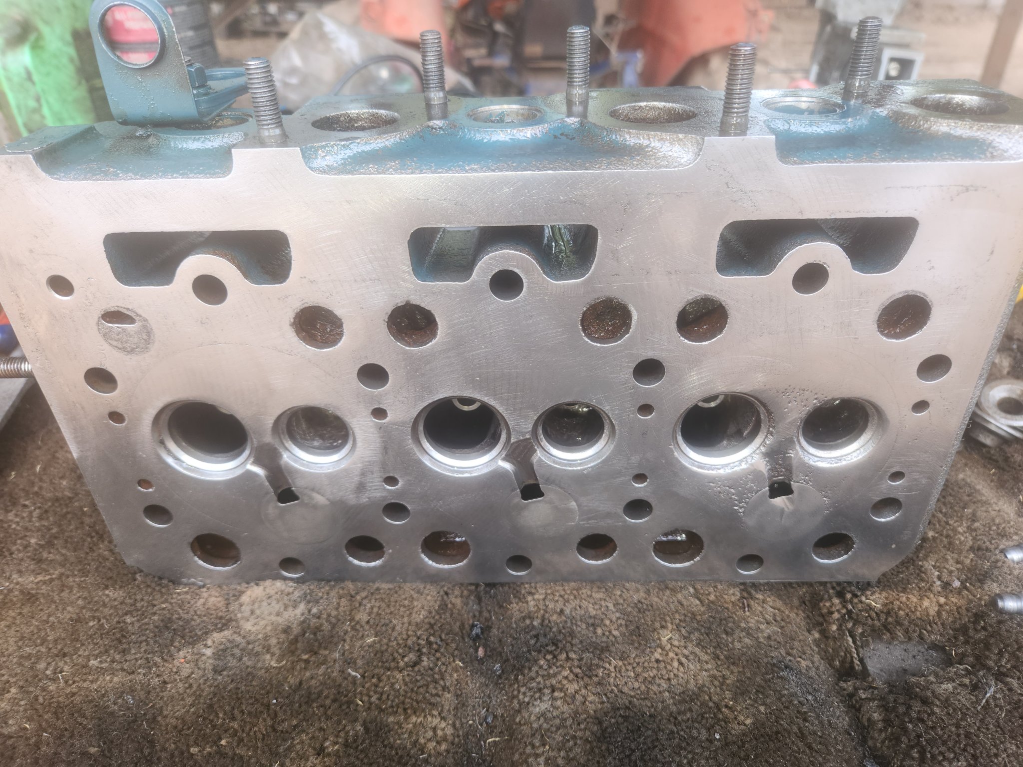

Head gasket lined up, pitted area is in explosion zone of 3rd cylinder

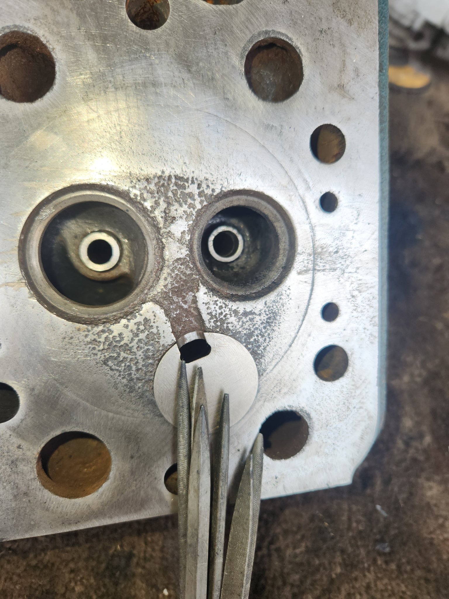

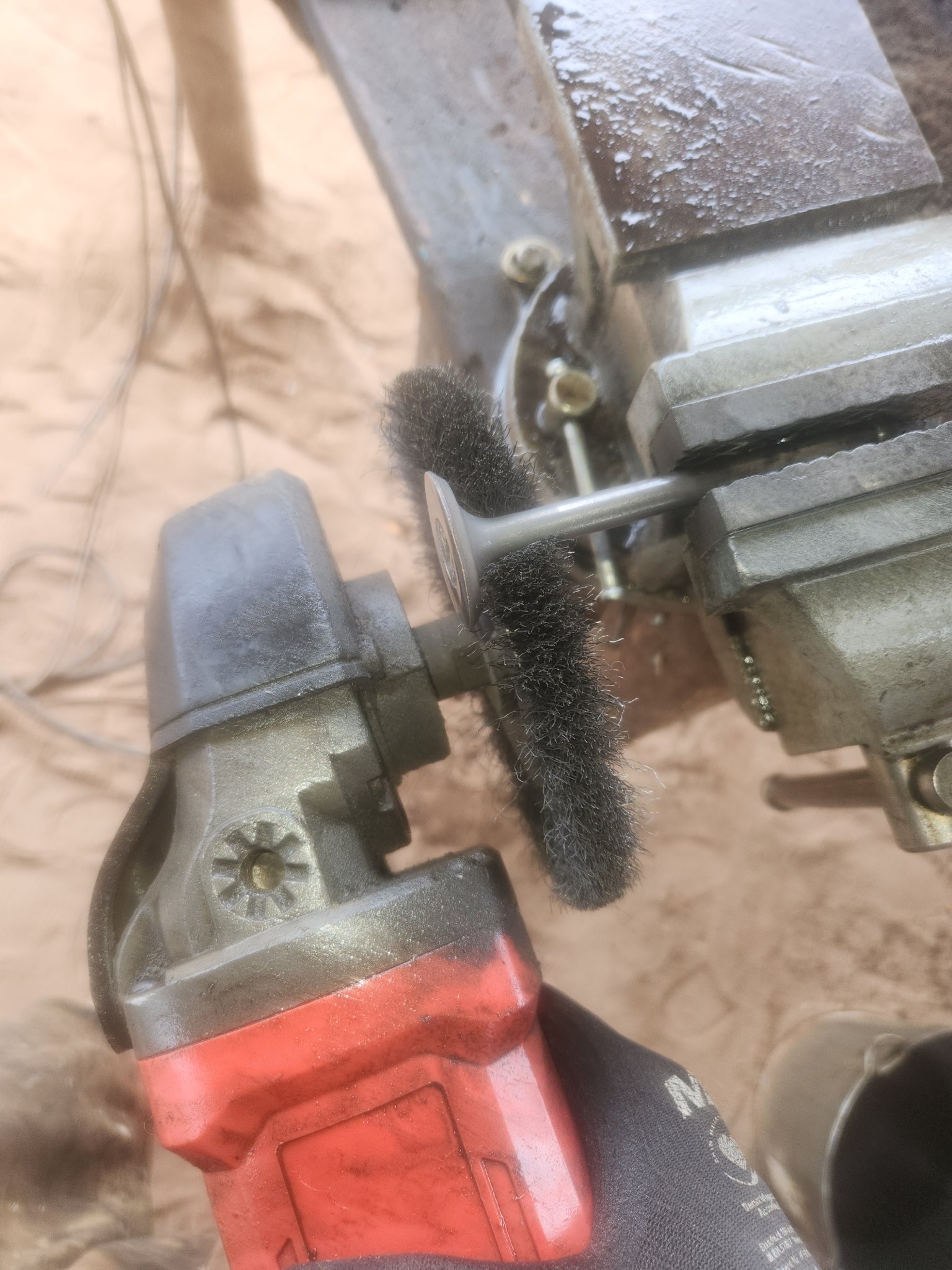

hit pitted area with files and sanding disc, hit head and valves hard with everything
Spent 15 minutes filing the pitted head, especially the port

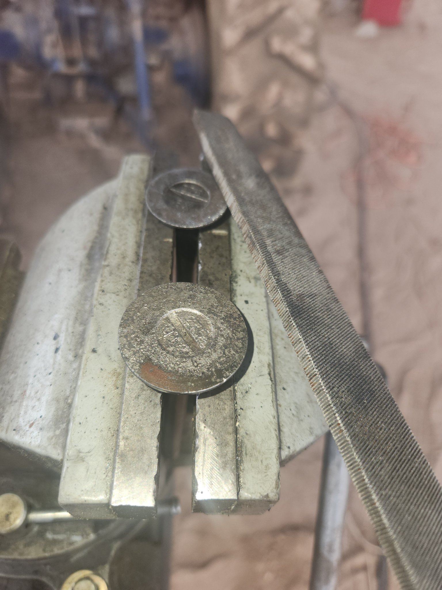

Used Dremel, files to smooth out valve seat
Hit each valve on vice hard with fast wire wheel, and top of head with sanding disc on angle grinder, it should burn hand when taken off vice
Hit whole head with fast wire wheel
Now: put head back together

re: stuck hinge pin
try putting it in a bucket of 'oil' for a week, in the hot sun if possible.
let TIME move the oil into all the nooks and crannies.
then try tapping the pin back and forth
when it moves keep going back and forth, maybe add oil
You want to go back and forth NOT bang from ONE side only.
patience and a plan......
View attachment 136870 View attachment 136871 View attachment 136872 View attachment 136873 View attachment 136874 View attachment 136875 View attachment 136876 View attachment 136877 View attachment 136878 View attachment 136879

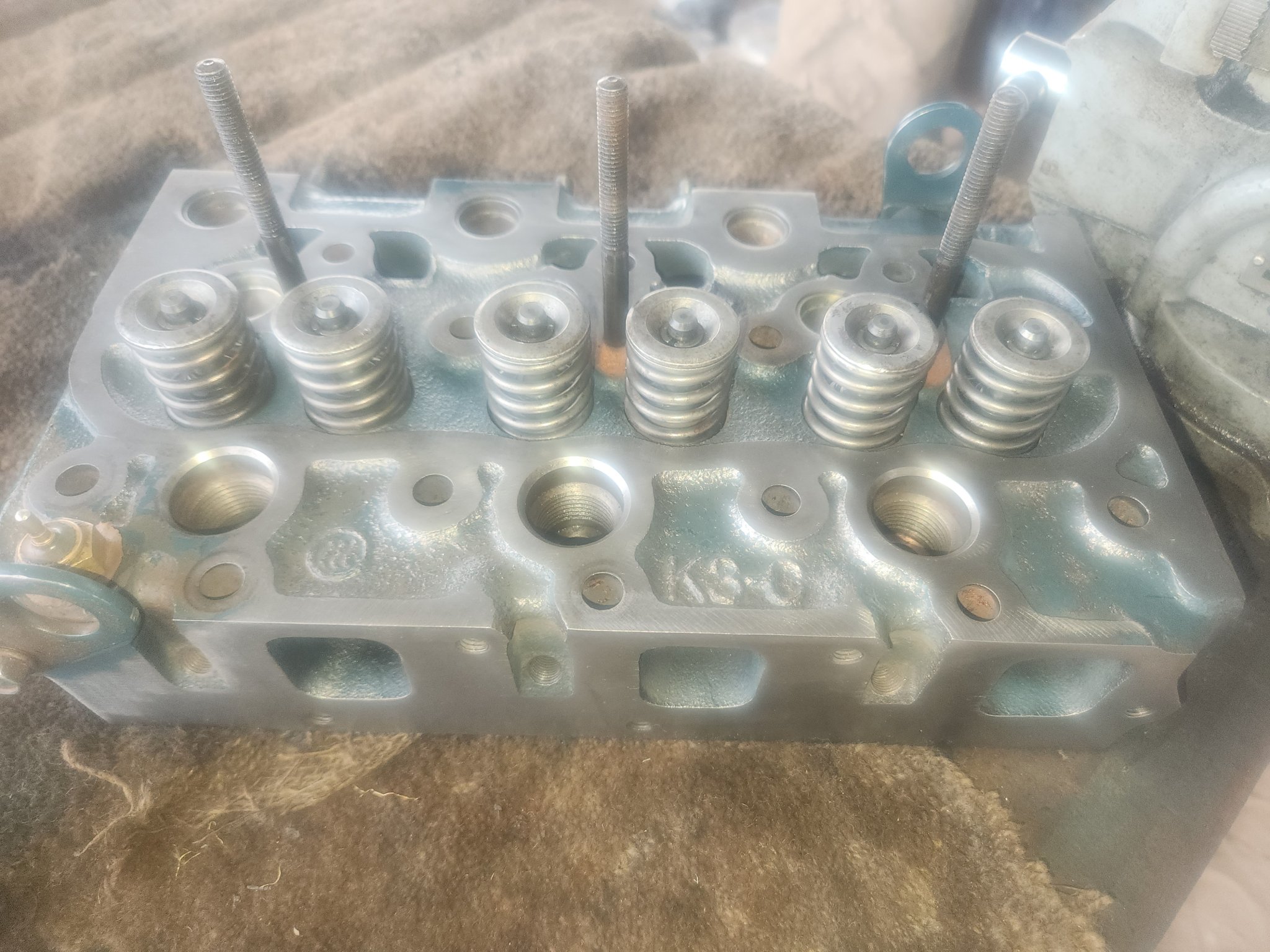

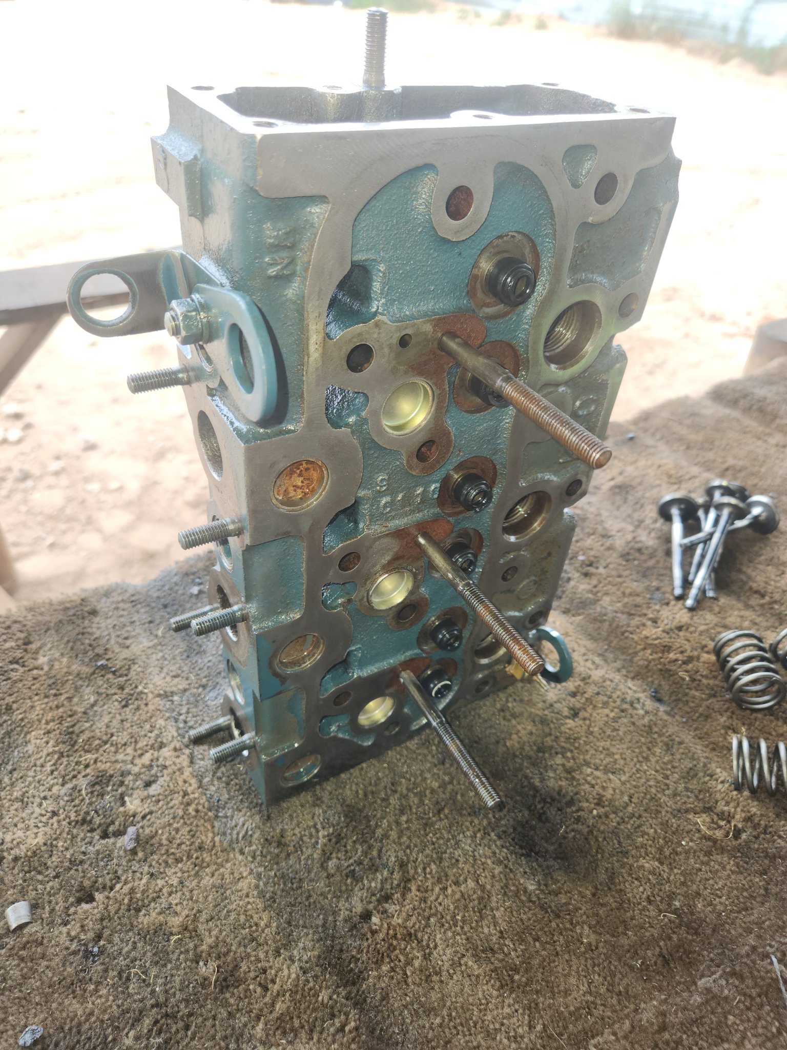

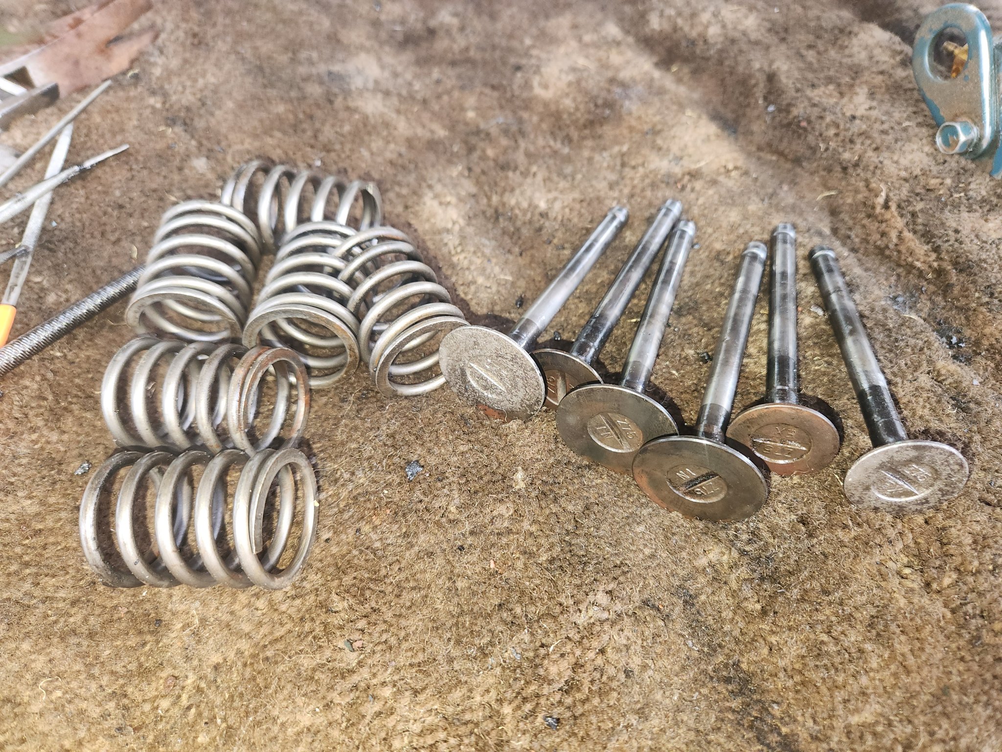

Put head back together using tie rod tool and needle nose
Exact way to put in holders on spring: left hand pushing spring down with tie rod tool, right hand using needlenose to get it in place then push down
Fastest I've ever put them back on
Other pictures: finished product, notice the pitting a bit better
Up close of pitted area after hit with everything imaginable

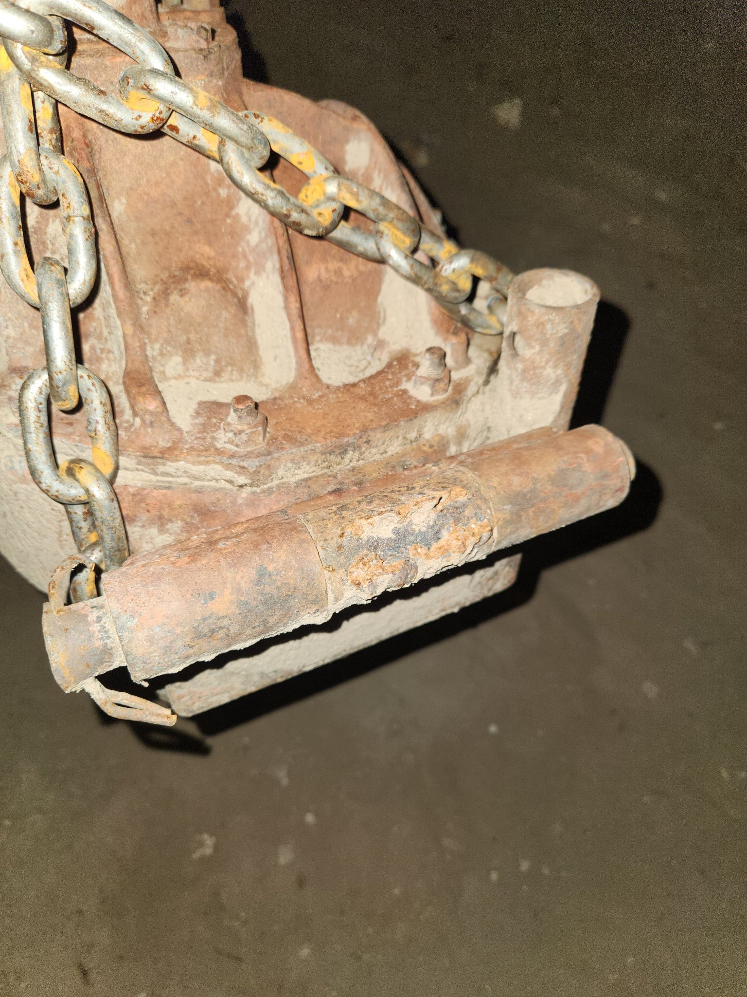

re: stuck hinge pin
Yes, soon I go pick up auger using chain and 3 point hitch on bx1500 and bring to work area
Problem: hinge attached to massive auger, I cannot just take the hinge and put in oil

Hit that hinge hard with everything you have and if that doesn't loosen it,hit it again and again until it's loose.

Joe, you need to get some valve lapping compound and a valve lapping stick to lap in the valves. This is the way you can check the sealing area on the valves and the valve seats to see if there are any issues. You put the grinding compound on the valve sealing area and rotate the valve back + forth on the seat with the tool. If there are any issues with the sealing area you will be able to see them.

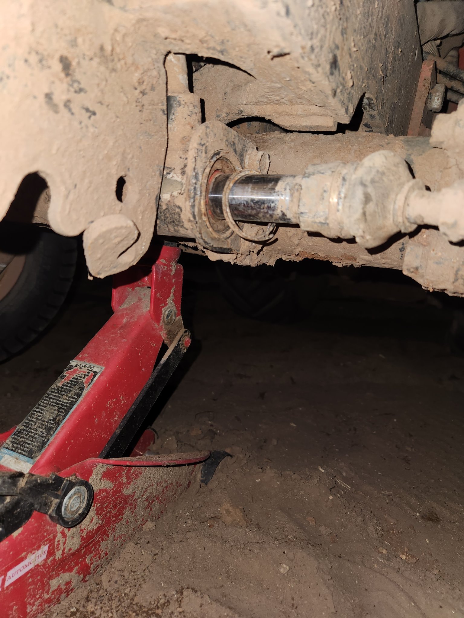

Fixed bent bracket on bx1500, then brought auger to get it working
Steering bracket keeps bending on bx1500
Raise machined, hit it with sledgehammer, watch your fingers

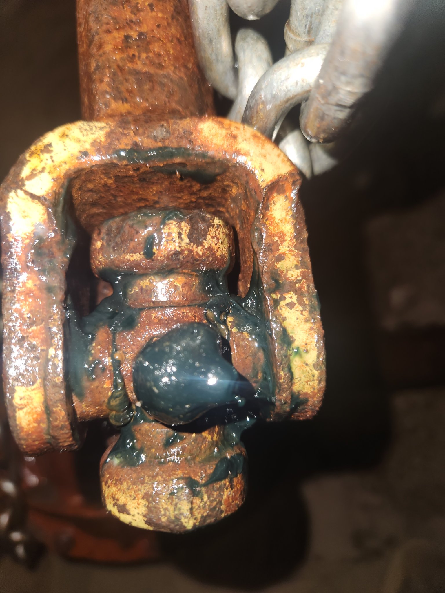

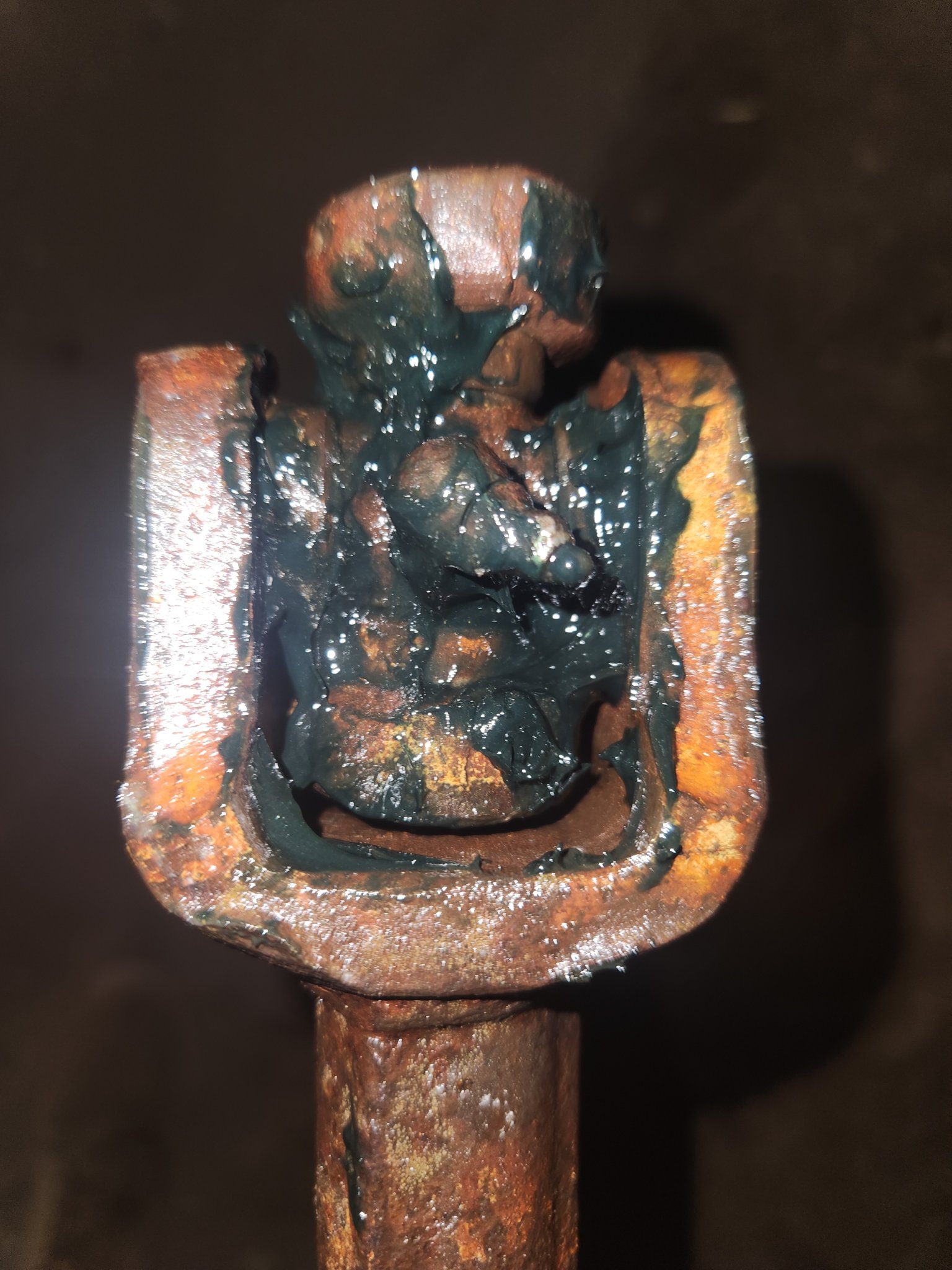

Up close of stuck hinge on auger

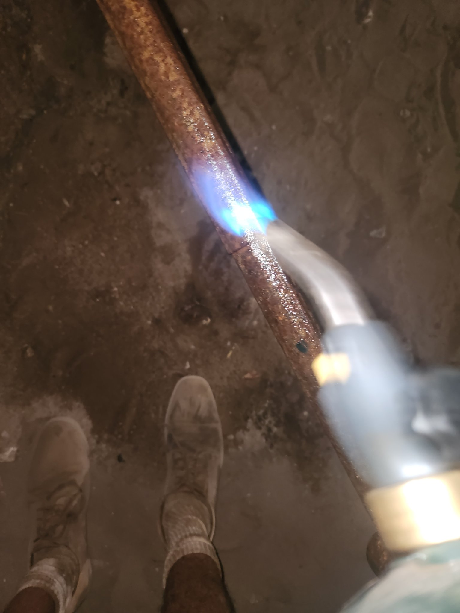

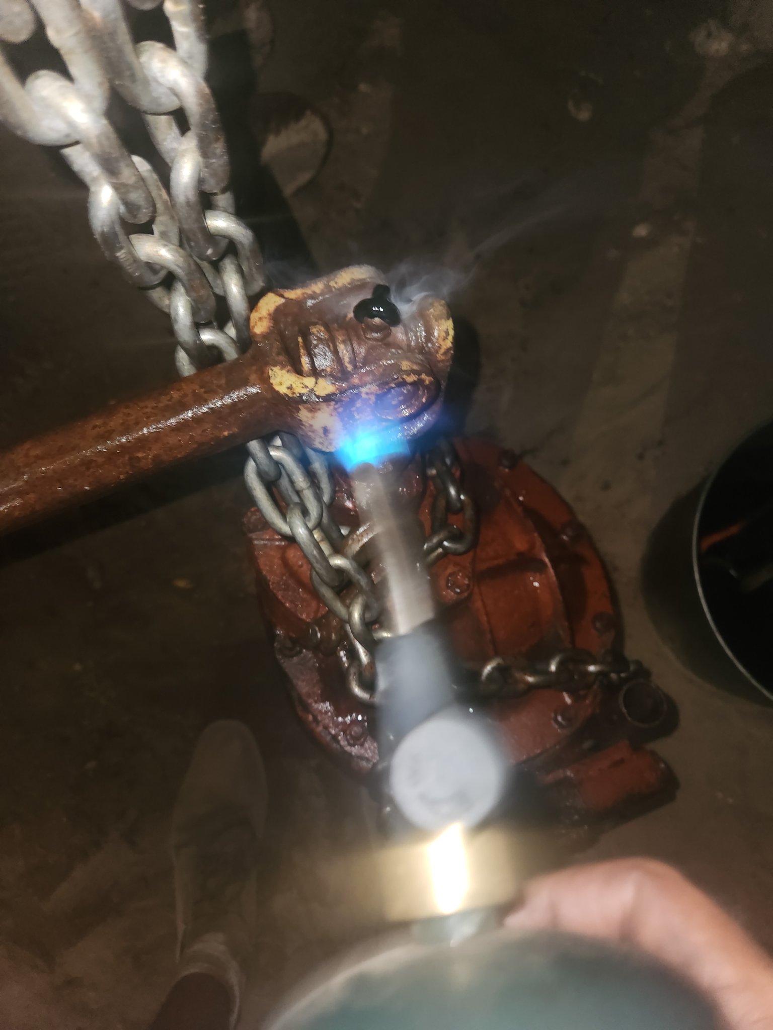

Plan: spray with diesel, hit with torch hard, hammer each side trying to unseize it, get grease into the grease pins

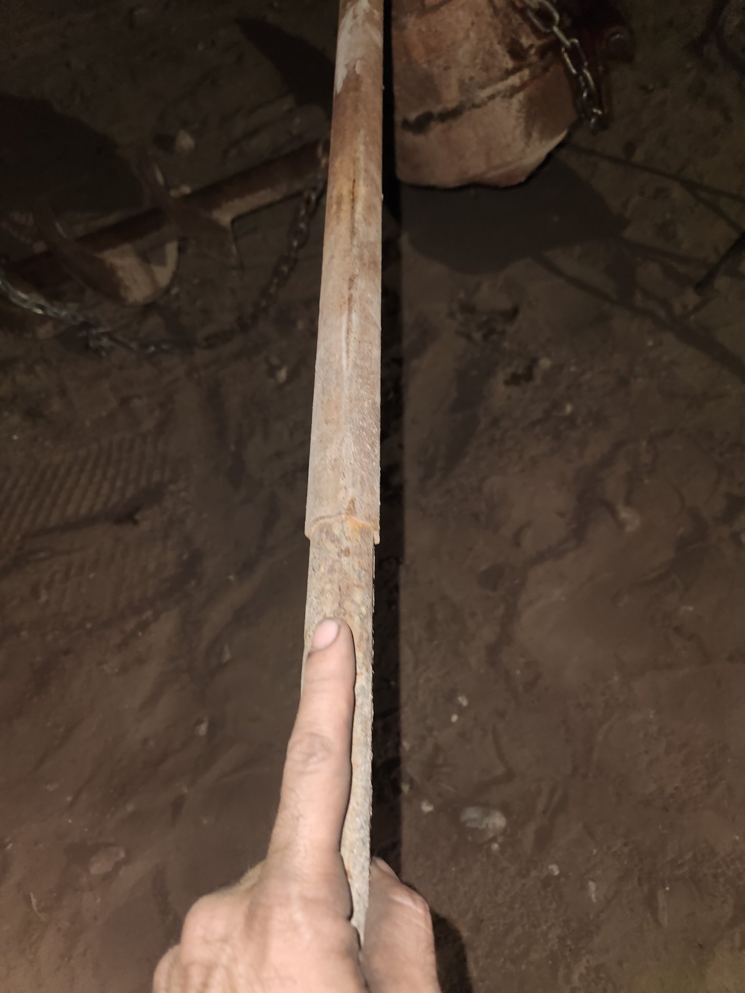

I point: shaft that slides as auger go up and down, spins from tractor to auger
Problem: shaft seized
Plan: hit with diesel, clamp stuff on them then hit them with hammers, and torch of course

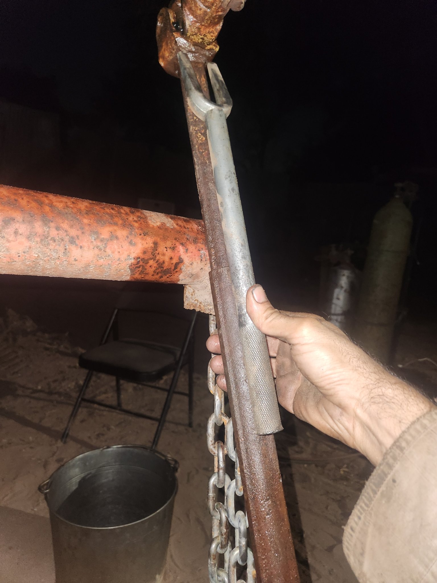

Soaked with diesel, hit with compressed air, grease pins not taking grease, hit with torch
Both pins accepted grease: sprayed them with diesel, went with pik and opened the port, hit with torch, then sledgehammer, solved
Hit seized sliding rod with diesel then torch, entire area
Using tie rod tool to strike up using sledgehammer, tried both ways, won't budge
Now: leave it alone, try to unseize main big hinge
Ktrim
B2400, lA352 loader,3pth quick hitch/z122r zero turn/restored 52 farmall super a
Dec 23, 2020
444
369
Nazareth Pa
Propane not gonna get hot enough. Use your oxy
