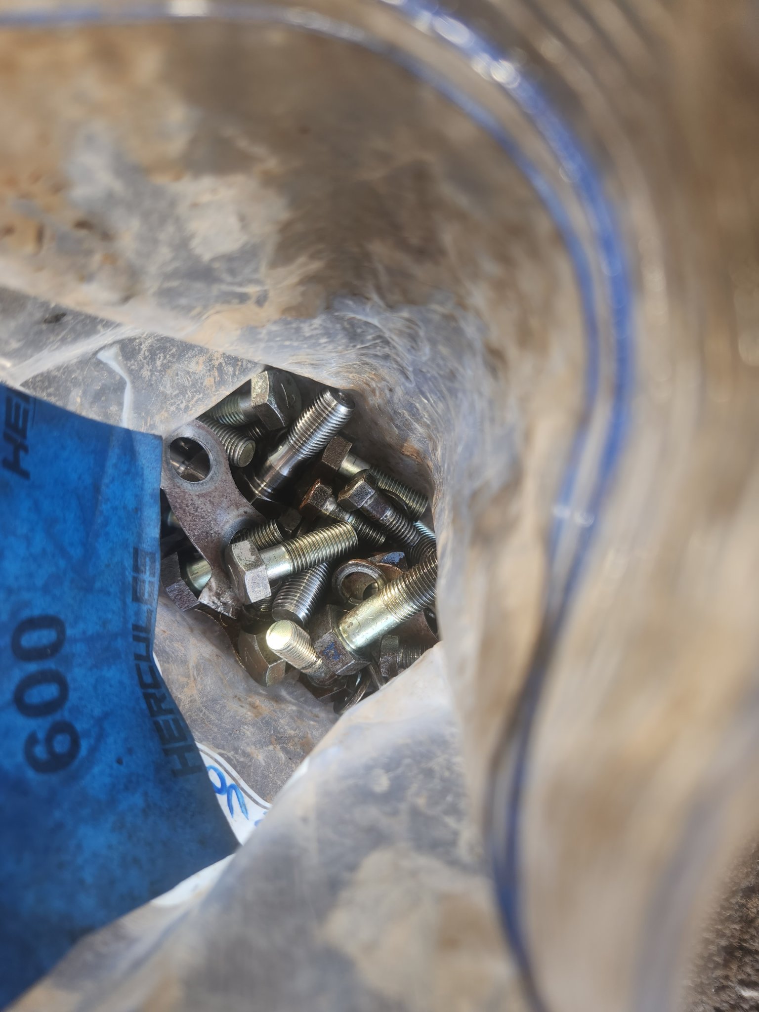

All bolts hit with wire wheel in bucket of diesel

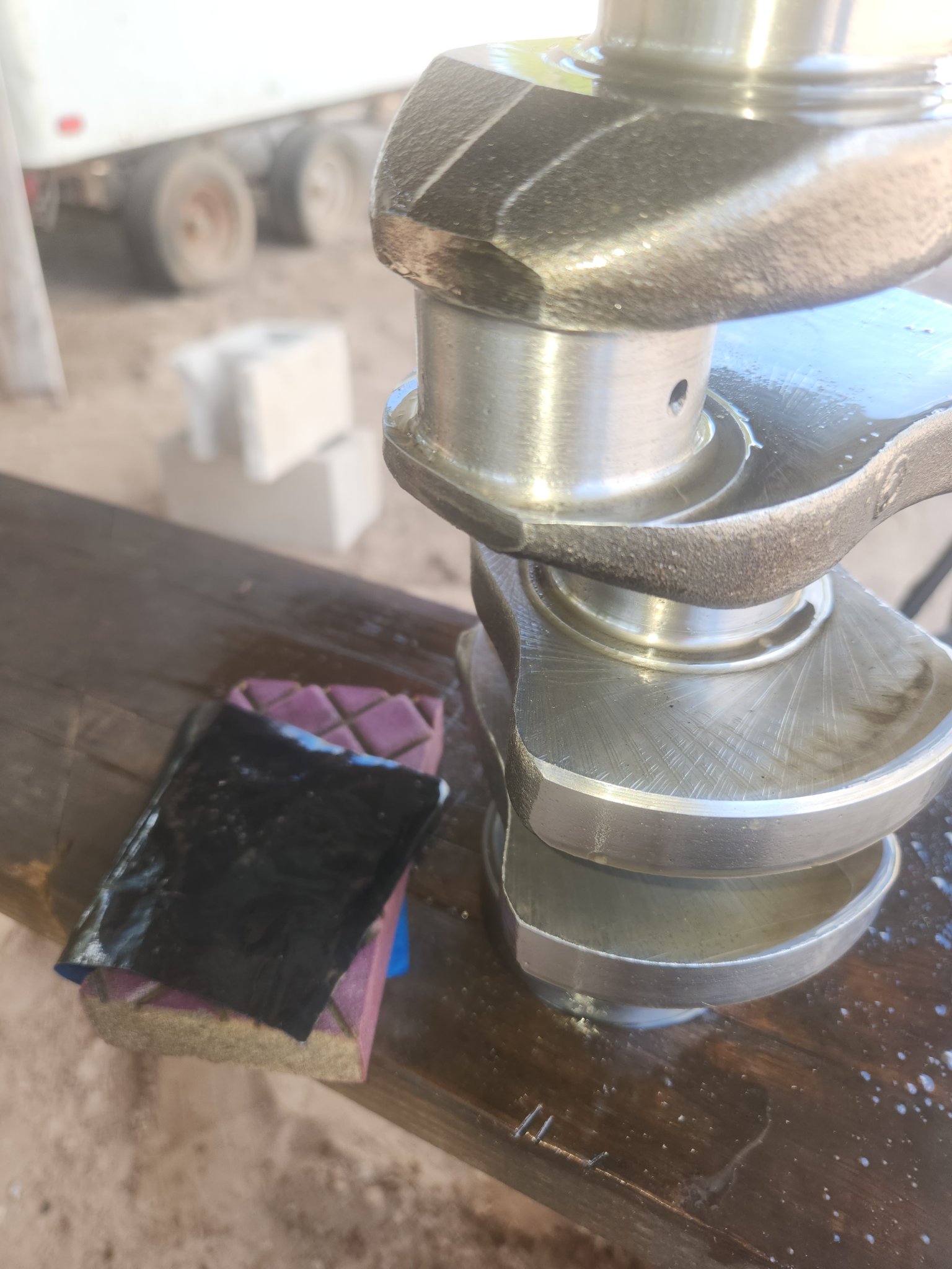

Spent 30 minutes wet sanding the journal that threw the rod, its not as smooth as the other journals, but good enough

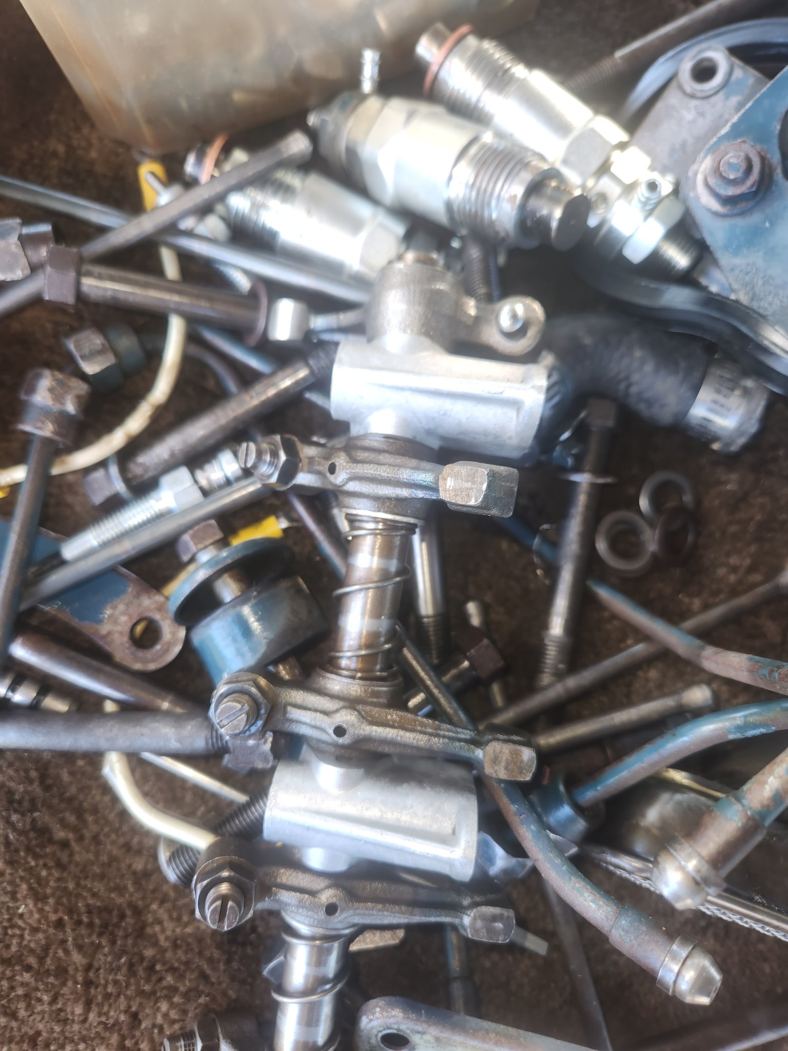

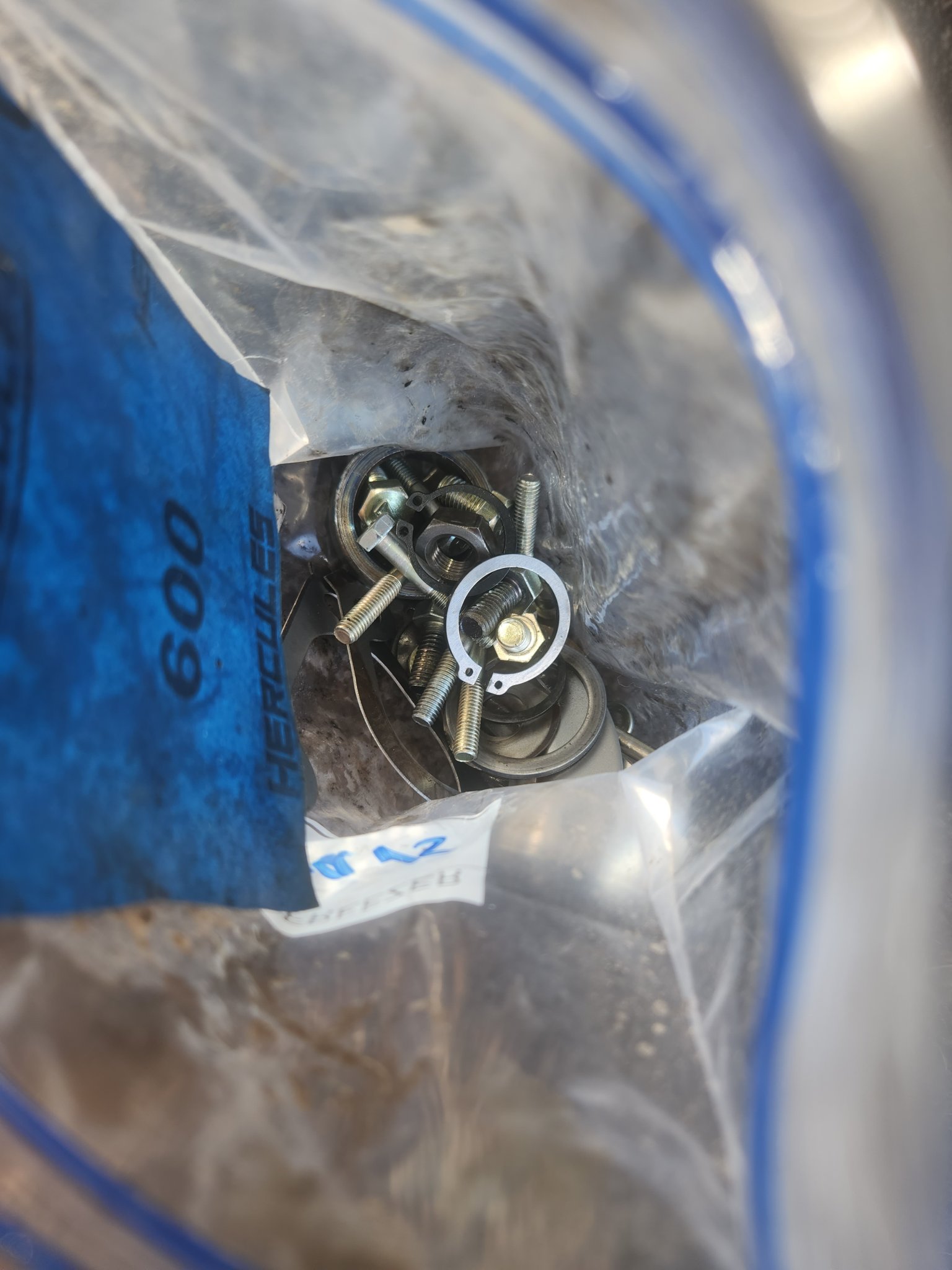

All bolts are in sections of where they come from, the bags are lableled: gears, crankcase, engine to tractor, bell housing all together with their hardware
What you see is all the bolts for the rebuild cleaned
dump one section in diesel bucket, hit it with wire wheel on drill, spinning the diesel, take them all out, put them on the table together, did this task to all bolts
Video: a section of bolts being hit with wire wheel in bucket of diesel, do not worry about the details, keep them together in areas they belong in sections as you took them out

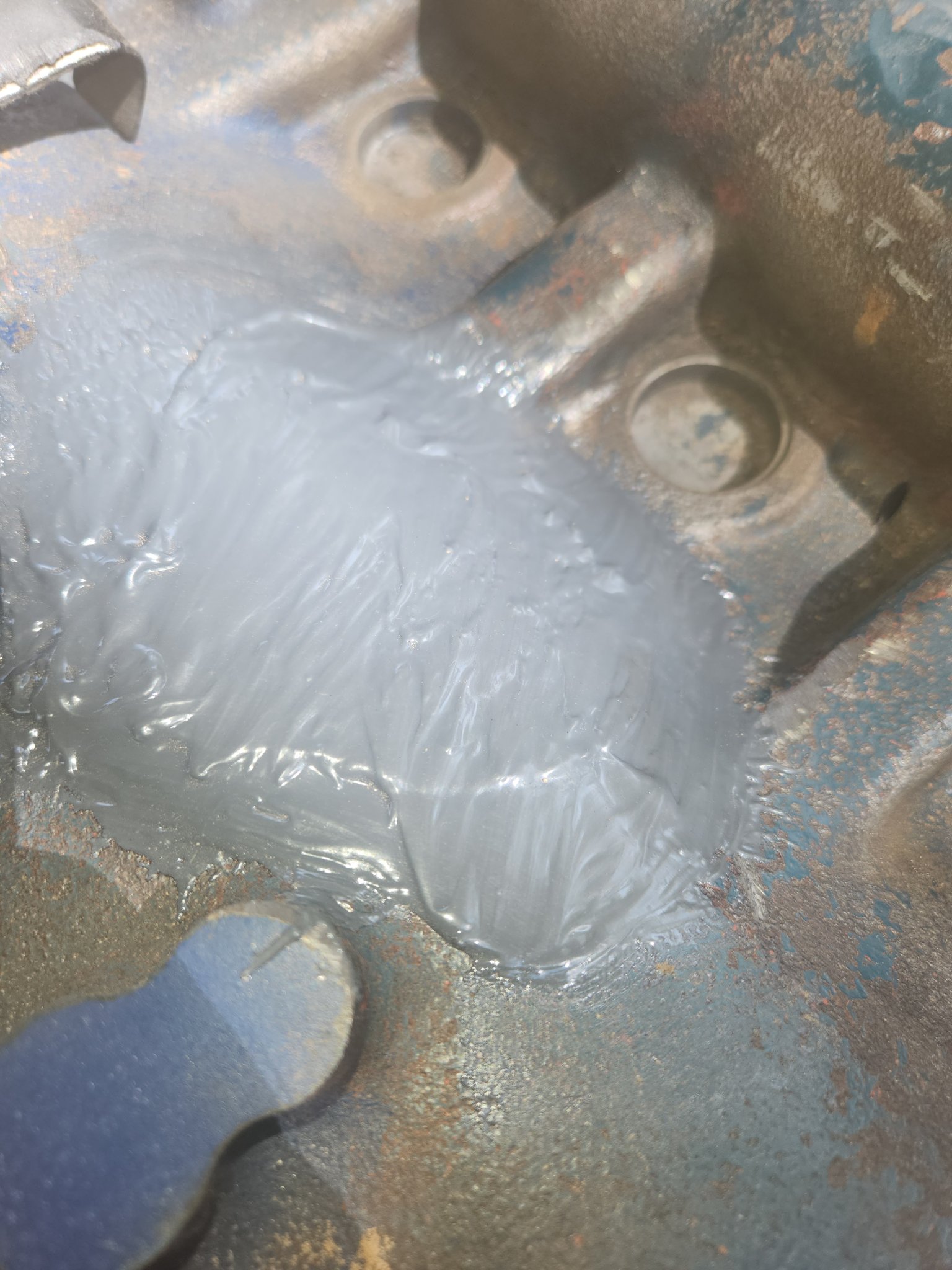

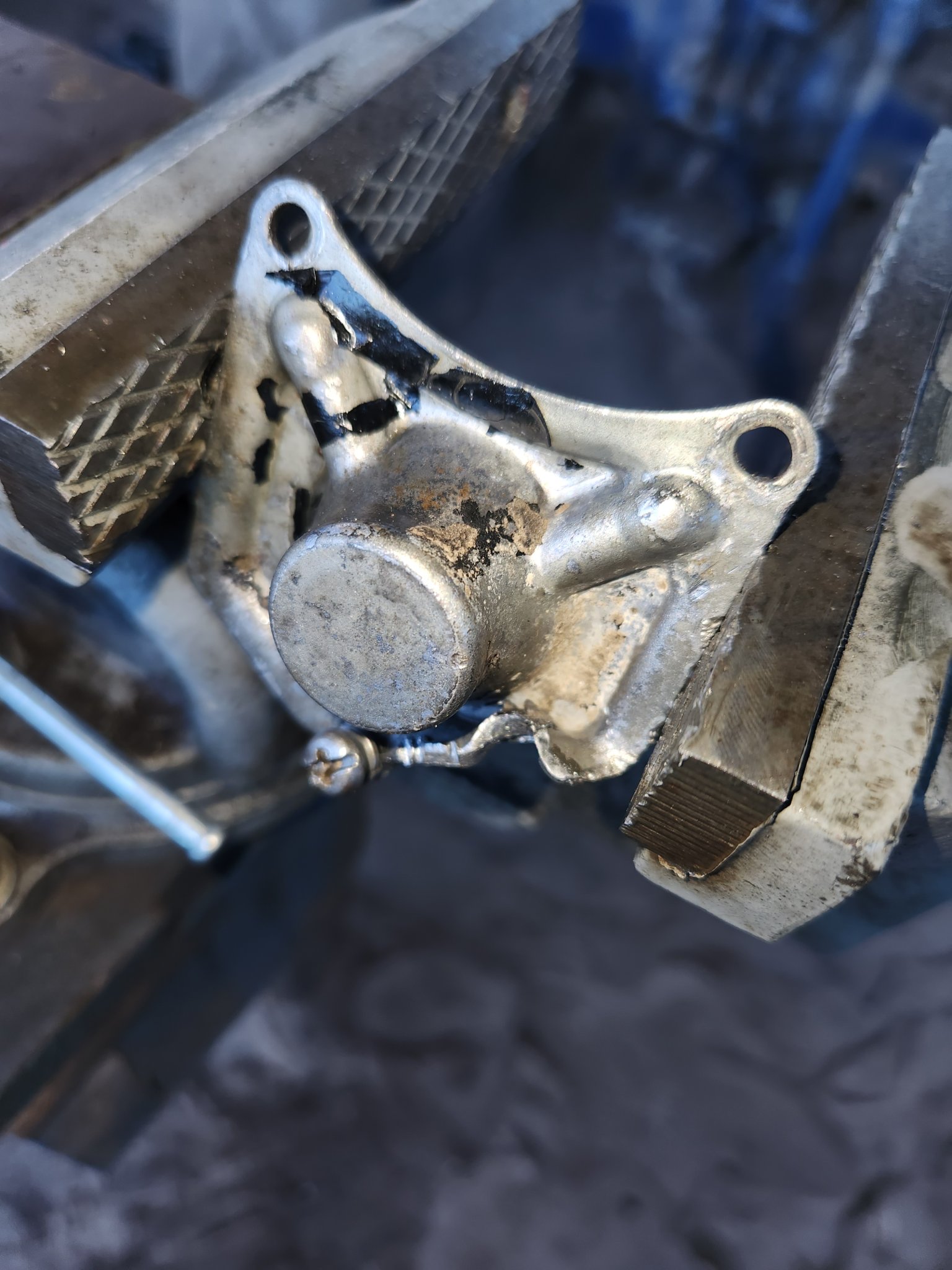

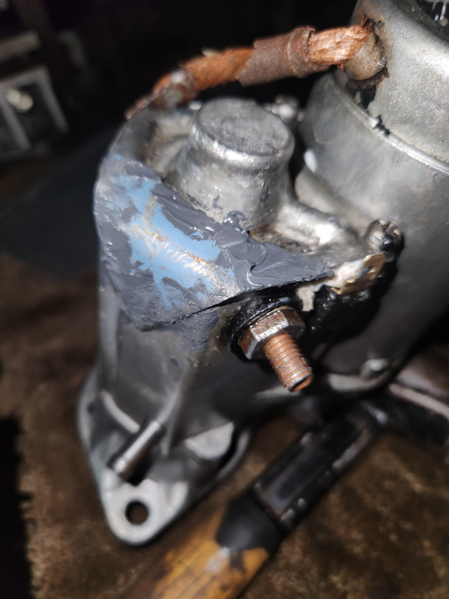

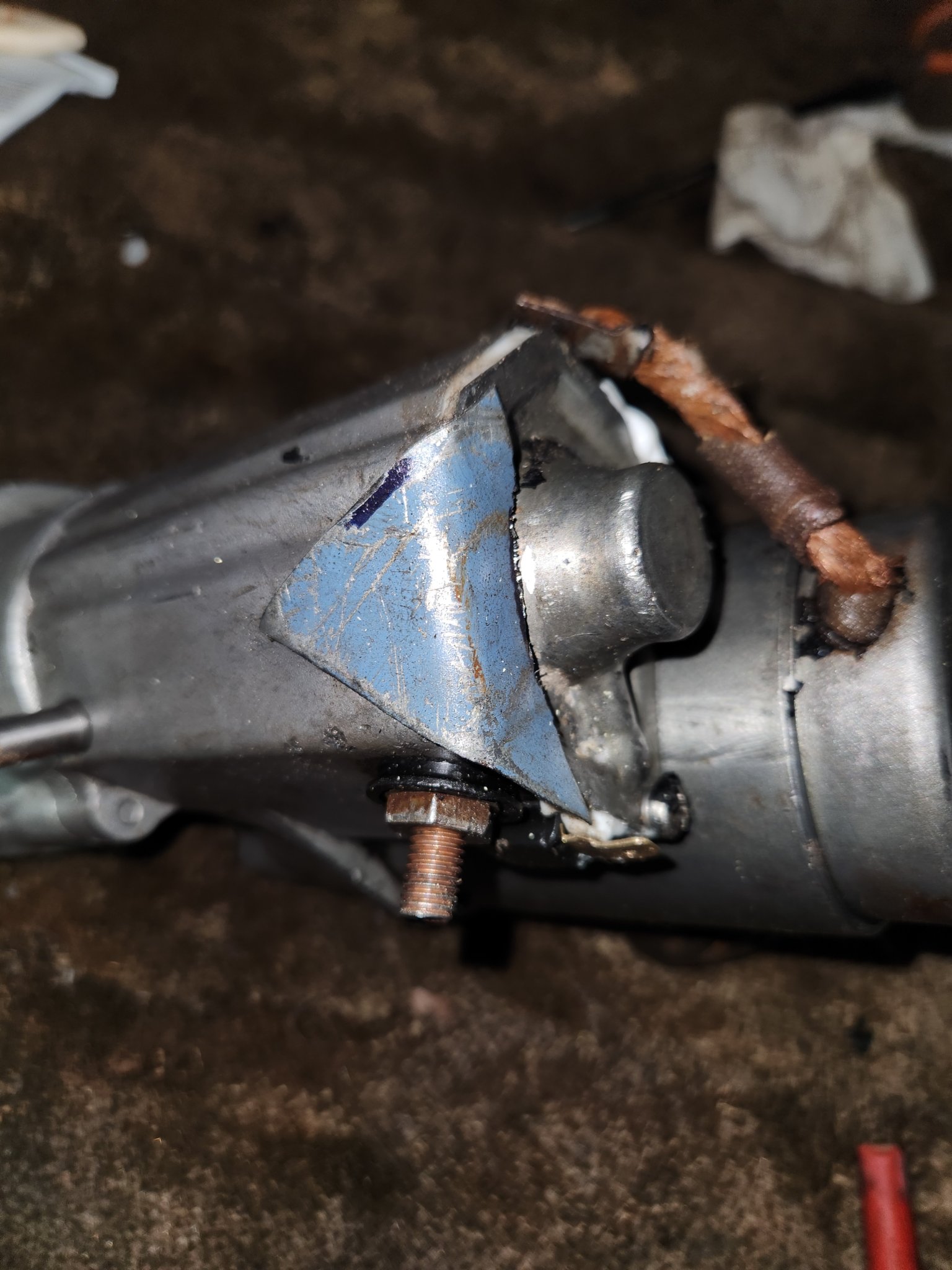

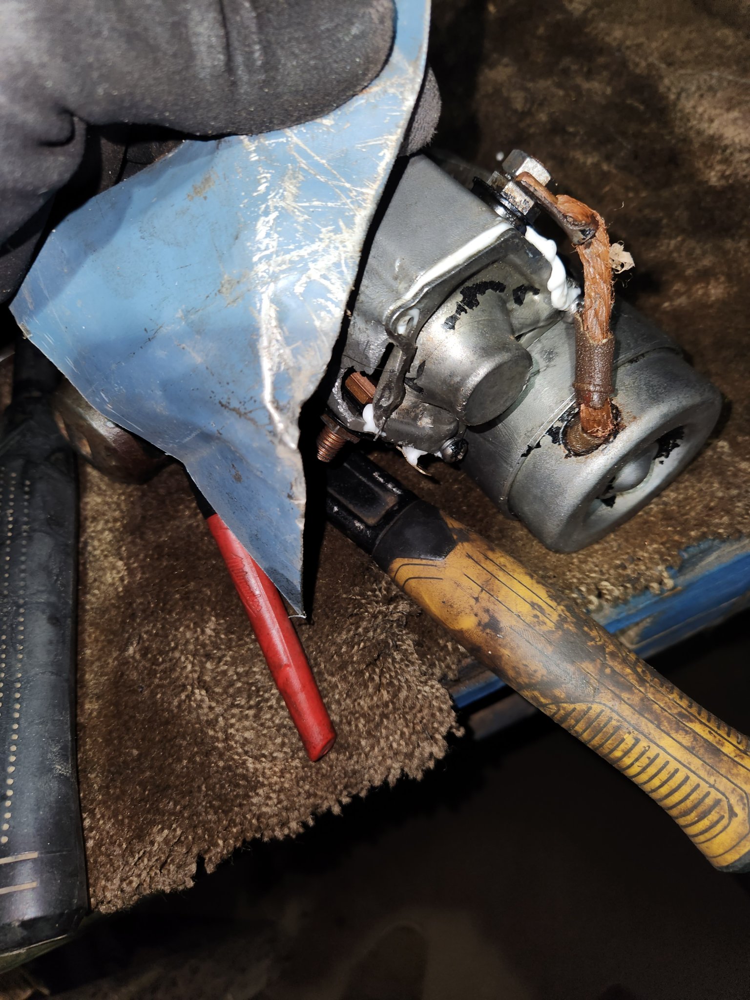

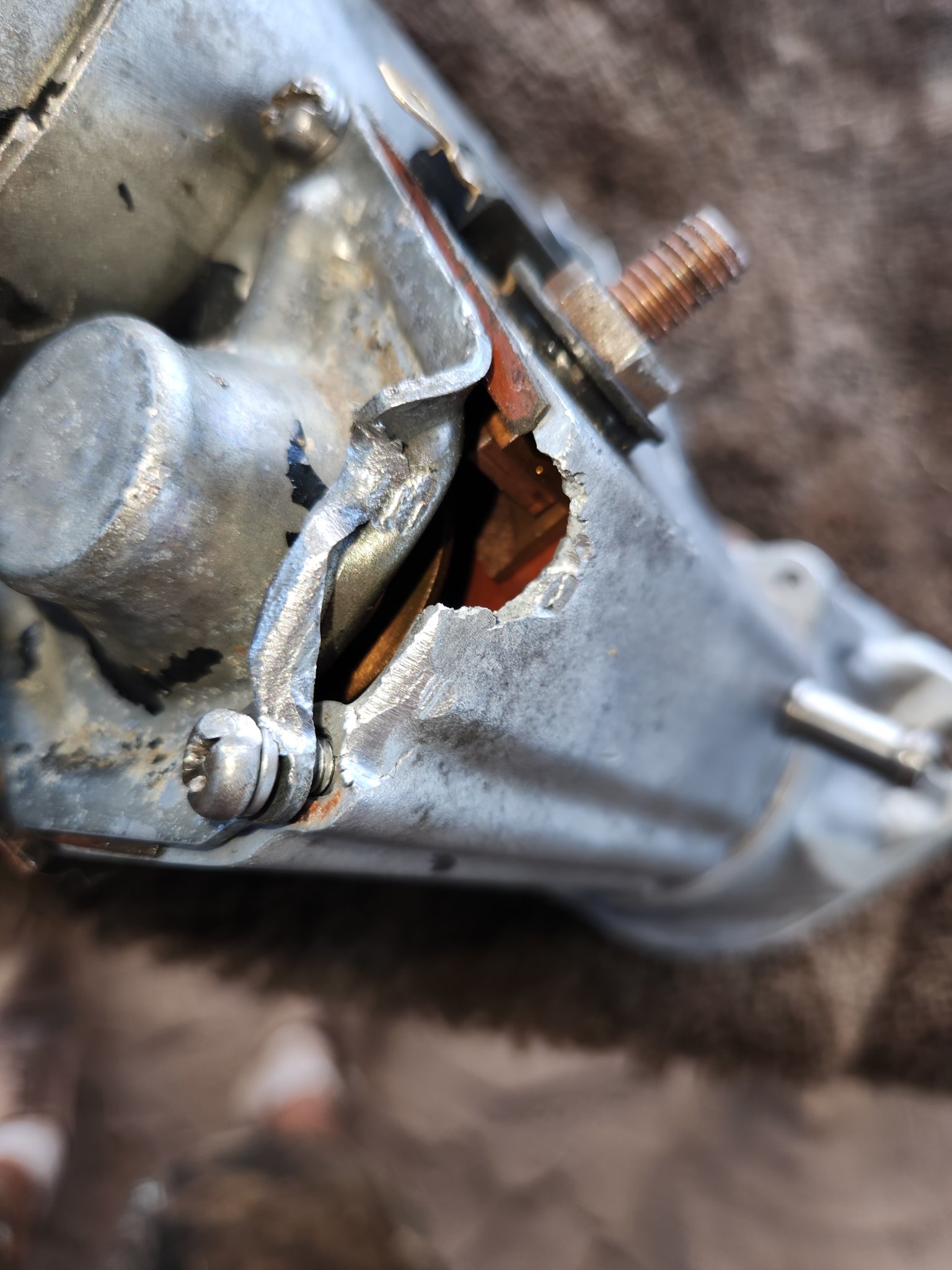

Starter damage, bend metal back and jb weld patch
Removed cap on starter, tried to bend the metal with chisels, couldnt
Cut damaged with cutting wheel
Hit area of damage with file, then compressed air, then cleaned entire area and sprayed diesel, cleaned inside of starter, hit it with compressed air
Made a gasket for the cover, put the two remaining screws and put it back on starter
Cut random piece of metal roof, bent it the shape of the damage, used sharpies to label where to grind, shaped it to the damaged area
cleaned everything with alcohol, put gloves on, mixed jb weld, caked onto patch, put patch onto starter, used spatula to evenly distribute

That patch forming was fantastic.
My comment was based on that and it looks better than some people's work with many years of practice rather than a first attempt.

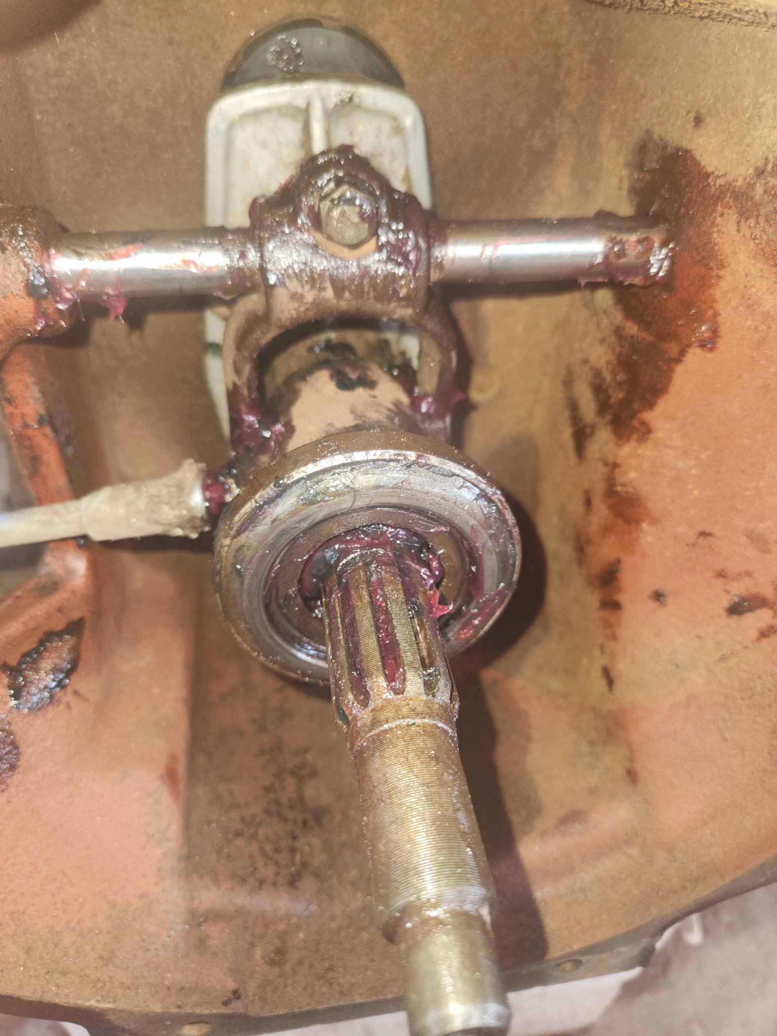

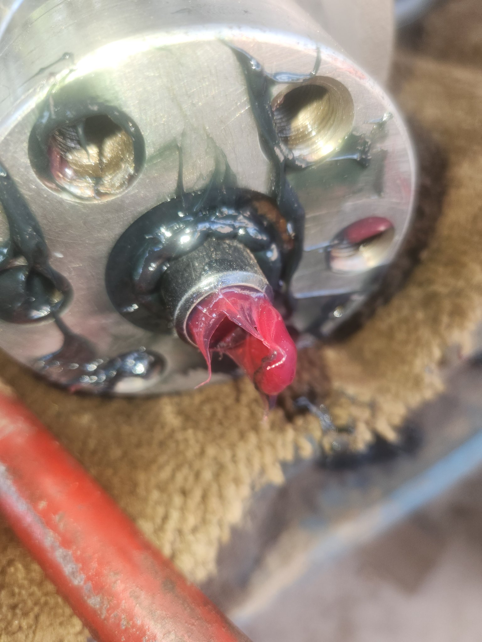

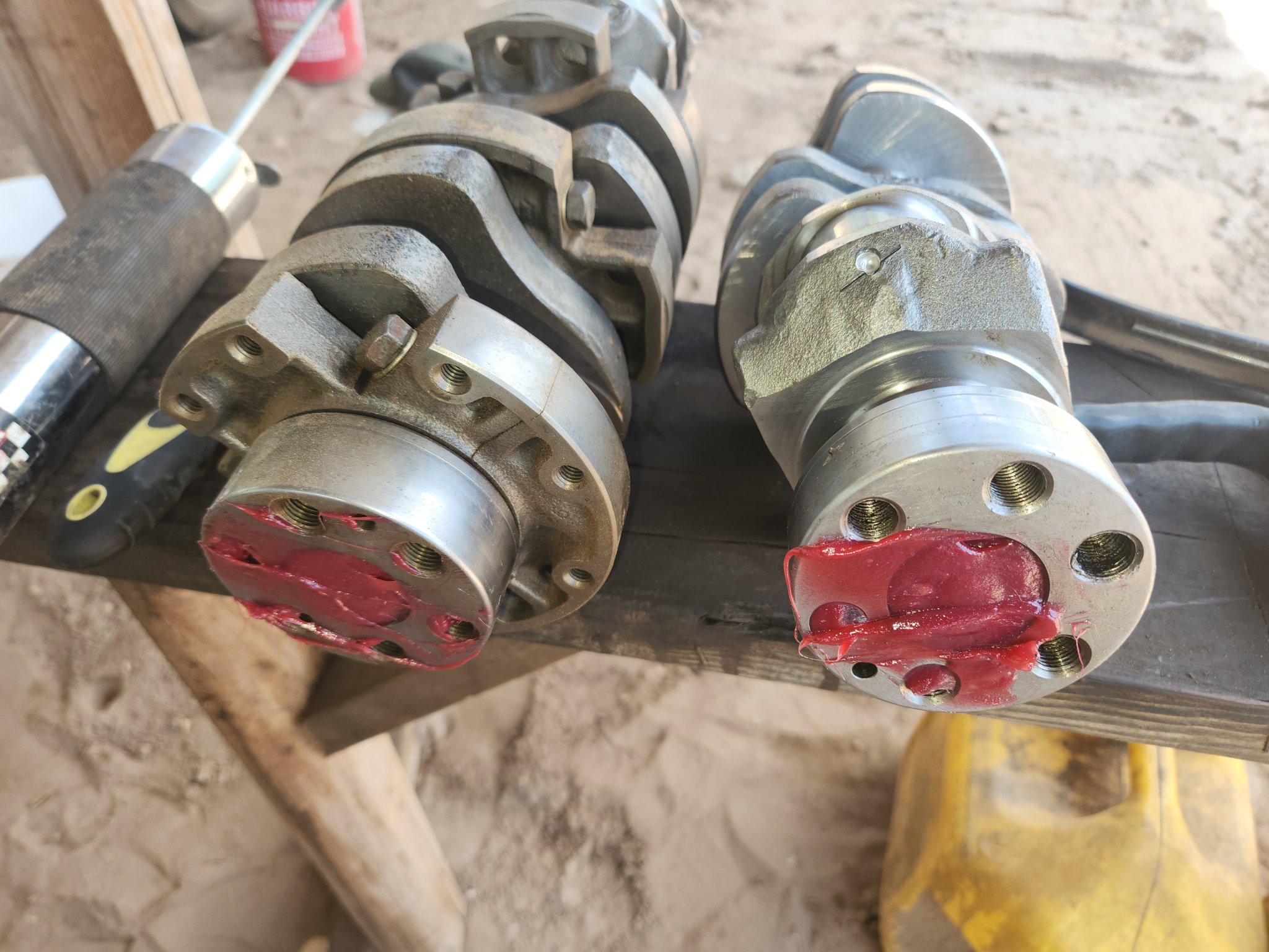

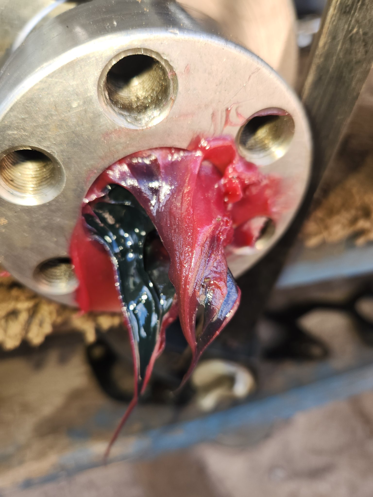

ok yes I read yalls statements about taking out that bearing, I get back to shop and pump grease into it and see if it comes out

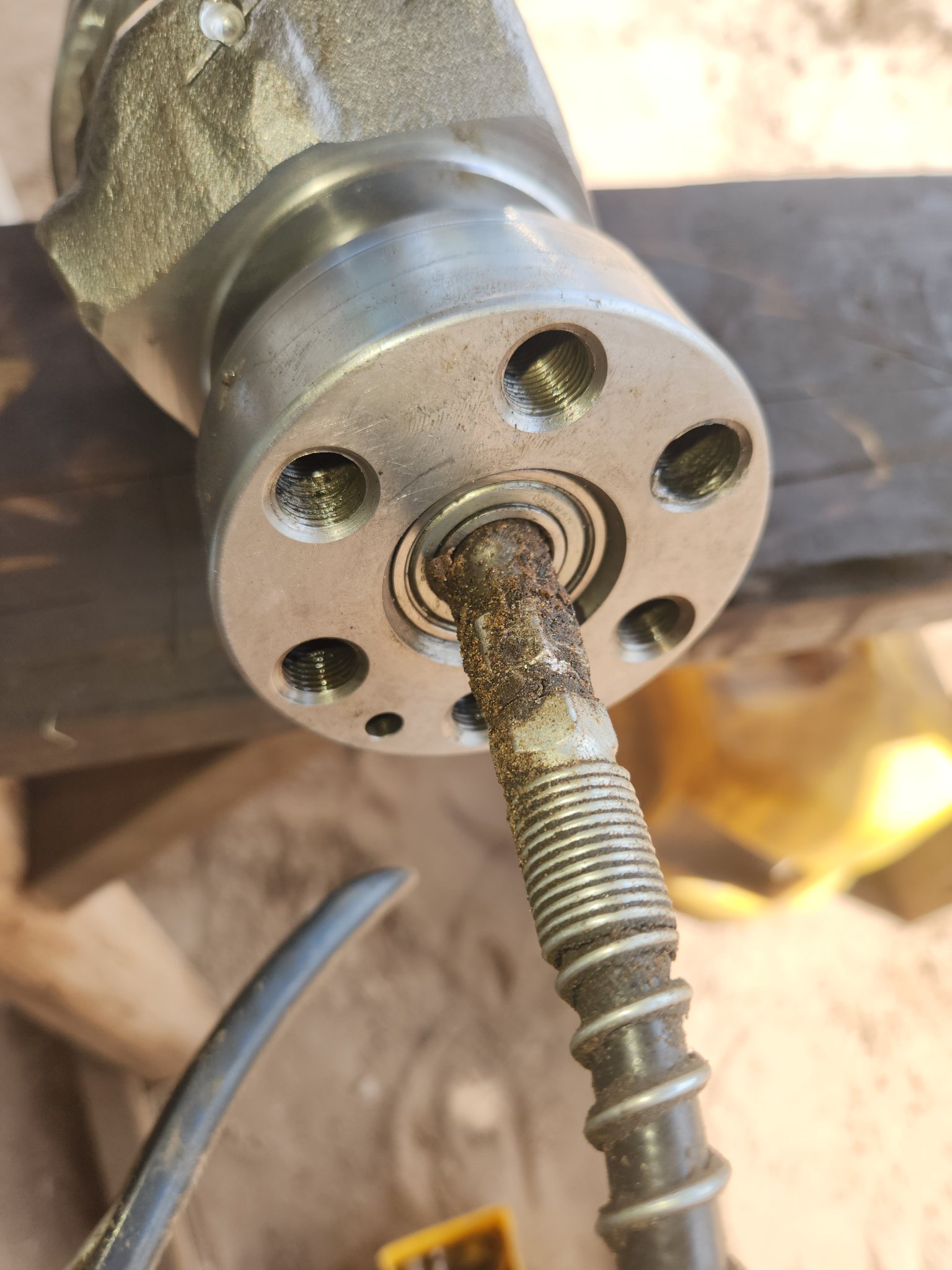

Tried 2 different grease guns, pumping grease, won't budge on both crankshaft
New plan, heat the area with torch, then loosen it using air chisel, then try again pumping grease into it
I try now
Did not work, grease escaping from outside radius
Escaping not from where I put the rod, the outside of the bearing

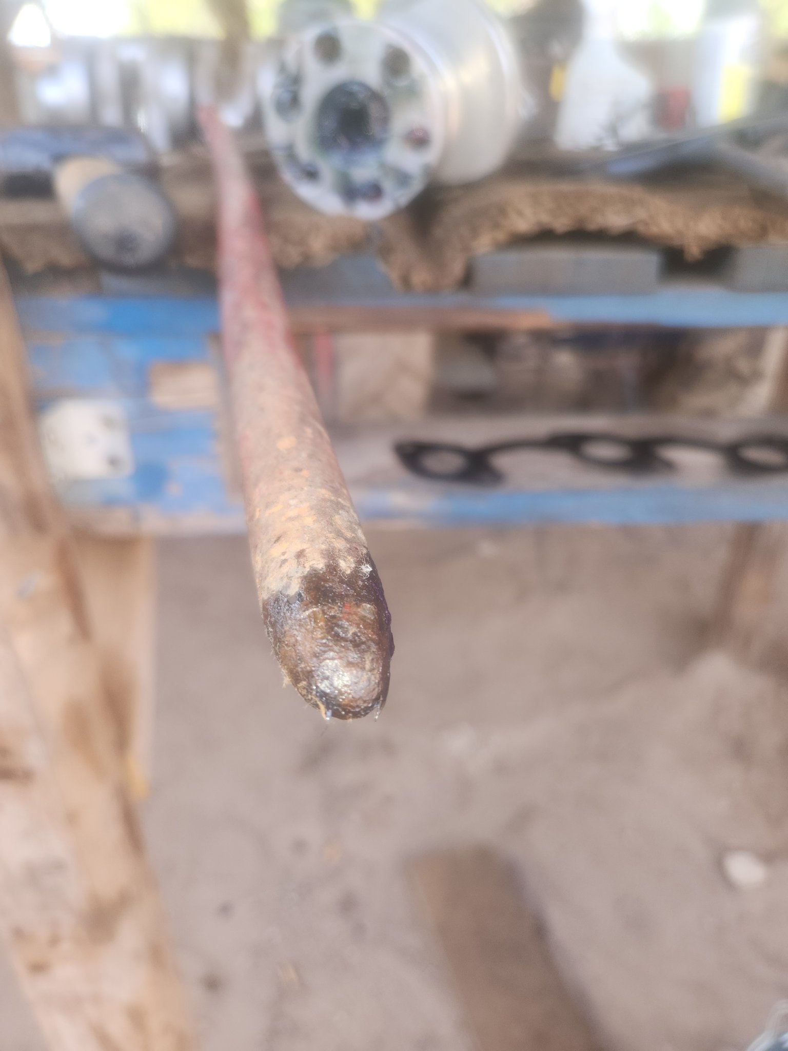

In the picture, that is the best thing I found to try to fill it with grease, then hit with hammer
Could be seized to crankshaft after 44 years, stop working, go back and look at the tools people mentioned, find a different solution
Up close, escaping from outside radius of part we are removing

Your comprehension skills off today? Get the area full of grease. As full as possible, then drive a snug fitting shaft or dowel in.
14,623
7,091
Your dowel needs fit snugly (like an interference fit) so grease can't get past it!!!!!!! The heavier the grease the better.
Jim L.
Jun 18, 2014
870
172
Exactly what the other fellows are saying. When the dowel is hit, the force will transfer through the grease. Grease should flow under the bearing, and then out between the bearing and crankshaft. A rag around it will stop a grease explosion from hitting you.
If preferred, soak the area between the bearing and the crankshaft with penetrating oil, and then use grease.
The method does work.

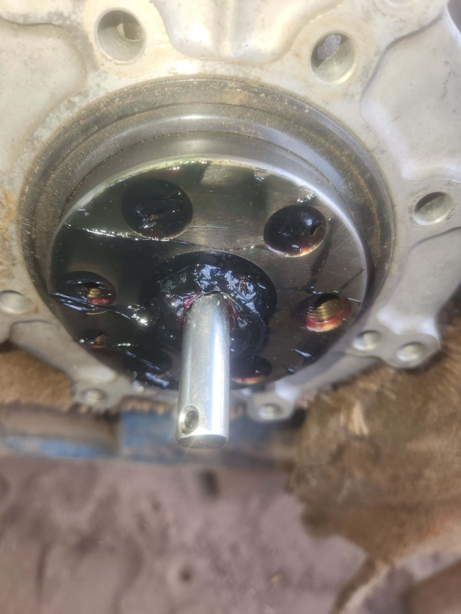

Tried everything, grease keeps escaping too quickly from outside radius of bearing
Last attempt: found this part that is slightly bigger than the hole, put on vice grind down to fit the hole
Filled each crankshaft with grease, gave it solid hit, all grease quickly escape from outside area
Now: look at the suggestions and try to get the proper tool

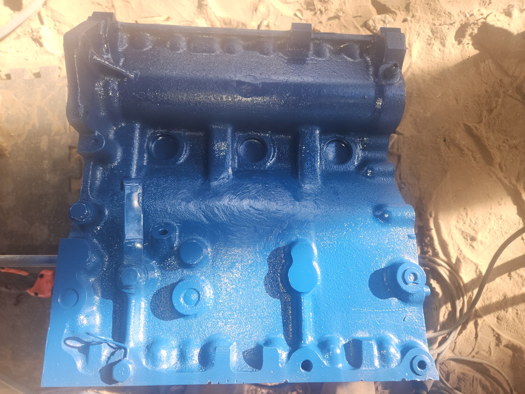

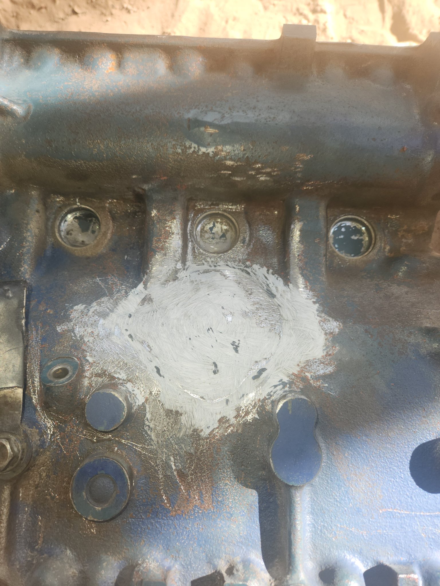

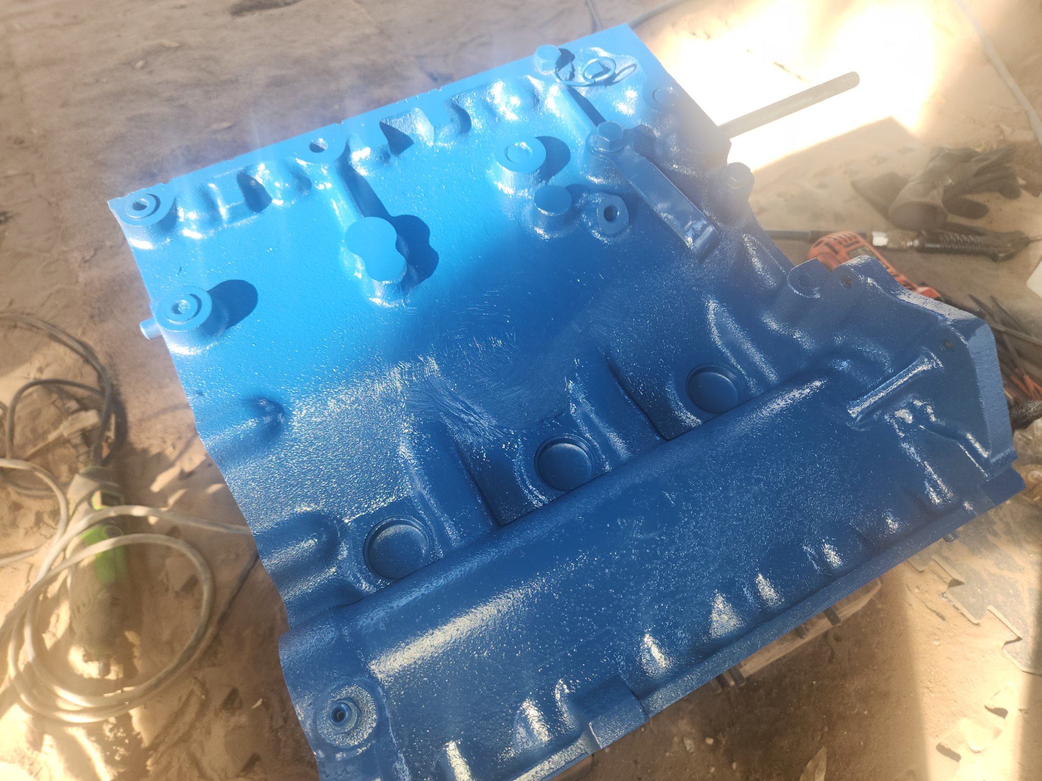

Patch on engine block after two days curing: plan - hit it with slow grinding wheel, then hit with spray can yall saw

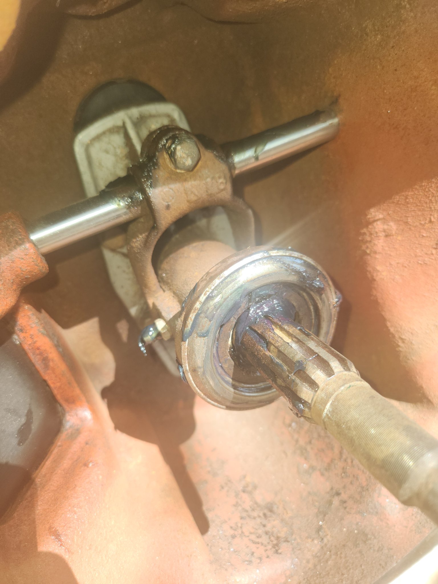

Bell housing: getting ready to grease entire area all moving parts
Took off side cover to access hole better
Greased everything, pushing clutch back and forth

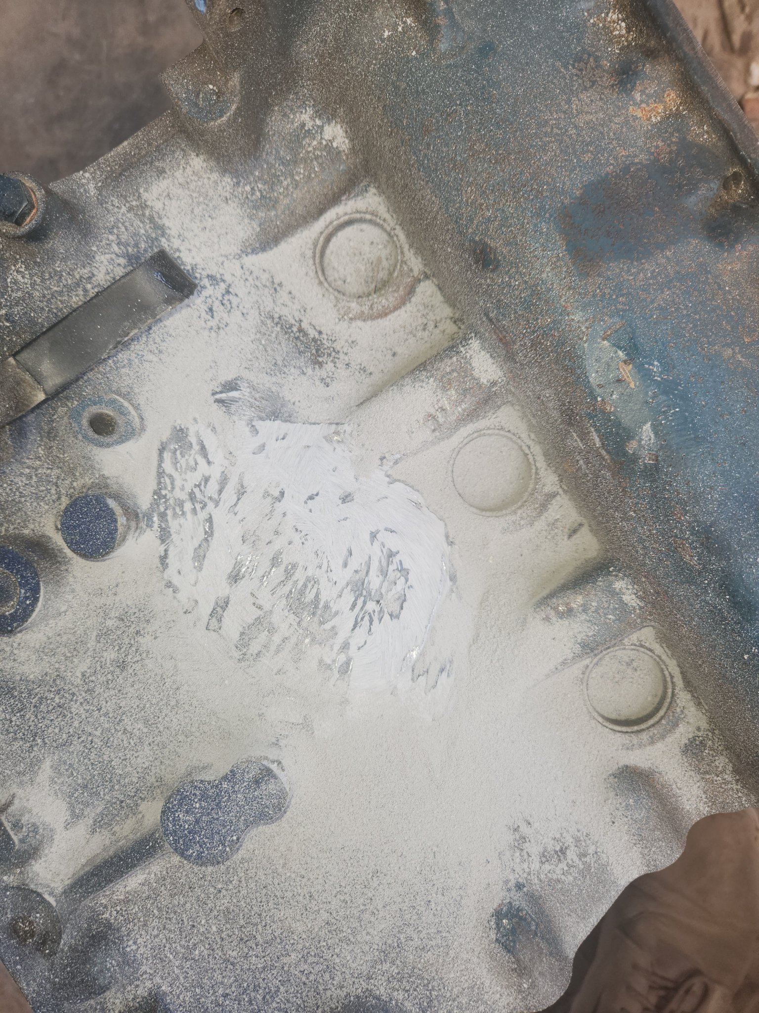

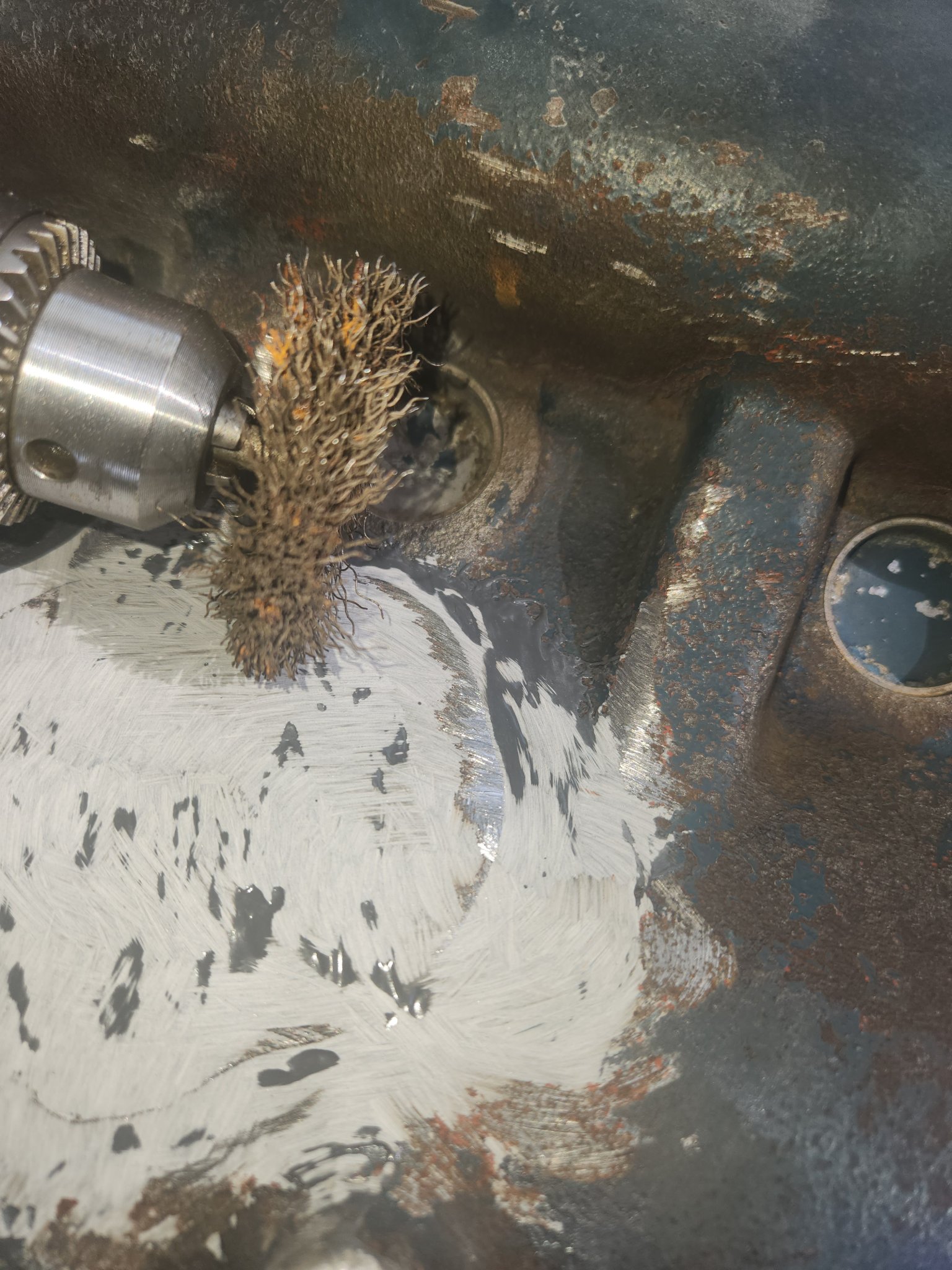

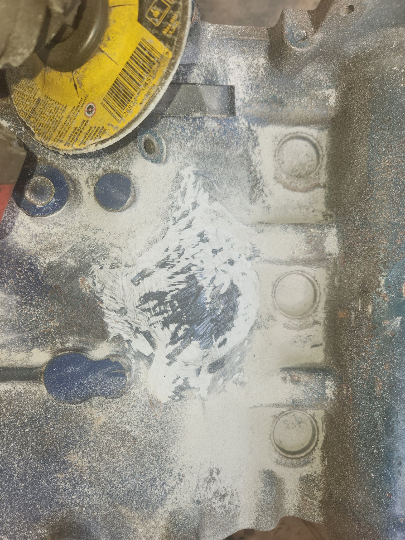

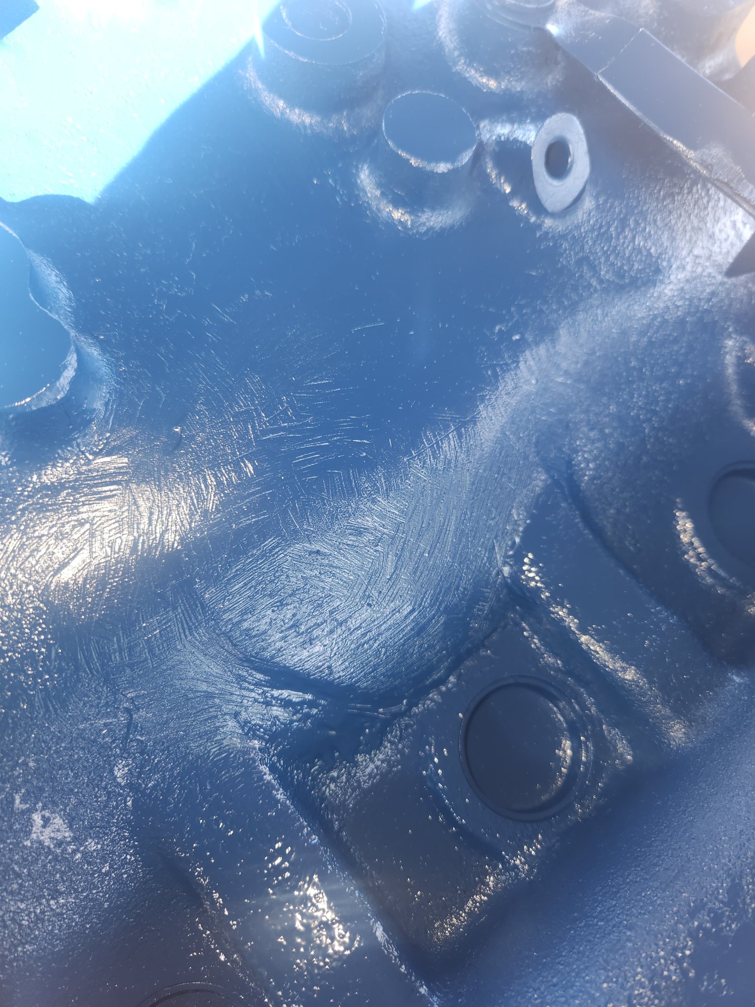

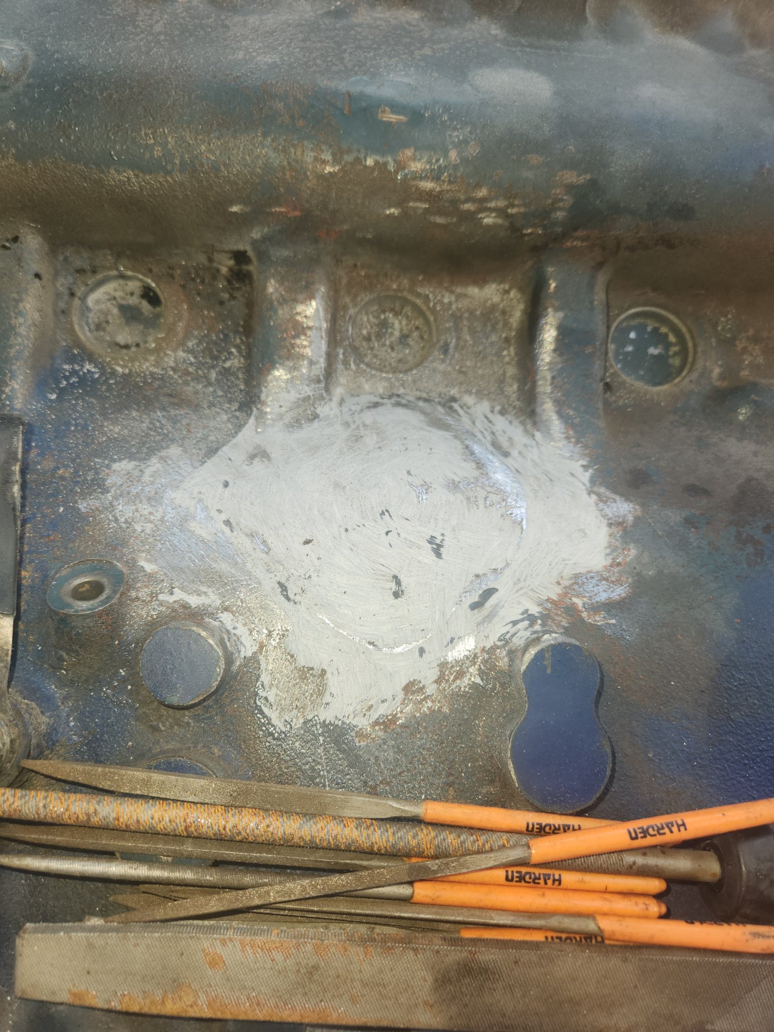

Grinded down jb weld, painted patch
Hit jb weld with grinding disc, 800 rpm
Grind down high areas, tried wire wheel, it can't grind down jb weld
Hit with compressed air, get files and hit nooks and crannies
Hit with compressed air, wipe with alcohol, hit it with matching paint
Plan: clean up shop, get all tools out of sight, solve the bearing removal and wait on parts
There might not be enough excess grease on those parts to lubricate clutch disc so save a handful to "hit the clutch plate with" before buttoning up. :LOL::unsure::ROFLMAO::cautious:😂🤪

I suppose if the pilot is a ball bearing and it isn't shielded on the inside then the grease will just pop off the outside shield, letting the grease vent through the balls.
PaulL
Jul 17, 2017
2,642
1,624
NZ
I don't see how the grease can go outside the bearing if the bearing is tight. If the bearing is not tight, I don't see how it isn't coming out. Are you sure it's not coming out through the bearing - through the balls? Even then, I'd expect if the grease is packed tight, and the dowel is hit firmly, it should still put enough pressure on to push the bearing out before the grease all leaks.
chim
L4240HSTC with FEL, Ford 1210
Jan 19, 2013
2,874
2,304
Near Lancaster, PA, USA
Guessing here. It looks like Joe is not using a punch that fits the ID of the bearing and the grease is squishing out around the punch. OR, the punch has a diameter that reduces before it reaches "home" going through the bearing.
Just for giggles, it wouldn't take a lot of time to cobble up something like this to try. Find a bolt that has a head, that when rounded, fits through the ID of the bearing. Grind the points off. Make a saw kerf from the head end into the shank of the bolt. Insert the head end into the bearing so the head is on the back side. Drive a small wedge into the kerf to spread the head so it grabs the back side of the bearing . Take a short piece of pipe, or a couple pieces of steel that will sit outboard of the bearing's OD. Bridge the pipe/steel with another sturdy piece of steel with a hole for the threaded end of the bolt to protrude through. Put a greased-up washer and bolt on it and tighten.
View attachment 136529 View attachment 136530 View attachment 136531 View attachment 136532 View attachment 136533 View attachment 136534 View attachment 136535 View attachment 136536 View attachment 136537
This task would be much easier with a flap dice on your 4 1/2" angle grinder. Take a couple of minutes, don't have to change tools, nice smooth finish. https://www.harborfreight.com/4-12-...s-backing-and-aluminum-oxide-grain-57749.html

The thought that keeps coming back to me watching this journey is that in third world countries they do what they have to do to keep stuff running, without the luxury of being able to take things to machine shops, or ordering replacement parts. Sure, it would be nice to machine a damaged crankshaft journal and fit an oversized bearing shell, but all you got is fine-grit sandpaper you get it as smooth as you can and put it back together and get some more hours out of it.
I'm still thinking about how nicely that engine block patch turned out.
