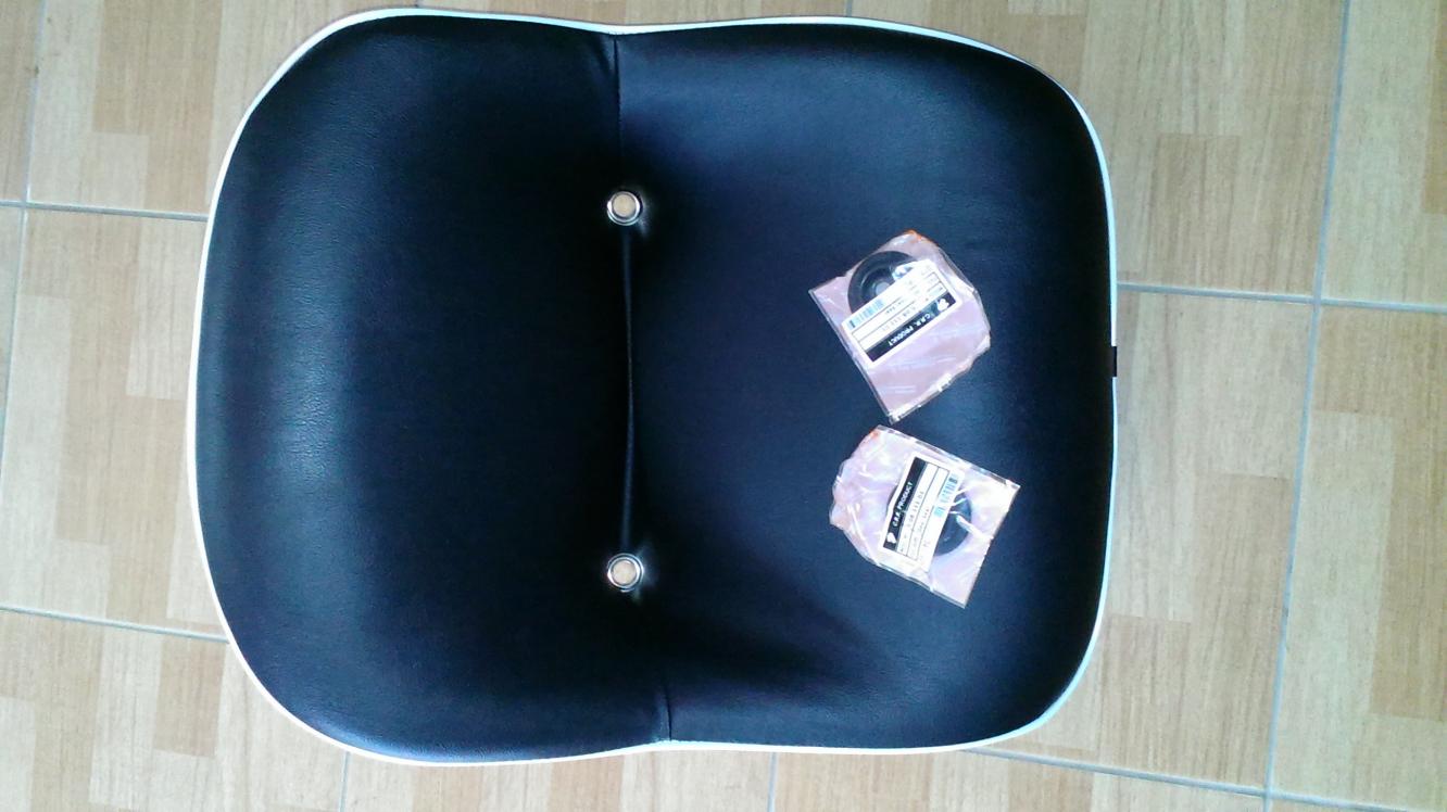

all the items-gifts had arrived but the weather is rainy, all day long :D
we had a little sun today and i couldn't resist.

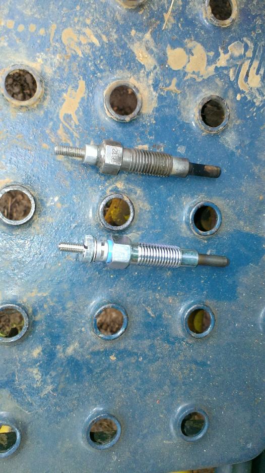

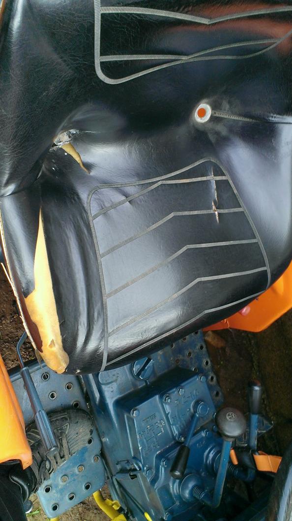

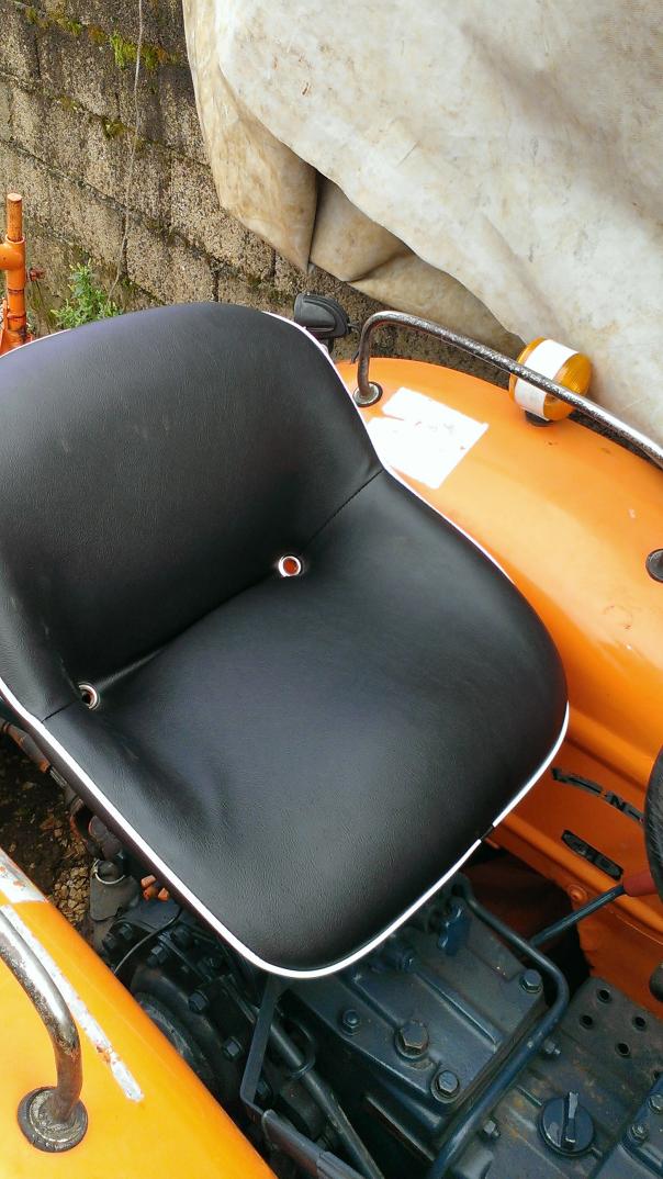

i took a 12mm long ratchet, and some pliers, to remove the glow plugs and the seat.
10 minutes later everything was ready.
now as for the new glow plugs, they are really fast and the glow plug indicator glows hot red after 9-11 sec, i hit the starter right away, the 2 cyl kubota fire right up with 2 degrees (Celsius) at atmosphere,
normally with the old plugs and that weather i would need 40+ sec and the indicator it will be seen only if it was night.
It was one of the best upgrade that i had made to the beast.
the glow plugs are recommended to every fellow that needs faster glow times.
now if i find time and good weather i will change and the gear shift seals.
here are some photos with the old and the new plug and the seats.

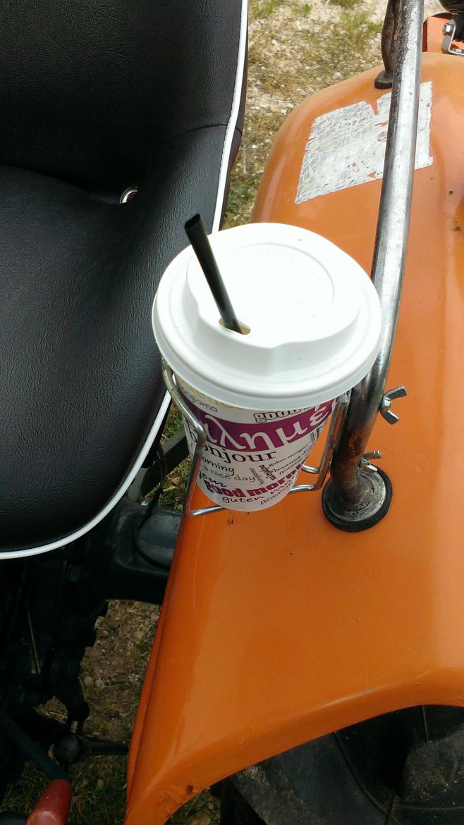

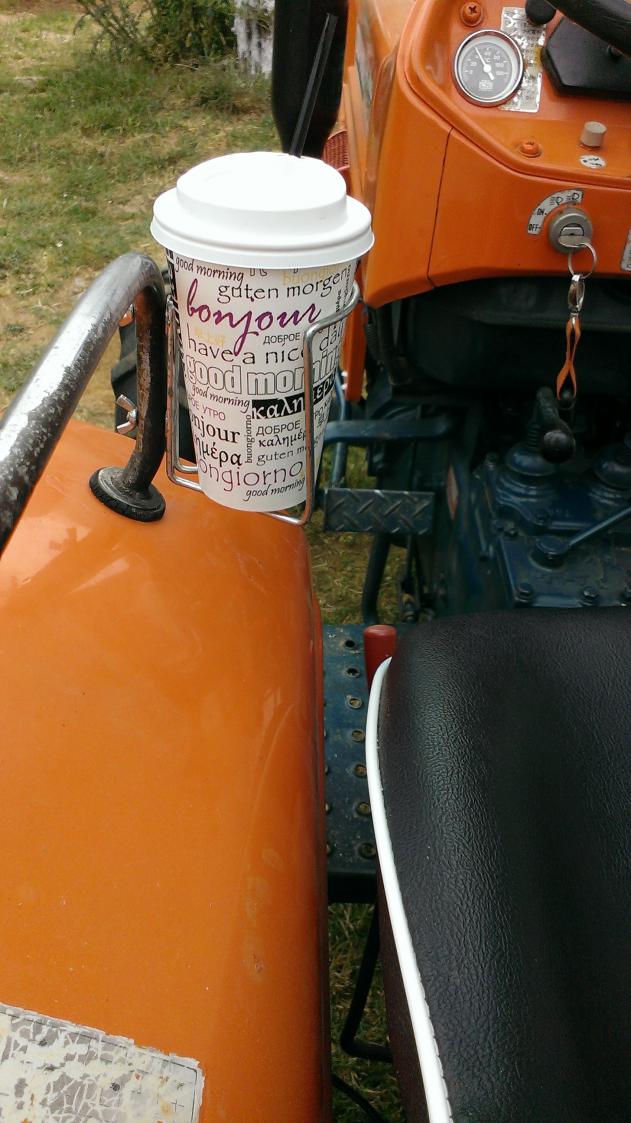

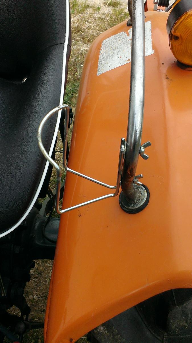

Summer is coming here in Greece and i need a cup holder, today i change the oil at the kubota and i decide to do a small modification at left fender-handle and put a cup holder from a old bicycle,
it is metallic and i put it there with two small 4mm bolts with wing-nuts , so i can fast remove the holder,
the holes are small and they don't effect the strength of the handle.
here are some pictures.

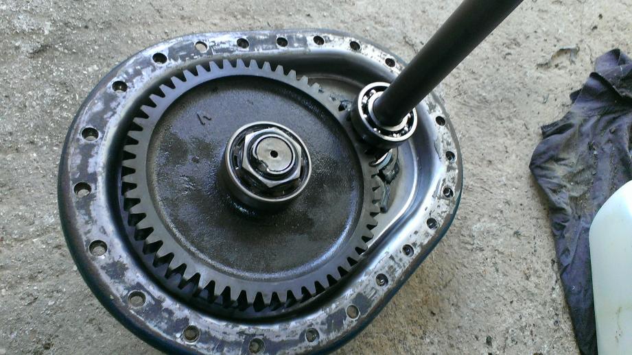

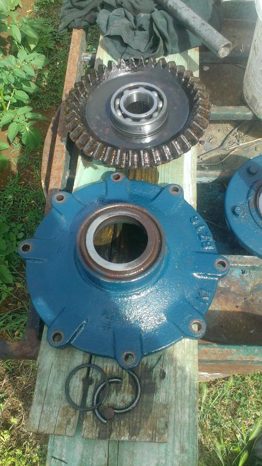

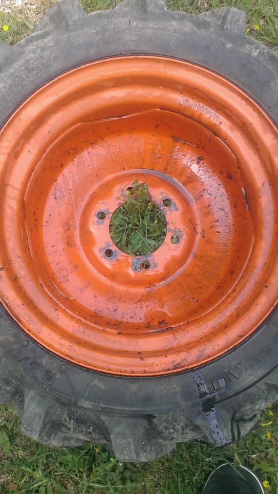

my beast had develop a new oil leak, from the front right weel hub.
it was a very easy and fast job,
i jack up the front weel and remove it, then i remove the out bolts of the hub and everything came in my hands, a big gear and two rollers,
the dissaseble was easy and in 20min later i had the old seal at my hands.
a fast vist to the nearest car service center to find a new seal.
from there it was easy, cleaning and asseble the hub, new sae90 in and ready.
here are some photos.

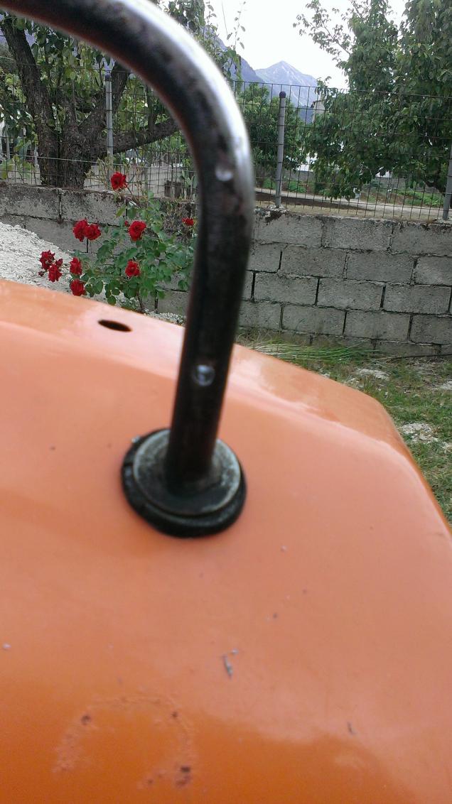

a long time i've been away from the forum but i don't have free time,

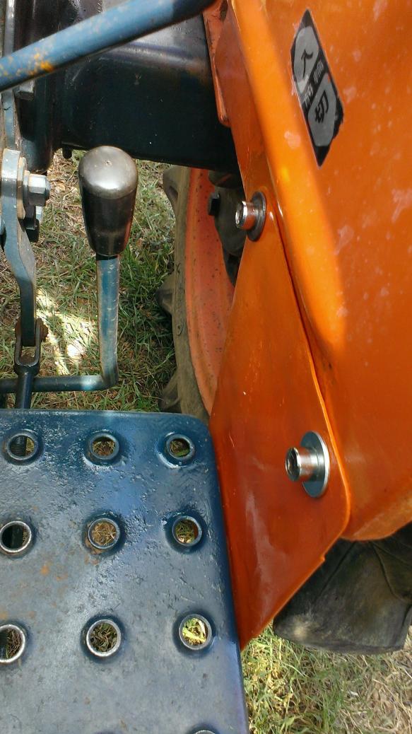

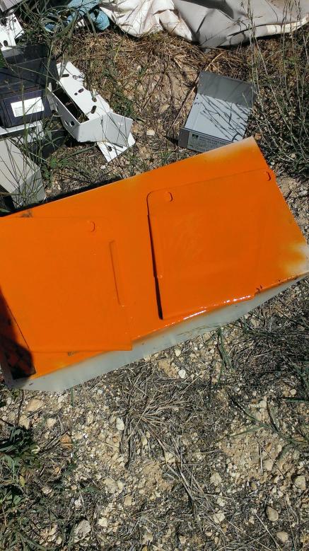

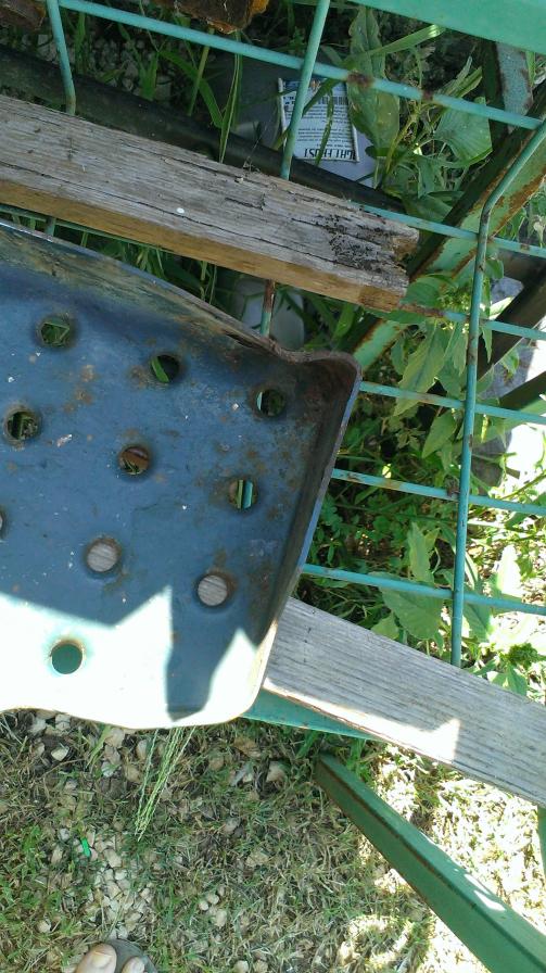

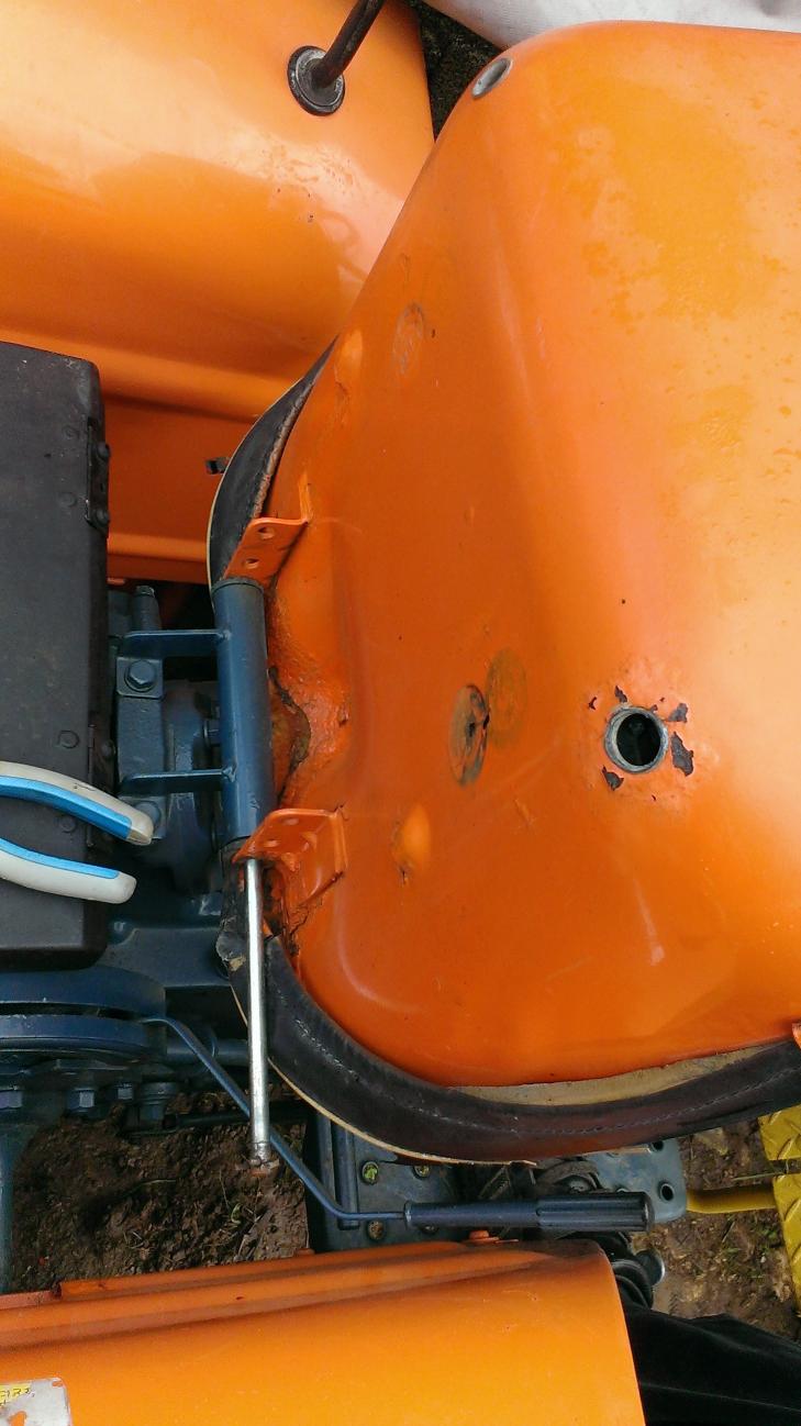

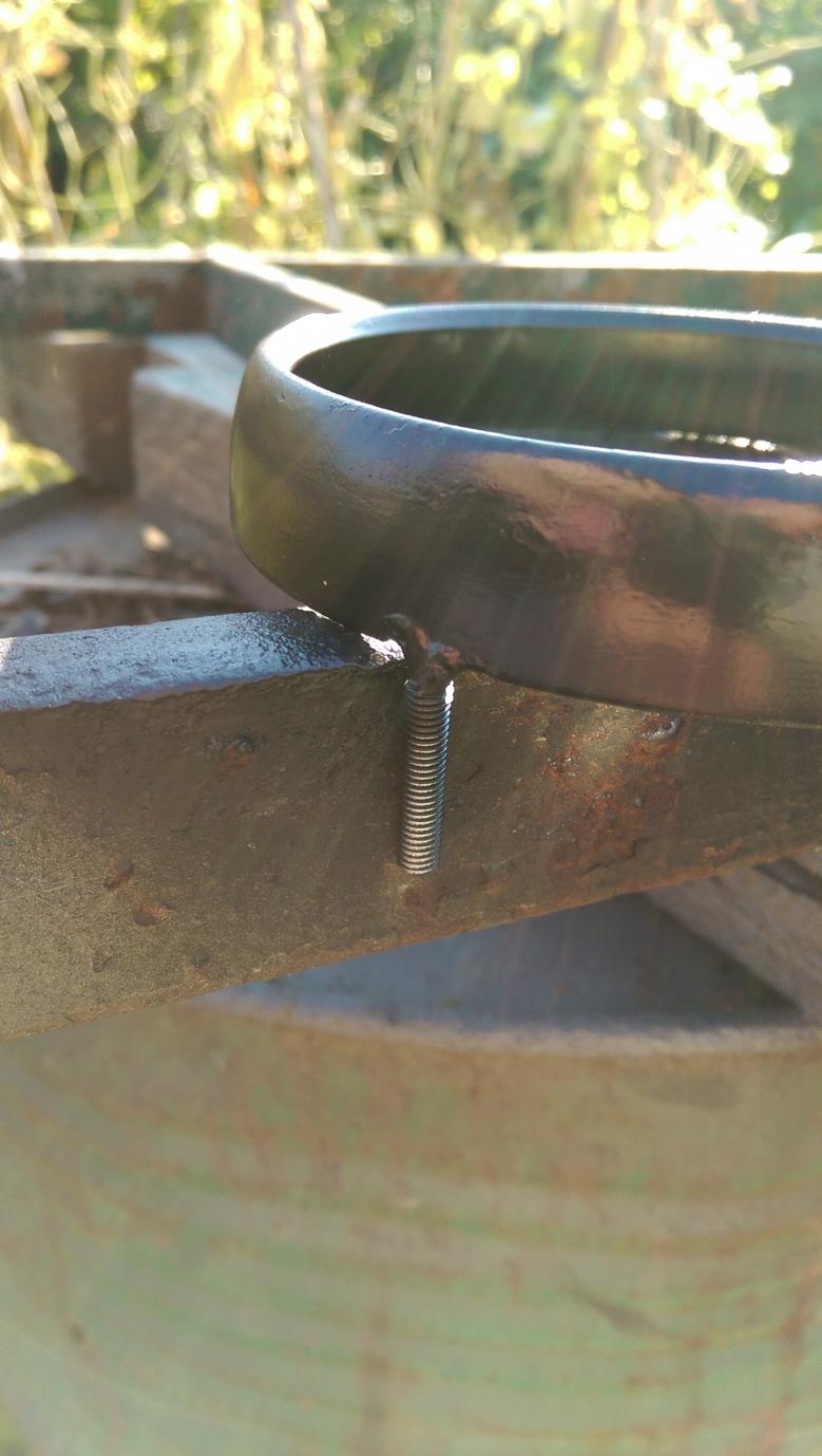

today i remove the metal plates that hold the foot paddles at the fenders because the upper bolts had rust and the plates had lost the paint, i decide to remove it and change the bolts because one fender when the bota is at lower rpm it (dances)
the plate don't grab it perfectly at the foot rest, and the bolts were bad.
here are some pictures from the repair time.
first i remove all the 4 bolts, and 2 of them snap, i even remove the clutch foot rest because had a dent under it..
then i clean with the grinder the plates and straight them,
i spay paint every thing and put 4 new bolts.
i think that it looks better.
and the better thing is that the fender is rock solid now and it not dance at low rpm.

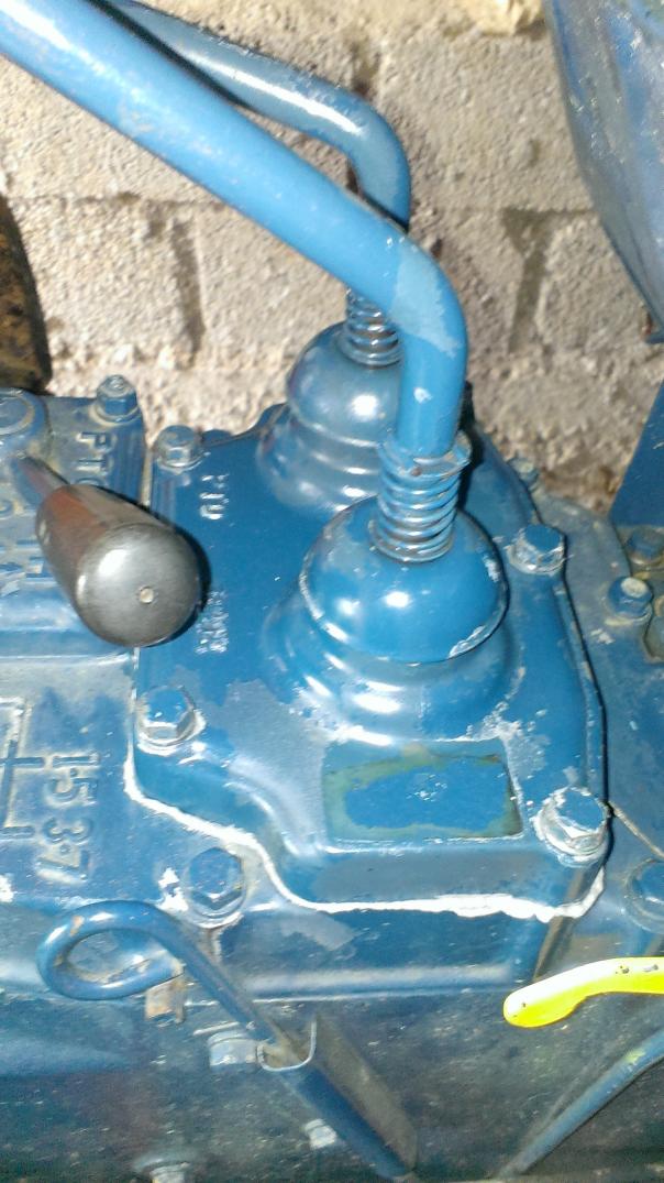

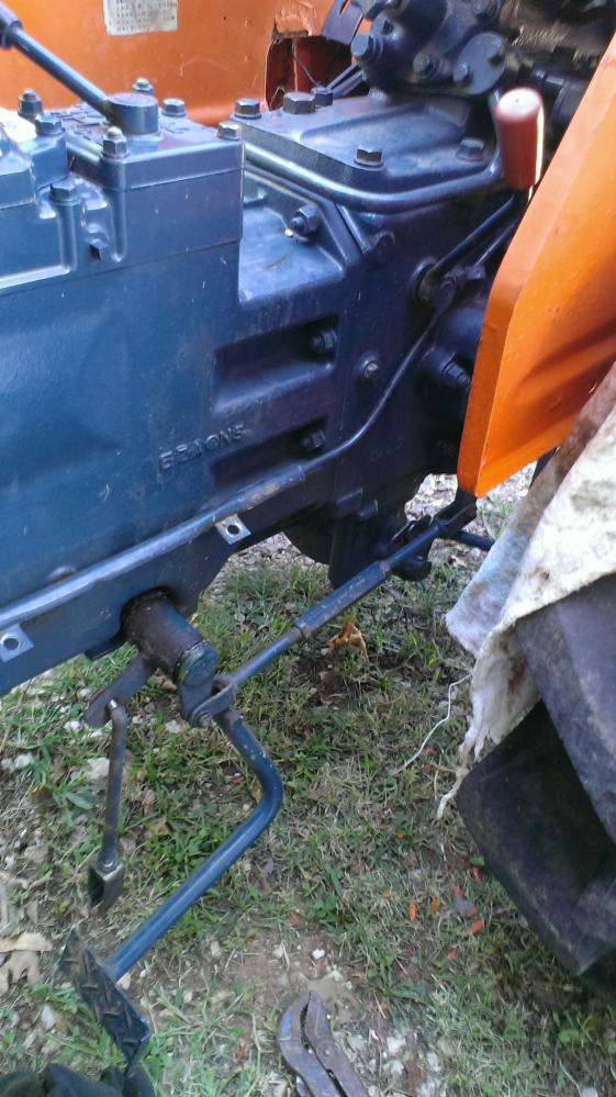

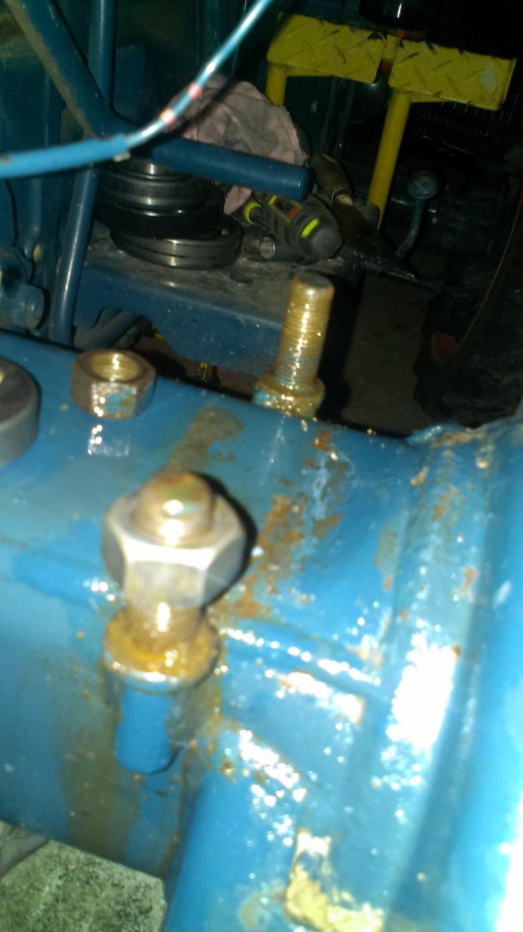

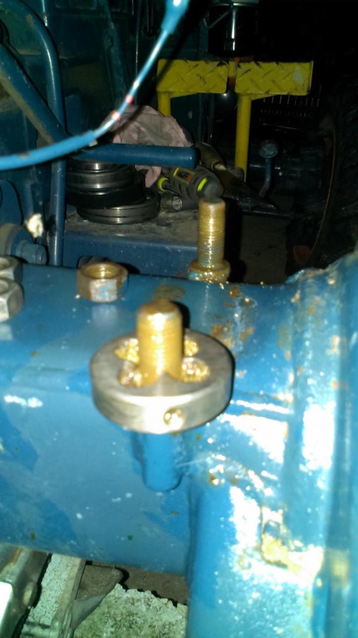

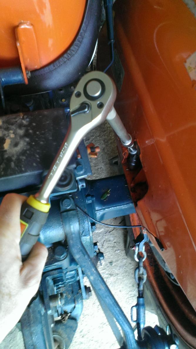

Hello again,
Since a lot of fellow forum mates fix their tractor and since that L1501's loose after 40 years some oil i decide to fix mine.
i start with the fender that it was a 5min job with the right tools,
20minutes later i had the axle removed.
The other leak that my small beast had was some tear at the pto lever after some hard working time.
i know its very bad.... :D:D:D:D

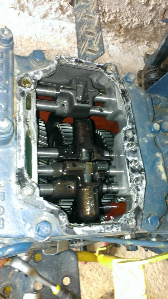

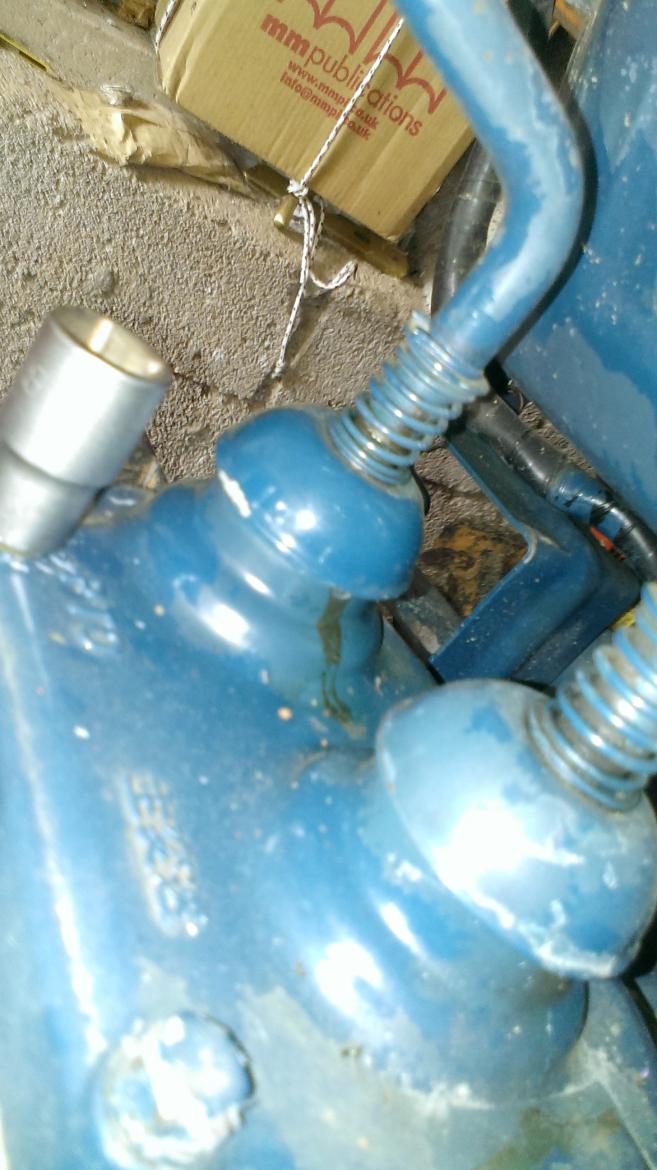

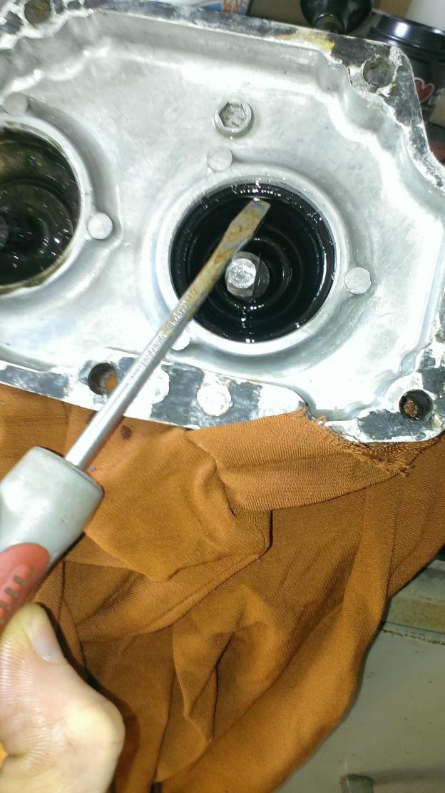

i had buy the seals some time ago, and it was a very simple fix just 10min work,
the old seals i remove them with just a screw drive, and the new ones i just pressure them with my fingers and they pop in.
i clean the levers underneath and after some inspection to the gears (Everything is like new in there)
i put some rtv and install the levers.
i will remove the extra rtv when it cold...

Nice work :D I had to do the same wheel seal replacement a couple months back. Haven't had to go in and seal the top to the transmission though. Mine would start leaking there, and it meant that the mud dobbers got my transmission vent again :rolleyes:

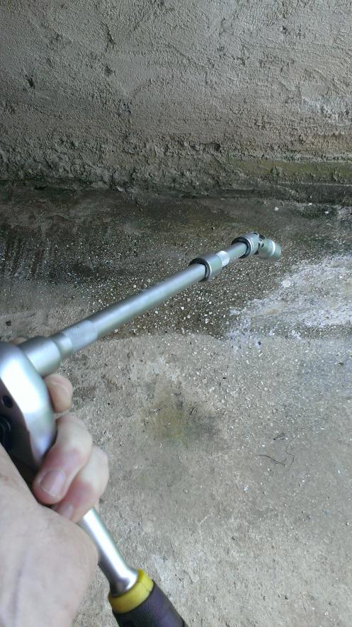

I removed the fenders the same way you did. That 17mm universal socket and a couple of extensions sure made it a lot easier :D It's the first time the clutch side fender has been tight since I owned it :eek:

well after 40 years of hard work its time to develop a leak, for me its normal, and i understand that if a machine is in working mode-on then it needs attention and service.
the good is that we have very strong build tractors and very easy to work with.
@ Daren this seals at the transmission have double purpose not only to seal the oil fumes to get out from the transmission but the real goal is to keep out the water and the mud and the other elements..
you wouldn't believe what i found over the seals.
i advice you to change them, its easy job and trouble free, and in that time you take a look at the gears

nothing special today, i had no time for the kubota
and i just clean the threads and i buy 2 new screws but they are 19mm and not 17, i will see if i can put in the socket at the fender....
now the bolts are (playable) by fingers

Today i install the new oil seal and new rollers because the old ones had a small play,
i clean all the bolts and the threads and i put the gasket with rtv
here is the only picture that i took, (my phone died)
everything is cleaned and new.
the kubota is at his feet and ready for work..

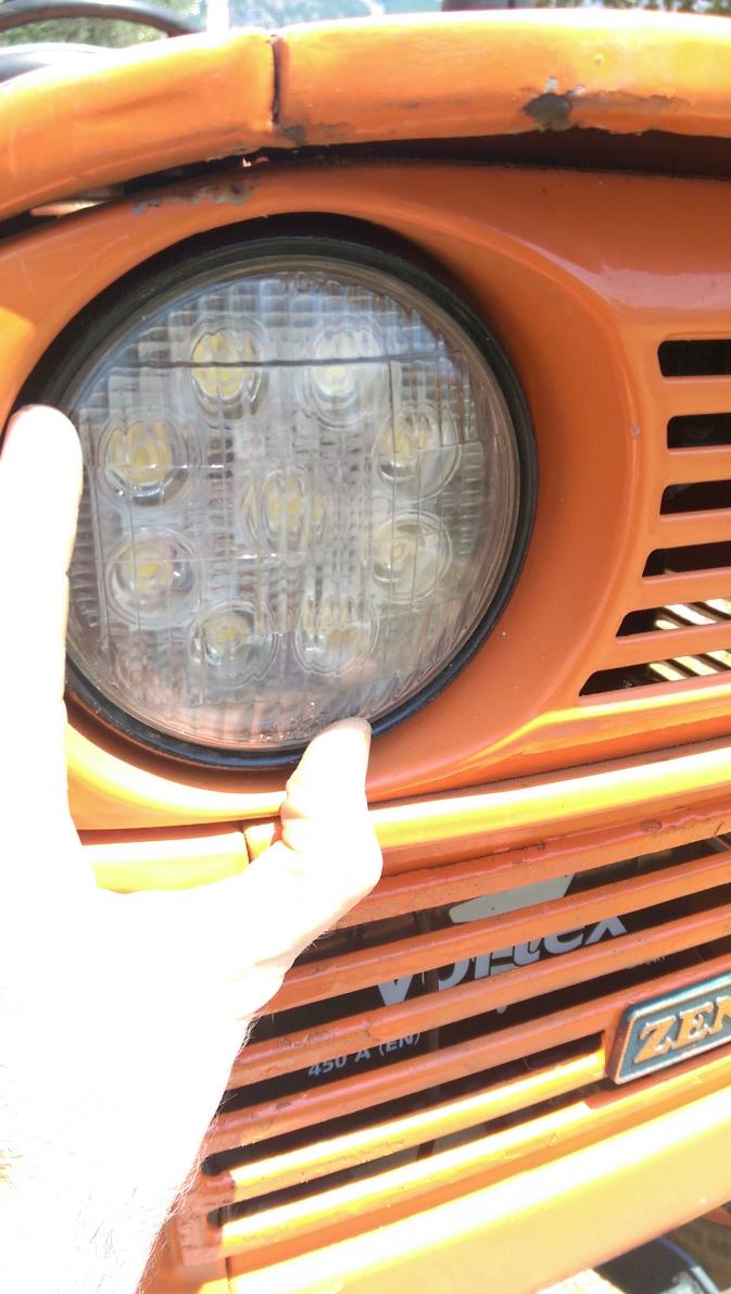

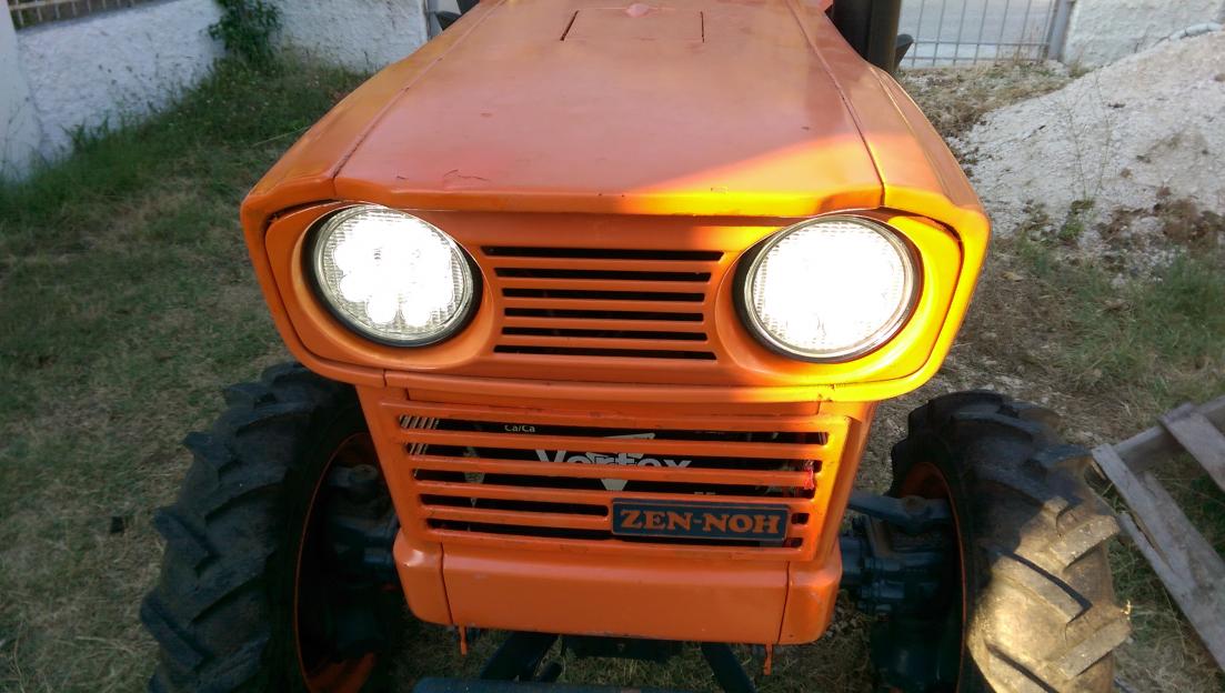

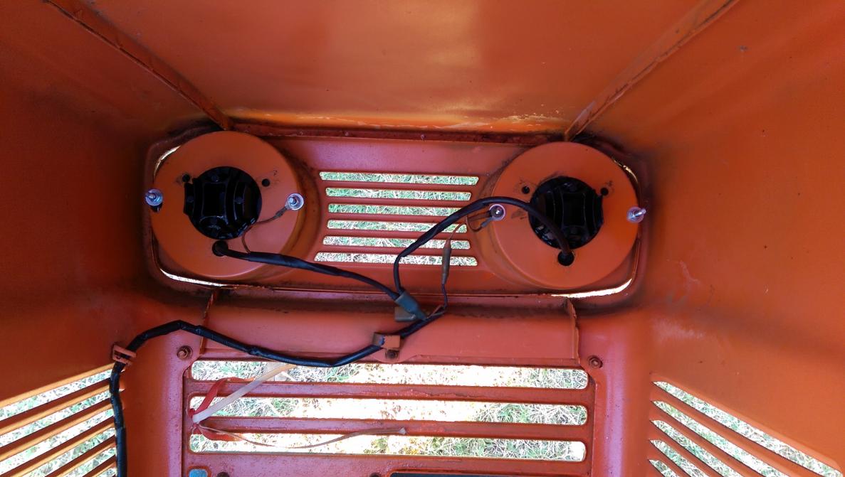

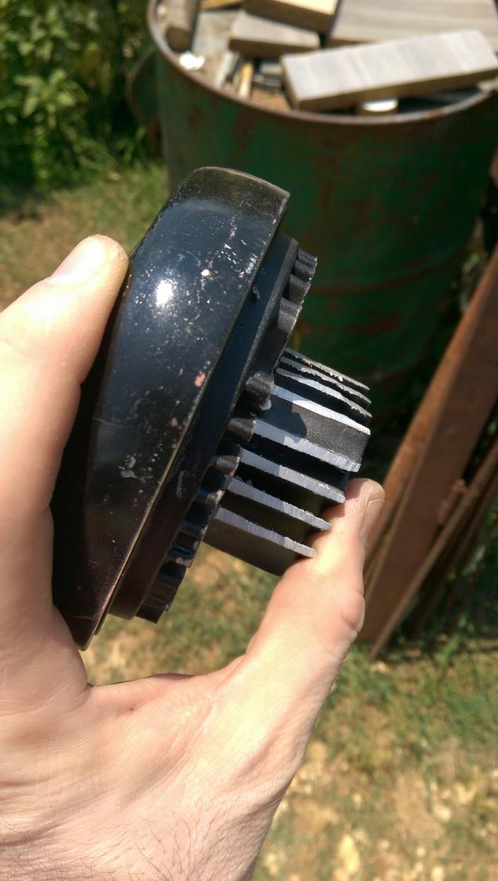

Good Morning from Greece.

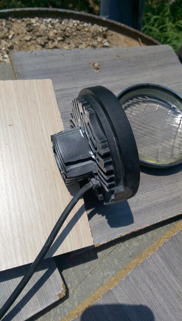

here is is a very hot summer and sometimes i need the tractor at late evening, near night and even with h3 bulbs at the headlights i need more light.
the only problem is that i like my tractor to look as more original as i can.

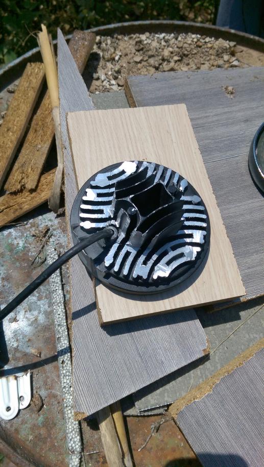

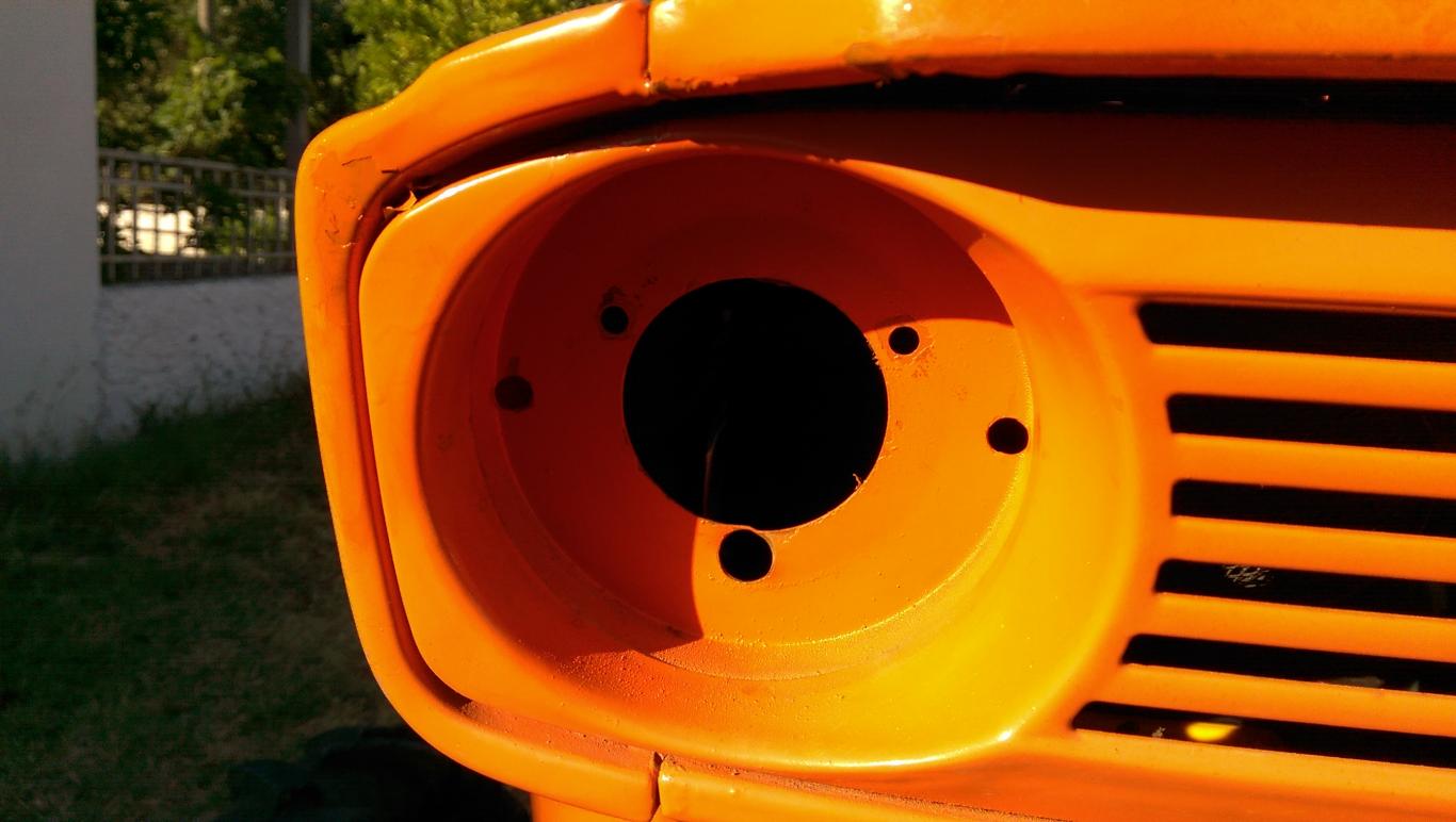

so after a lot of reading and some half stolen ideas i decide to create my own version on led head lights,
this is how i have cut the led headlight and how they seat at the hood,
i decide not to remove the hole aluminium body of the lights because it acts like a huge cooler.
a lot of sanding must to be done and painting later and installation at the end but with that pictures you can see how are going to look.

i have made some changes because i didend like the way the light was flooded with the original glass over the led light.
and that's the final modification.
i weld some bolts to the the original metal frame and i made a set of holes in the hood, and a bigger hole for the cable,
now the work lights are easy interchangeable, with just two bolts
i leave the bolts that hold the light bigger so i can put the original glass over if i want.
