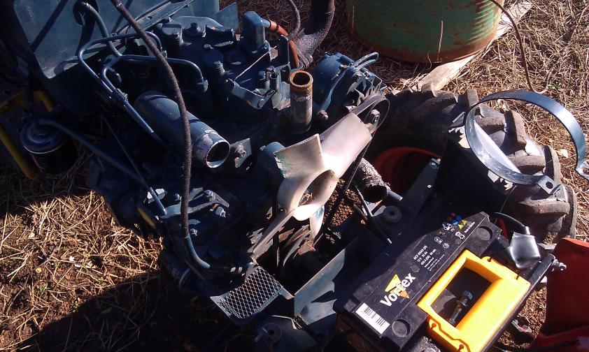

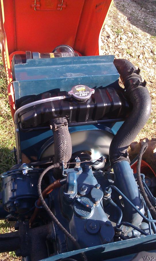

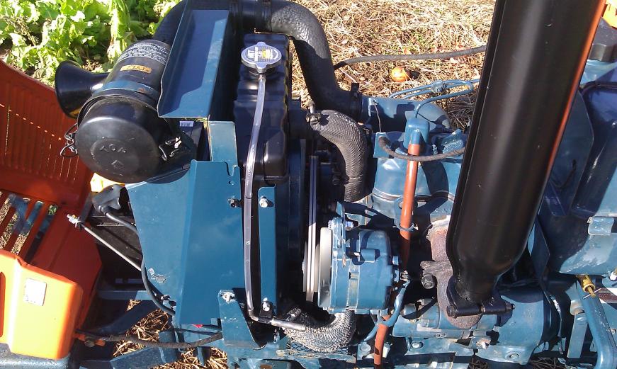

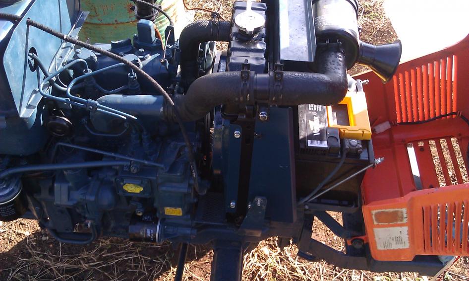

I had a red antifreeze in the radiator and i haven't change the fan belt since i bought the tractor.
so since i remove all the thinks i clean the block and the radiator inside (i pressure wash it and the to remove the water that was in it i fill it with antifreeze and water until green stuff start to come out the holes),i paint everything and change some bolts with new ones, new tube for the whistle and clean it to look line new, i even paint the exhaust with 2 layers of high temp paint.
and then i fill it with a premixed Green solution of antifreeze
