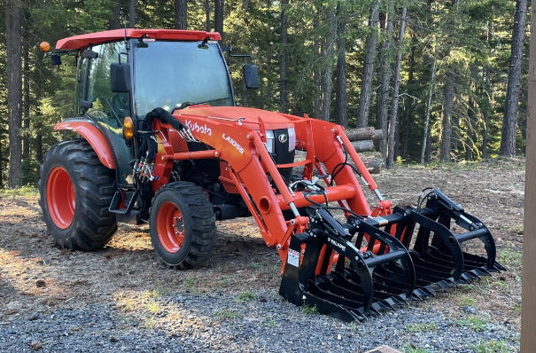

I dont have a root rake type, so probably not what you're looking for, but I cant pass up an opportunity to show off my Kubota. I have a Paladin and have been very happy with it. I have spent the last year clearing about 3 acres of trees and of all my attachments, I use the grapple the most. I really like that the jaws work independently so if you have a odd shape log it still grabs on tight.

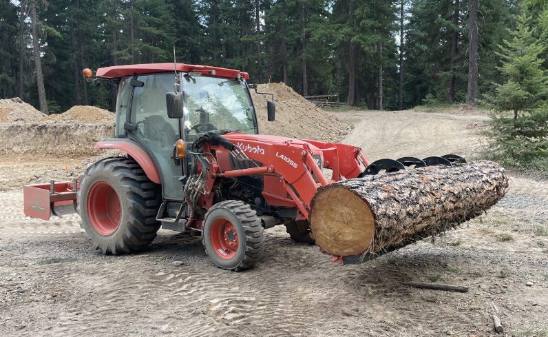

In action with a large pine log:

Sure hope that went to a sawyer!

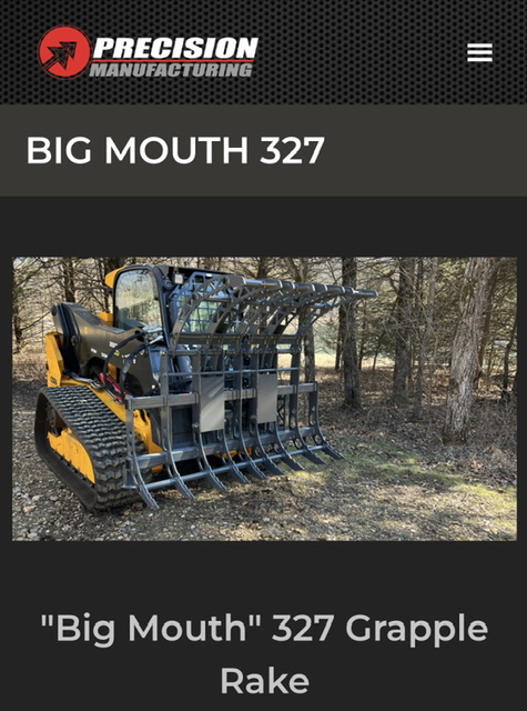

I also found this one from Precision mfg
It’s been a while but this is the grapple I ended up purchasing!Yes, it is designed with double clamps and I definitely would not own a single after using this bad boy. Yes, it is designed to use the grapples in fully open position as a debris rake due to the stops . I have put this grapple through heck and back , grabbing limbs from live tree’s and ripping them with a lot of times getting pulled sideways which means a bad angle on the grapple‘s hundred's of times with Zero Damage! I told the manufacturer that I was going to put it to the test and I have! This 66” is only 458lbs , it has stands and built from A400 steel. I did end up waiting 2.5 months to receive it but they build them 1 at a time / paid order. The root rake tines are fairly close together and work great at clearing new ground! The owner doesn’t do a good job of showing how well these are built but he has the personality of a piece of cardboard 😂- I’m certain that he would be awesome in person 👍🏼. The welds are beautiful , it has zerks at every hinge point and I am so pleased I went this route. I was hesitant at the price but it was a buy once cry once purchase for Me because I know how hard I can be on equipment. There is one thing that I am adding and that is 1/4” expanded metal to protect the hoses and fittings in the center.
