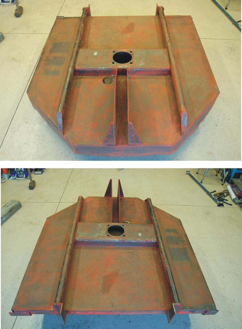

Brush Hog rebuild update,
Over the last few days I have done some paint removal in two stages;
1 with a paint remover...
2 with the wire wheel...
Today I did a light coat of Rust-Oleum Rust Reformer...
And a coat of Epoxy primer...
Also got most of the ancillary parts primered and painted...

Got the three point assembly painted and put together
A fresh coat of color on the deck, (yes it should be RED), but this is not a restoration, all my implements will be ORANGE :p
And the assembly begins.....
Last bit will be the gearbox, blade assembly and decals.

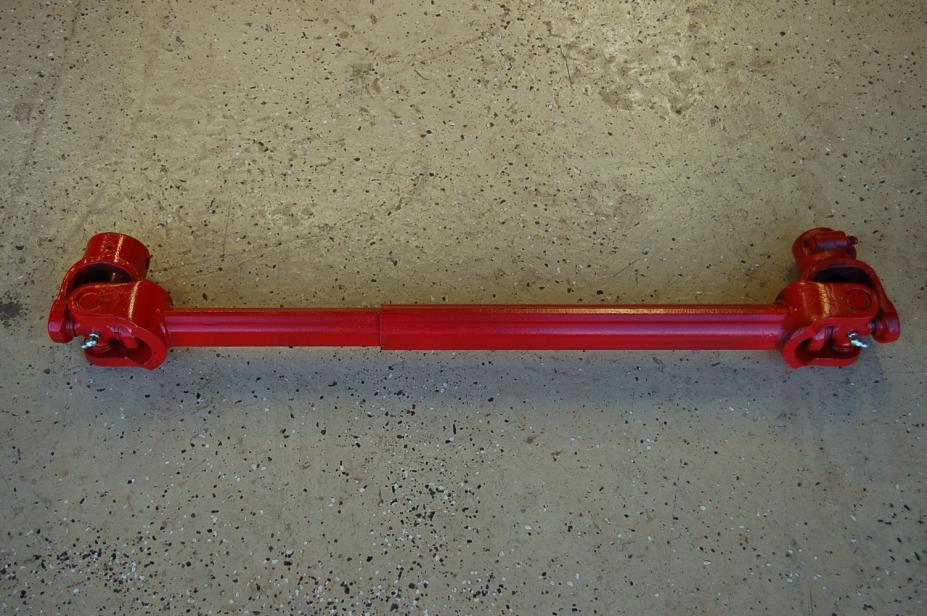

Drive shaft lubed, assembled with new zerks
Blade pan de-rusted, primered and painted
Added a washer at the bottom and top of the fork tube, do not see why it should be metal to metal?
Wish I could have found a 3" one for the bottom
Replaced ID tag
Next the gear box and decals

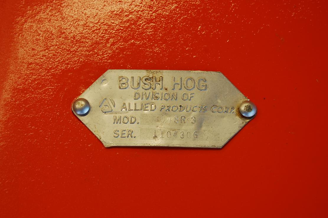

Today I got the gearbox painted, photos later perhaps. But I noticed something actually a couple things,
I was surprised that the 4 bolts for the top cover were metric,
while I was cleaning off all the gunk I noticed the gearbox was actually made in Italy for brush hog.
I also noticed I've been calling this thing a brush hog it is actually a BUSH HOG, gar-dang, don't I feel stupid.
Well anyway no help to my stupidity this thing will be assembled tomorrow!
