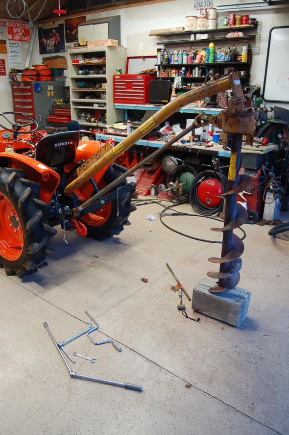

Yesterday I started on the A-Frame fabrication for the PHD
Had this laying around (or is it lying around) in the scrap pile
Cut down some 1/4" angle iron for the bracket
Drilled a couple of 3/4" holes and tack welded together
Tack welded it to the A-Frame metal and test-fit it
Welded it all up
Now I just need to determine the proper length to get the maximum travel,
cut and weld some brackets to the bottom and add a pair of Cat-1 hitch pins.

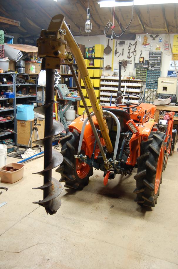

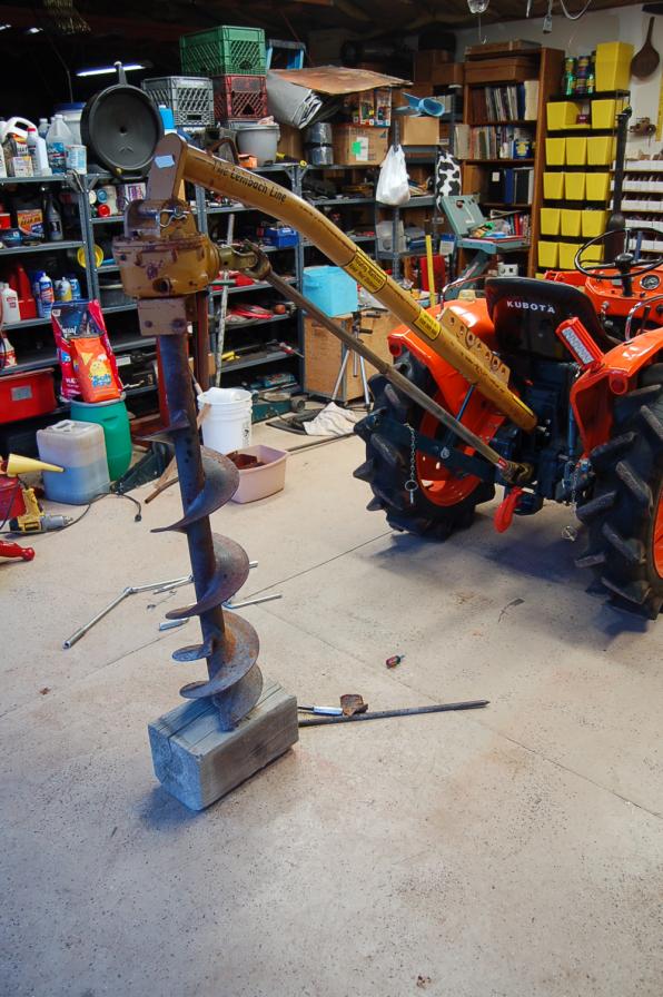

Finished up the A-Frame tonight, happy with the up-down travel.

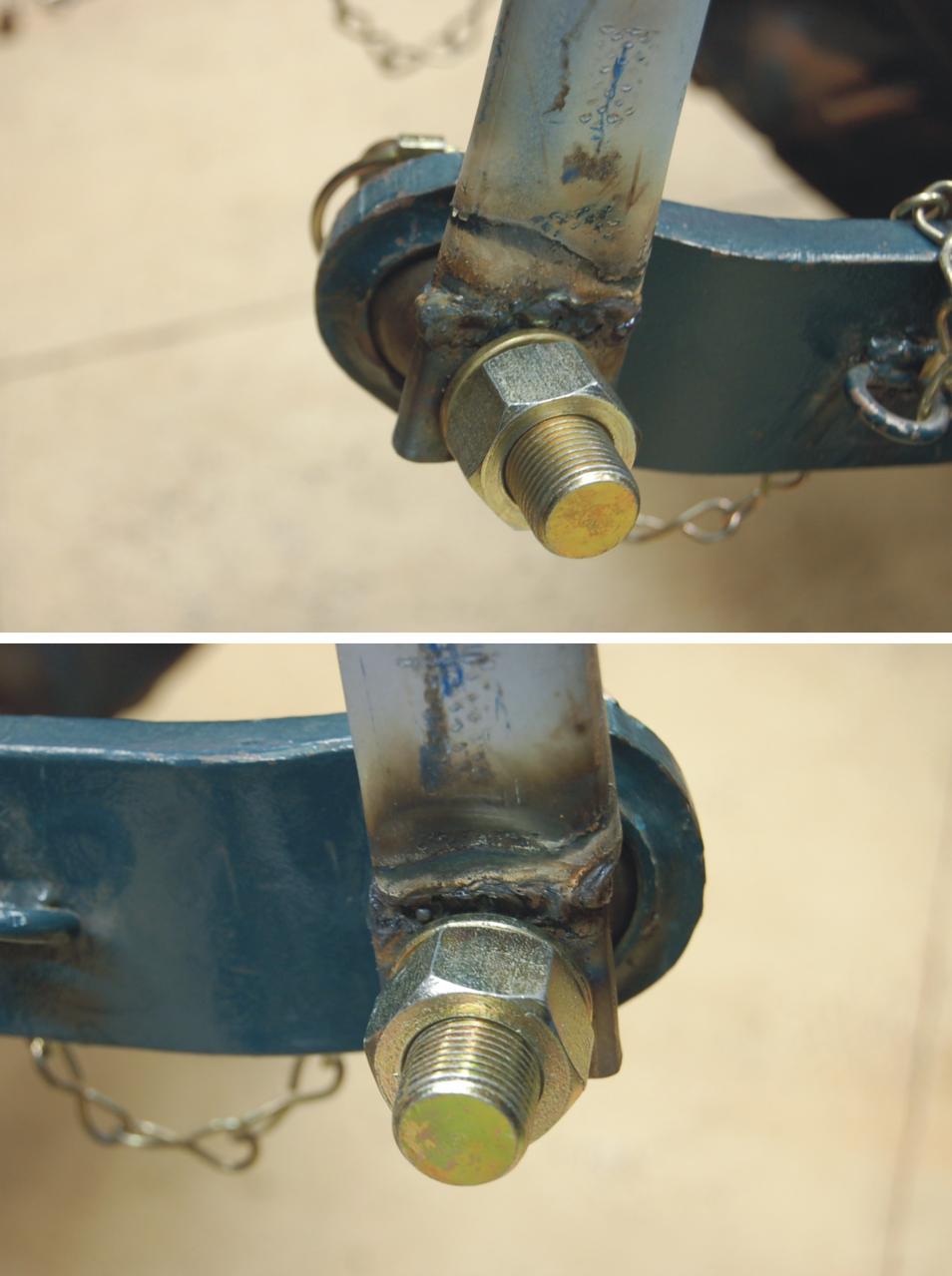

Welded a couple of tabs to accept the new 3-point pins
did a test run,
I ended up with 19.5" of clearance in the full up position, can get more with the four additional holes available on the boom ;)
and goes all the way to the ground and then some in the full down position ;)
I am wondering if it is proper to have the 3-point pins on the outside and tighten up against the lynch pins, Pulling the A-Frame outwards
(would make for an easier installation)
or should I have the pins on the inside? :confused:

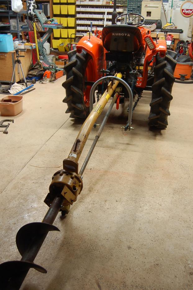

That exposed PTO shaft has me nervous. Otherwise looks great.
Yes tis the life of a grey market tractor , I may make a cover for it. I do have all the covers for the auger end of the drive shaft however.
I never understood the theory that grey markets do not have PTO shaft covers there's one listed in my parts manual finding it might be another story though , just another fab job probably.
