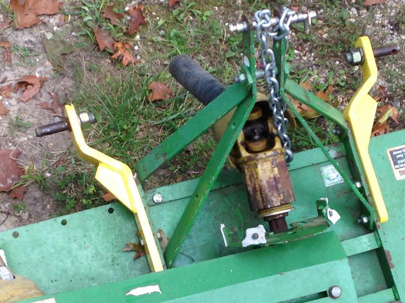

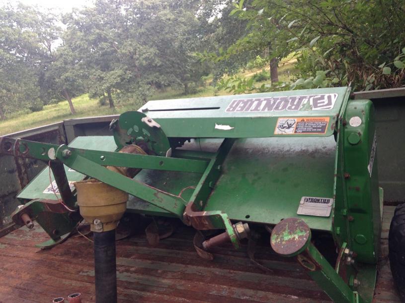

Fixed the TPH lift arms on my Frontier 1150 tiller. When I got it someone had heated and bent the lift arms, supposedly to allow it to fit on a subcompact green tractor. Makes no sense to me.
Removed the arms and took them to my local welder guy. $60 bucks later and I put some paint on them. THey used a press to straighten them out, welded in gussets and had to weld a couple cracks up. I had a can of JD yellow paint that came with my house so I thought that appropriate. They are still a bit out of square since the main frame got bent some by the PO. Easy to hook up now and should be a lot less crooked. I also had them straighten out one of my lower links that was bent when I got my B7500. Very nice guys, I will be taking a lot more business there, since I can't weld very well.

Drewzee87t, looks like you got your tiller back in operating condition, but I want to see a picture of your John Deere yellow house!!:D

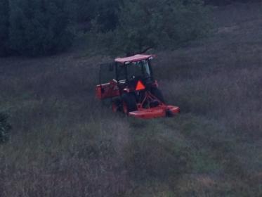

Brush hogging this property for the first time. Got out to police-call the next area. It a Land Pride RC 1860.
Nice! How's the 2650 do pulling the Land Pride 1860? Just got a 2650 a few weeks ago and I've been looking at cutters... Local dealer recommended the 1860. Just been a little worried the 2650 would struggle with it.

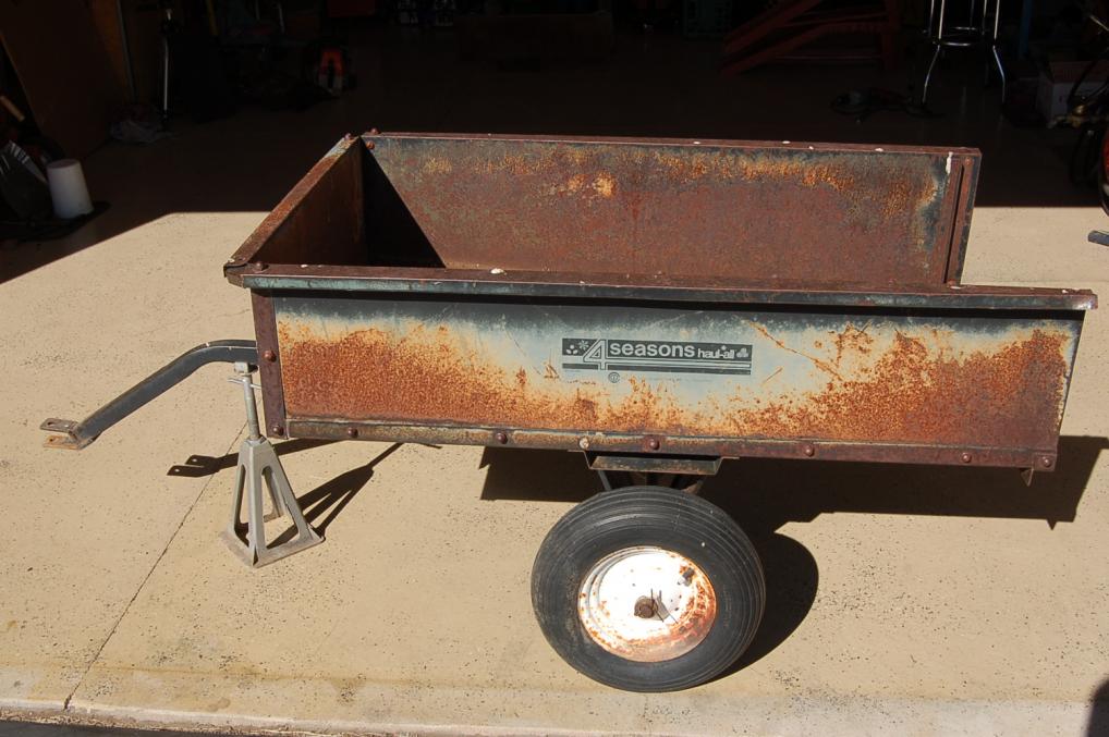

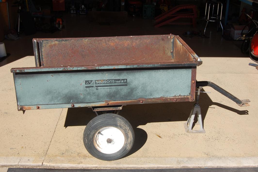

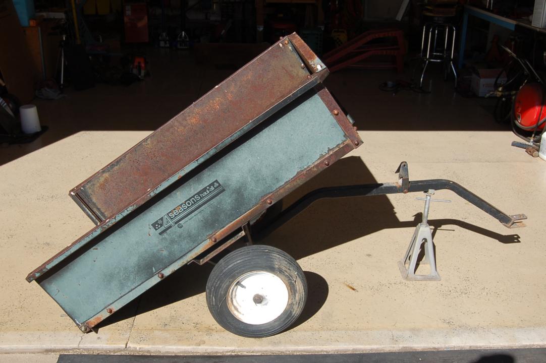

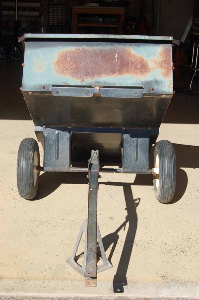

Friday I picked up a small dump / utility trailer.
A 4 seasons haul all model 480 50" X 30" X 12" (10 cu ft)
Made by Central Quality Industries in Polo IL

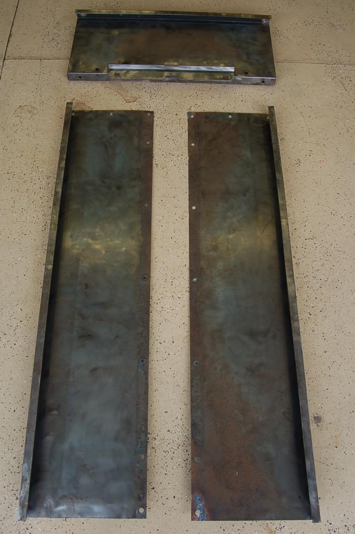

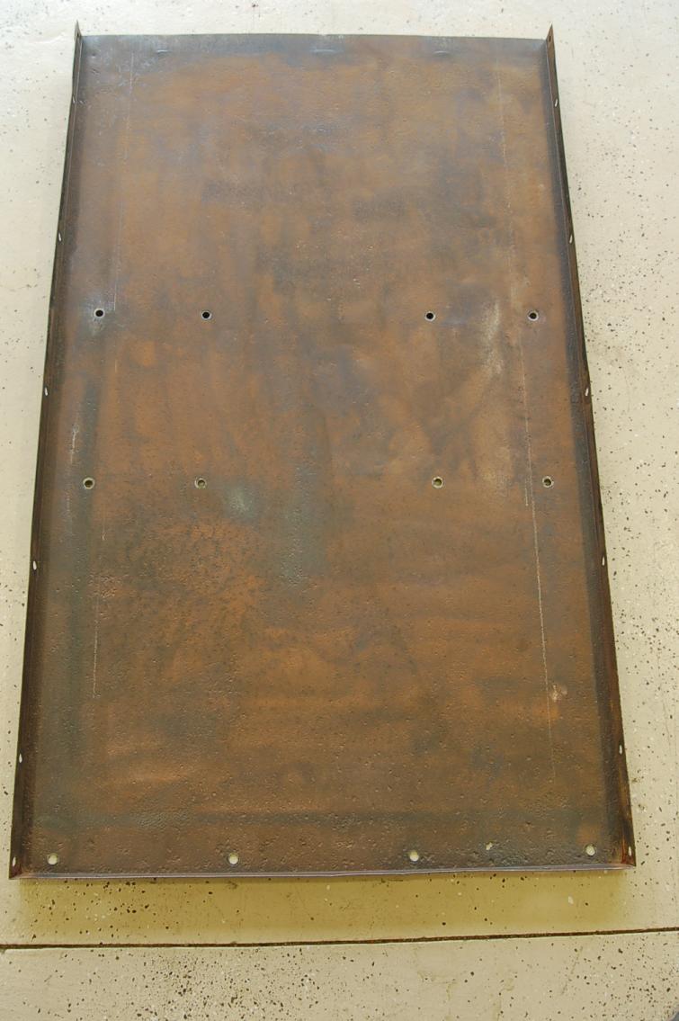

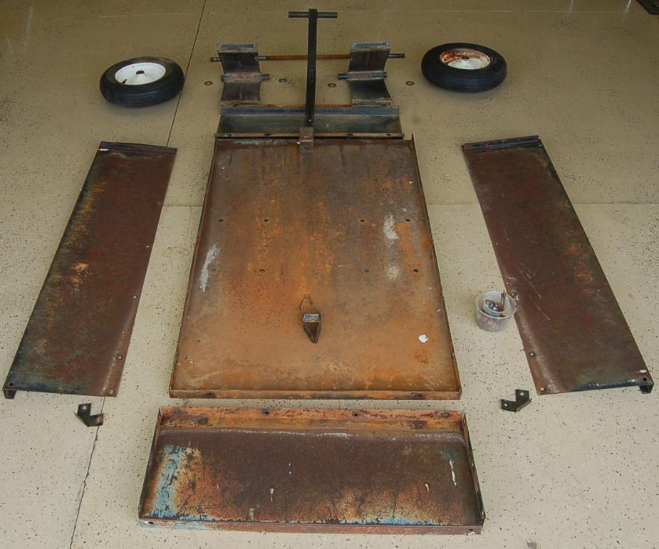

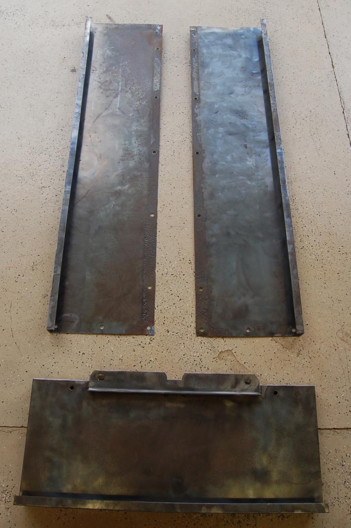

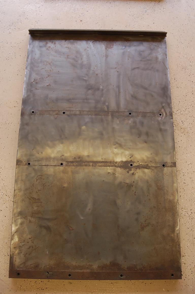

Today, the dump trailer story continues,
I wire wheeled all of the "box" sheet metal and
welded the few cracks and rust through holes....
Tomorrow I will pick up some Rust-oleum® Rust Reformer
and get at stopping the pitting rust and surface rust.

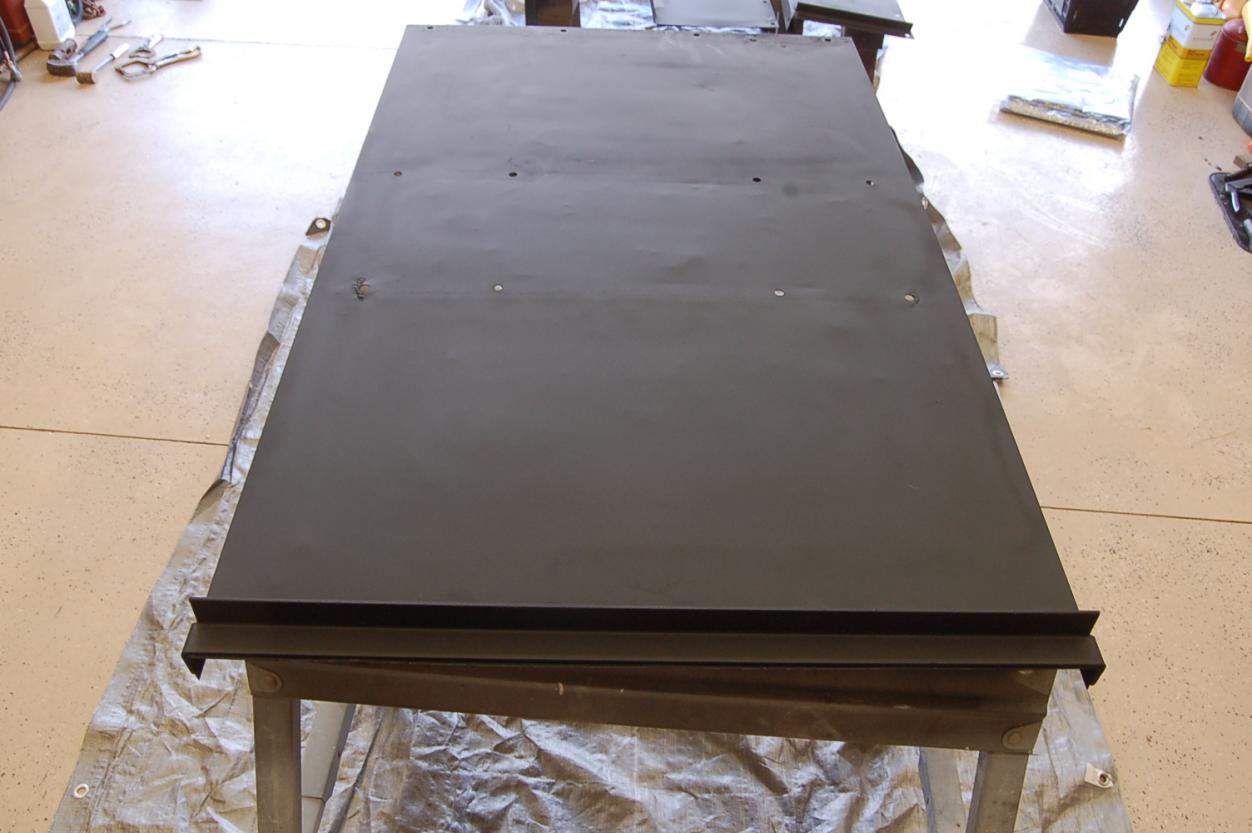

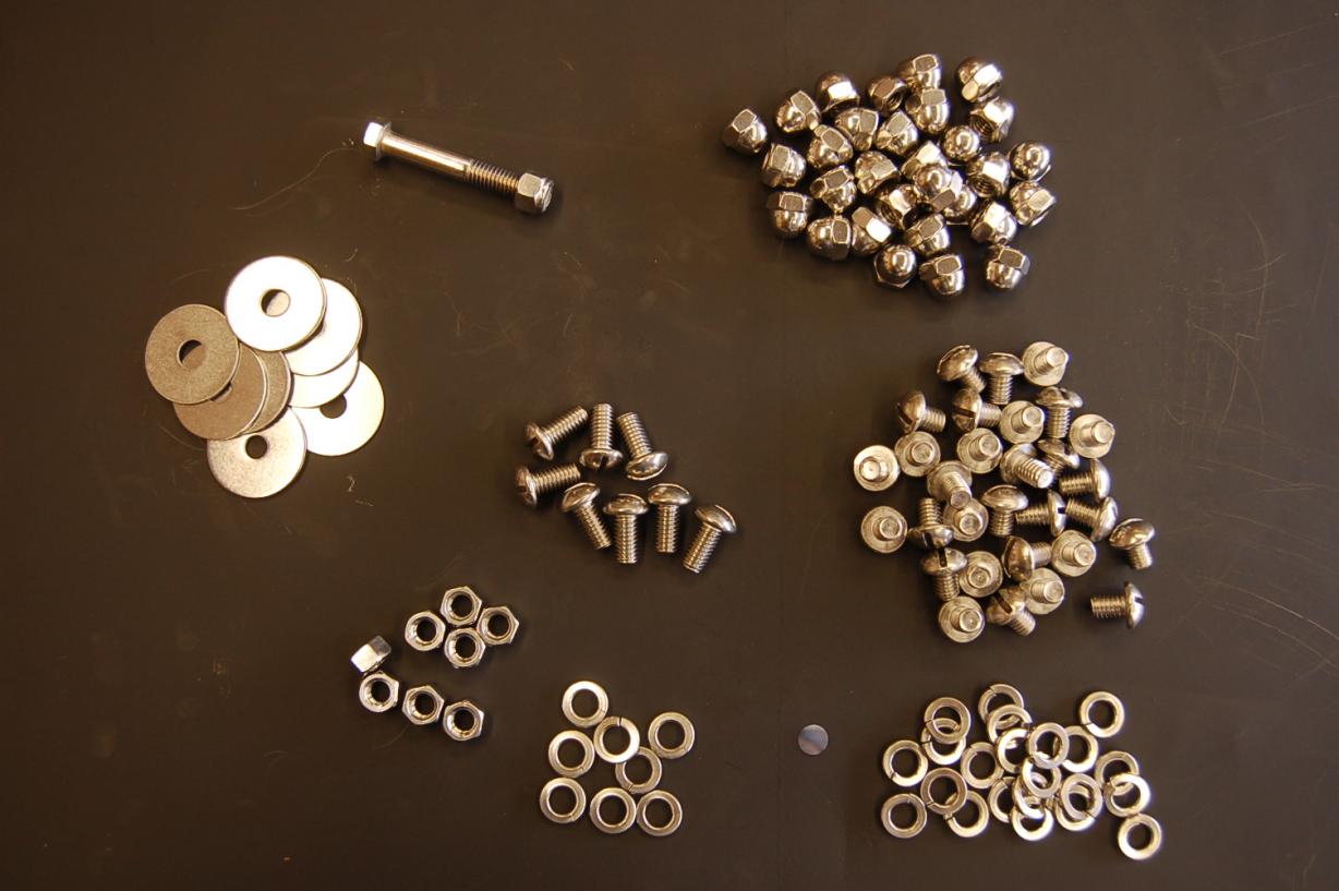

Got the bed sides and bottom of my dump trailer coated with Rust-oleum® Rust Reformer
and got all new stainless steel hardware for the re-assembly.

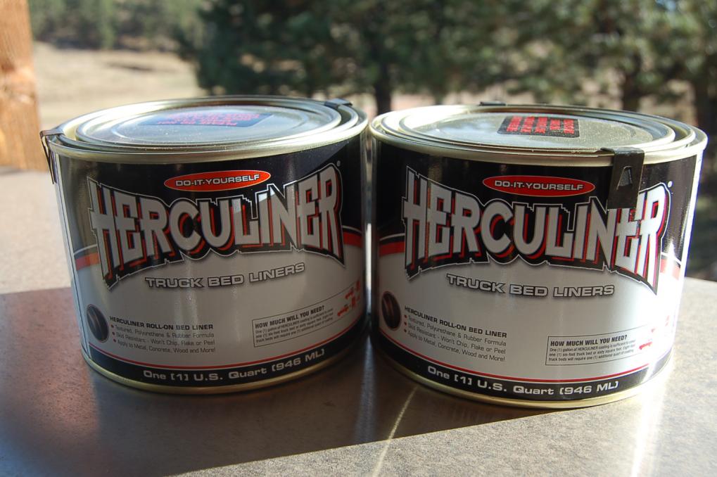

Hopefully tomorrow primer and paint and DIY bed-liner
