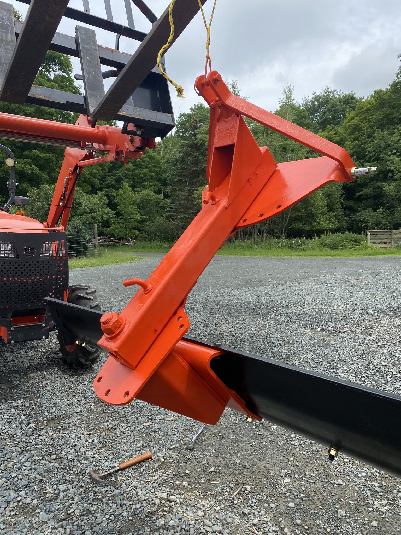

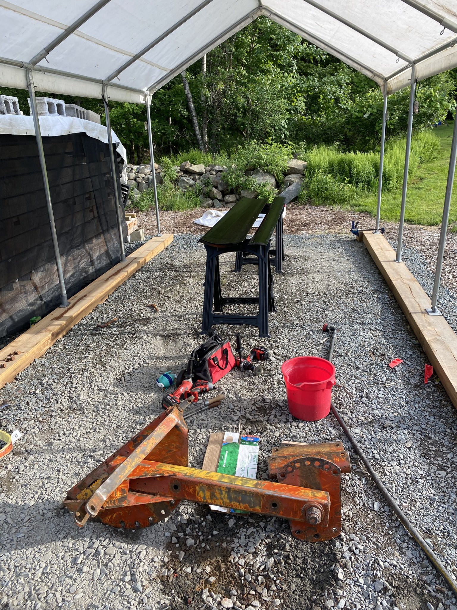

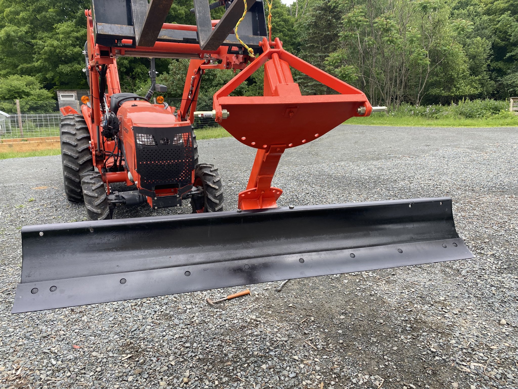

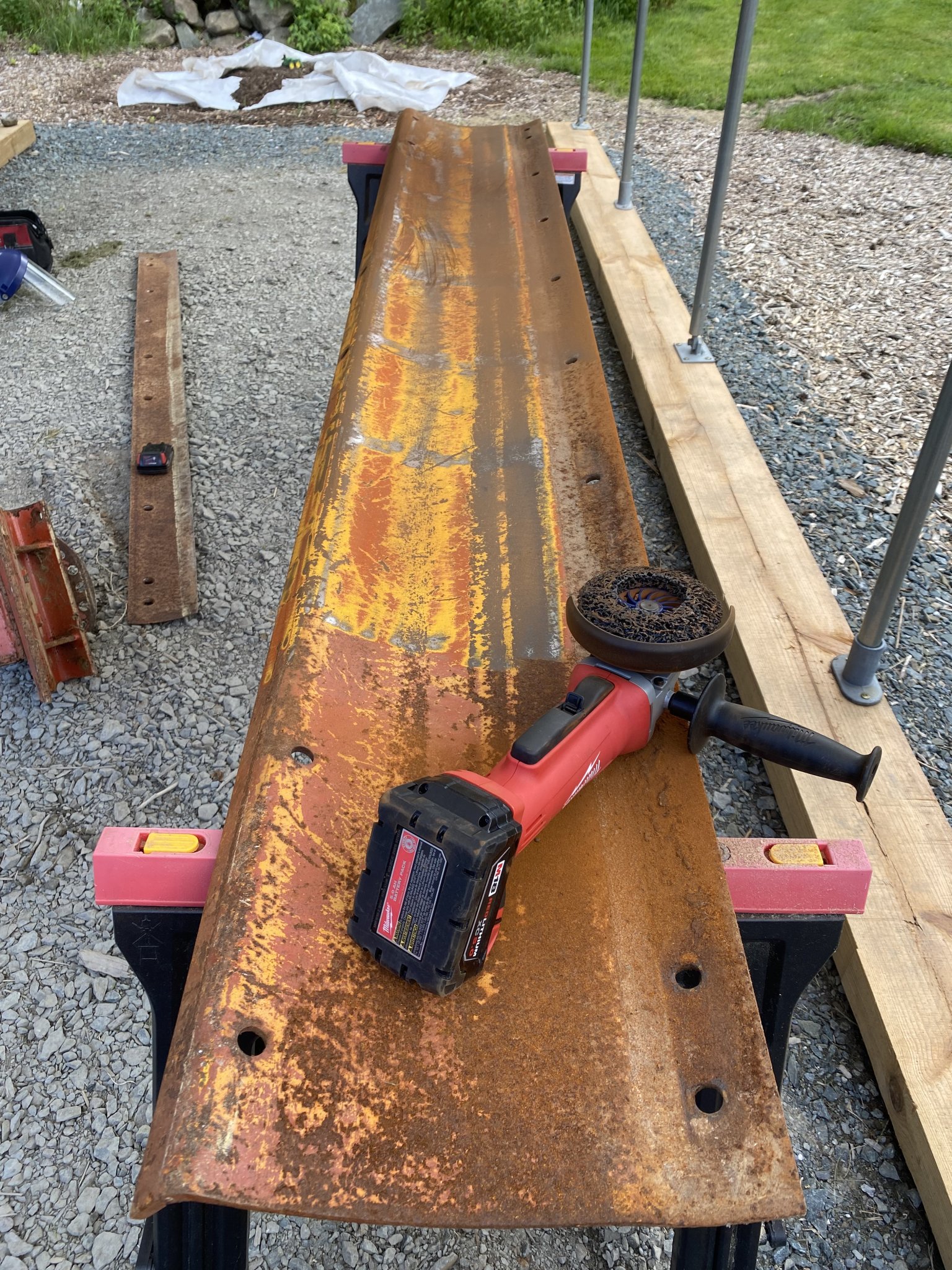

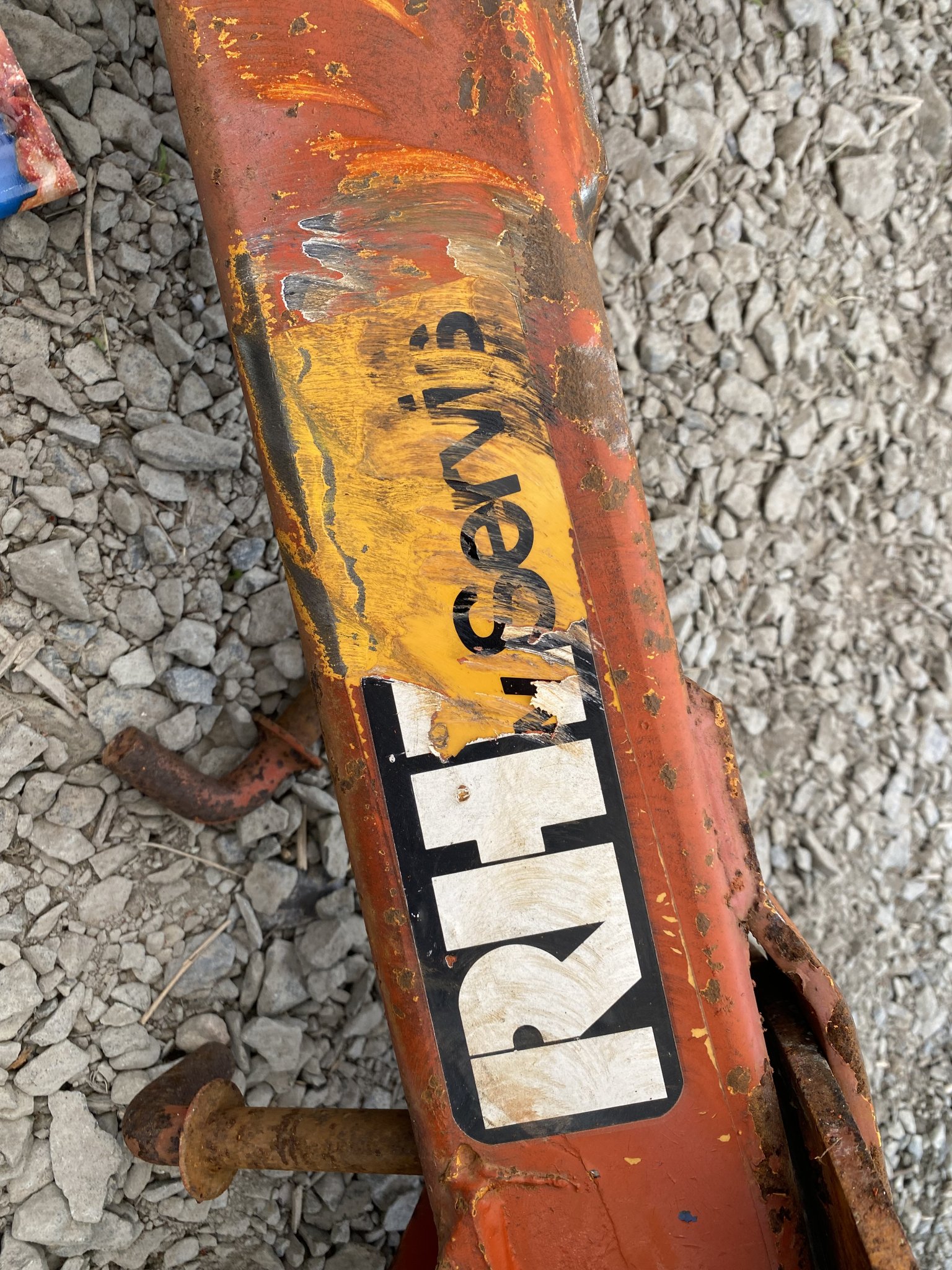

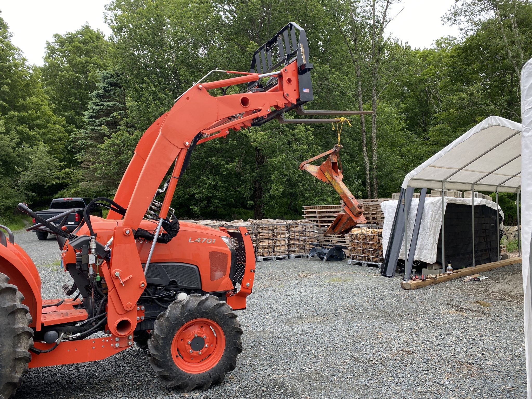

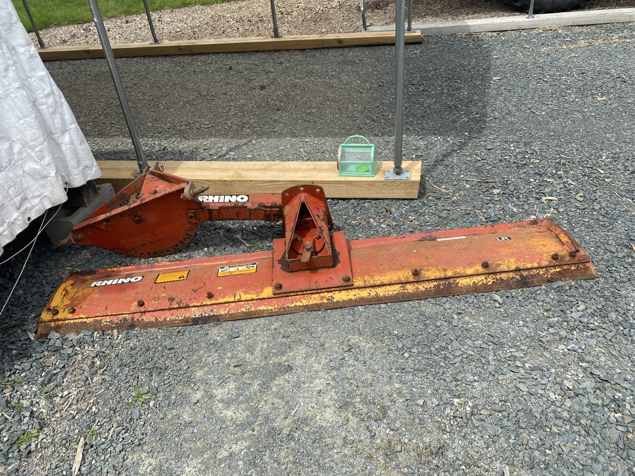

Today I finished cleaning up an old back blade I picked up for $400. I’m fairly sure the thing is as old as I am (from the 80s) and was in fine shape really besides the surface rust, so this was probably not necessary. But it does look better and this will hopefully prolong its life.
When taking the “Rhino” sticker off, I found a “Rhino by Servis” sticker underneath. I guess it was made right around the time of a corporate change.
View attachment 130829 View attachment 130830 View attachment 130831 View attachment 130832 View attachment 130833 View attachment 130834 View attachment 130836 View attachment 130837 View attachment 130838

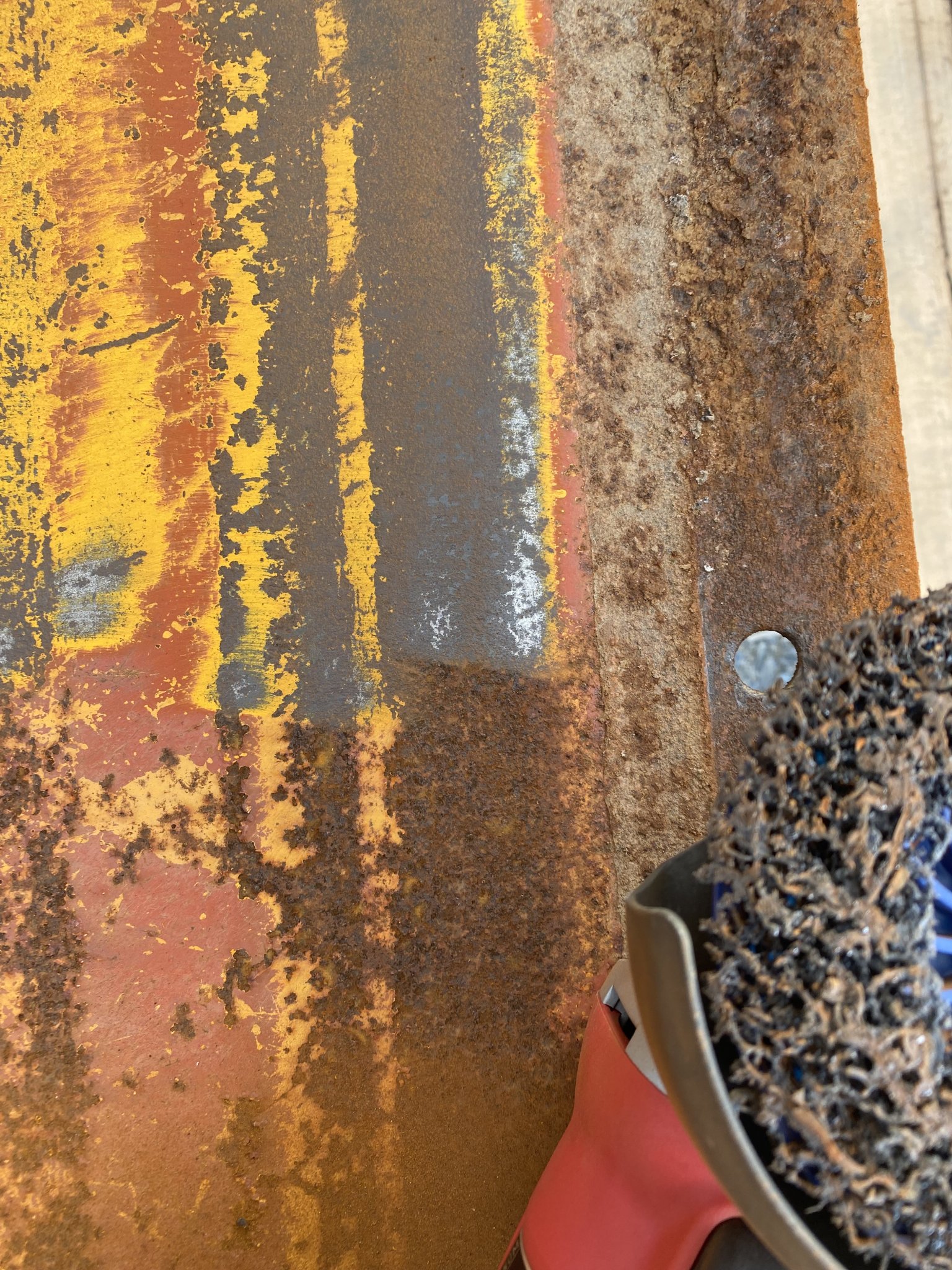

I cleaned off the rust first with a stripping pad thing on the angle grinder, which wore down way too quickly so I switched to wire brush attachment. Then I used some rust spray stuff (Rust/oleum brand spray gel, it worked okay). Then Rust-oleum farm implement enamel spray paint. Which so far seems not all that durable to me (I’ve already scraped some off, oh well).
OSPHO (Phosphoric acid) works best as a primer on rusted steel.
Yeah, thanks. The Rust-oleum is made with phosphoric acid. I wasn’t sure if there is a way to get it in a more concentrated or cheaper way? I’m open to recommendations for next time.
8,005
5,185
OSPHO is relatively inexpensive,.....often under $40 per gallon.
Available at hardware stores and marine supply stores.
I buy it by the gallon.

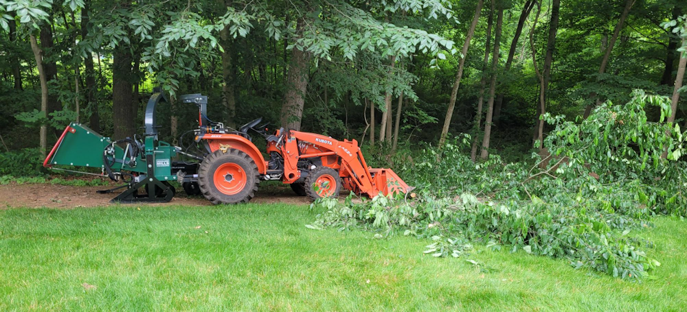

Ooohh, jealous. I have so many limbs to chip at any given time, I need to look more into one of those...
Your packing was incredible, as was the crate construction. Got the implements out and into secure storage, that's as much as I had time for given other activities.
I unloaded and assembled the wood chipper, adjusted a bunch of stuff, and made two boxes of chips for the retirement center gardens after adding cookies* to keep the weeds down.
Pictures and review in the WoodMaxx Chipper Sale thread.
*thin cut wood rounds

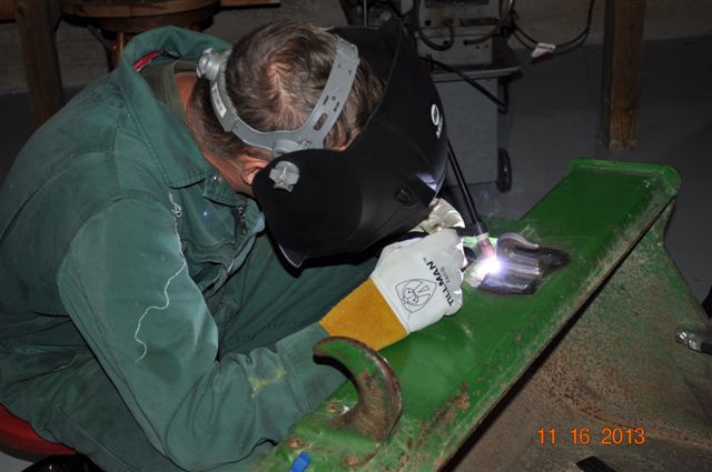

I decided to weld on some chain grabs onto my pallet forks. I had the first one welded on (with probably my best bead ever!) and the second one tacked on when my wife asked what I was doing. In the process of explaining how the chain grabs will work, I realized that I had welded them on backwards!
Oh well, I needed some practice grinding.
I had a friend do the exact same thing years ago, LOL. If you guys had only bought our Bolt-On's it'd be an easy fix 😂

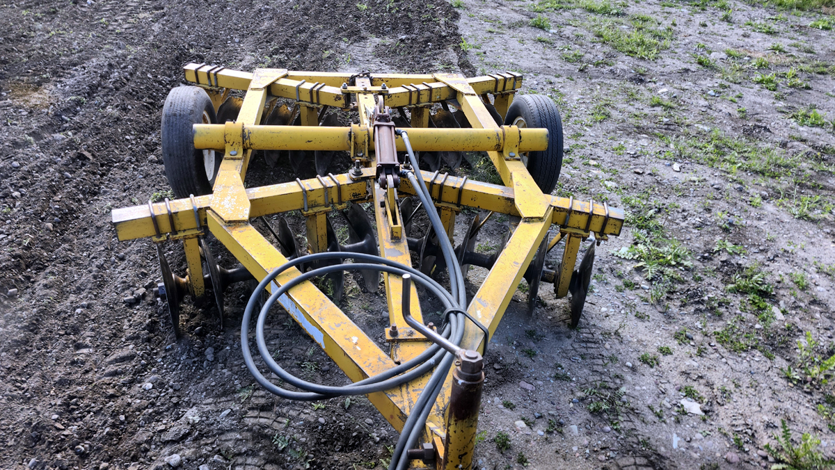

Yesterday I modified the Schafer disc harrow by adding a lunette ring to the tongue, and this morning made a pintle drawbar for the MX6000. Late this afternoon I spent 3 hours discing an area that will be hydroseeded this Friday. It was a beautiful spot, the owner was really nice and was very pleased with the finished product, and I got paid. A great day for sure. :)
The MX did really well pulling the disc and ran like a top. I ran the engine at 2,300 rpm and fuel consumption was minimal. The MX and the disc can turn on a dime, and the hydraulic lift is awesome in the turns.
The photos of the disc show the gang positions that I used. The last photo shows the starting position which was too agressive. I ended up reducing the angle of attack for the front and rear gangs and it was better after the adjustment.
