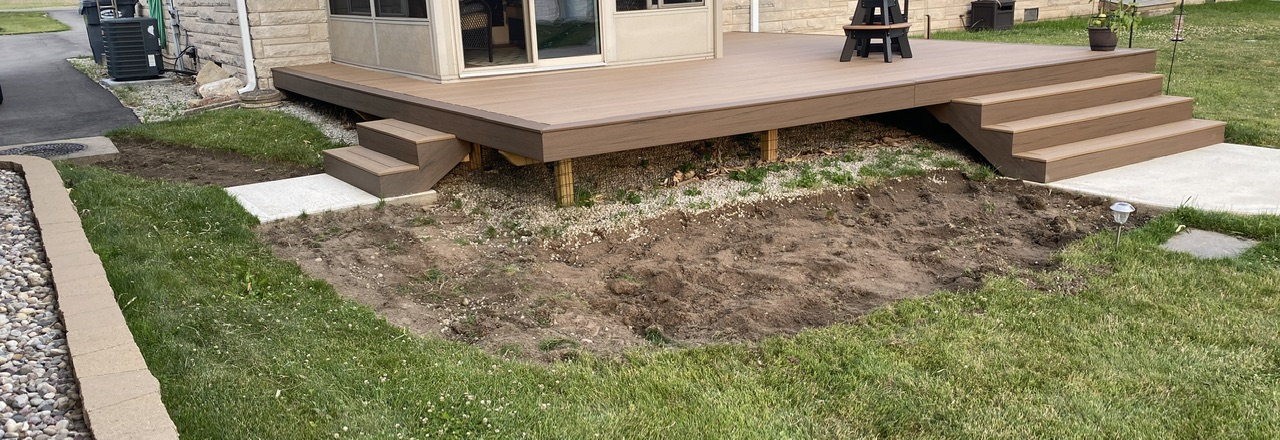

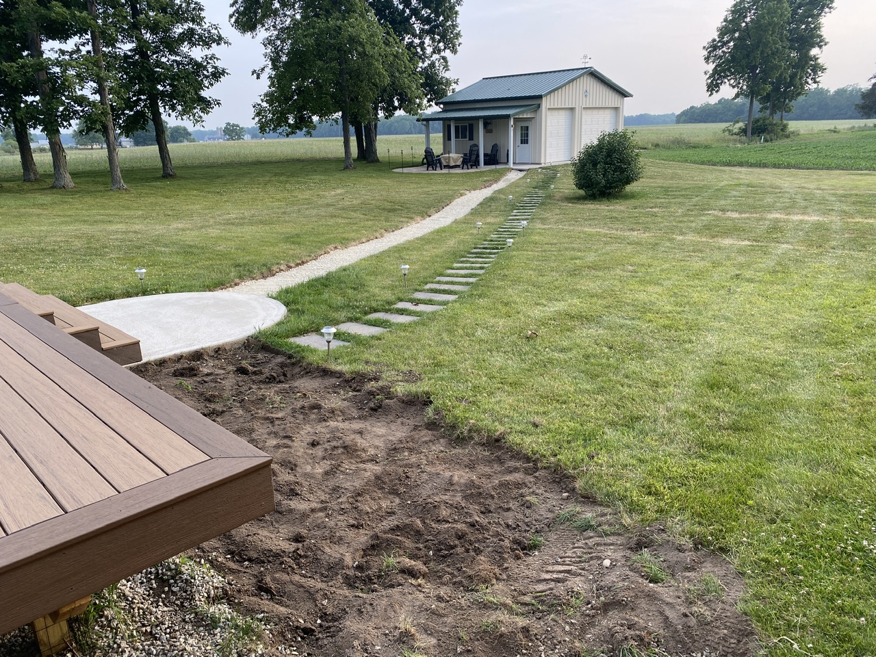

Used the backhoe on the BX24 to peel off the sod for a paver path from the garage to the deck landings. Picking up another 2.5 tons of #73 limestone tomorrow for the base for the paths. So far, I’ve got 5.4 tons on the 90’ path from the deck to the barn. Another 2.5 tons should be enough to finish everything.

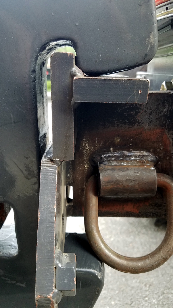

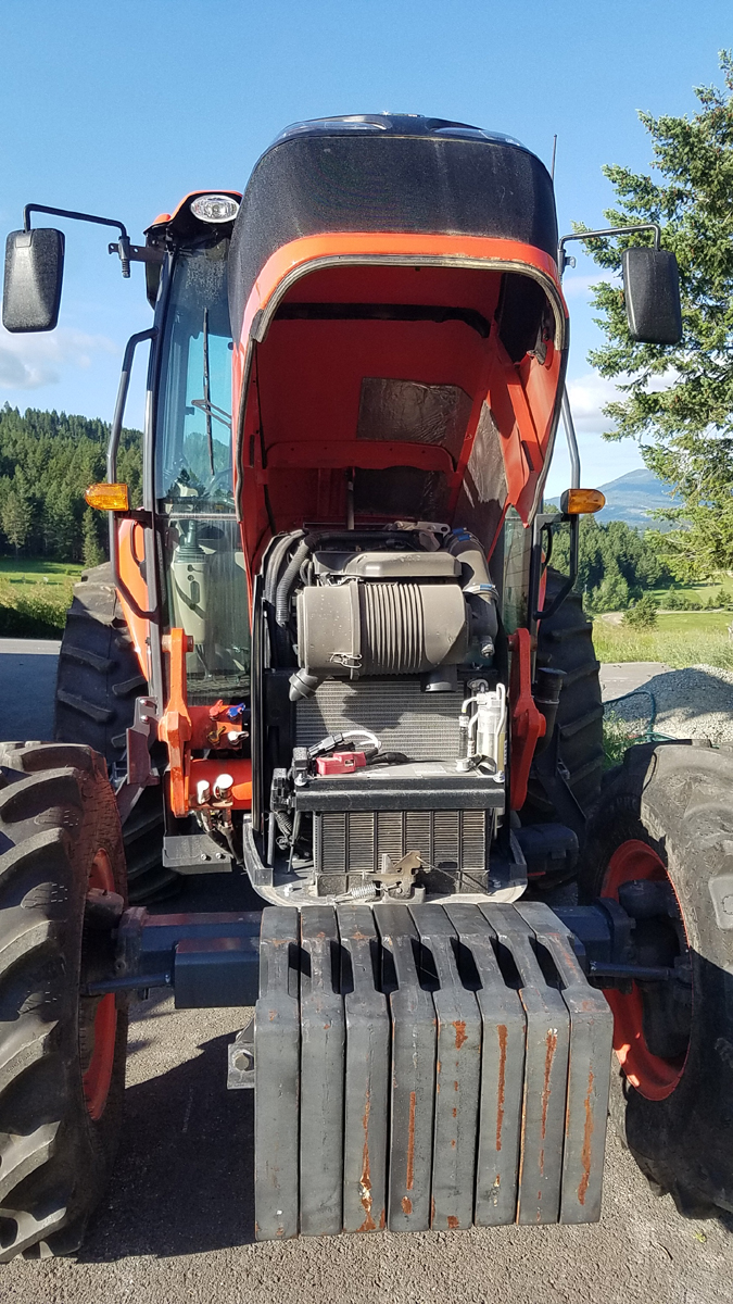

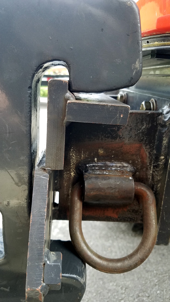

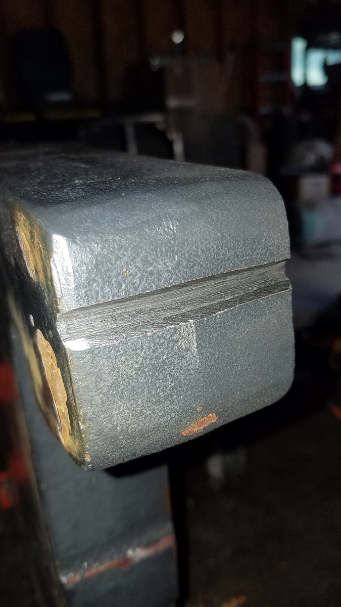

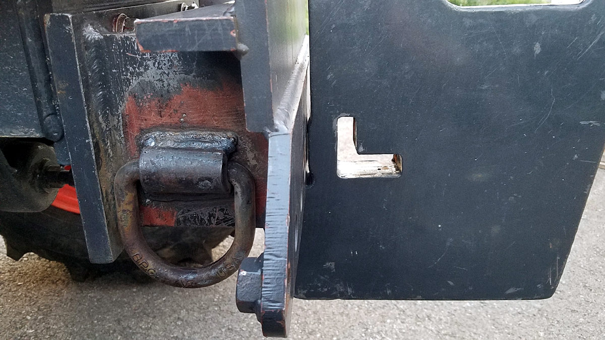

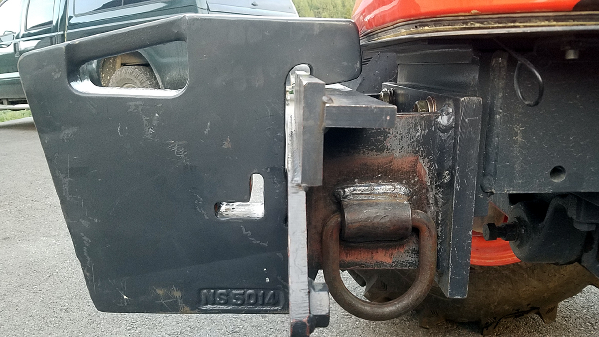

I was on the struggle bus most of yesterday. It started out ok welding two D-rings (repurposed) onto the front weight bracket that I bought last year. I used 7018 rod, beveled the loop to get good penetration, and made multiple passes. The D-rings are for trailering the tractor and so far that's the only part of this project that has gone well.
I thought that the Kubota weight bracket and Kubota "brush guard" would play nice together but that isn't going to happen. Initially I was supporting the brush guard with a floor jack and blocks and trying to lift up and bolt the weight bracket in place through the guard. That proved to be extremely difficult and finally I removed the guard only to realize that the suitcase weights won't fit on the bracket with the guard in place. I don't know if Kubota suitcase weights would fit but it's moot at this point.
Next up was to bolt the bracket to the tractor sans the brush guard. Not ideal but I can live with that and make up a custom guard or modify the current one over the summer in time for forestry work in the fall. So after getting the weight bracket installed I put one weight on and although there's minimal clearance between the weight and the hood it fits. Great, now to get the other seven weights on. Nope! The weights are a little oversized and they interfere with the steel lip that runs around the base of the hood. I bought the weights from Everything Attachments but they're made in India so it should come as no surprise that the "Kubota" weights aren't plug and play. Now I have to modify all ten weights by adding a groove or notch to provide clearance. I must have moved 3,000lb of steel by hand yesterday afternoon/evening getting the weights off the trailer, test fitting them and moving them back to the trailer. Who needs to pay for a gym membership!!

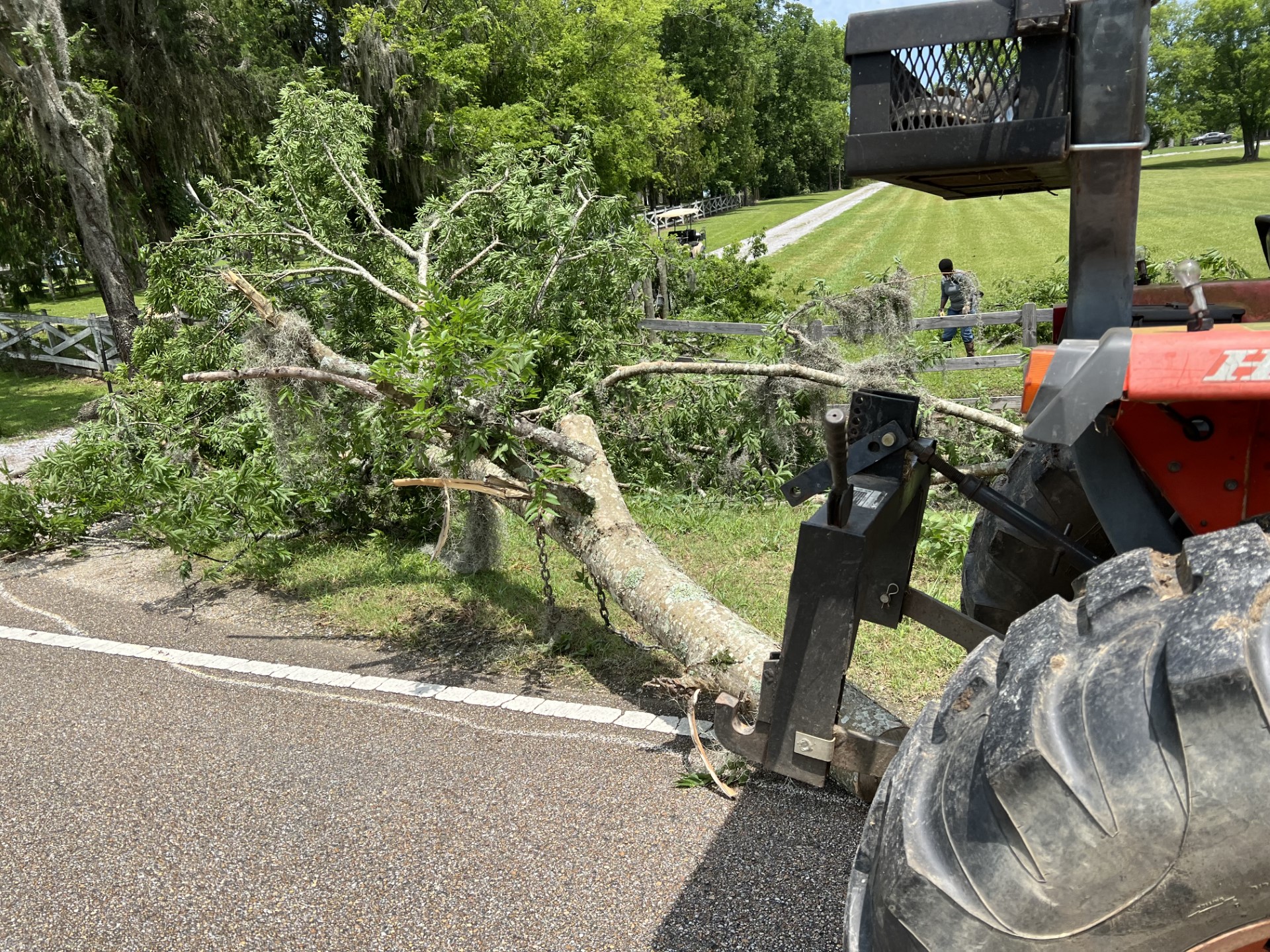

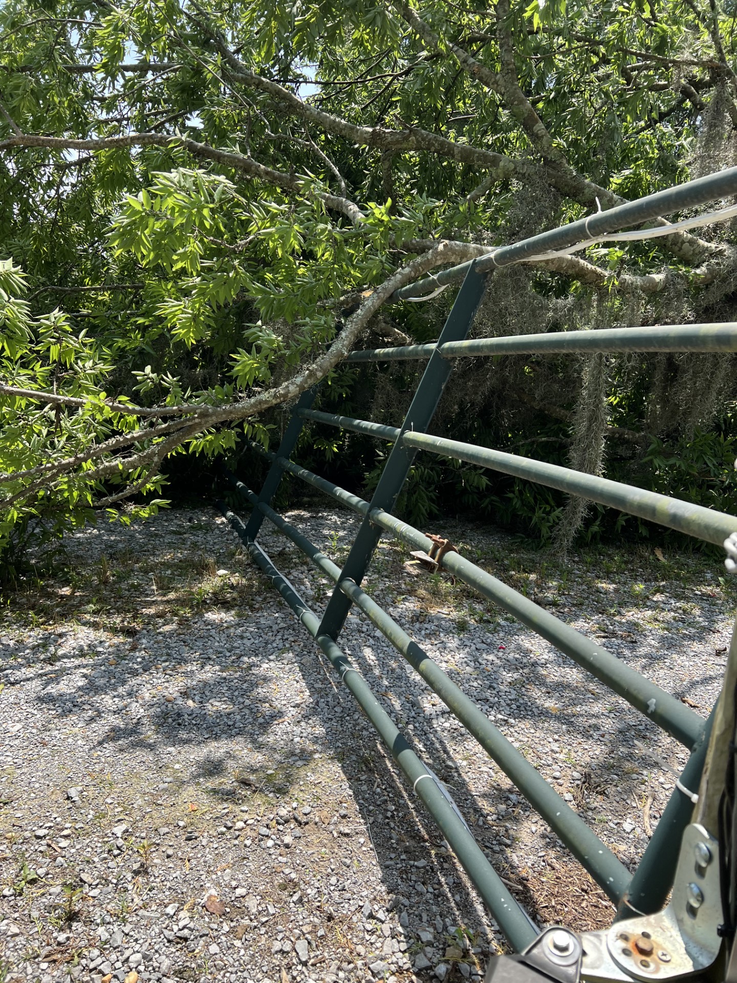

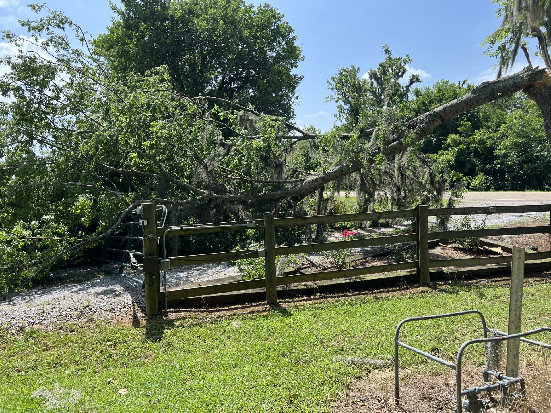

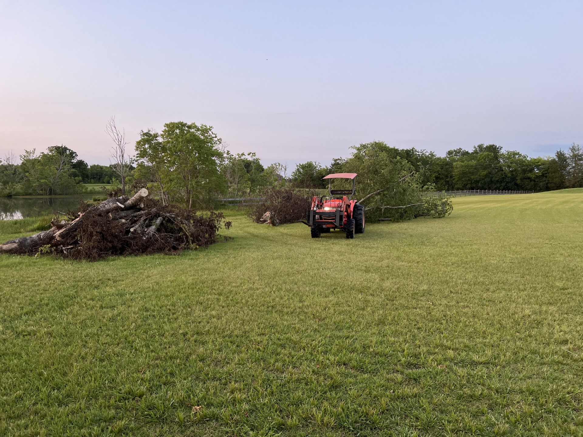

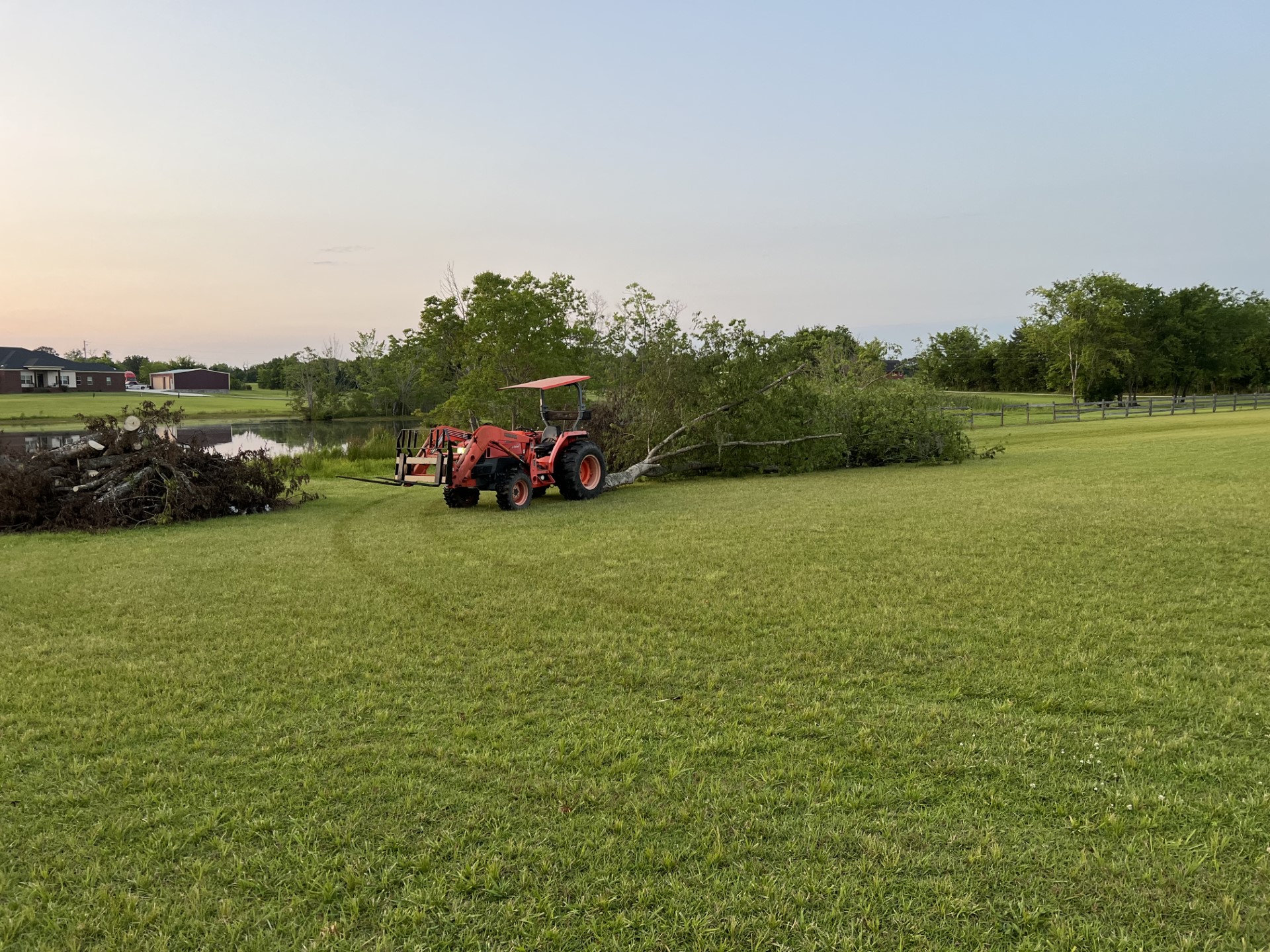

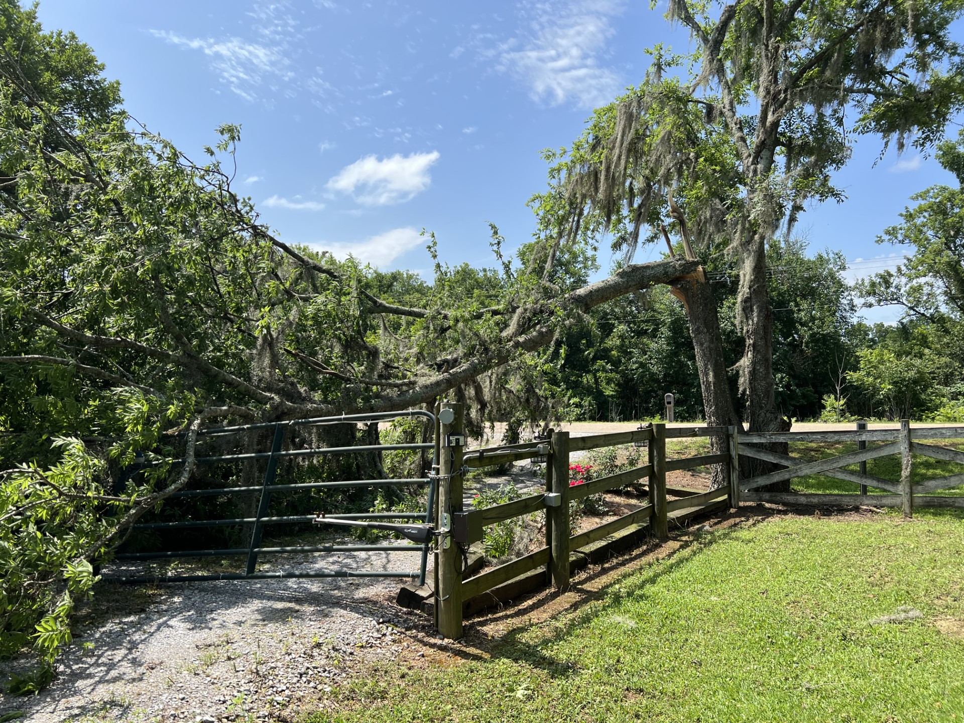

Had yet another tree fall this weekend. This one right on the gate. Those forks I purchased when the tree fell last week are worth their weight in GOLD.

Instead of grinding all the weights, can you install a couple washers to the bracket to allow clearance?
6,954
2,433
If it was me I would get a thick steel plate spacer and move the weigh bracket out and avoid interference with the hood when it gets opened.

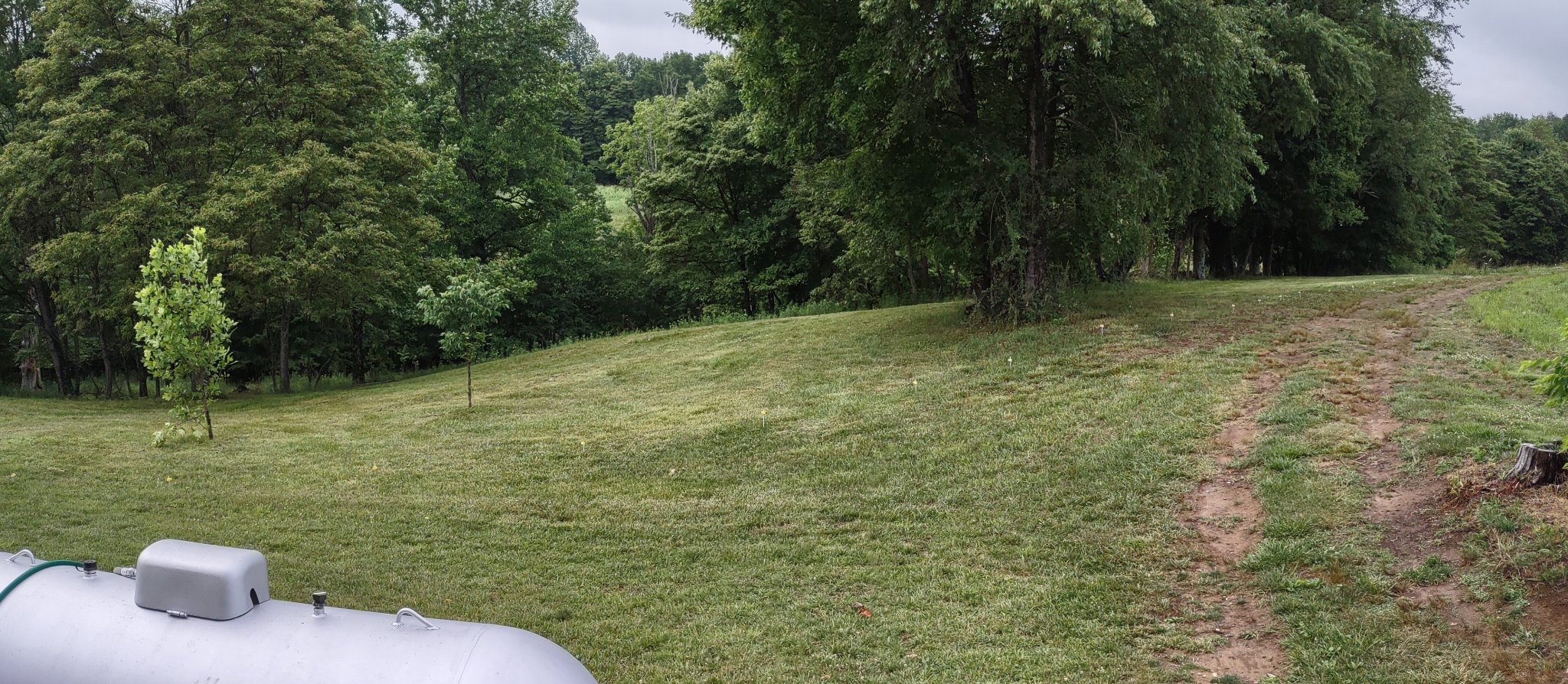

It rained today. The day before yesterday, I mowed field grass outside of our yard. It was about a foot tall since I mowed it last month. I'm getting better at not leaving high spots or scalping it. Lots of dips and humps. I need to get a hydraulic top link that can float.
That's a good idea but it turns out that only the two center weights needed clearance so I notched the backs of two weights. The bigger issue was that the fillet weld on the back side of the bracket was interfering with the weights and preventing them from sitting down on the bracket (see first image below). I fixed this by chamfering the appropriate edge on all eight weights. Fortunately the steel is fairly soft so it didn't take long.

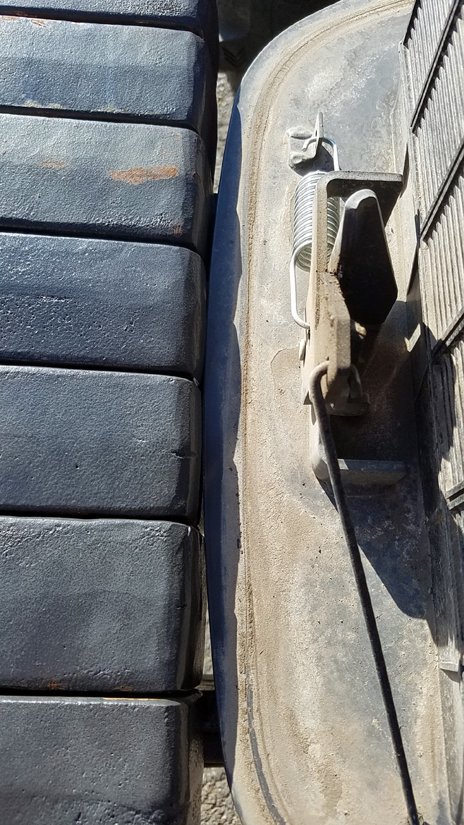

Yes, this is a good idea and something I'll most likely revisit in late summer, early fall. There's no interference with the hood. The interference was between the two center weights and the lip that the hood gasket compresses against when the hood is closed.
I might weld a spacer plate to the brush guard, and then weld the weight bracket to the plate and bolt the whole thing on as one unit (easier to handle with a floor jack as one piece) if this will give enough space for the weights to clear the brush guard. Another project for another day.

With the front of the weights so close to the hood, what will happen when you raise the hood if the weight is on? I am assuming the hood opens from the rear and will hit the weights as it rotates up but I really

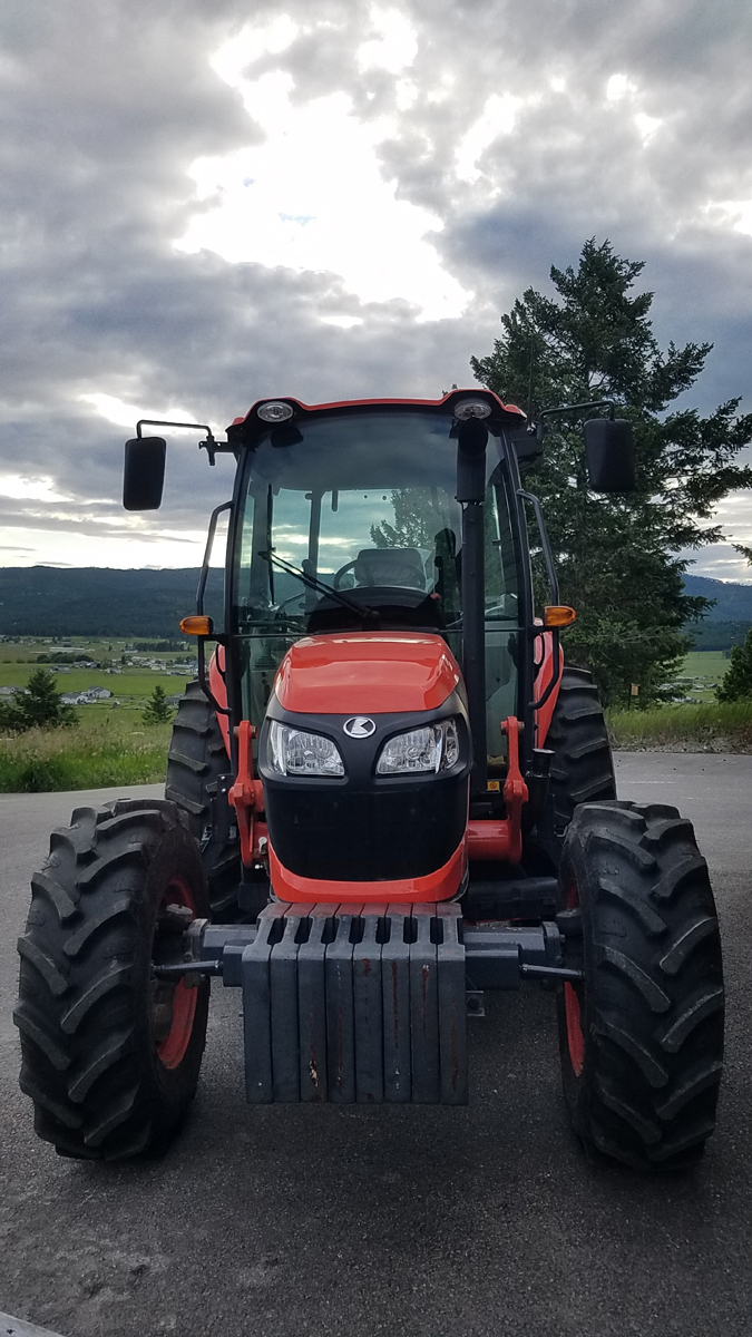

The hood opens from the front and there's no issue with raising or lowering it. I took some more measurements this morning and I would definitely need to add a plate (spacer) between the weight bracket and the brush guard if I wanted to have them on the tractor at the same time. At least I have something to think about moving forward. The bottom photo shows the steel lip that the hood gasket sits on when the hood is closed and that's where the interference is/was.
By the way, the paint that was applied to these weights is an absolute joke. I would rather they were unpainted so that I could apply paint of my choosing.

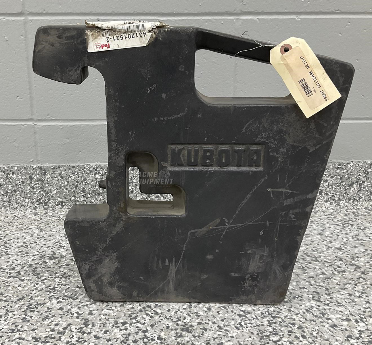

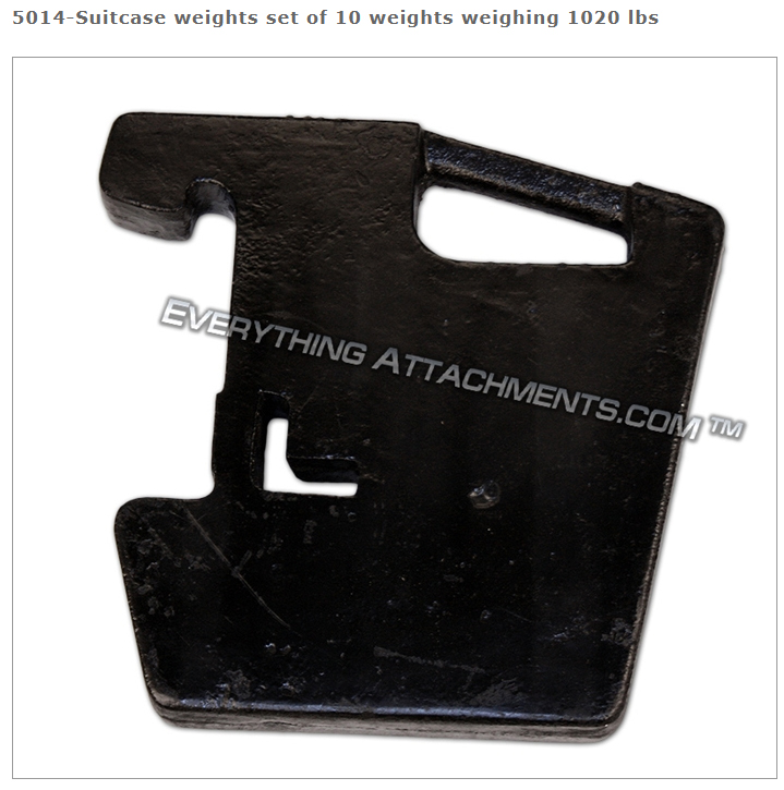

As I said, these are not Kubota branded weights and I have no idea if this would have been an easier install with factory weights. Here's a comparison of the EA Kubota weights for this tractor.

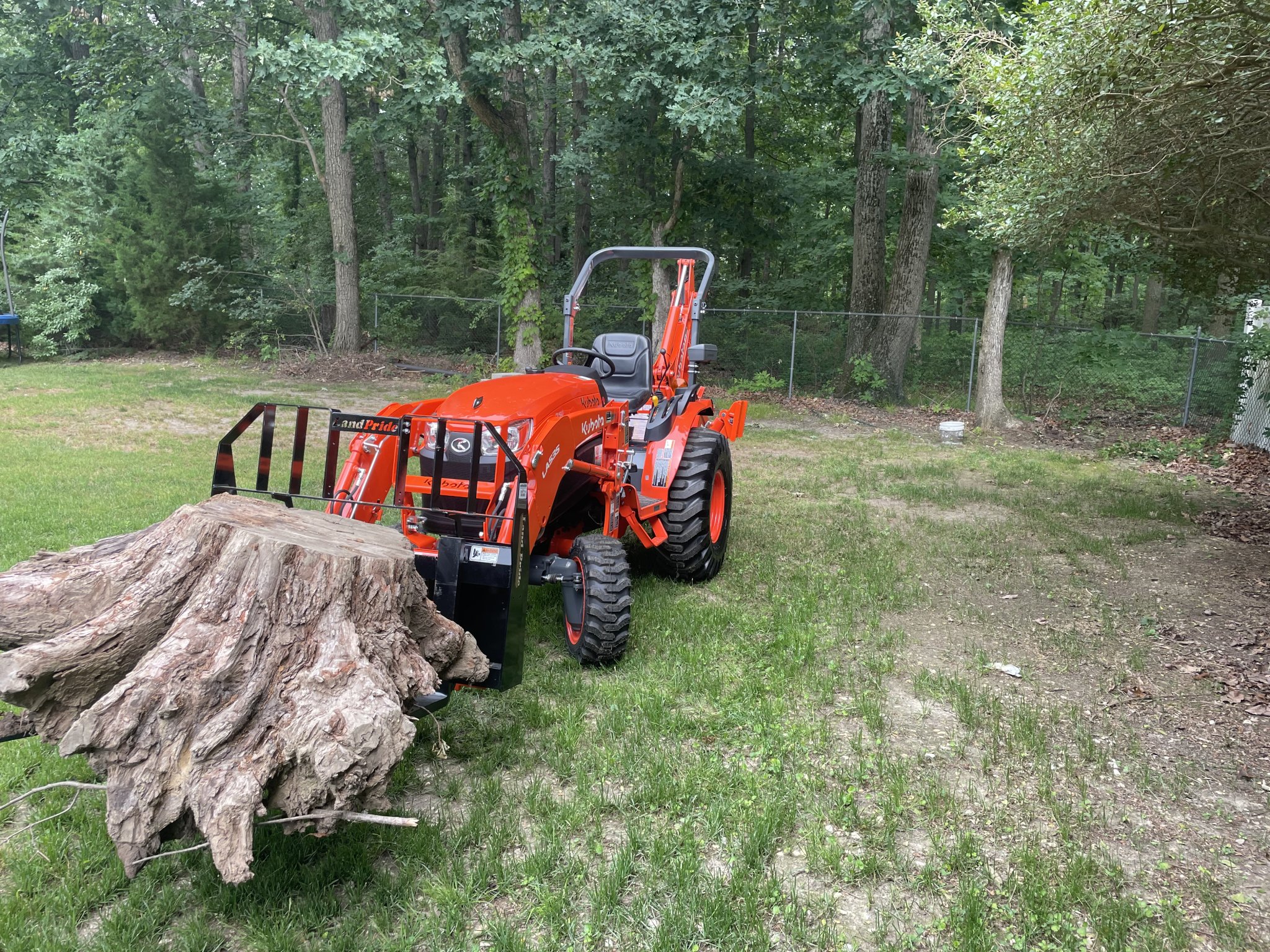

Brought home the LX today. Glorious day. Early test was picking up and moving a big stump the old BX could only dream about. It wont be hard falling in love with this machine
Well the hood opening from the front makes that work better. Thanks for the information
What is the 90 degree angle hole through the weight for?
The ones I bought from the dealer (but not Kubota brand) for my older L 185 have a bolt that attaches them to the weight bracket and a round hole in the weight similar to the angle hole in yours. I ran a piece of all thread through the weights and clamped them together with nuts to keep them together and red the movement of them slightly. But the paint on them was also poor quality
7,093
9,702
The 90 degree hole in the weight is for a piece of heavy duty angle to pass through, which bolts on either end to the weight bracket to keep everything nice and tight.
