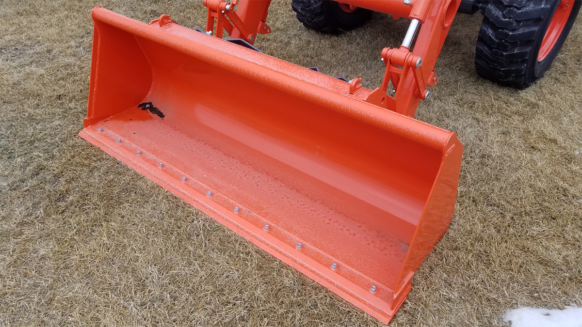

I don’t have those hooks but some hooks I welded on.
The local dealer welds two hooks on all of the buckets on the tractors they sell. They do such a nice job that I assumed it was a factory installed feature, but learned through this forum that it's not. Turns out the dealer in Sheridan, WY doesn't weld on hooks, so I still need to buy and weld on hooks on the bucket that came on the M6060.
Here's a bucket on an MX6000 that was sitting out front around the time I bought my MX6000 open station that I sold after a year.

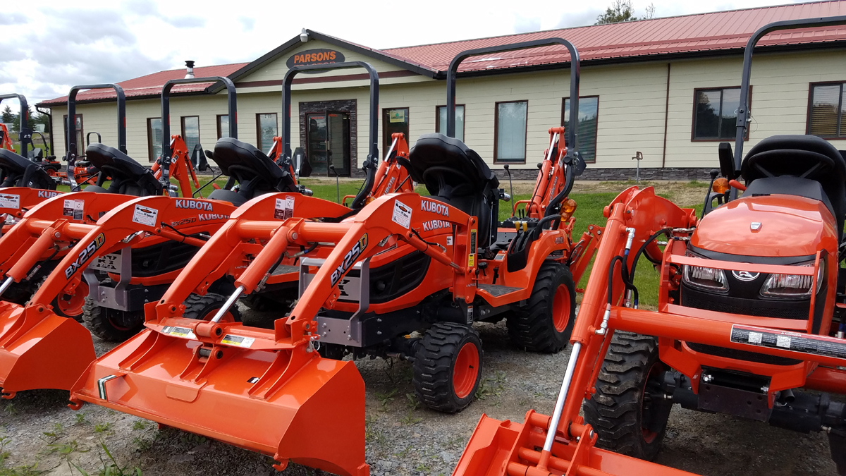

I'm a pack rat with photos and here's a photo that I took on May 31st, 2016 at the local dealer. I bought a BX25D in early June of 2016 and can't say if the one in the center of the photo is the one I bought, but you can see the welded on hooks on the bucket.

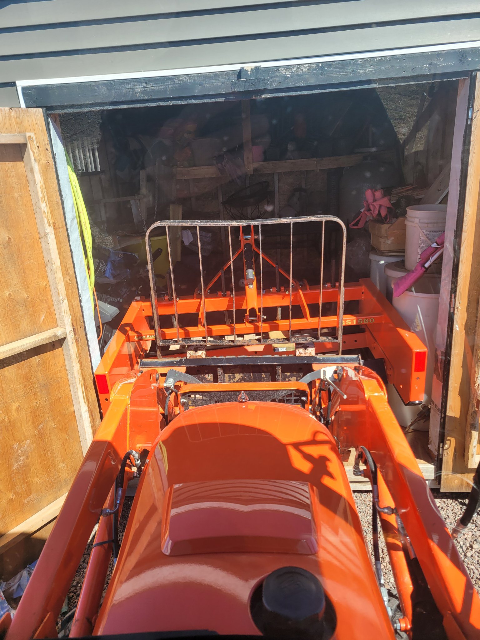

Winter has finally faded away [I think/hope] and the driveway mud has dried up enough to tractor again so took off the plow and the chains and put the bucket back on for some spring clean up.

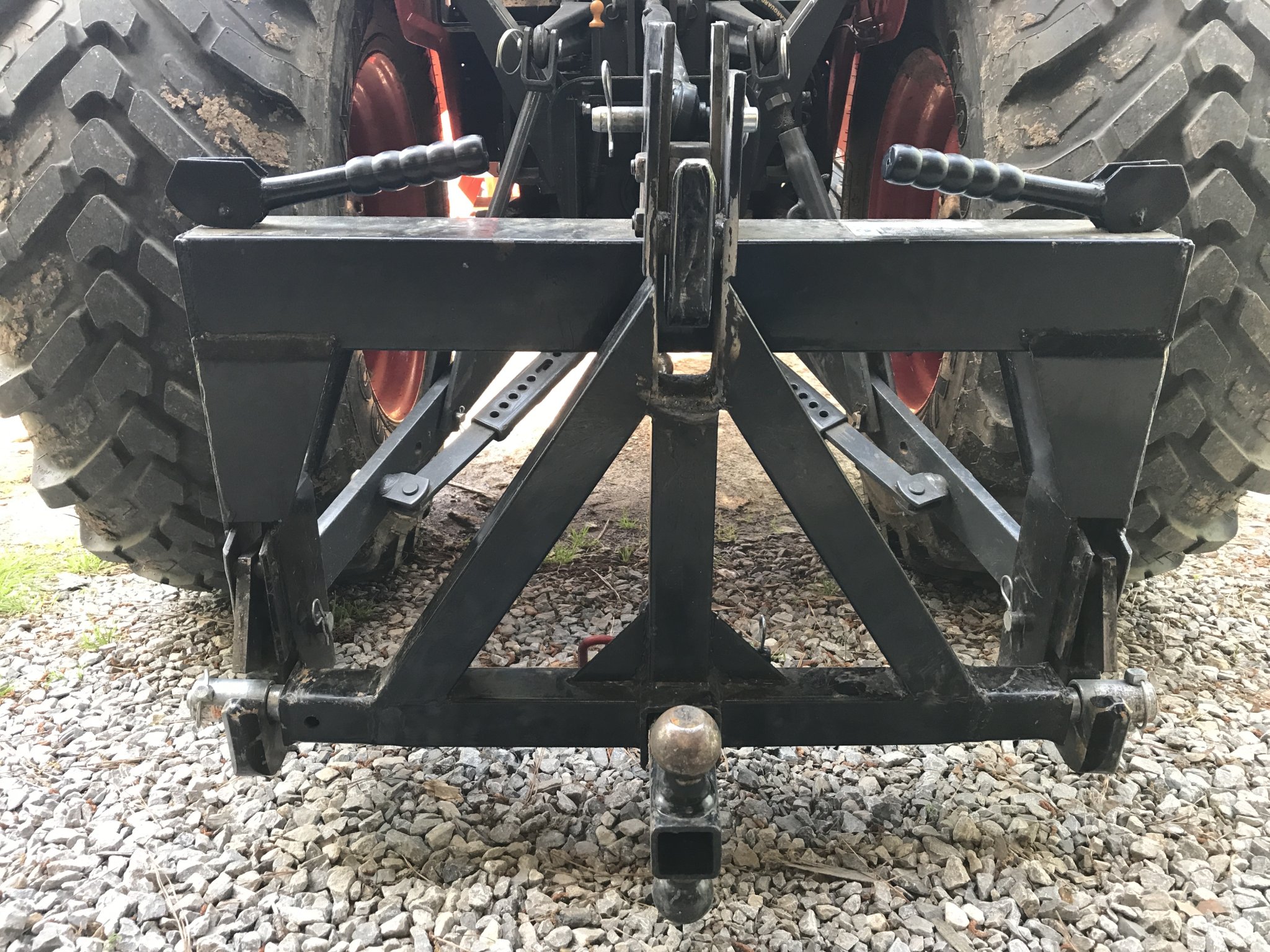

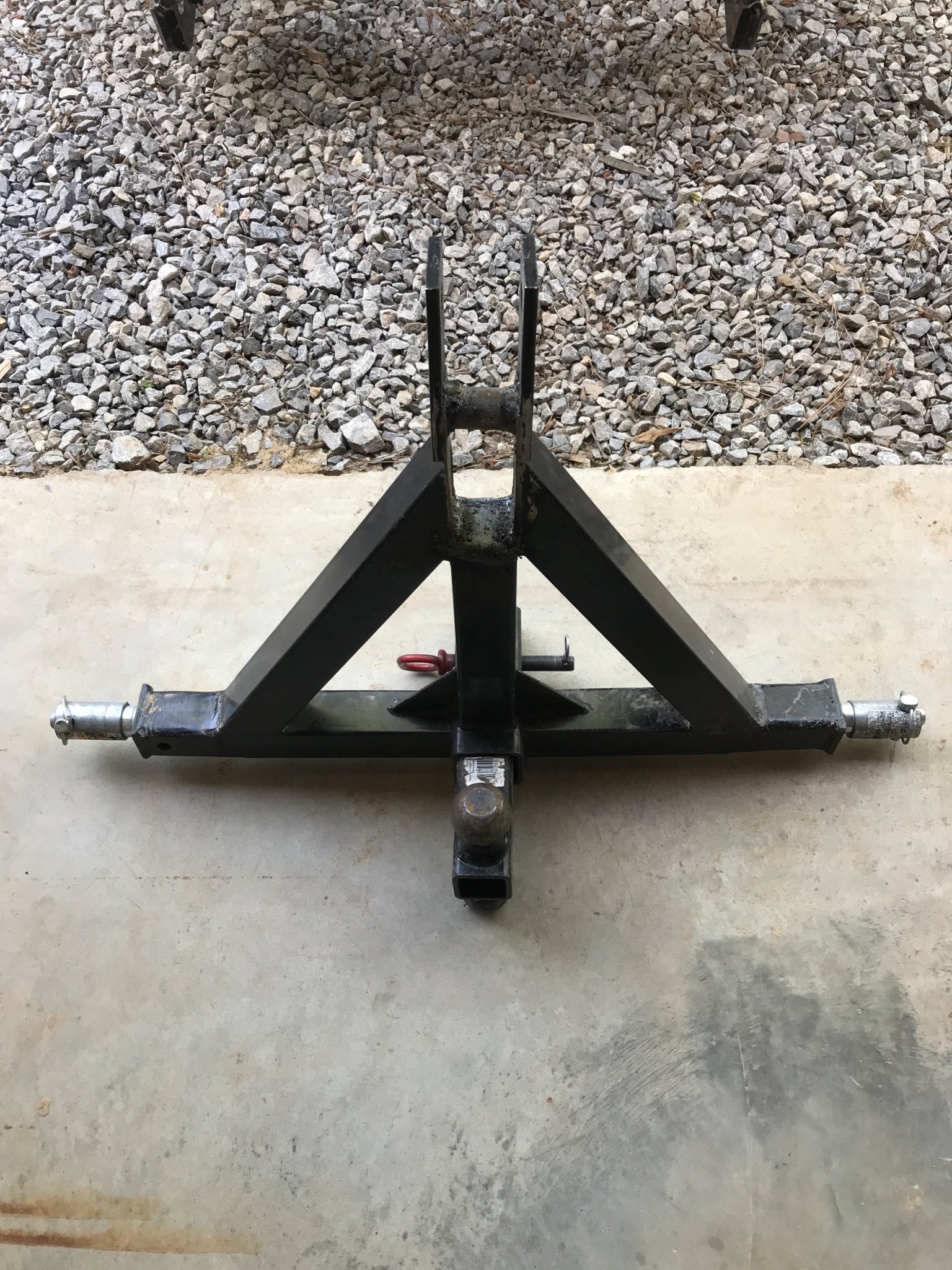

Modified my receiver hitch so I can put it on the quick hitch instead of swapping them out for the few minutes I need to move the trailer with the LX. The cross member carries all the weight, top point is only to keep it from rolling. Cut the center vertical box beam to accommodate the hook, and welded a piece of 1/2 steel pipe at the right height for the hook to hold the top. No pin necessary. Fits great. Worst case, I kill a $80 receiver hitch. Best case, I don’t have to take the quick hitch off again. Needs a little sanding and paint, but otherwise done.
Gotta get some more Cat 1-Cat 2 and Cat 2 - Cat 3 bushings. The bottom hooks on my quick hitch are Cat 3. Pins on the receiver hitch are cat 1. Not my first rodeo with this issue. TSC has exactly what I need, and we have a brand new stove a lot closer now.
