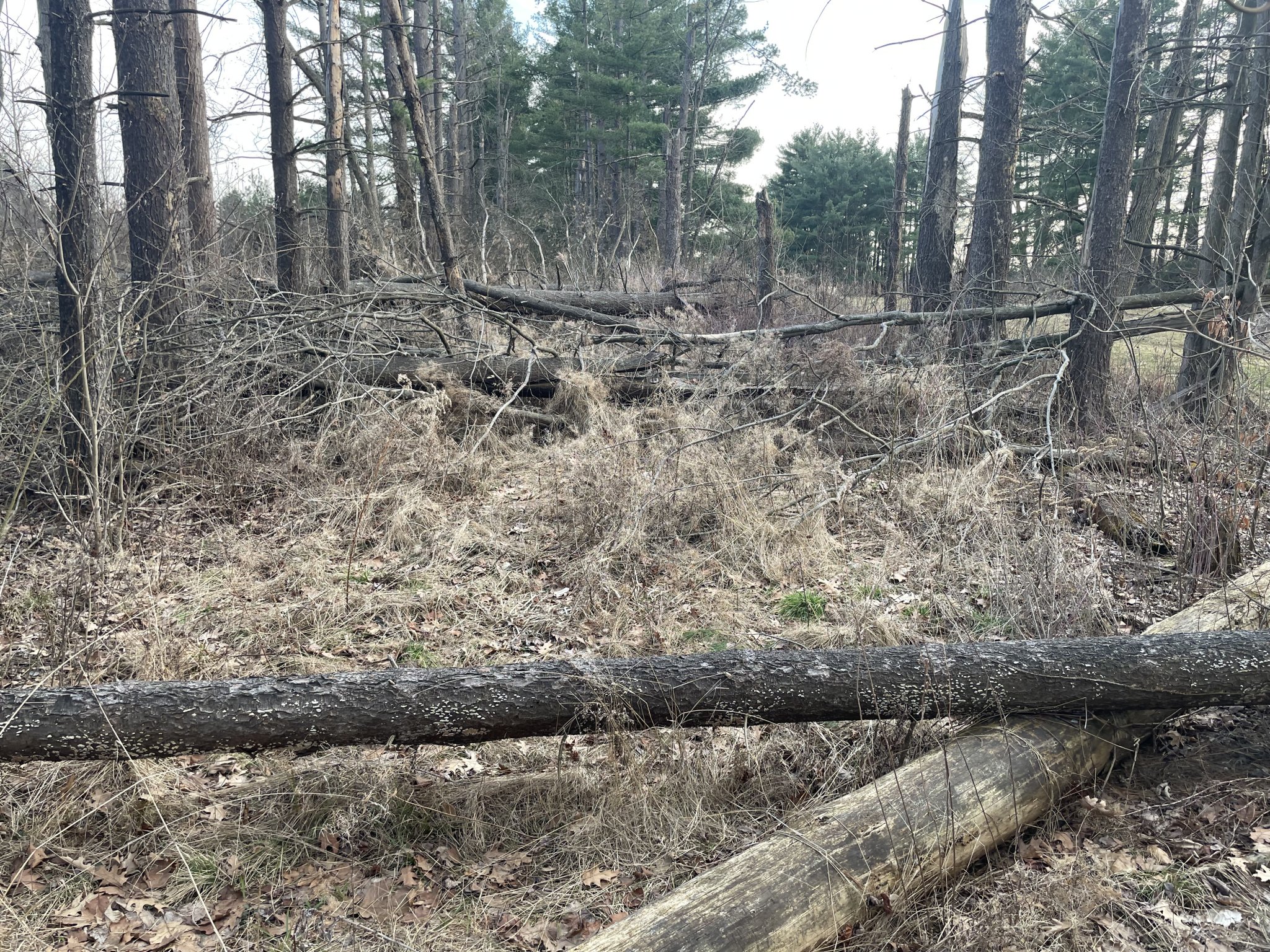

Not finished with clearing this trail but a nice dent. Still have maybe a dozen trees blocking then I’ll have to fix the ruts which should be quick work with the box blade.

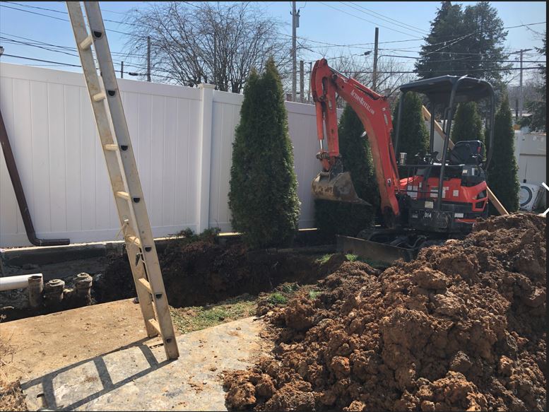

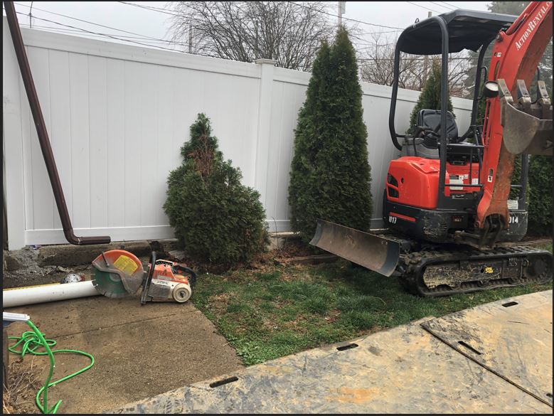

Ok. Broken waste line today. The KX and B2650 were both too fat, so, a rented U-17 got the call. Couldn't squeeze it through the gate, so a section of fence had to be dropped.

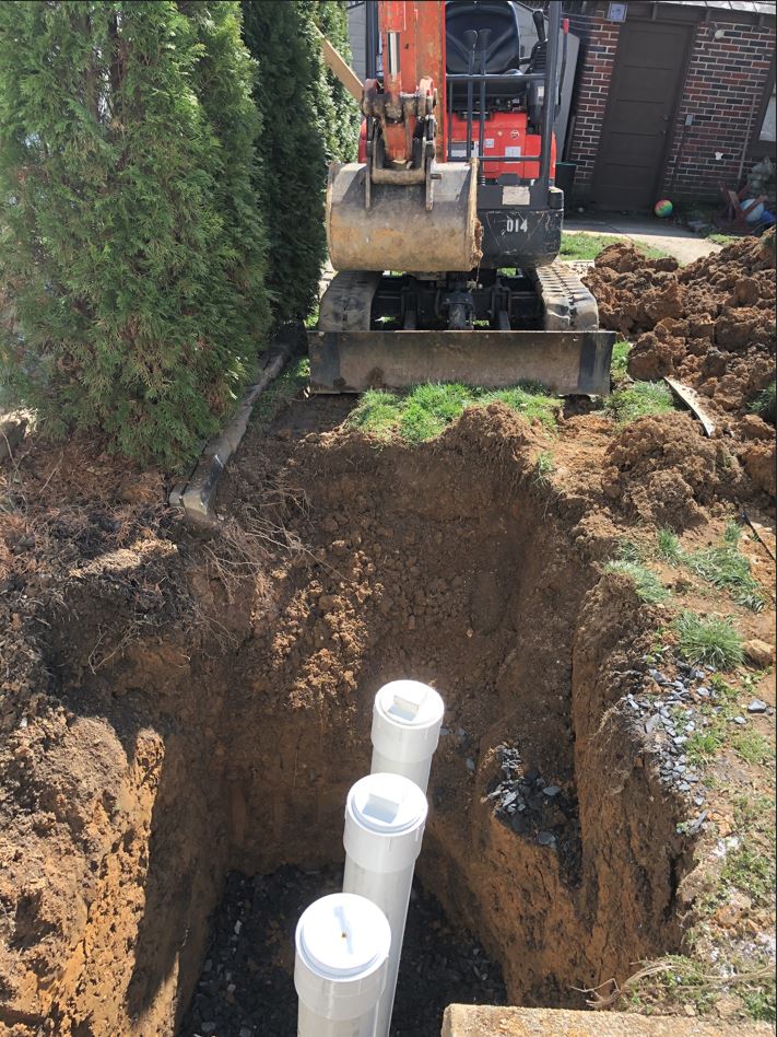

New poop line:
done...well, I didn't get a shot of the backfill job. Too tired and back was aching a bit.

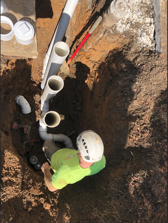

Can you explain why 3 risers?
clean out up?
clean out down?
Valve?
And if a Valve why?
Wolf, first two risers are for the house trap (and vent, the first in line will have a vented cap). The third riser is for a two way cleanout. There is a two-way cleanout Tee lying in its back. All are required here by code.

That's interesting, maybe that's a municipal sewer line code, or local code?
As our sewer line from the house to the septic tank hook ups don't get the trap or the vent just a cleanout every 100', I have three as my tank is 250' away from the house.

“Wolf, first two risers are for the house trap (and vent, the first in line will have a vented cap). The third riser is for a two way cleanout. There is a two-way cleanout Tee lying in its back. All are required here by code”
I assume you are counting starting at the house but please confirm what side “first” is on. I think my assumption is wrong.
Here in Texas I have never seen that arrangement before, there is usually a clean out at the house and lately another near the street in municipalities. The vent is for sewer gases (assuming again) and here that’s through the house piping". I th If the vent is nearest to street then the trap, the the sewer gas would not be inside the house piping if the trap is properly full.
Please explain the arrangement in more detail

Correct, septic systems typically don't require the trap. We just put a 2 way cleanout in them if they ever needed to be jetted.
Correct. for connections to municipal sewer. Not required for septic systems here.
I'm betting in Texas, you don't have basements....
In most of the older homes here that are connected to municipal service, the house trap and fresh air inlet are typically in the basement. We simply eliminate them from inside the basement and move them to the exterior. That way, they can be cleaned (jetted) from the outside if necessary. The older stuff is all cast iron as well. The pvc replacement will last quite a bit longer as long it was primed and glued properly. You'd be surprised at just how many we replace that were never primed.
