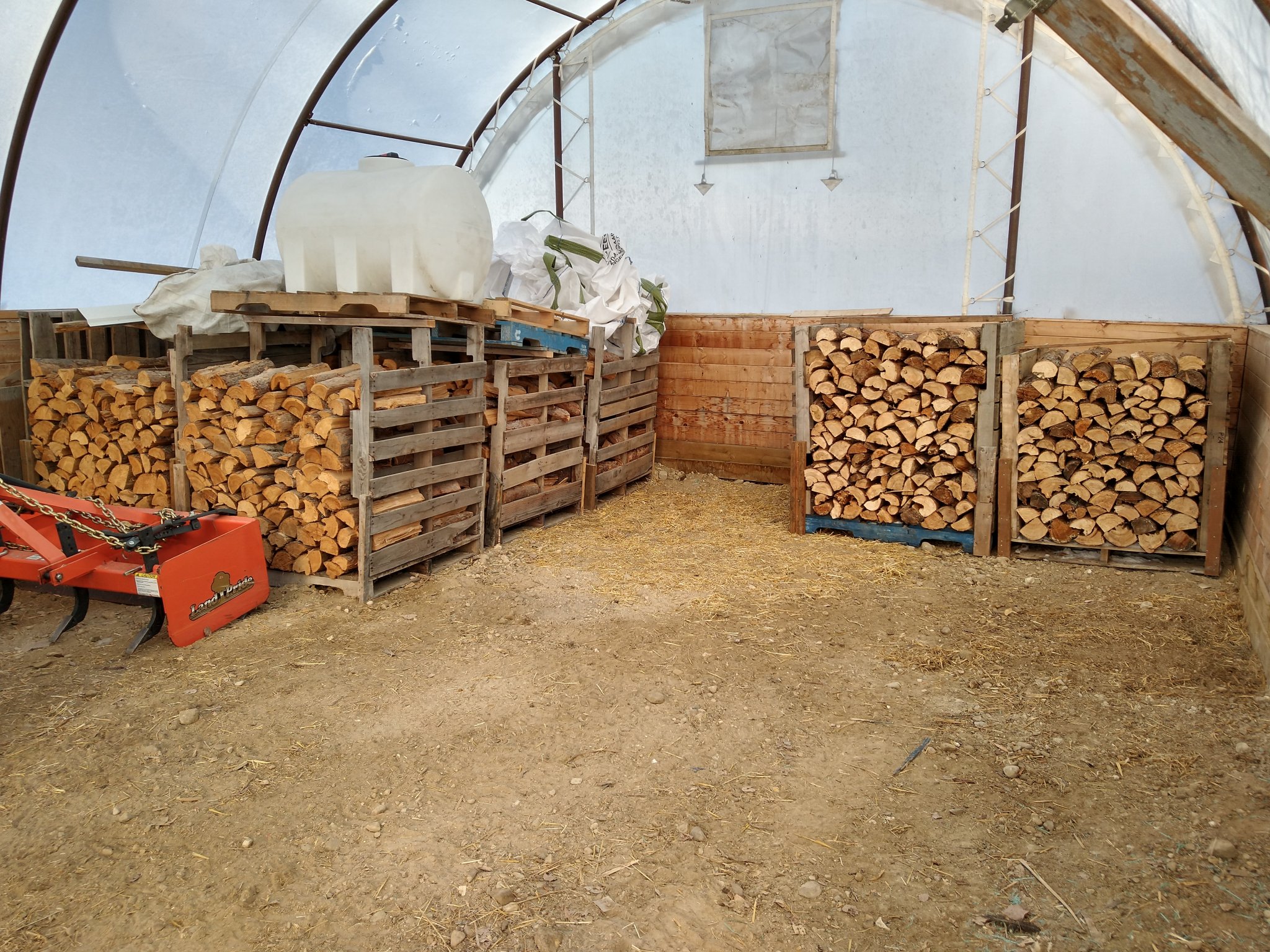

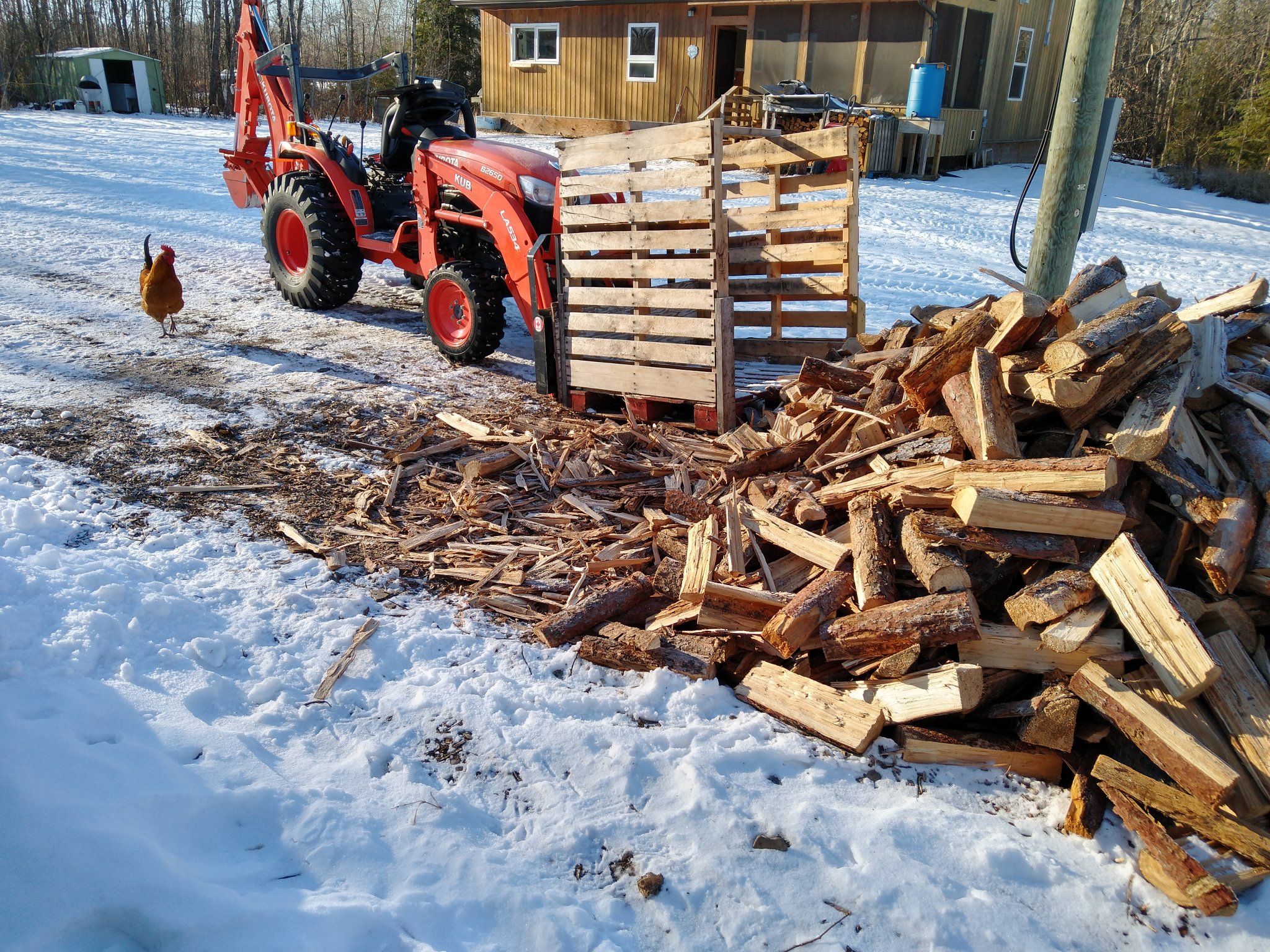

Time to pile this year's fresh split green Tamarack into the drying crates. That's Sparky the rooster guarding the operation.
Then fork them into the hoop shelter to dry for at least a year.

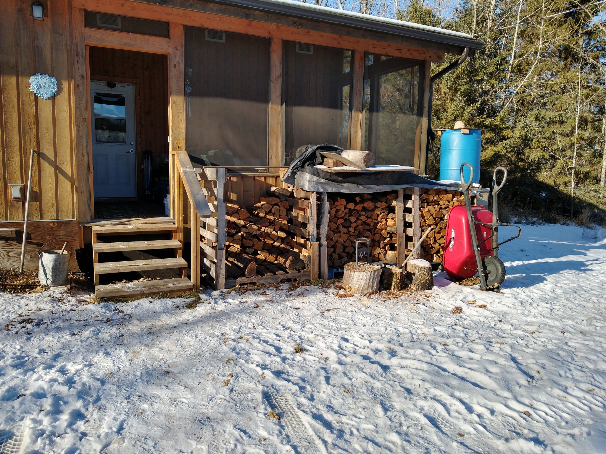

Then its set by the front door. This firewood pictured by the door had spent 2 summers and a winter in the shelter. Makes for an easy to ignite, long and clean burning, low ash fire, the best imo.

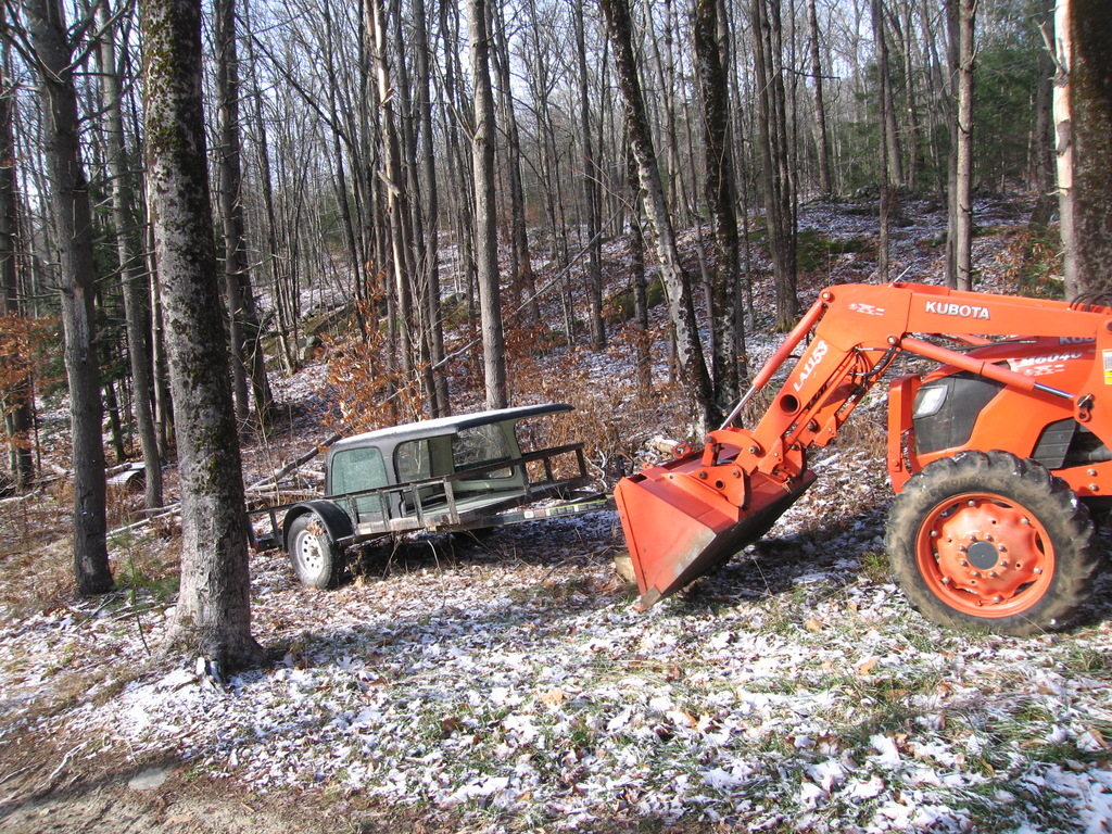

Tried out the new and improved dropped hitch trailer mover today!!!
hitch traier.jpg hitchdrop.jpg The 8" drop is enough to hitch and haul the trailer without dragging either the tail of the trailer or the bottom of the bucket

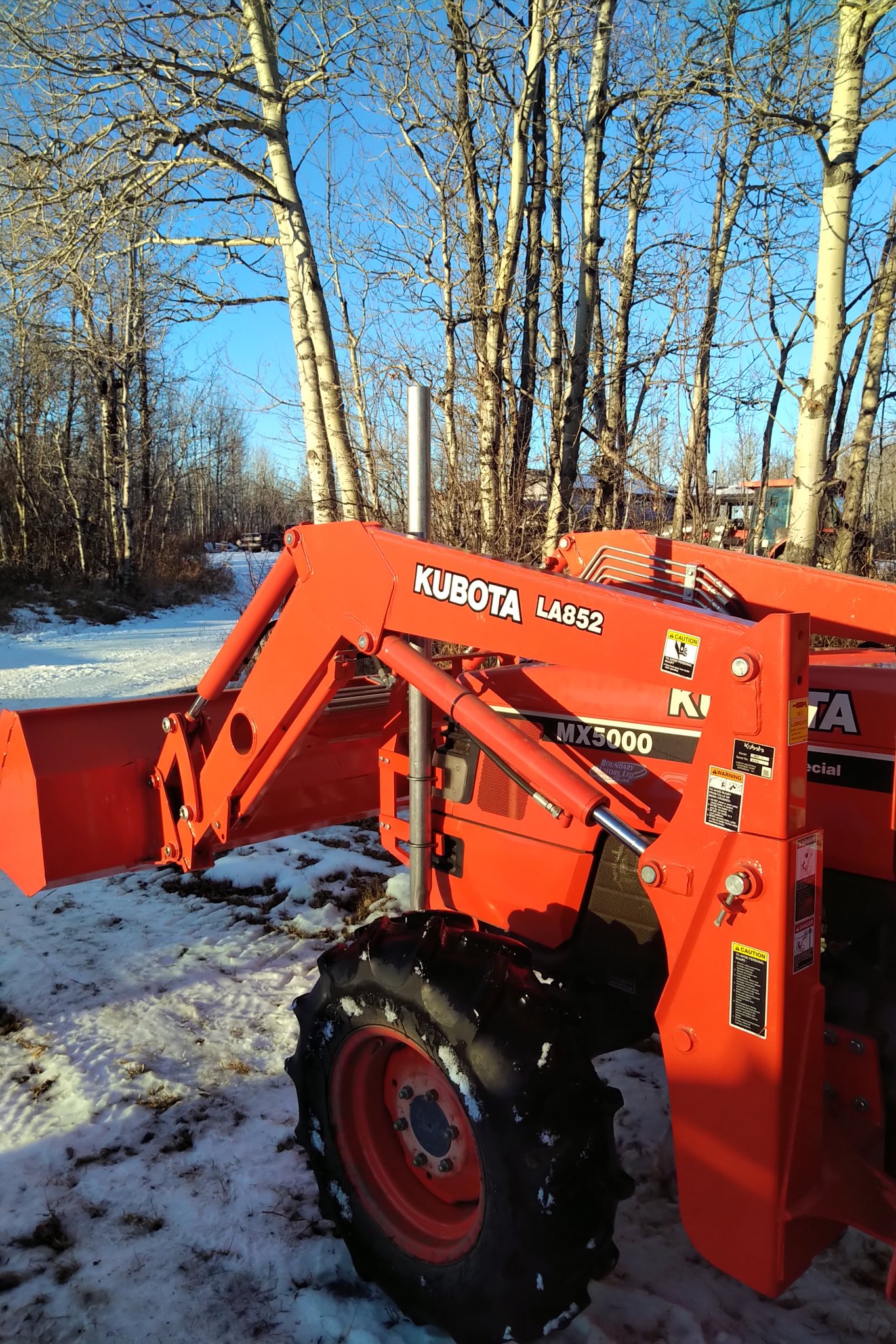

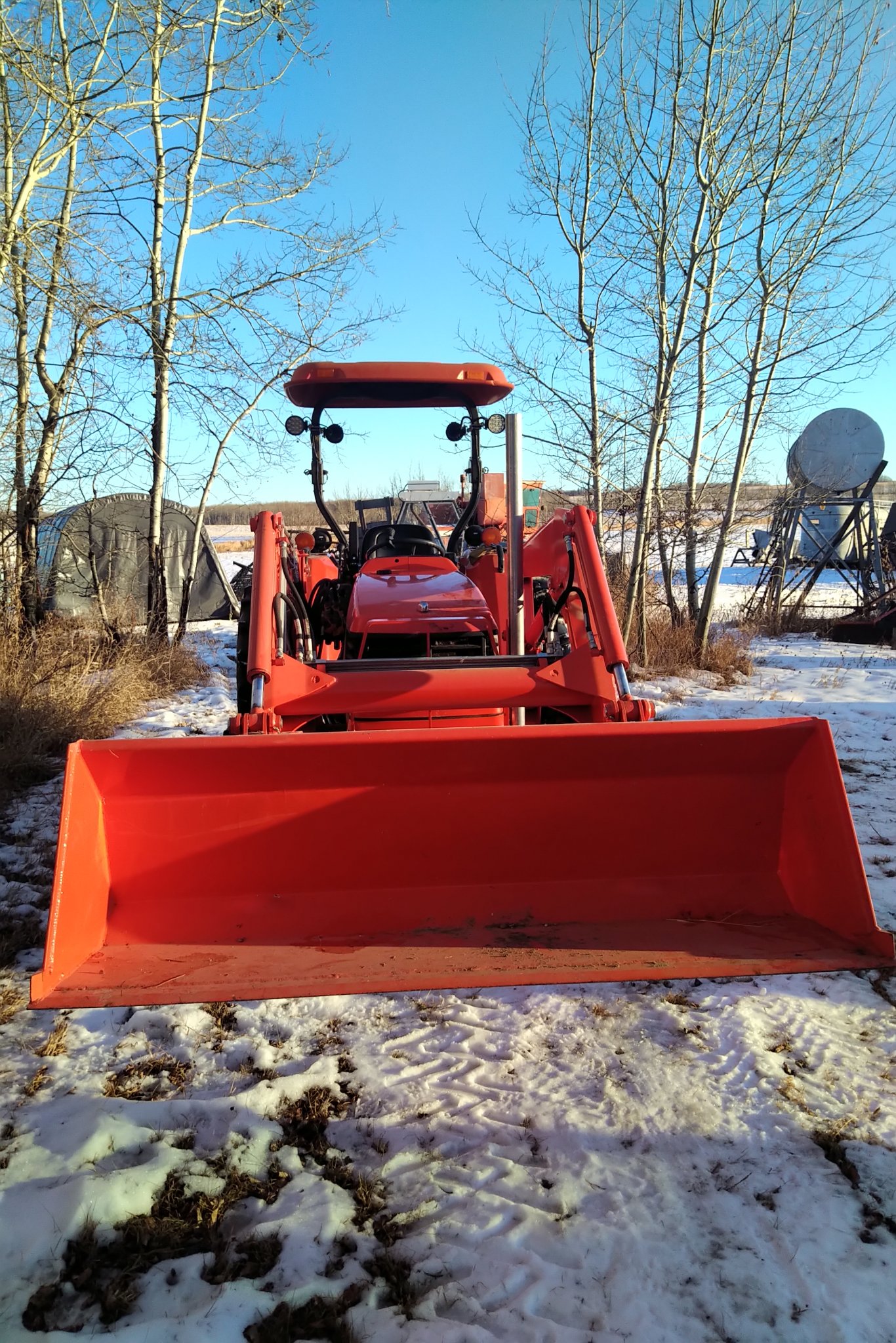

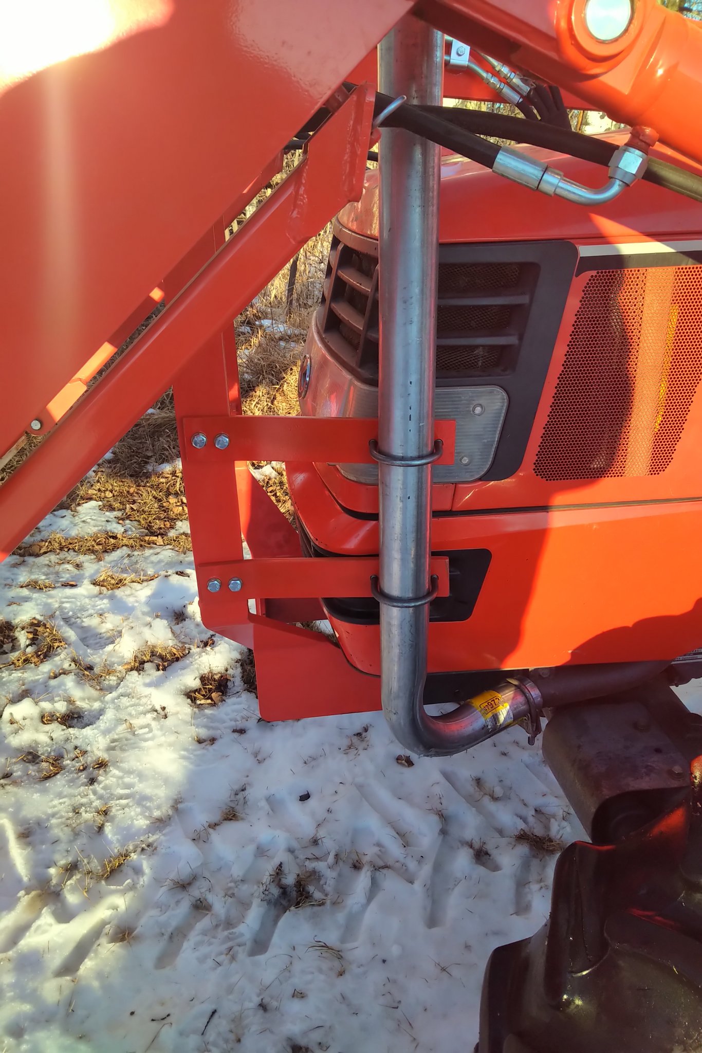

I was tired of smelling exhaust and cleaning black soot off of my loader arm due to the factory muffler outlet.
So, I had a stack made at the local muffler shop and then I made up a couple support brackets to brace it to the grill guard.

You've gotta put a rain cap on that to complete the effect! Hopefully you can get it to slap a bit! Post video please!
Nah, I have the rain caps on my other tractors that sit outside occasionally, but they wear out over time and start jingling and rattling. This one is stored inside and I only use it to rake hay or plow snow, neither of which is done in the rain lol.
The tractor is actually quieter now with the stack, no more snappy bark, more of a deeper rumble.
We’ve had similar experience with the flapper cap durability and jingling at low rpm on our vertical stack machines. For the occasional parking outside an old soup can on the stack will keep rain out. About half the time I forget to take it off before cranking, blow it about 8’ in the air, and hope it doesn’t land in my head. But at least it doesn’t rattle. I’ve also had it rain a lot more than I thought it would, water sits at the bottom of the pipe for a while so cranking results in a soot water shower. Maybe DPF prevents the soot water shower.
The vertical stack is a nice mod, though. Still kind of weird having a tractor without a vertical stack.

You could put a sewer trap on the pipe to keep the water out of the engine

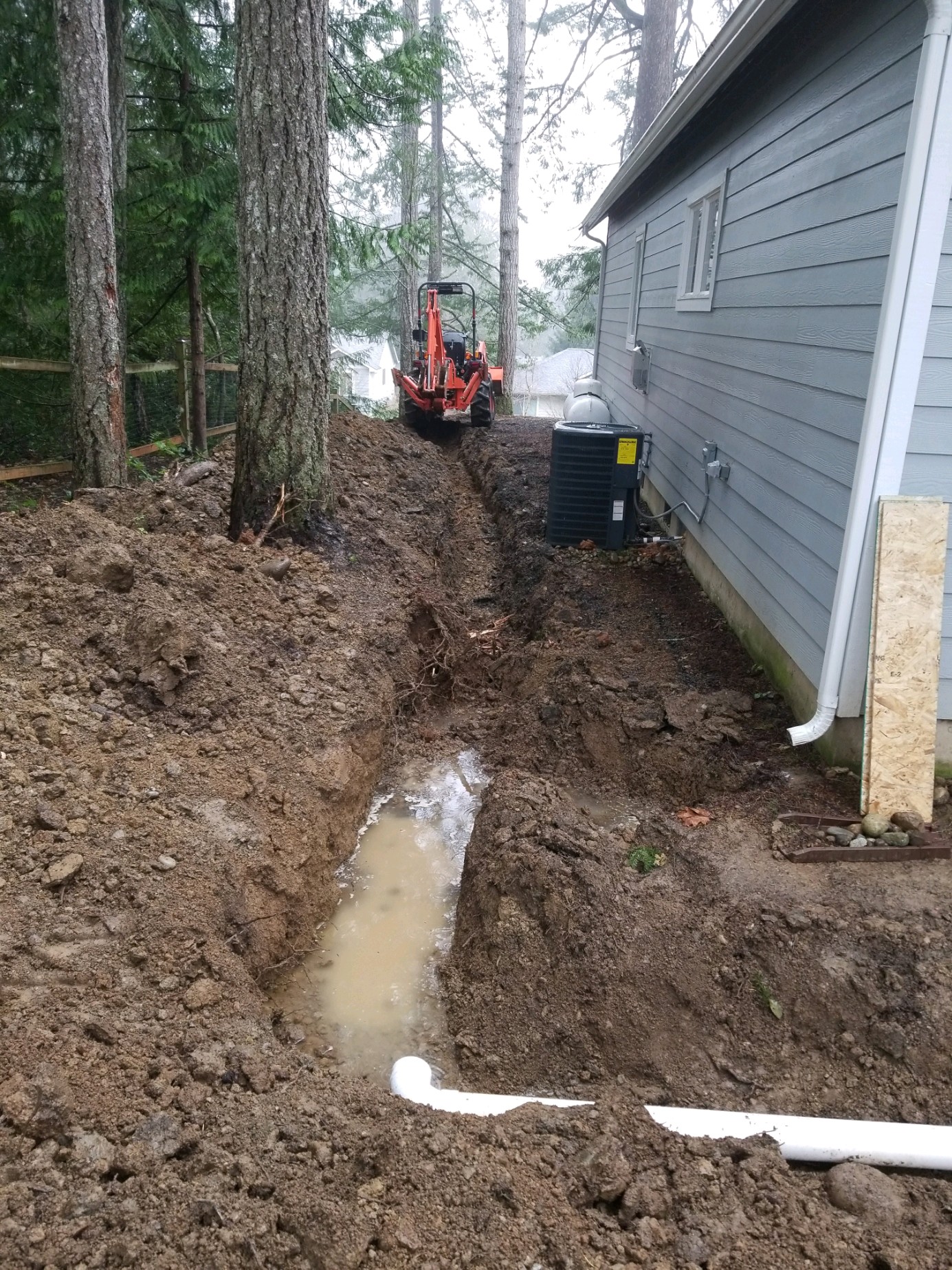

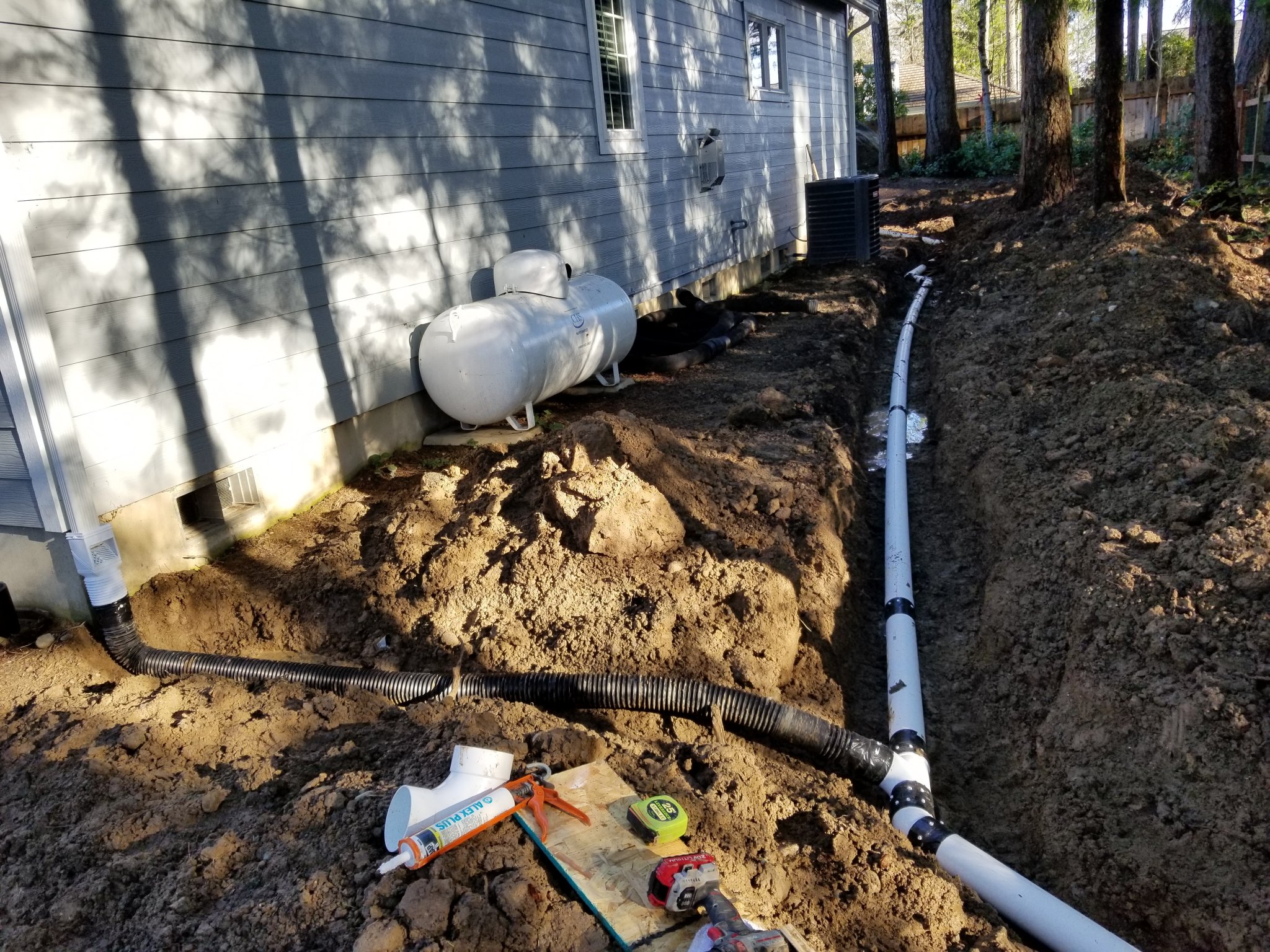

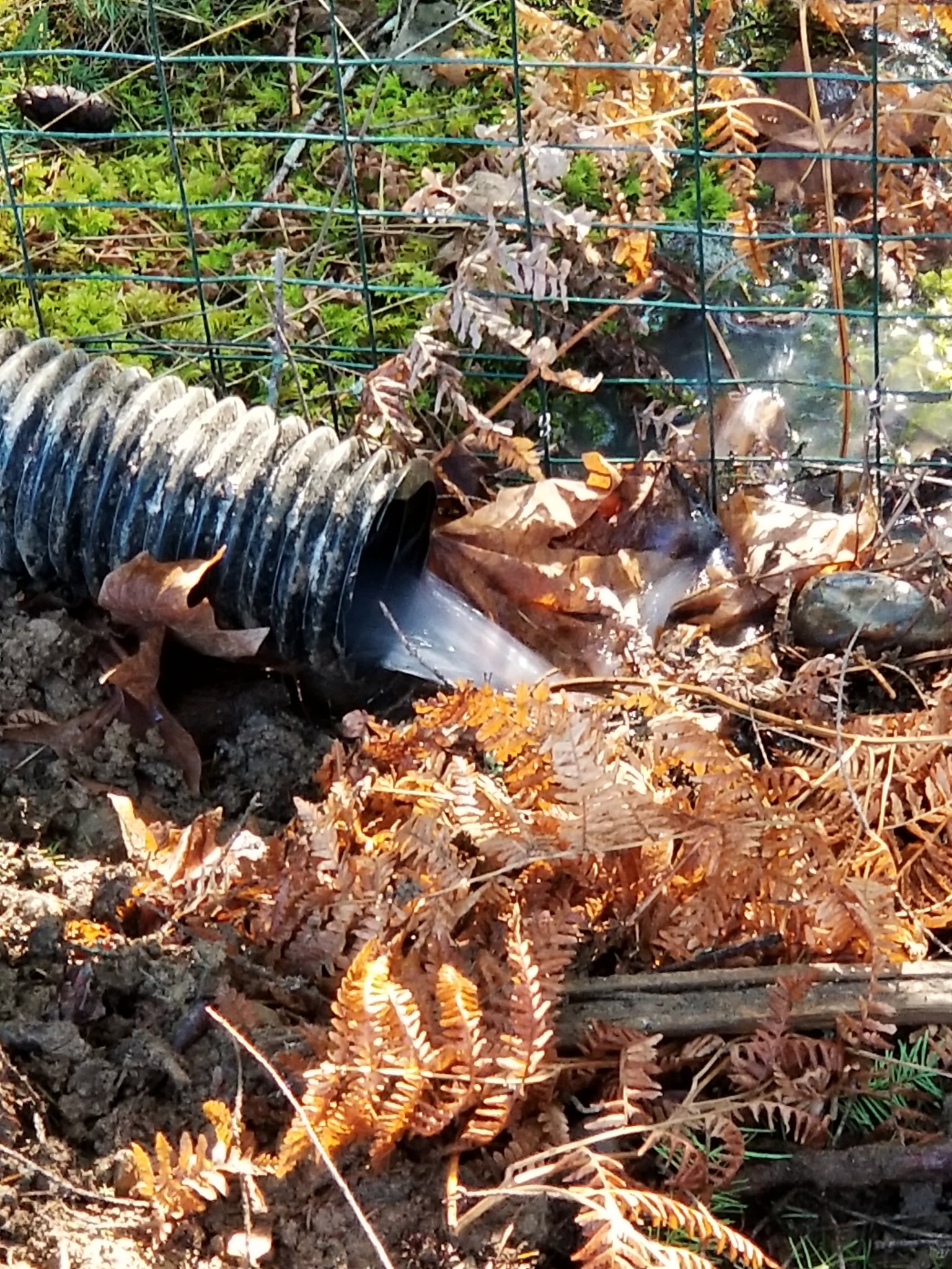

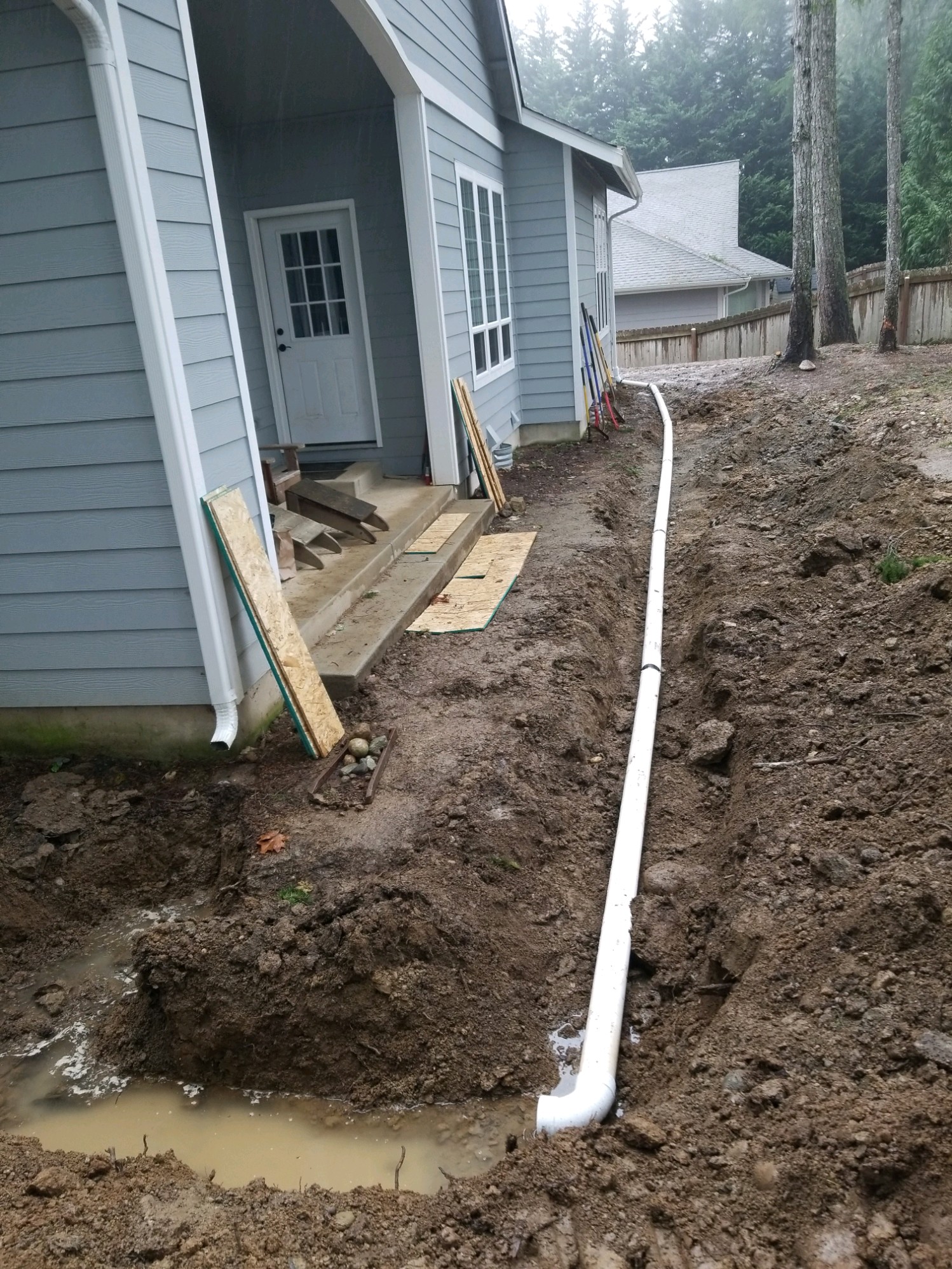

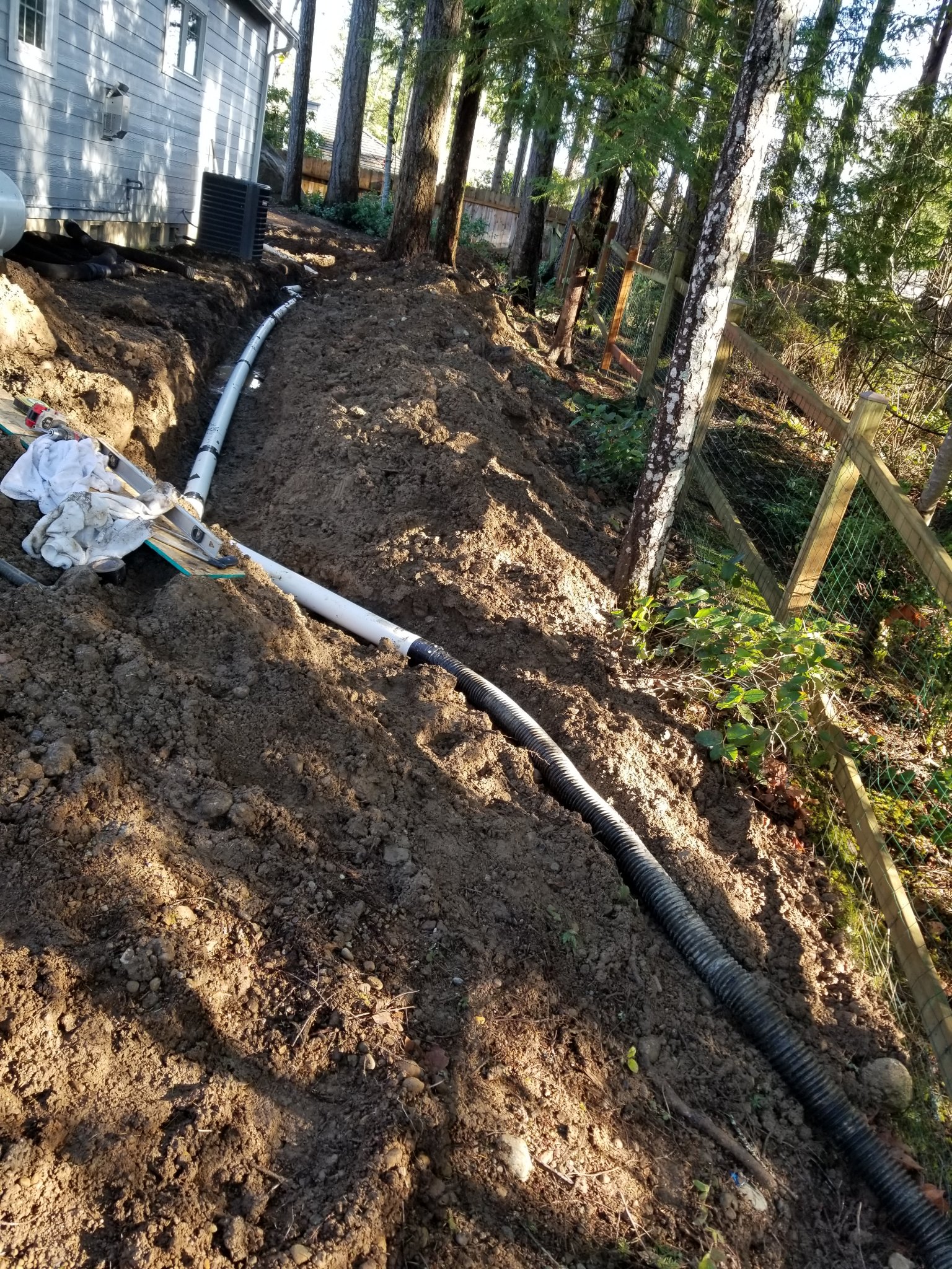

Dug smore trench to lay pipe for the home gutter drain system.
This job would be more funner in the Summer!

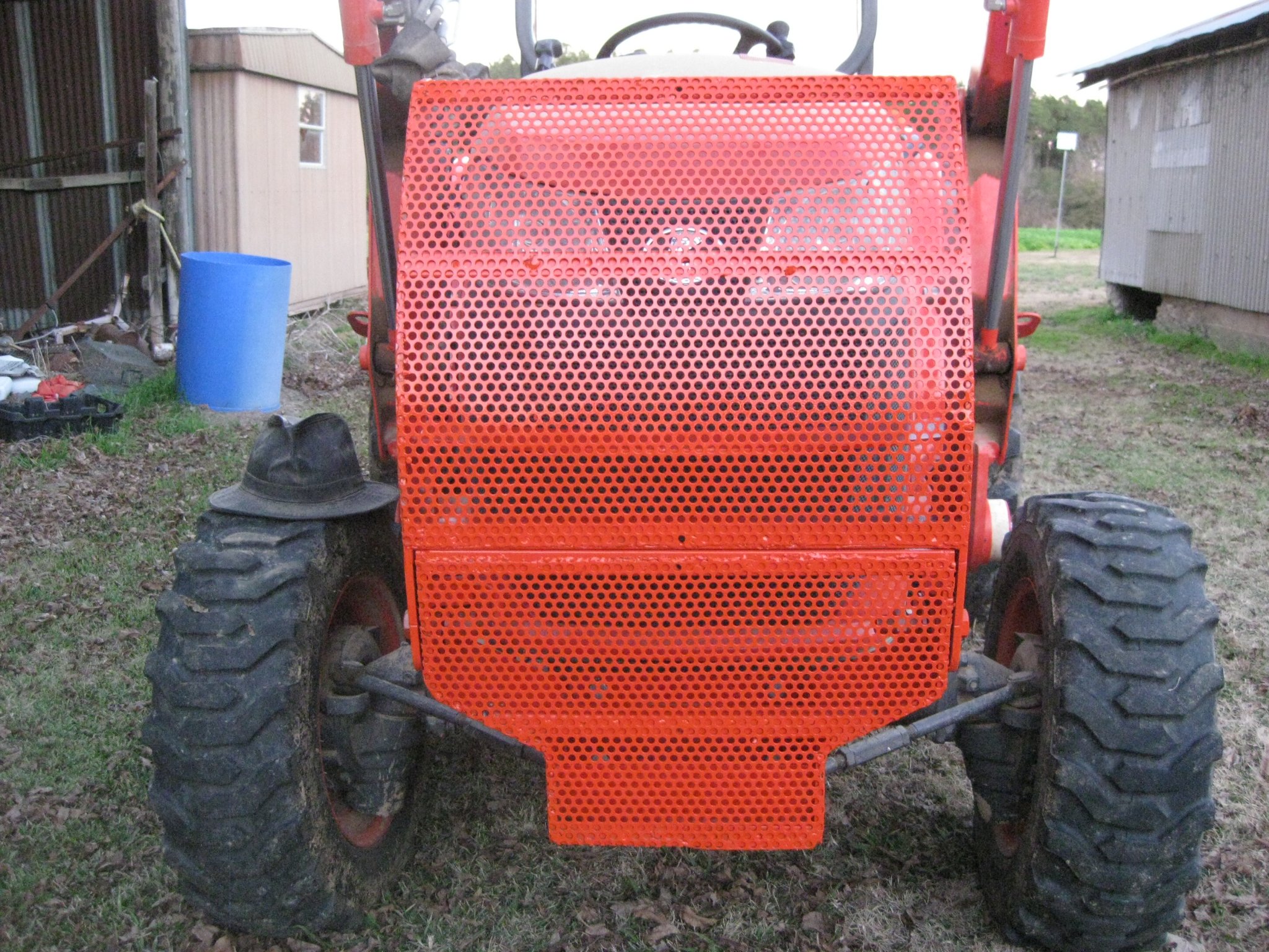

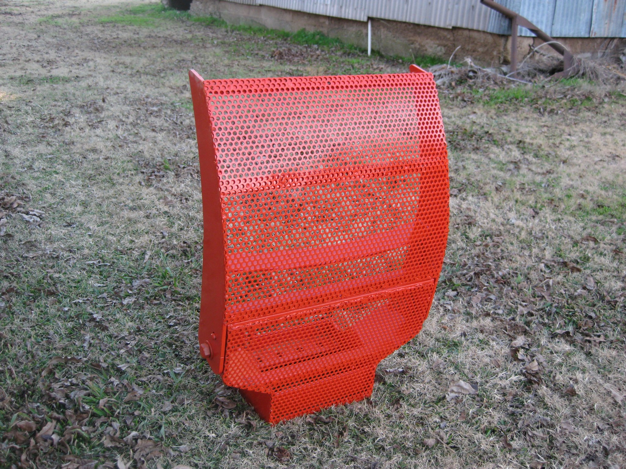

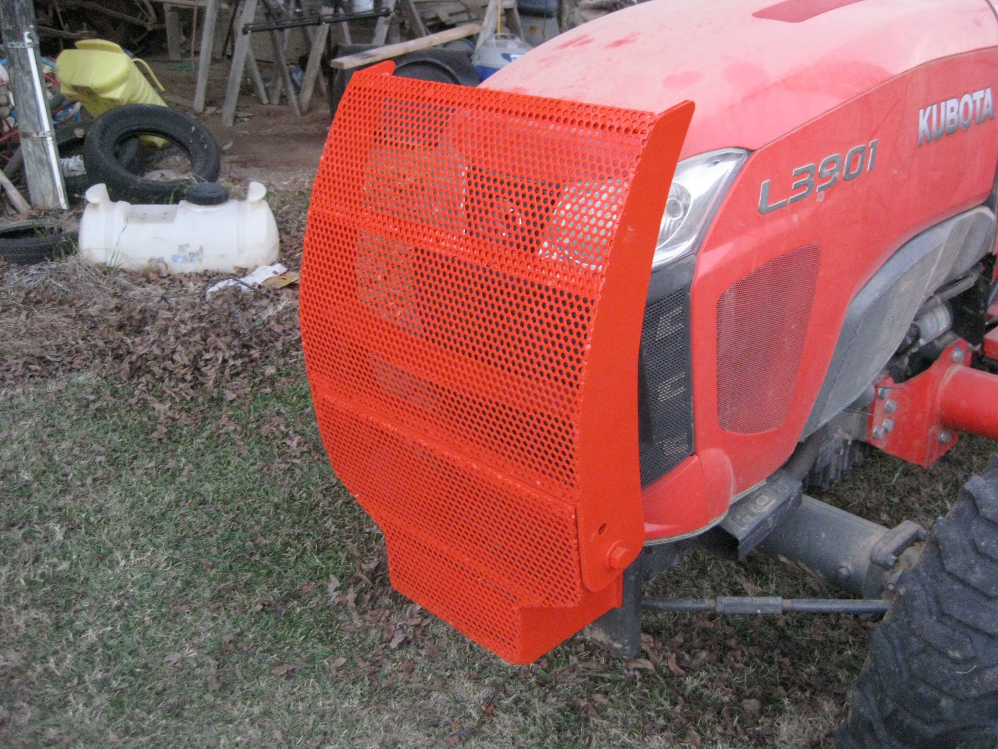

I'm getting ready for my new Wicked grapple. Hope to get it in the next week or so. Added protection to the grill guard turned out better than I hoped for. The paint job looks better than the welding. Shaking hands don't hinder painting as much as it does welding.

Nice brush guard! That ought to keep all but the skinniest sticks away.
I don't have any excuse for my poor welds, other than lack of practice.
