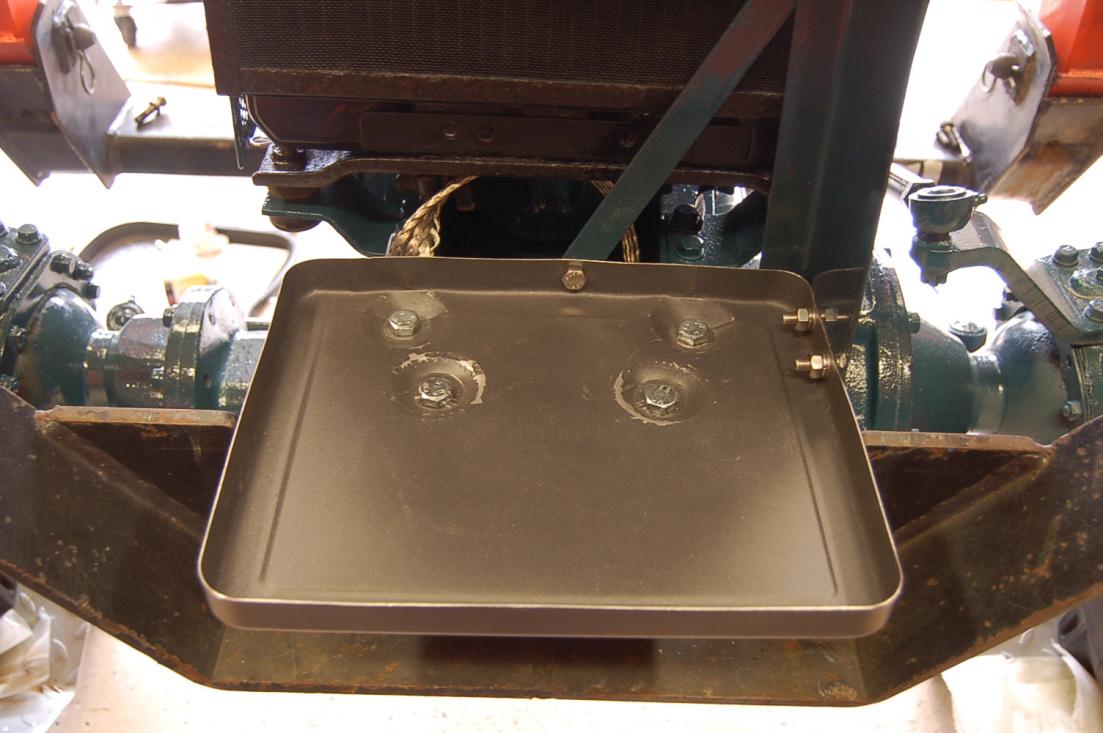

Worked on my Battery tray Replacement, Went from a small cash box almost
to a real life Kubota Battery Tray (still a few steps to go),
$34.00, a little elbow grease and time.
Way too many photos to upload here, but this is the basic procedure....
Started with this;
Tore it apart and then trimmed the bottom to 1", smoothed out the edges
and drilled the mounting holes;
Pressed in the "dimples" so the bolt heads are not going to interfere with the battery base;
Drilled the air filter bracket(s) mounting holes and did a test fit;
Made a set of angle brackets for the hood mounting.
Still need to remove a 1 7/8" section from the front to rear depth
and then weld the two halves back together, so it will clear the opened hood,
and weld on the hood mounting angle brackets.
It will be 1/2" larger in width than the stock one, but that should not be noticeable.
All in all it has so far come out pretty good.
And compared to the original, which i do not see how it held up the hood,
this will be a great improvement for a part that is no longer available fro Kubota.
6,939
2,426
Very clever use of the lock box!
Odd hood hinge arrangement. On my L185 there are nuts welded to the vertical legs that hold the battery tray to the frame, then some bent straps that bolt to the battery tray legs and the hood bolt to the straps.
Anyway those strap metal parts are not available - at least the left one was not available when I wanted to replace mine that was bent. The other side was available.
Notice the little round nubs sticking out... Those stop the hood at an open position
