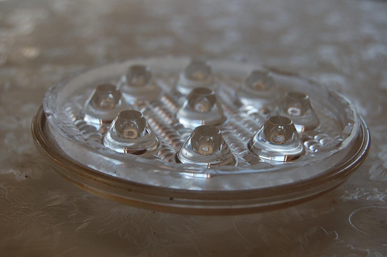

First I removed the reflector and LEDs from the stock fixture
Cut a circle around the new lamps and removed the guts
Did some sanding on the clear faceplate so it fit into the glass stock faceplate

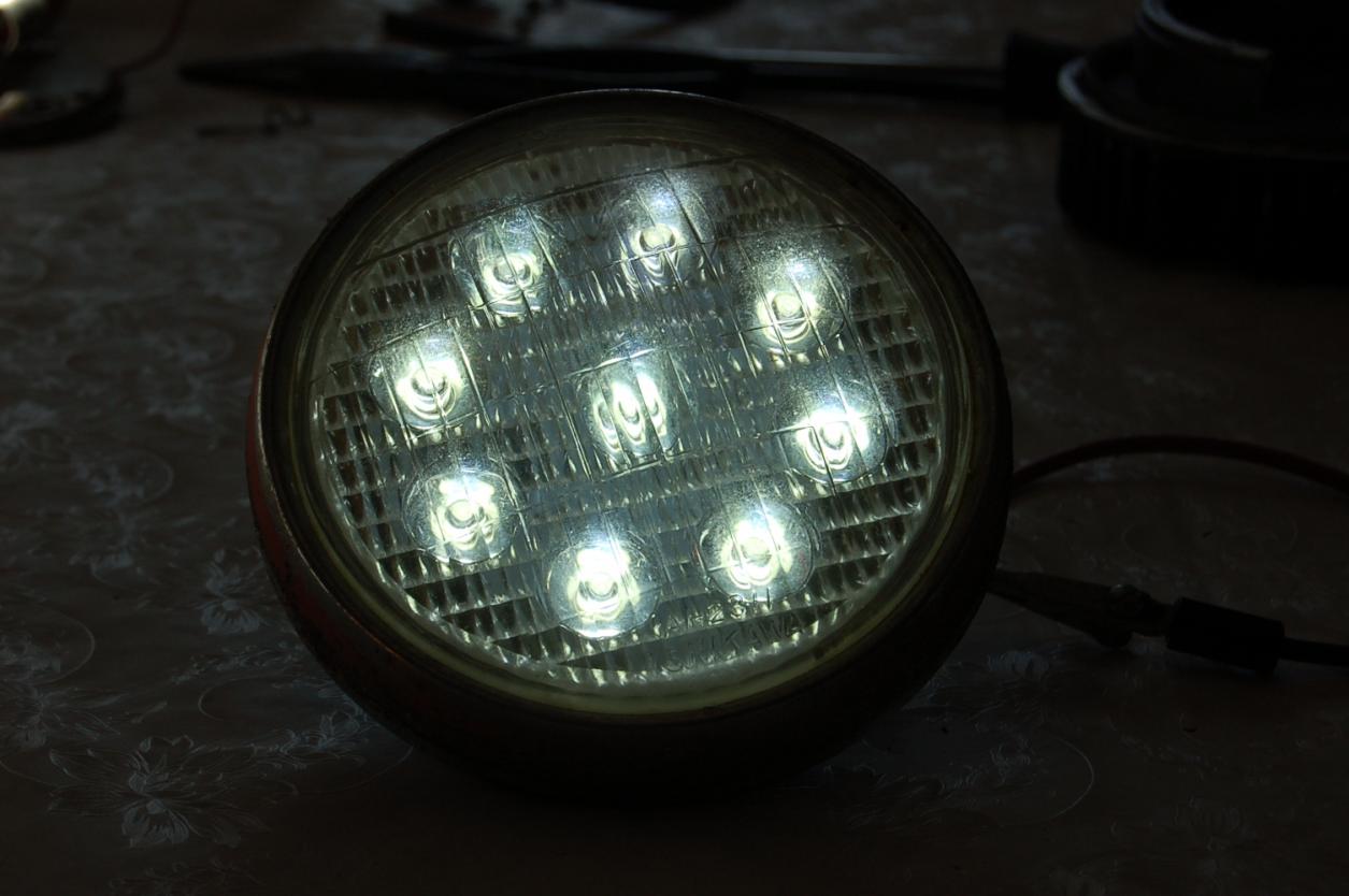

Put it all together and tested it, works great
put some sealer on the exposed components

Still need to seal everything upon assembly so it is moisture proof,
Should be quite a difference from a 35/35 watt incandescent bulb.

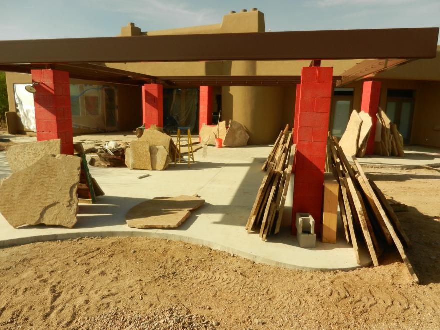

Moved 10,000 lbs more flagstone yesterday. Going to move two more pallets today and that should about be it for the back yard, save a couple pieces should they run short. The contractor told me he accepted this job thinking they could move the flag themselves. My Kubota has saved them from losing their butts. I told him to "remember this come the next job bids!"
Staging of material as of yesterday...
