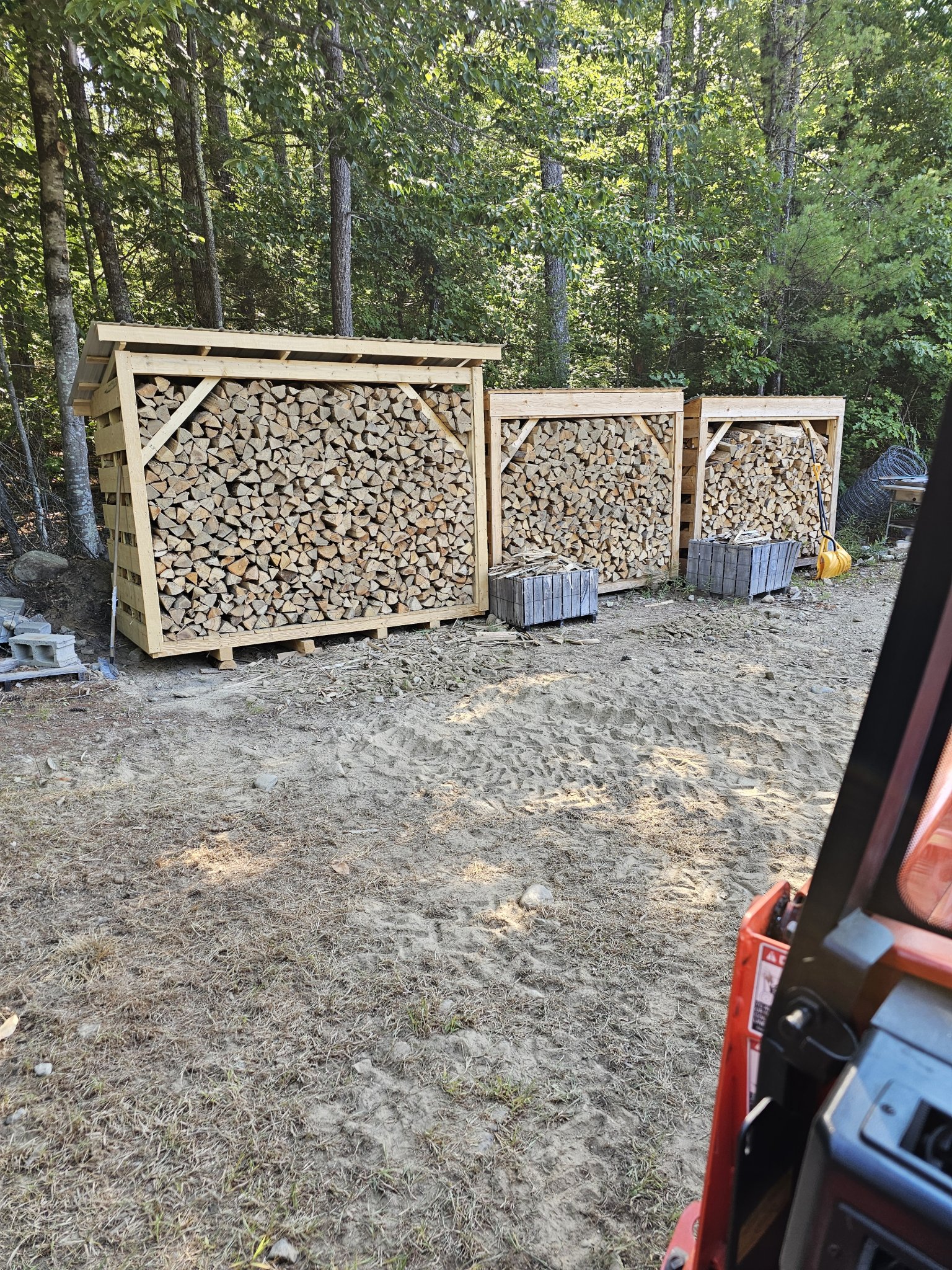

And in November I'll cover the fronts with tarps for the winter. Three sheds, four cords. The top rows certainly gives a challenge to shoulders that have been operated on. This won't get burned for several yrs. Glad that's done.

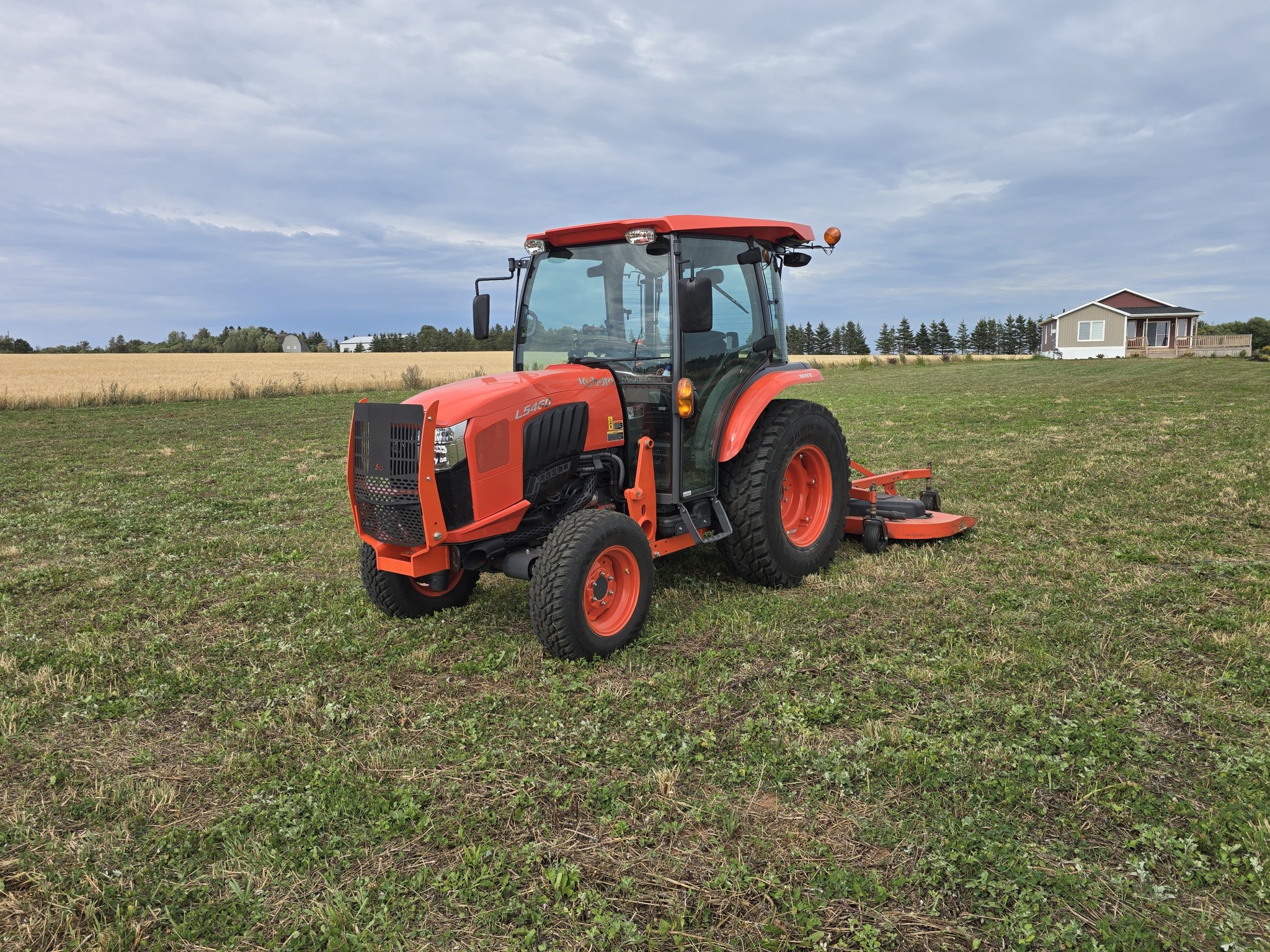

Took the loader off. I'd say it was off in less than 90 seconds. Much easier than the LX3310 with it's hydraulic lines between the hood amd loader frame. Did some mowing and it was far smoother without the loader.

It really does make a world of difference.
I can turn around at the end of my rows to like a friggin sports car LOL.

I'm really impressed with how tight the L can turn. Actually everything has impressed me so far.

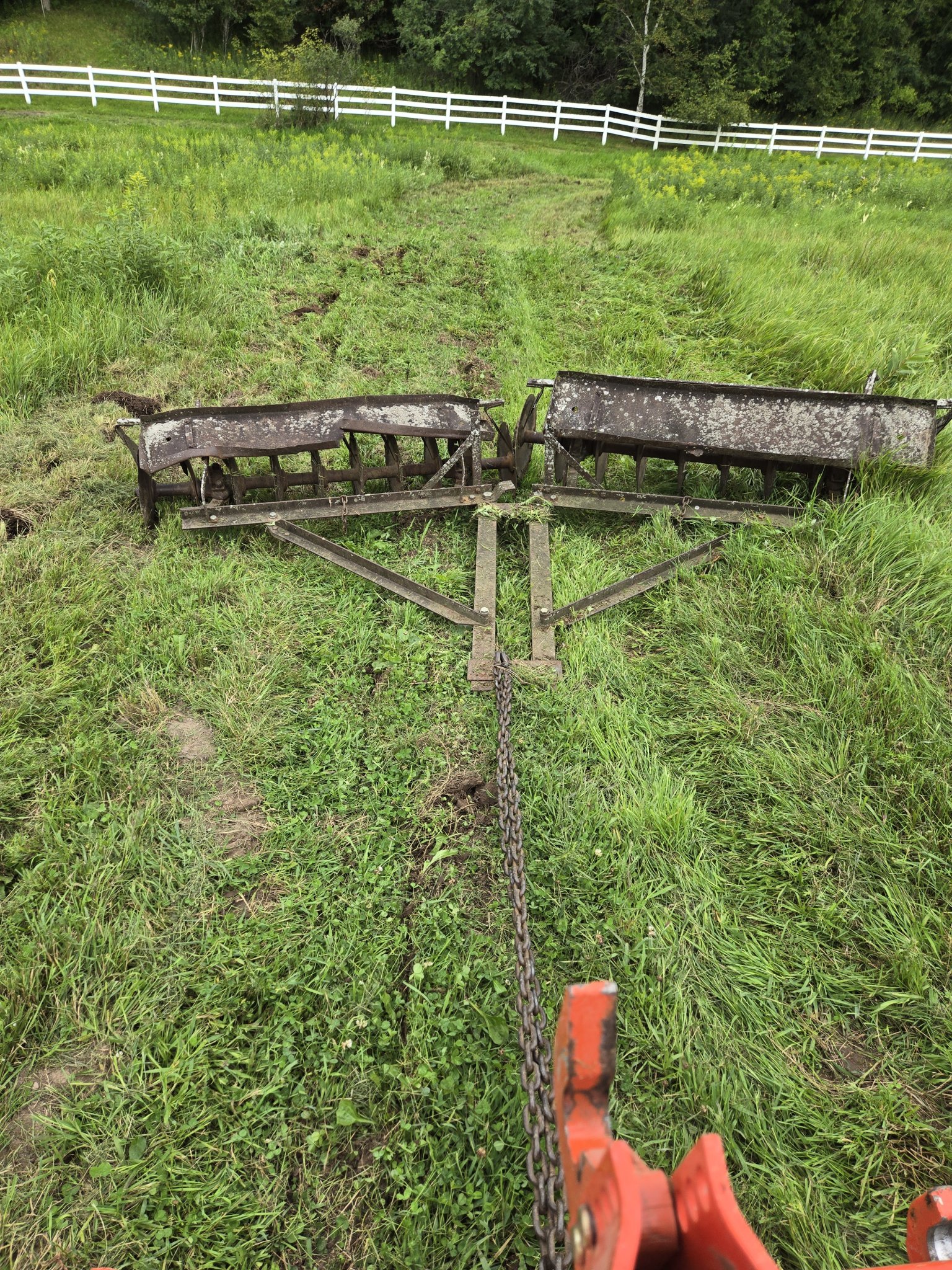

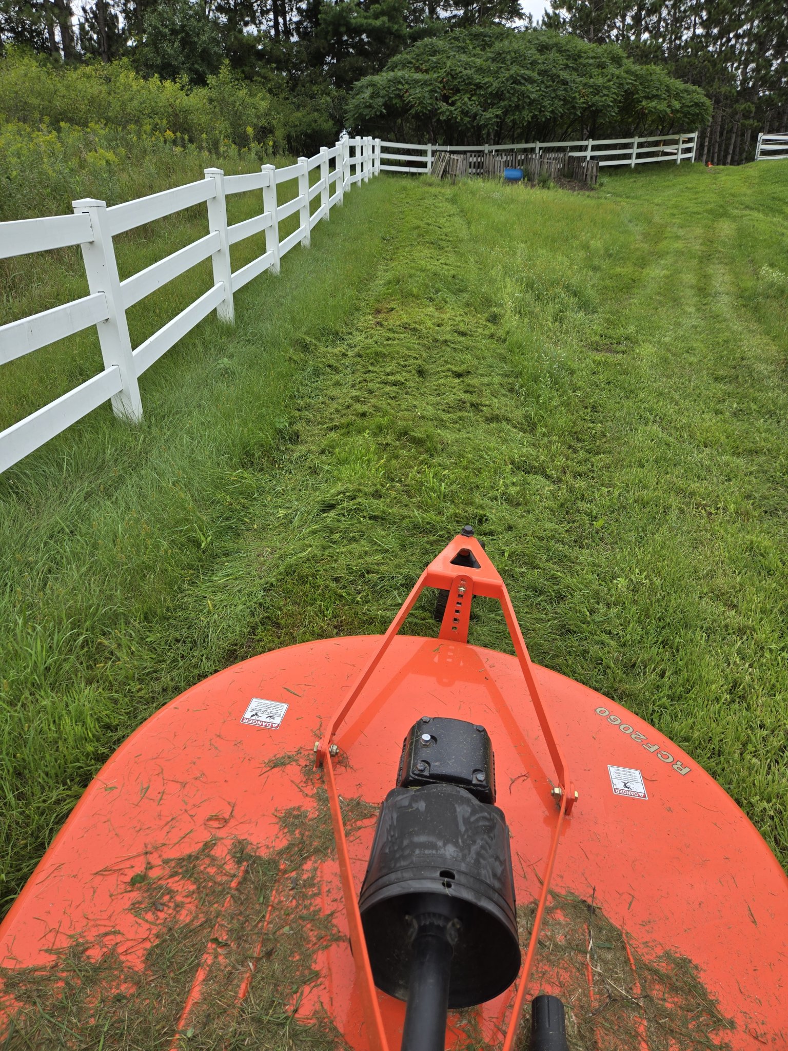

Last time mowing the pasture for the season.
Since I had to move this old disc to mow, I thought I would drag it around the track to get rid of some grass. A tiller is high on my want list.
I then went back to using my box blade with the scarifiers all the way down, just grazing the surface.

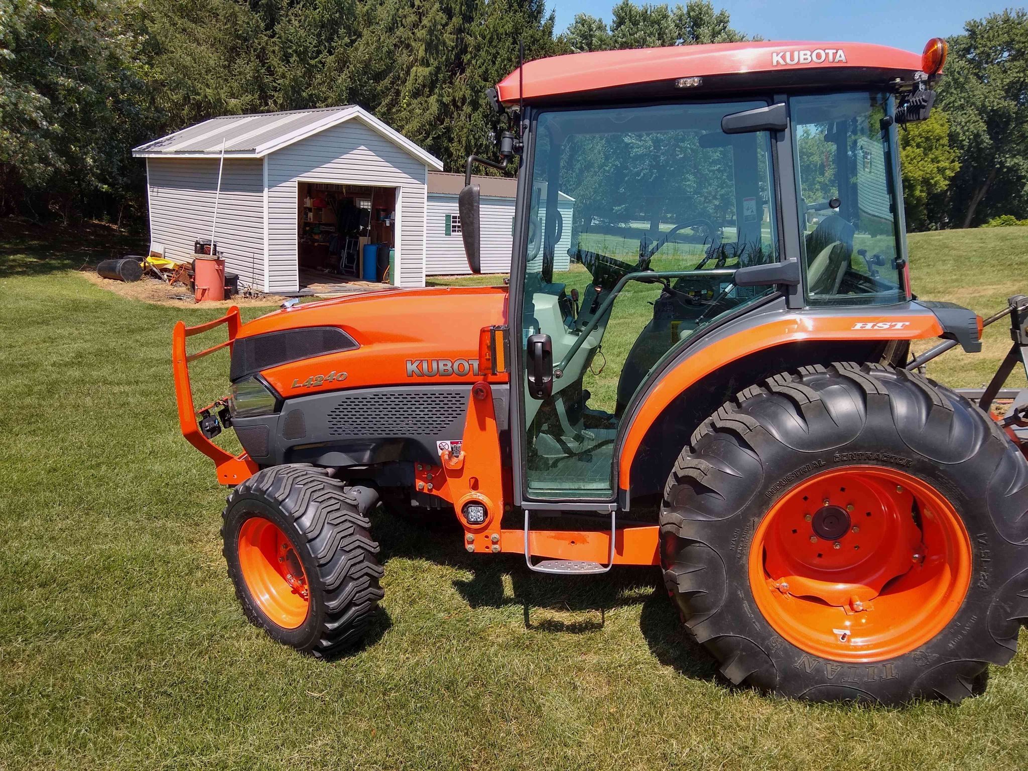

Changed oil today at 1603 hours. Last time was June of 2024 (about 150 hours ago). I often don't go the full number of hours on maintenance items. It may cost a few extra bucks, but it makes me feel better. It had been getting dusty, then I did some mowing in the rain. The spots all over the paint and glass bugged me so it had a good bath and window cleaning.
I'm the same way.
Usually once a year for me. It would take a few years to hit the recommended interval anyway. It's just too quick and easy to freshin the oil up, especially when considering the price of these machines.
I've always loved the photos of your tractor. Such a nice looking machine. What year is it?

Thank you. The condition is great for its age. Based on S/N info, I believe it was made in 2007. Bought it used at the end of 2018 with 977 hours on it (1603 as of today). It's kept inside, maintained well and waxed at least once a year. If you zoom in on the picture above, you can see the paper sticker is still on the rear rim at the valve stem:)

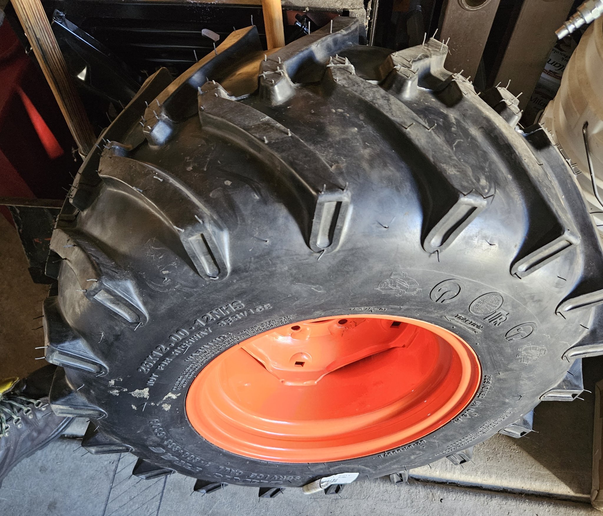

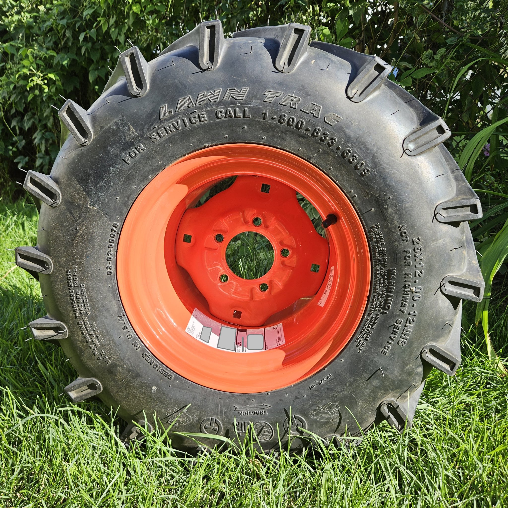

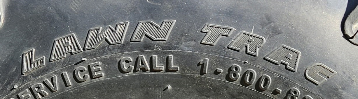

Whatever I did to anger the tractor gods must have been pretty good because their wrath is ongoing--about the same as the autocorrect damon that spells stuff wrong when I hit the Post Reply button...though the damage from the tread on those lawn tires isn't going to be fixable with backspace.

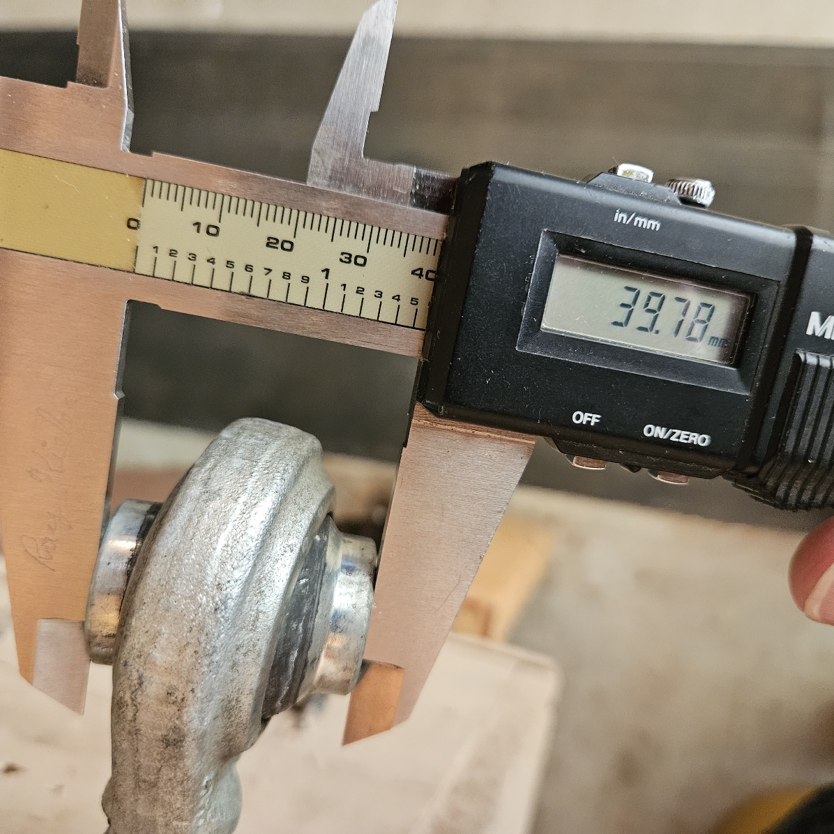

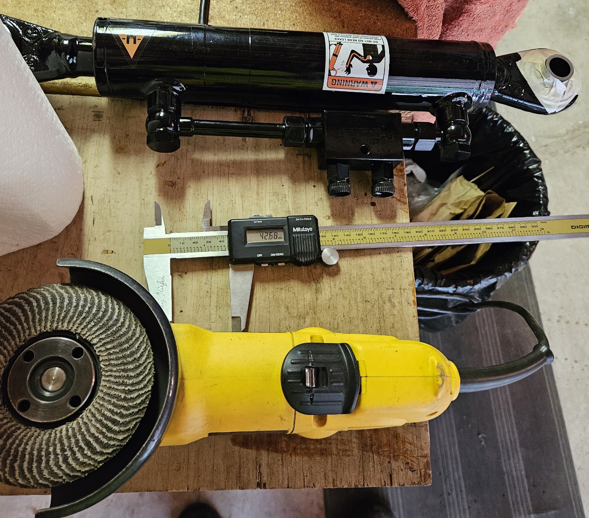

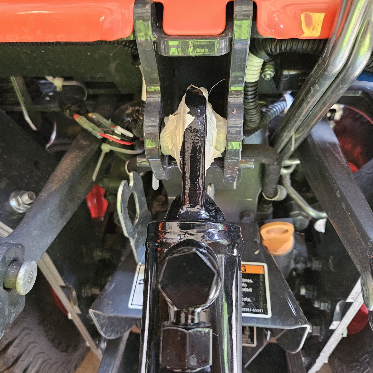

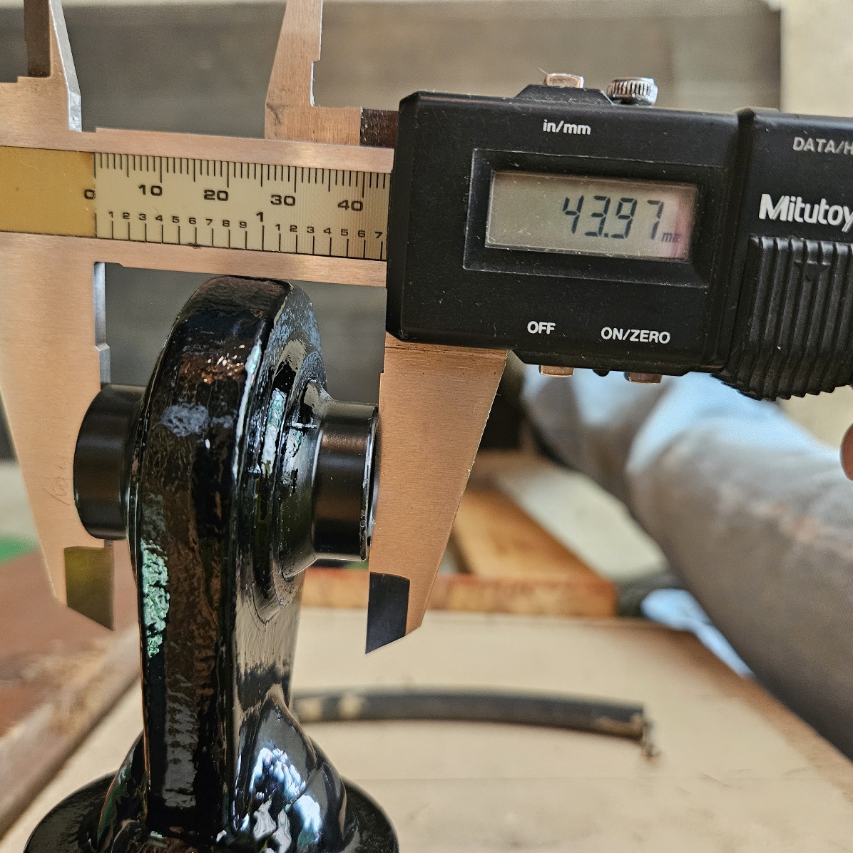

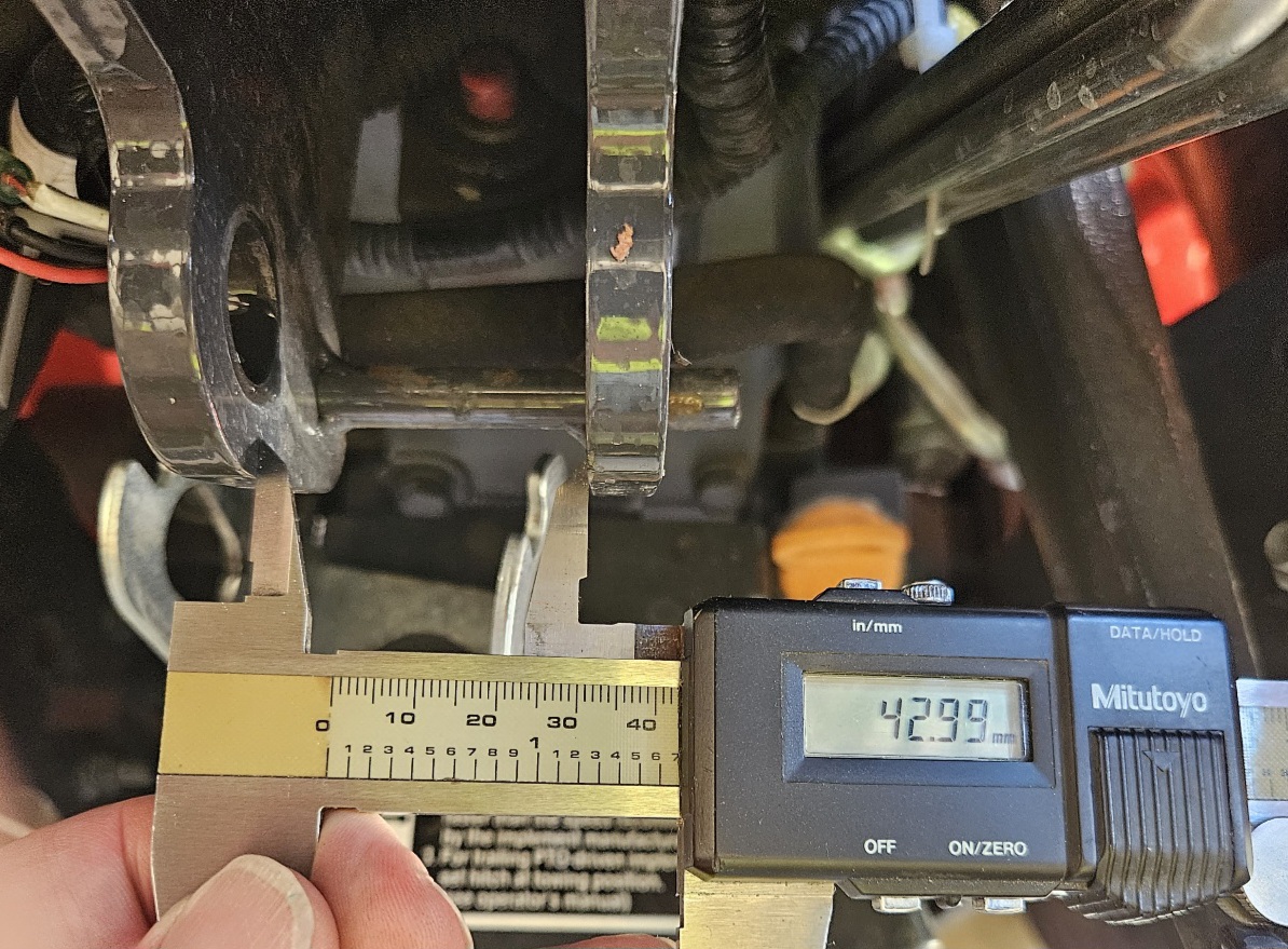

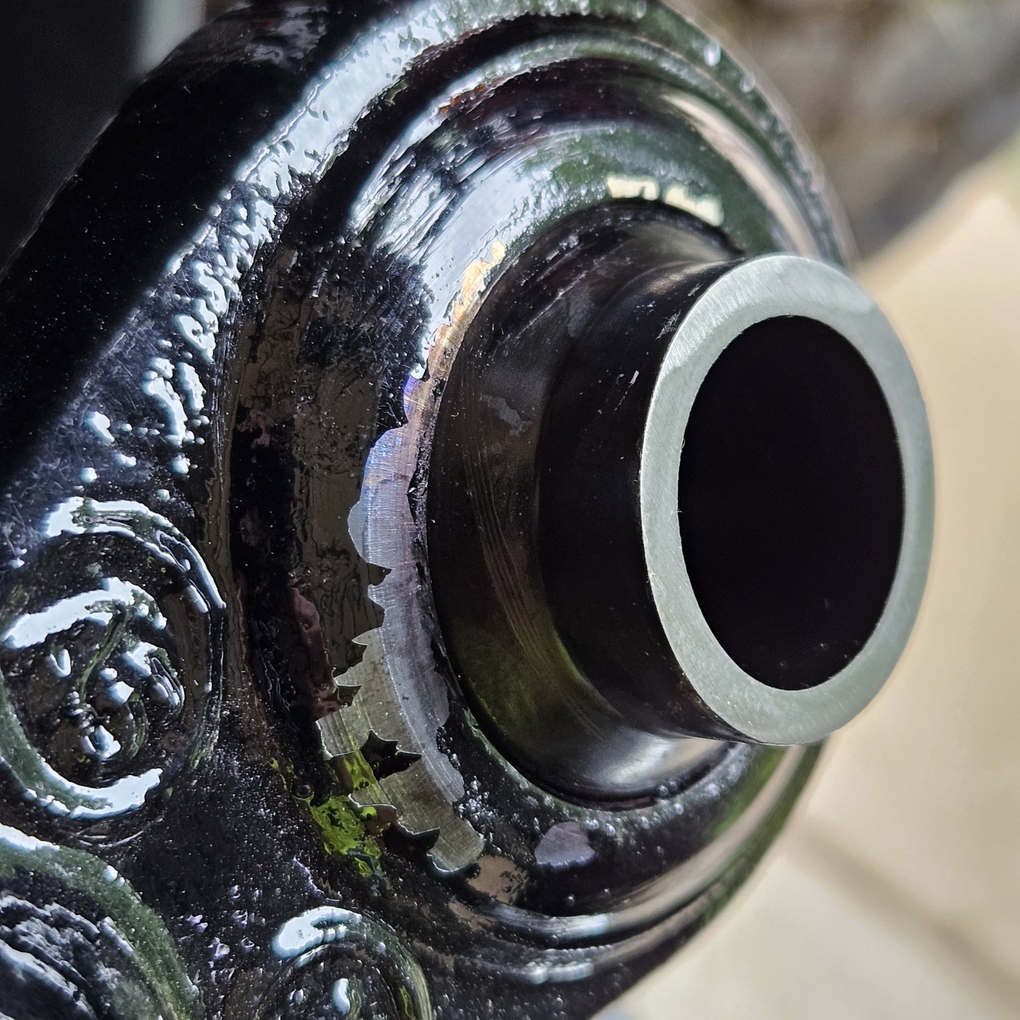

First things first, mount the hydraulic top link to the tractor. Simple enough, but I can't get it to go. At least Summit let me know what to expect and my attitude was now adjusted to think of this as if I sourced my own parts.
Width of the 3-point top link bracket: 43mm
Width of the Kubota top link bushing: 40mm
Width of the Summit hydraulic top link bushing: 44mm
Even if I convert that to inches it's not going to fit. Time to void some Warranty and break out the parts shrinker.
1/100" clearance and square/parallel within 0.004" using a redneck hand lathe...good enough for government work.
Let's hope the pin fits... :censored:

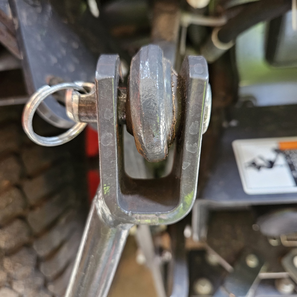

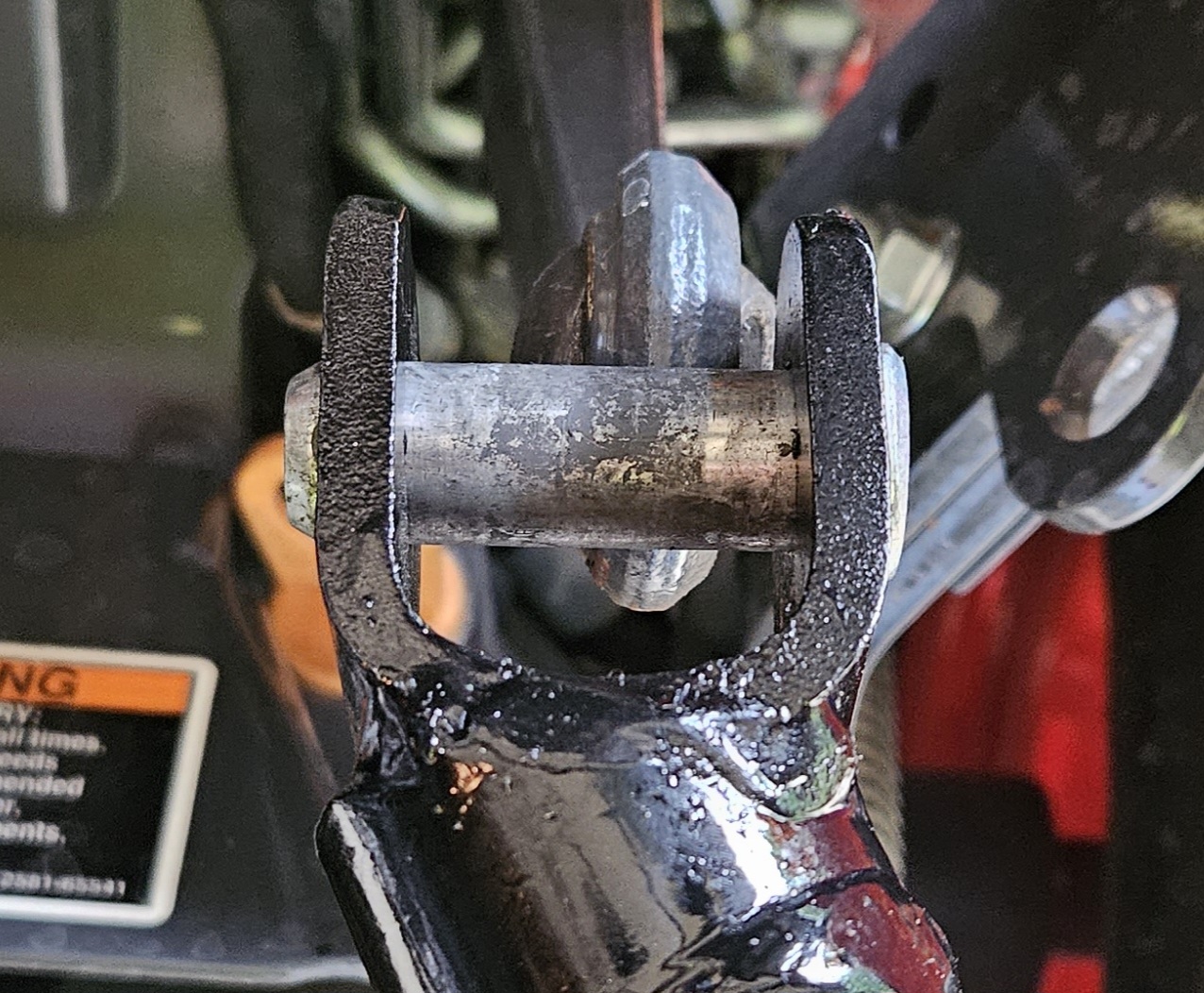

Paint quality is "a bit iffy," but the "now smaller" top link fits, coat it in grease and call it good...on to the side link.
Stock on the left:
Hydraulic on the right:
Yeah, the ring isn't going in that hole.
Standard pin length: 2"
Needed: 2-1/8"
Where can I get a 5/8" diameter 2-1/8" or 2-1/4" long single-hole clevis pin??? Our local tractor place shifted to impliment fabrication so I'm out of luck locally.
3,241
5,434
If you have a decent local hardware store, get a 5/8” grade 5 bolt long enough the unthreaded part is at least 2 1/8”. Cut it to length you need and cross drill it for the clip.

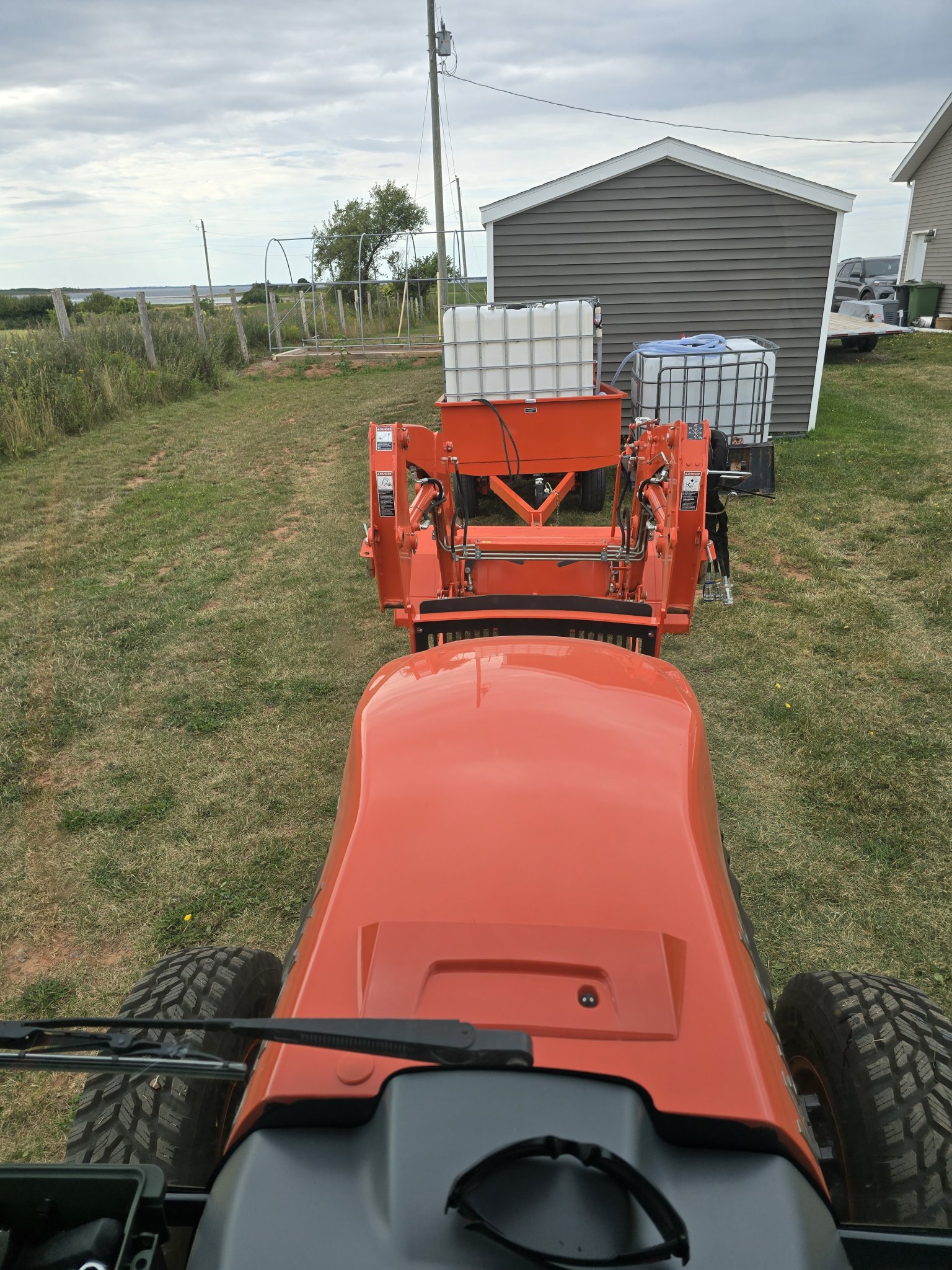

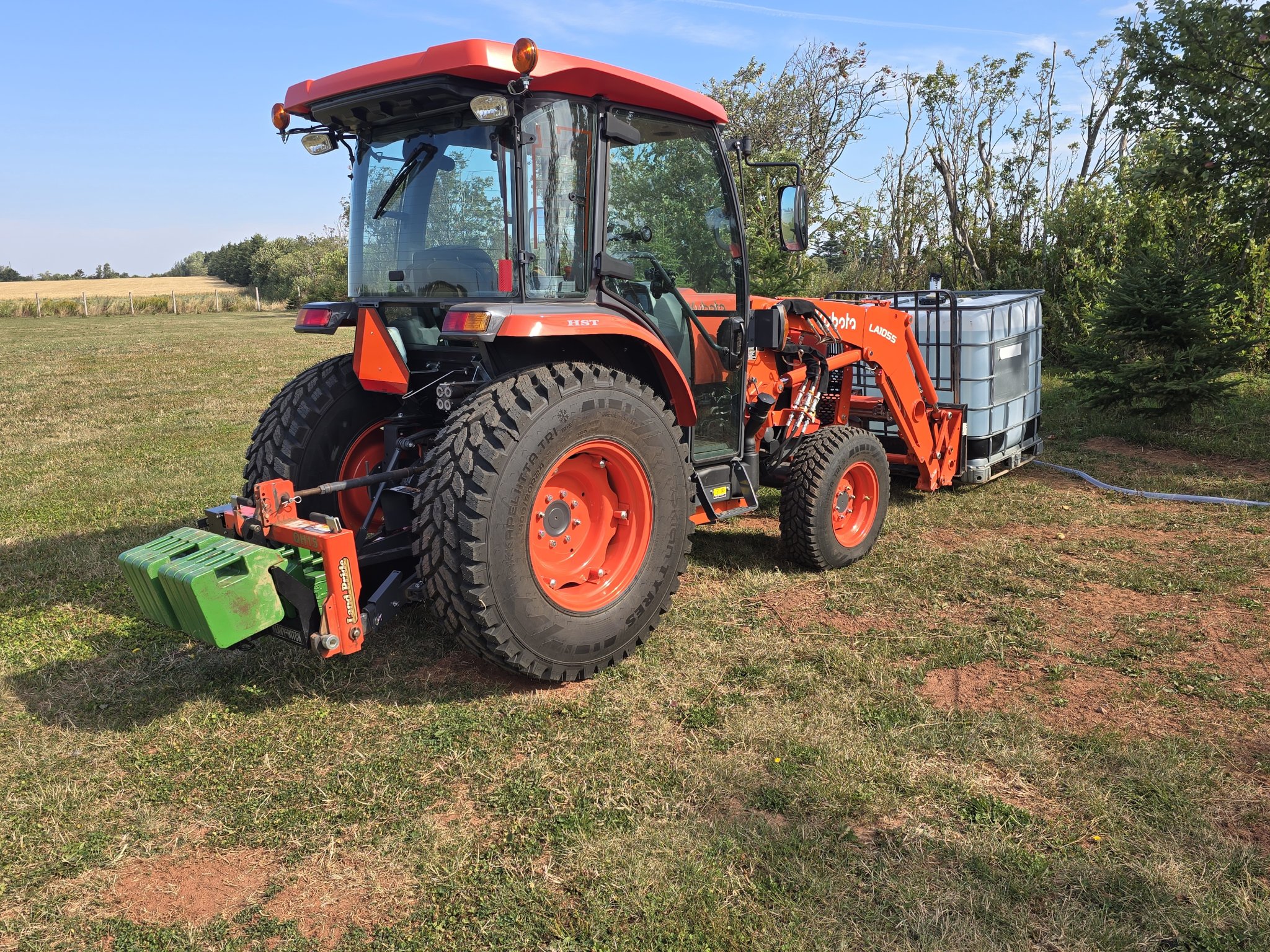

Trying out the lift capacity of the loader with the heavy hitch and about 700lbs of weight. Rear tires are loaded. Still feels a bit light. Anyone running rear wheel weights on a grand L?
MOOTS
MX6000
Jun 27, 2019
2,189
2,718
Canton, Georgia
My MX likes the 990lb tiller on the 3 point when moving water totes. It will do it with the 700ish lb box blade, but feels tippy. I also have 3 sets of wheel weights.
S-G-R
Grand L5460, X1100C RTV
Jun 17, 2020
1,543
3,794
PEI Canada
I have a FDR2584 that's weighs 800lbs but it takes up a lot of real estate. I'm trying to keep a smaller footprint because I'll eventually be unloading trucks and putting the skids in a building.
