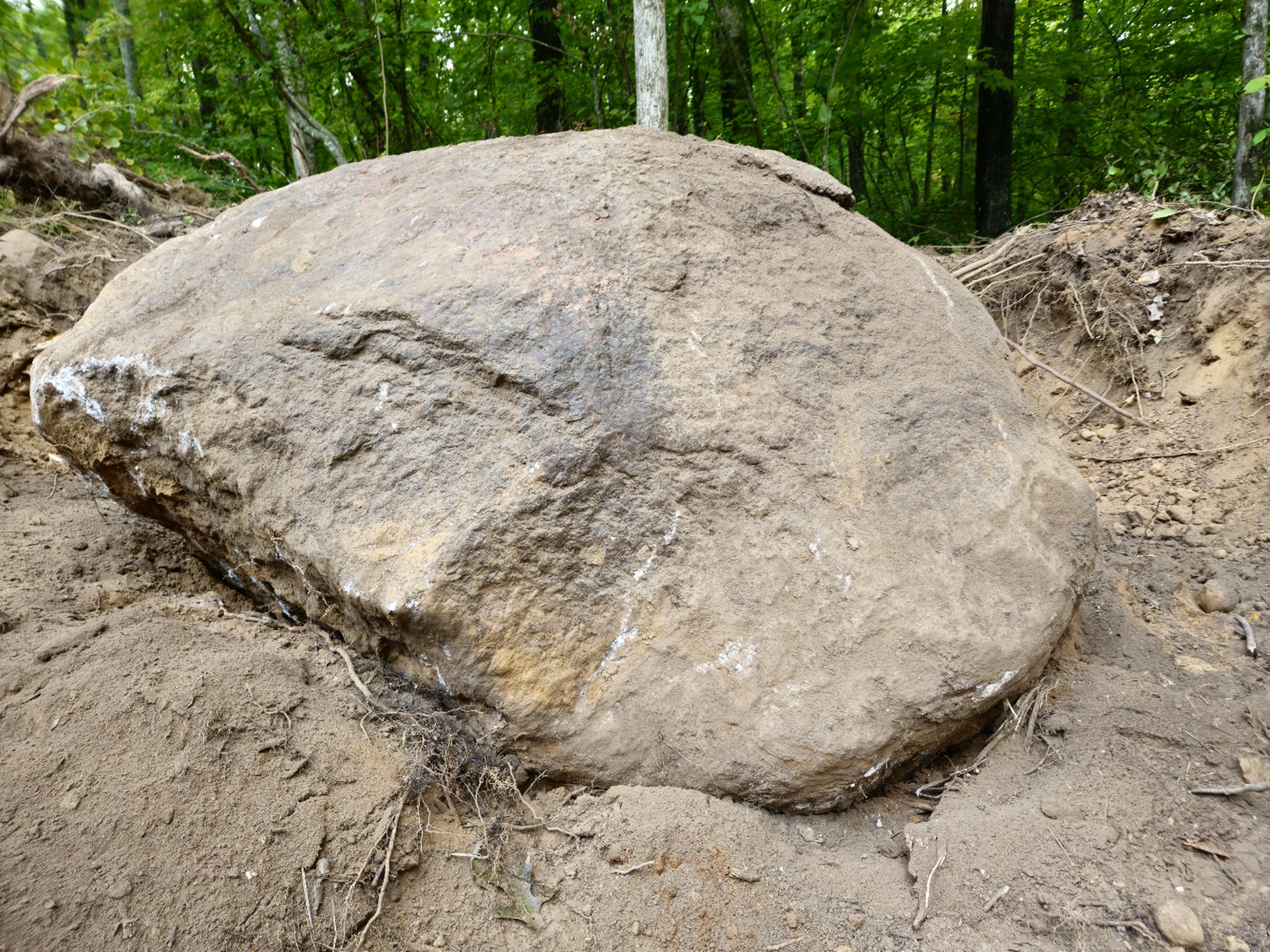

Brilliant picture !
Reminds me of some creature from a horror movie, with glowing eyes and huge claws :giggle:
That you can move this size rocks with your tractor is most impesssive (y)

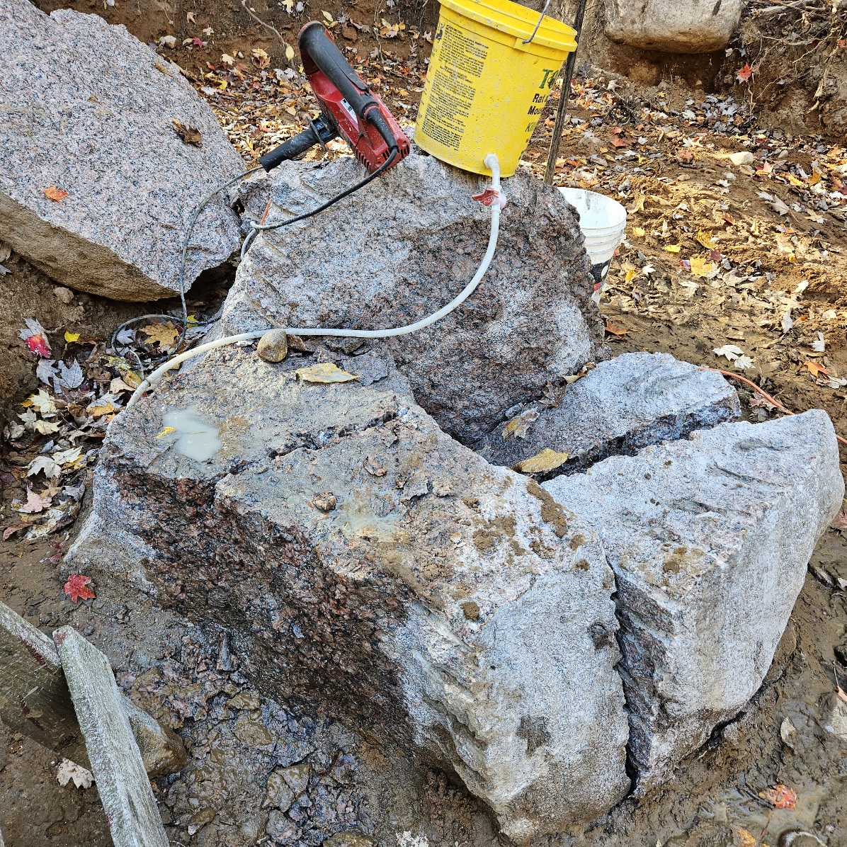

To start with I split the rock into quarters (with some unfortunate fractures), this is the far side:
Then split each 1/4 of the near side into halves, so each piece is 1/8 of the rock...or more like 1/10 due to fractures on the far side:
After removing the top pieces, (the parts on the right are from fractures during the initial quartering)
I split the near side bottom in halves:
The front left part is the piece in the original picture I posted, most of it was underground, which is the brown part on the left in the following picture taken when pulling it out, the grapple grabbing the top part:
That piece was, uh, deceptively big.

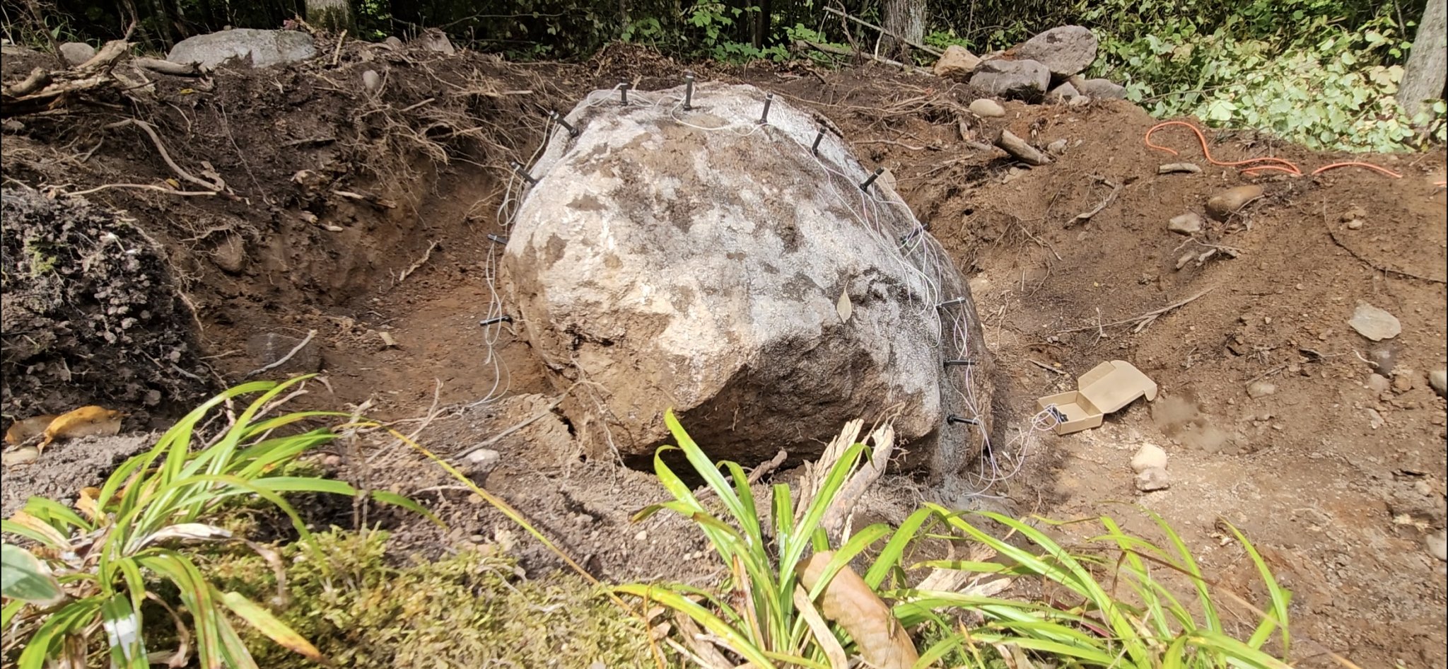

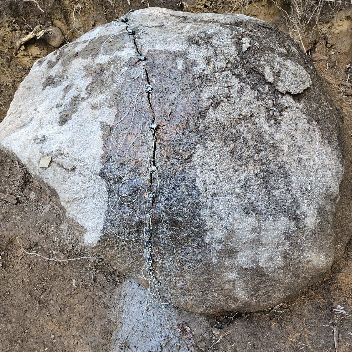

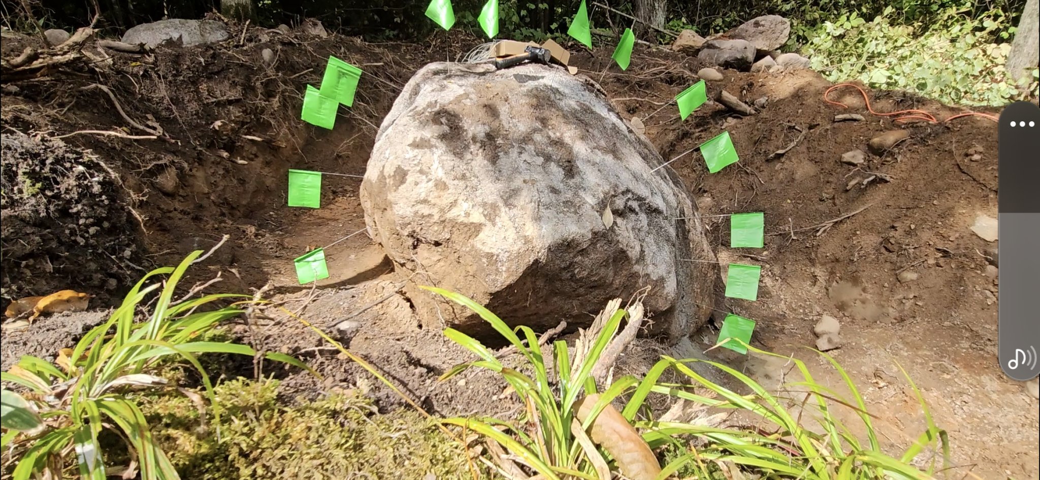

I looked into DEXPAN (from another post here I think), it creates about 18,000 pounds of force per hole. Wedges are good for 15,000# with a 3# hammer, 20K with a bigger hammer--but the wedge gets damaged from any bad hit. The benefit of wedges is controlling the sheer line by feel, which, once you get the feel for it, is quick and pretty easy, and requires far fewer wedges and therefore fewer holes than DEXPAN, and therefore less time and cost.
Before:
(left)
(right)
(near)
(near, with wedges)
After:
Mind you only 1/3 to maybe if I'm lucky 1/2 of the rock is visible.
The trick is to not bang wedges like in tree work, but to tap and listen to each wedge, then tap the wedges that you want to steer the sheer line with once, then tap a neighbor once, and continue the process like that.
