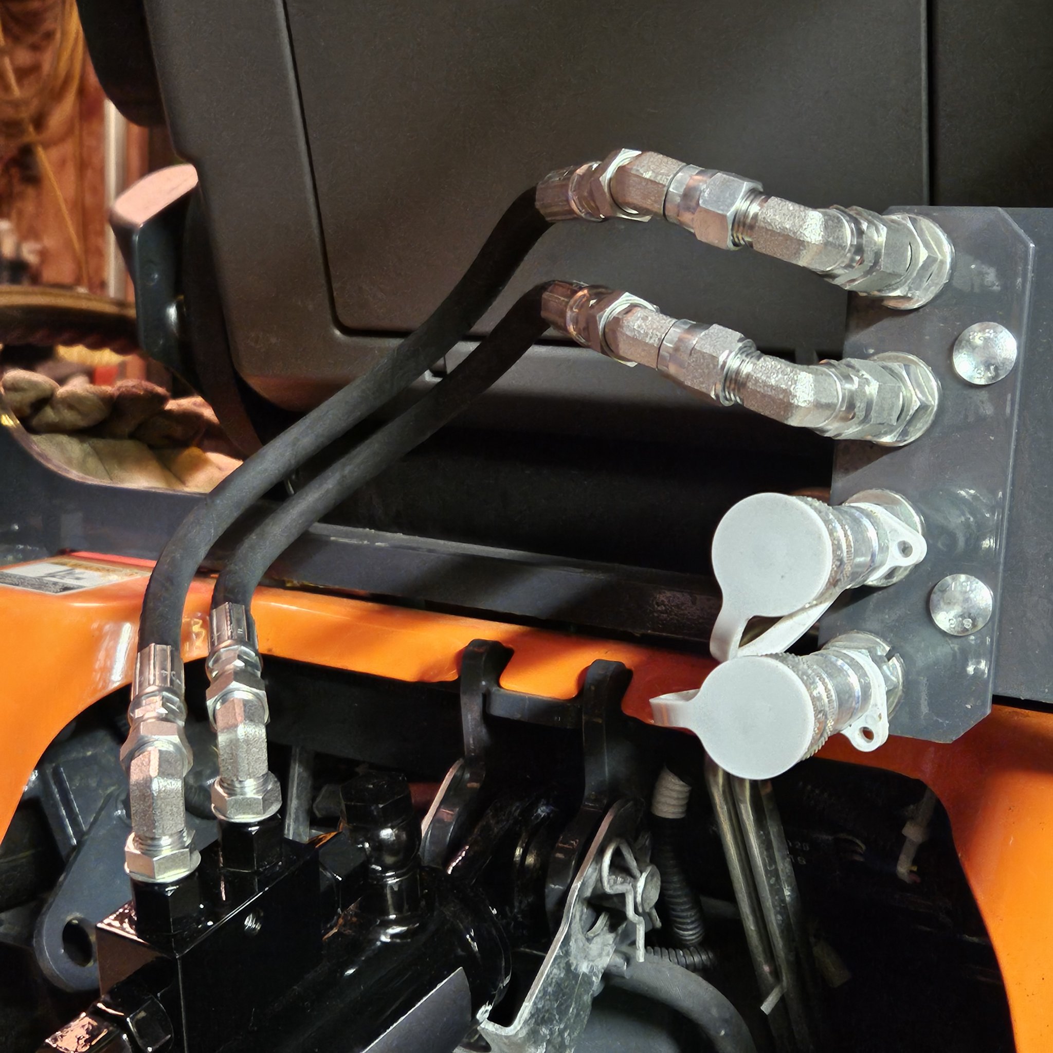

With OTT members sharing knowledge the BX 3-point hitch went from four-letter word painful to pretty darn nice and much easier to use than the OEM setup:
After OTT members helped with an education in hydraulics it became even better:

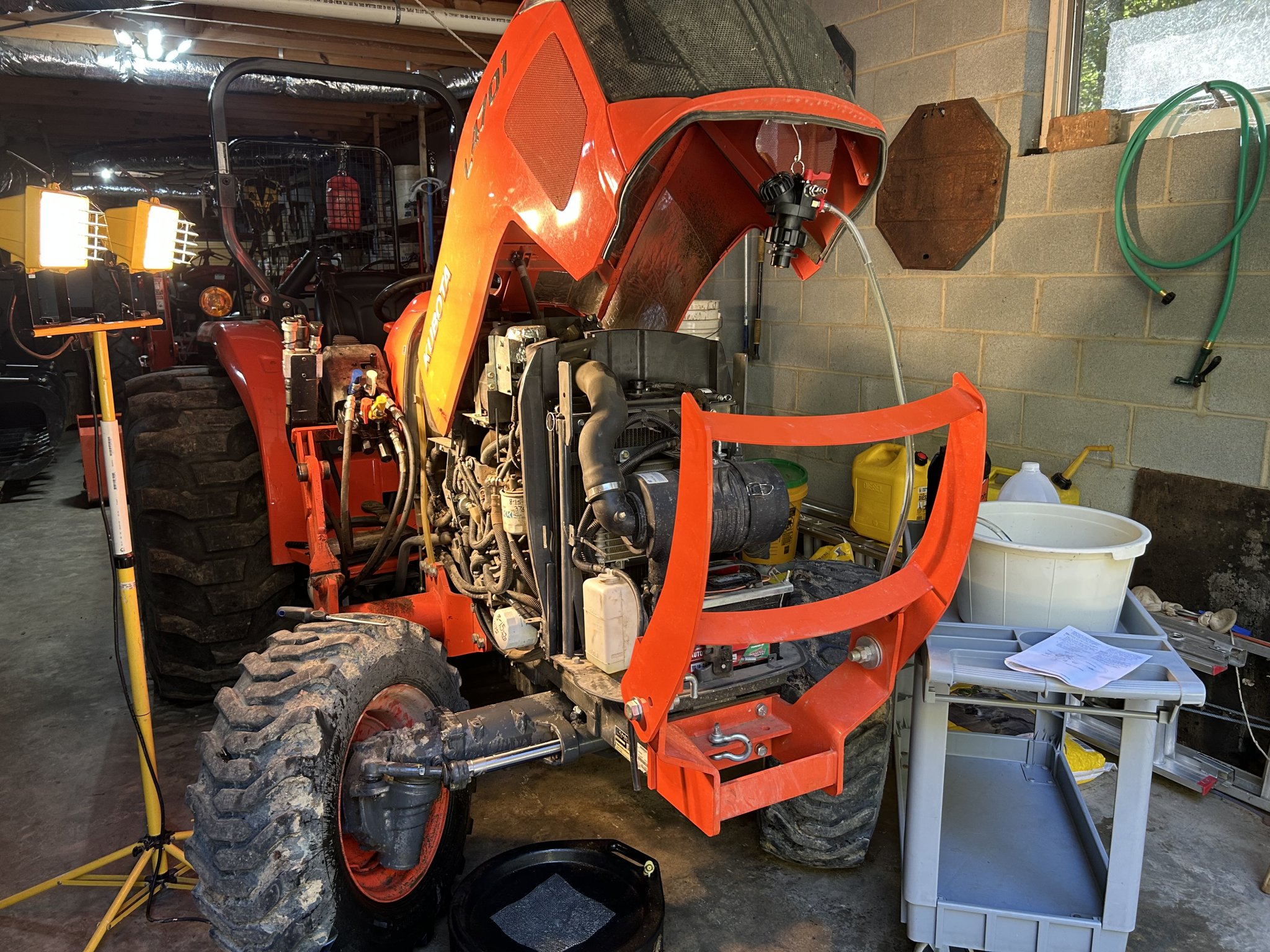

Took the loader off, removed coolant, ran a flush, and refilled. First time using a vacuum filler. Not a tool I anticipate using frequently so I cheaped out with a Harbor Freight “Maddox”. It worked perfectly.
I was glad I measured the radiator fill tube opening and overflow tank opening before buying the vacuum filler. Fill tube opening is 31mm, overflow tank 29mm. Several kits I looked at, even some high dollar ones, didn’t have either of those sizes in their array of adapters.

Nice! Coolant exchanges are so much easier with the aid of a vacuum fill tool. I have the Schwaben kit and it comes with two cone shaped bungs to fit a wide variety of openings as well as an adapter to work with EWK oil extractors. I've used it three times already so well worth the $100 or so. I've used the EWK oil extractor many times now and that's a really useful thing to have around. Interesting that your expansion tank is so low down.

I think your Schwaben is a step or two above my Maddox.
Read the instructions a few times because it seemed too easy; like I was missing something. But no, it’s really that easy.
Aside from likely not holding up long under routine use by a real mechanic, the only thing I didn’t like about the Maddox was the air line fitting. Instructions say to install the 1/4” quick attach fitting. Thought it a little odd that wasn’t already installed since there was one in the case. First use of anything often involves some one time set up steps, so no problem. At least not until I put it back in the case and realized it doesn’t fit with the quick attach installed in the manifold. So either R/I every time or drill a hole in the case for the air fitting to stick out. Oh well, I knew there was likely to be something jinky about anything from Harbor Freight. At least it wasn’t anything functional.
Thanks for inspiring me to buy this thing.

I can't take the credit since it was @The Evil Twin who recommended both EWK systems and the Schwaben, which interfaces with the EWK.
I wouldn't say that the Maddox system is cheap, and if it works that's all that matters. Cooling systems are often overlooked, but once you have an easy way to fill the cooling system, and have confidence that there aren't any air pockets, it's more likely that the coolant will be replaced every year or two. I'll be using the Schwaben on my other vehicles too so it's not just for tractors.
The EWK brake bleeding kit is freakin' awesome as well. Those three purchases (thanks to @The Evil Twin) were well worth it.

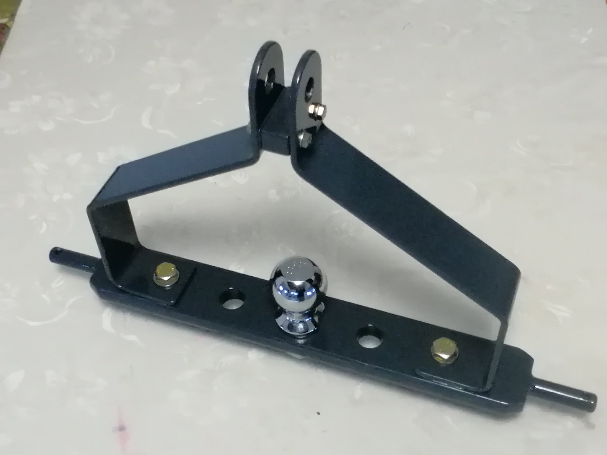

After paint top coat cured I assembled my three point hitch tow bar adapter.
I really admire the quality of the work that you do and your obvious attention to detail. It's good to have someone set a high bar and drag the rest of us up with them. A rising tide floats all ships .... or something to that effect.

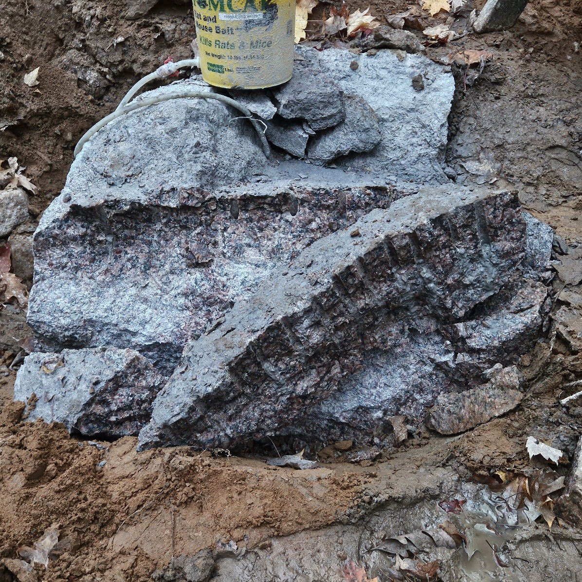

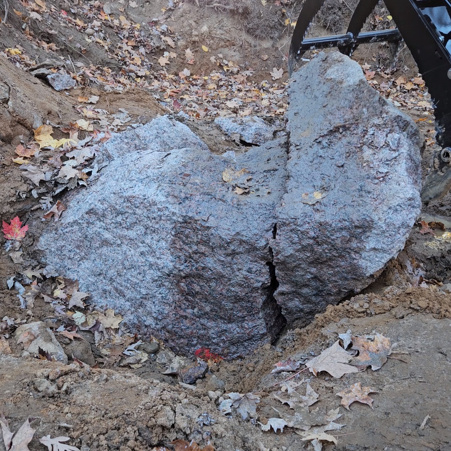

Moving on to the far side of the rock, let's take what's left of the top off by drilling holes and wedging around the perimeter:
Then give it a push so it tips over the edge and the grapple can get under it:
The bottom is going to have to be split into thirds, let's pull 1/3 out of the hole:

I should have wedged all the way around on the next cut, I only did the top and the side fractured off. All those holes wasted...
I think this is not trivial and you cannot look inside the rock what structure is there. And yes, maybe not optimal but not wasted either, you got a chunk off. You will get it done (y)
