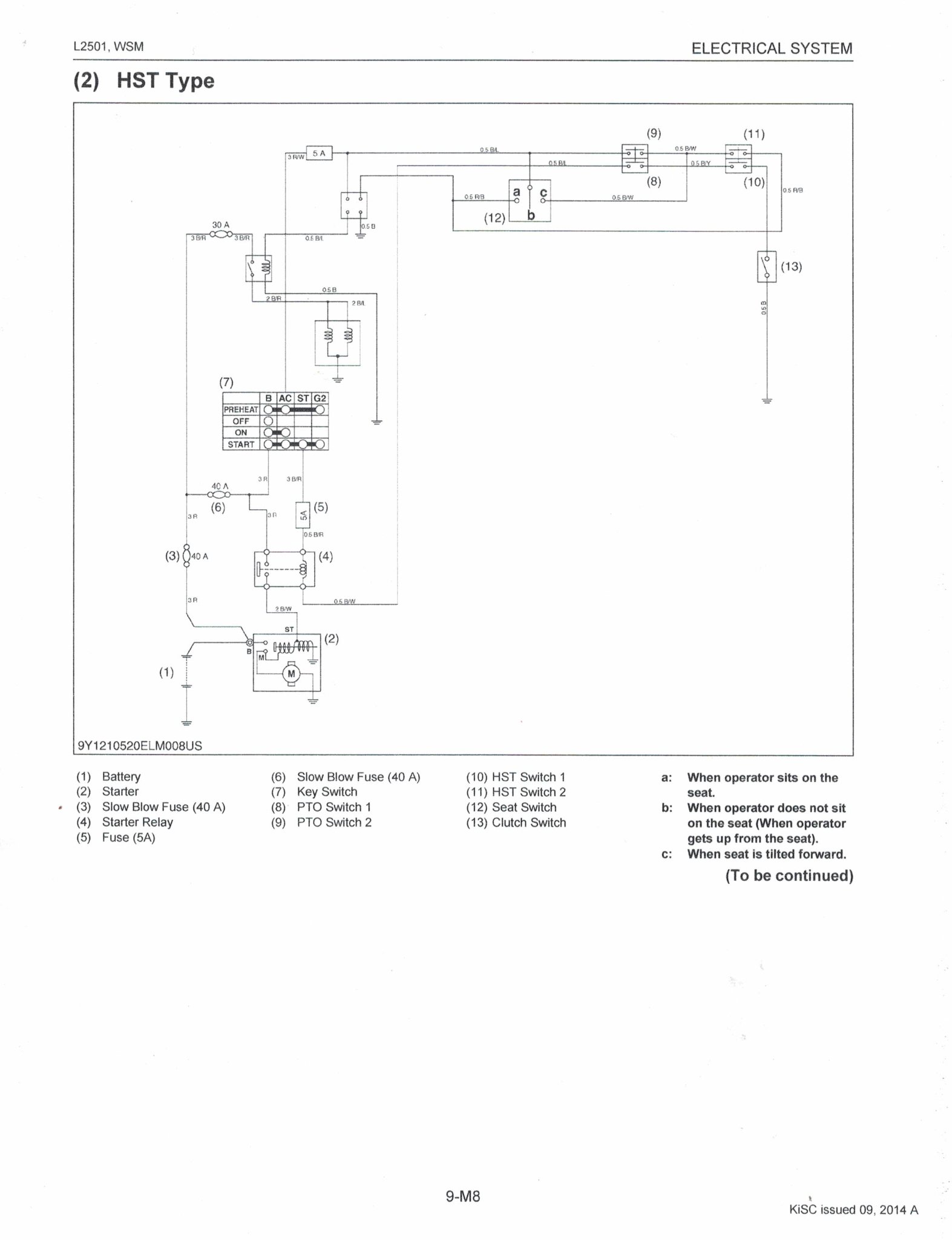

according to the diagram in the WSM, page 384, the 'starter relay'( 4) has a 5 amp fuse, the starter has a 40 amp fuse (6). The starter relay contacts feed the 12v to the starter.
So, if he's replacing the starter relay contacts ,he needs a switch that will carry 40 amps.
If he's bypassing allt eh 'safety stuff' and controlling the starter relay coil, then the switch needs to handle 5 amps (rating of fuse (5) ).
I think his intent is to simply put a pushbutton across the starter solenoid and battery. That switch has to handle the current draw of the solenoid and nothing else.
A typical starter solenoid design uses two coils - a pick coil that draws something like 20-25 amps and a hold coil that draws something in the 10 amp range. When initially energized both coils are in the circuit and you get a combined current draw of 30-40 amps for a matter of a few milliseconds. Then the pick coil is effectively shorted out and the hold current settles at around 10A. You can use a relatively light duty pushbutton switch but the solenoid design is hard on the contacts and switch lifetime will be reduced. Thats a pretty common issue in older vehicles where the solenoid was switched directly by contacts in the key switch.
Starter motor inrush current is several hundred amps and steady state cranking current north of 100. The motors are not fused.

Yes but. It does bypass any cranking interlock.
12,445
5,379
re: ...
wire a simple "engine start push button momentary start switch" to replace the starter relay.
BTW: Doing this does NOT bypass any of the safety relays.
YES it does ! Your push button replacing the starter relay contacts does in fact bypass all the safety switches that are in series with the starter relay.
perhaps you can 'cut and paste' a modified version of the wiring diagram. Maybe something is 'lost' in the wording.....

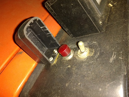

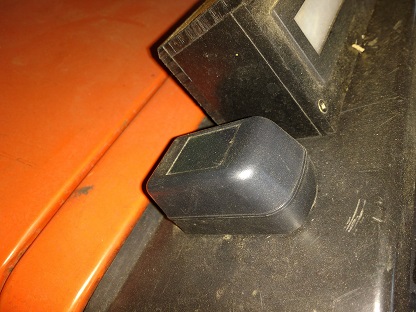

I wired these in for emergency use only, if I experience a failure of the safety switches. It allows me to go when there is a problem, get the job done, and then worry about fixing the safety switch problem. The toggle is a safety bypass for ALL the safety switches, and the push button is a start any time the key switch is on. Not many people want to be playing with their safety switch continuity when there is a job to be done under time constraints.
I have front mount snowblower, and a dog that loves to deposit stones all over the driveway. Using the bypass switch, allows me to dismount and remove shear pin destroying stones, without shutting off the blower all the time. If this causes me to be injured, I guess I will just have to sue myself.

here's the wiring for his tractor...
I'm thinking he wants to replace the starter relay(4) contacts with a pushbutton.
Since the contacts have a 40A fuse, that is why I'm suggesting a 60A push button.
Rewired this way DOES bypass all the safety stuff...
