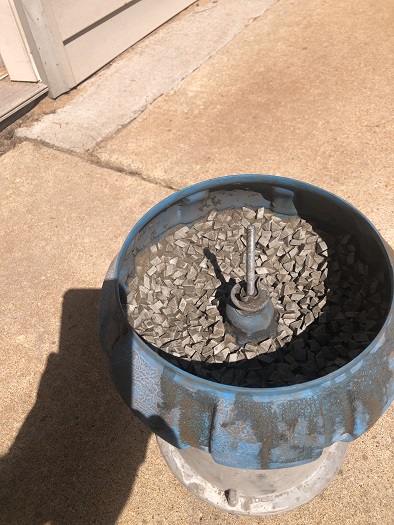

RWS asked: Is that the same type of tumbler used for cleaning brass when reloading?

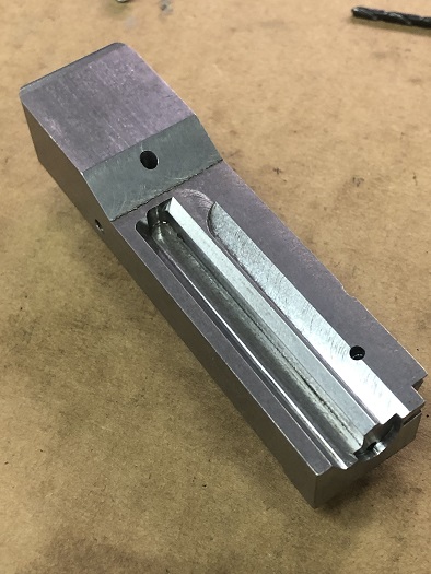

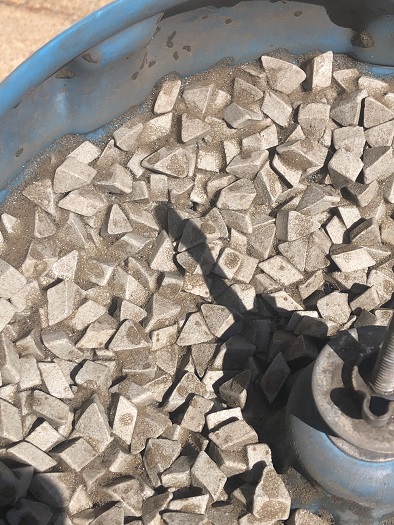

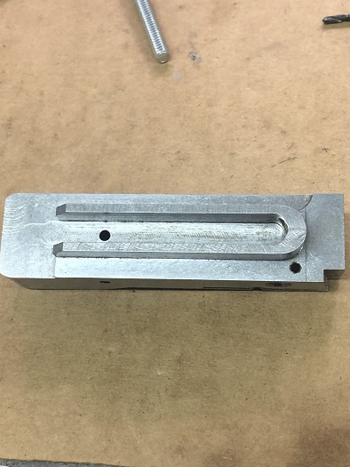

Sorry for getting back to you so late but I just finished a part out of 4140 that I tossed in the vibratory bowl and I wanted to show you the results. To answer your question, yes this is the same thing you use for brass cartridges. I used this media from McMaster in the bowl with just enough water to wet the media along with a couple of drops of dishwashing soap to make it a bit slippery so the part moves through the media better. https://www.mcmaster.com/4918A192/
This was only 2 hours in the bowl but you can see the milling marks have been softened.
Sorry for no before picture, but this is the other side.
The top on this picture was surface ground so don't get deceived about the finish.
View attachment 161658 View attachment 161660

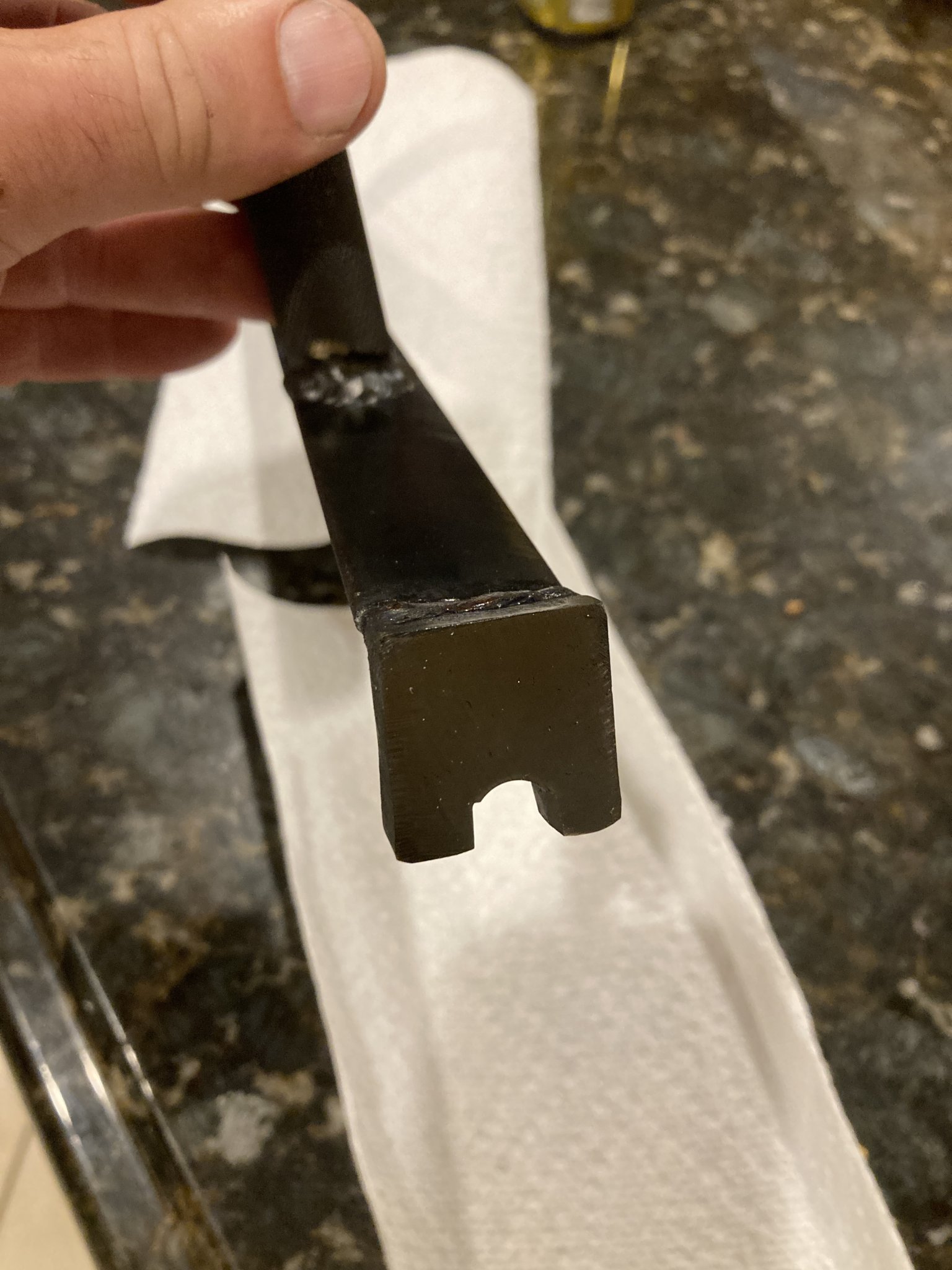

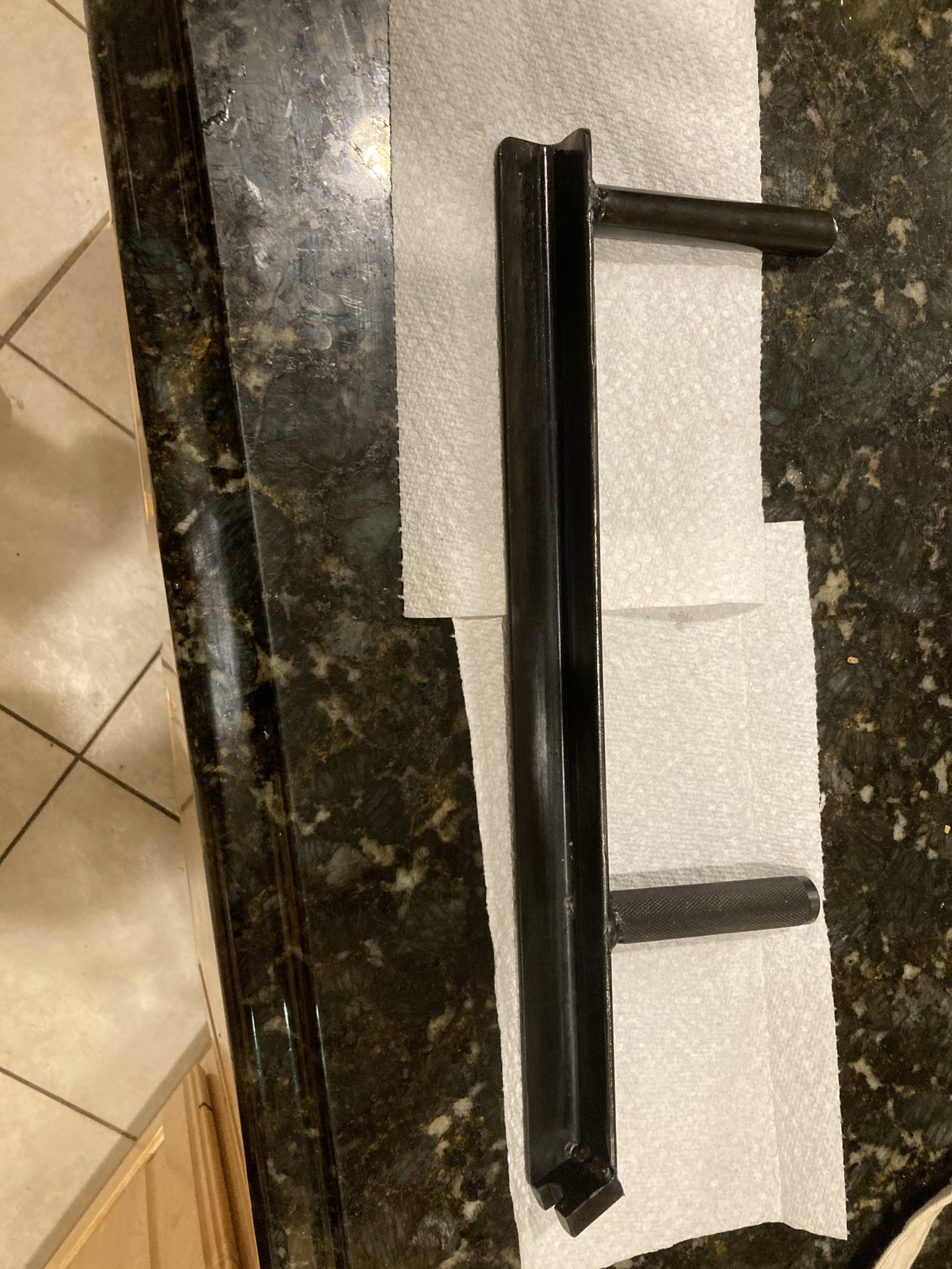

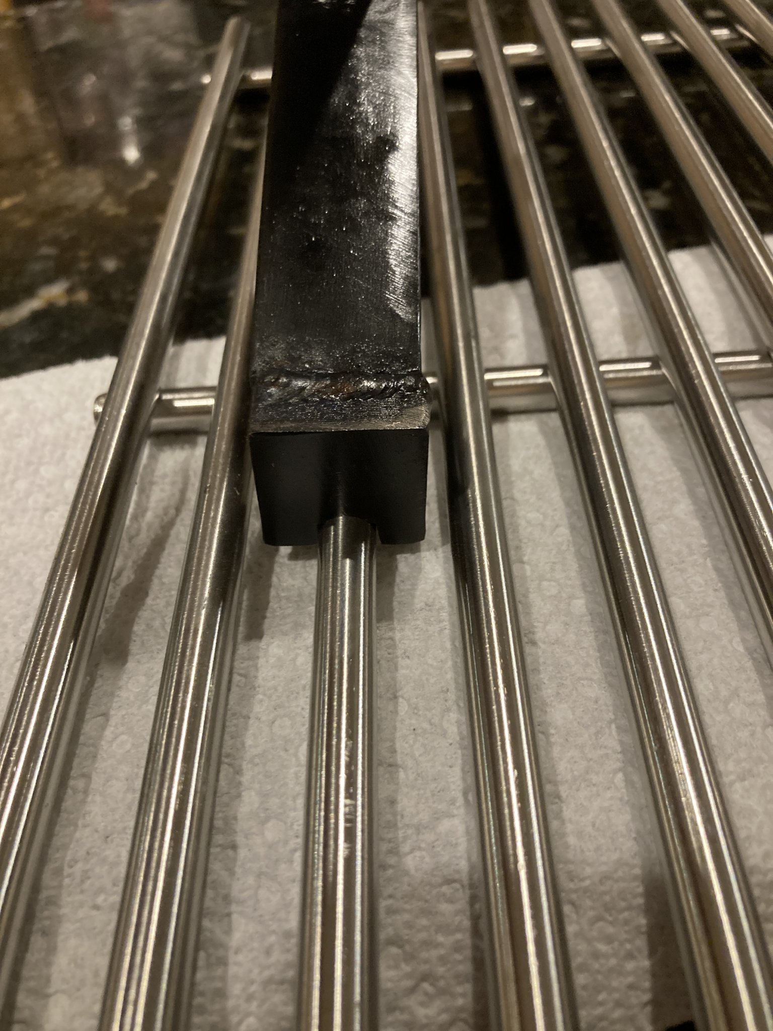

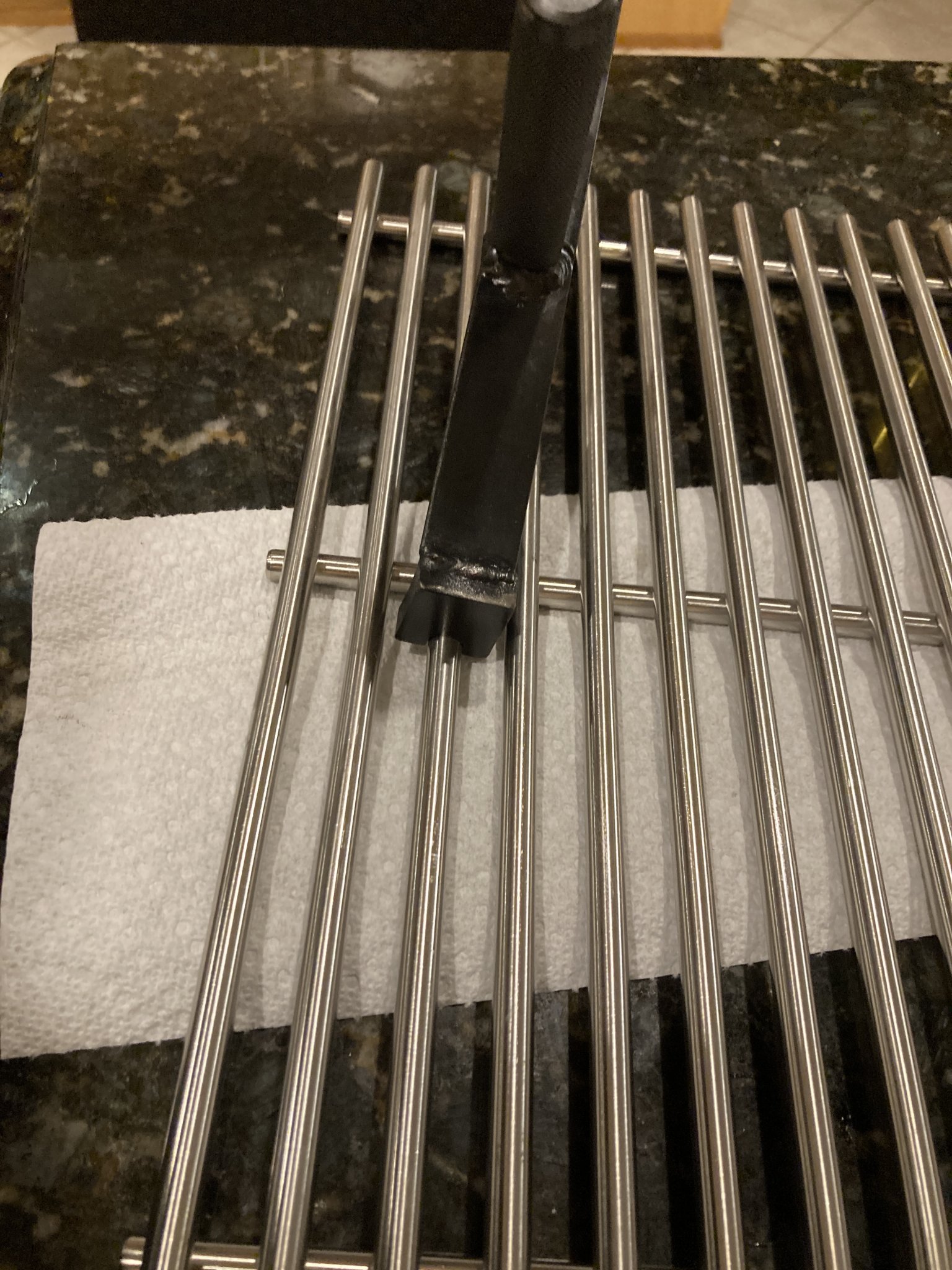

We just bought new grill grates for the cabins grill, and the Mrs. asked/ordered me to build a “grate scraper” for it, in the same fashion as I made for the “at home” grill, but she wanted it lighter.
So I dig around the scrap pile and cobbled something together that is the same “basic concept” as the original, just “lighter”.
Well "low and behold” I needed to give it some sort of "rust protection”.
Now I am “notoriuosly cheap” when it come to my supplies. I tend to try and stretch my supplies to the maximum. (arguably to a fault).
So I want to use my new “Magical Black Oxide” to coat it, however there is a problem.
I dont want to “mix up” more of my “magical solution” when I have some still left over from the last project. (thats how “cheap" I am)
I also can’t find a suitable container to accomodate the “length” of this scraper.
So in a pinch, I make a “bowl” out of aluminium foil and decide to try and “brush on” the "used blackening solution" (instead of soaking, cause I don’t have enough)
It took forever, but it “kinda worked”. The solution was clearly not as “potent” as it was originally and I blew the “5 minute maximum” time out of the water, just dabbing and brushing….dabbing and brushing….etc……It took proably 45’ish minutes…..
There were spots that I missed when prepping it, so I tried a “new technique”.
During this process, I used some Scotch Brite to “re-do” the spots I missed, and then used an acid brush to “dab” some 100% un-cut Blackening Solution onto those spots.
Then “brushed on” the 2nd “oily finish” part, as per the instructions.
Worked out FANTASTIC!!!!!!
I couldn’t take any pics due to my hands being in gloves that had that solution all over it, but here are some “after shots”
Here is how this style of “scraper” works……I like it much better than the “metal brush” styles.

Very nice. Scraper head looks super effective. Feather in your cap that the wife ordered a second one!
And yeah, all the wire brush style scrapers I've had have sucked and/or not lasted. The "OKest" one I've found wasn't really a brush, but still not as effective as yours looks. https://www.amazon.com/dp/B01MYC1C2D
