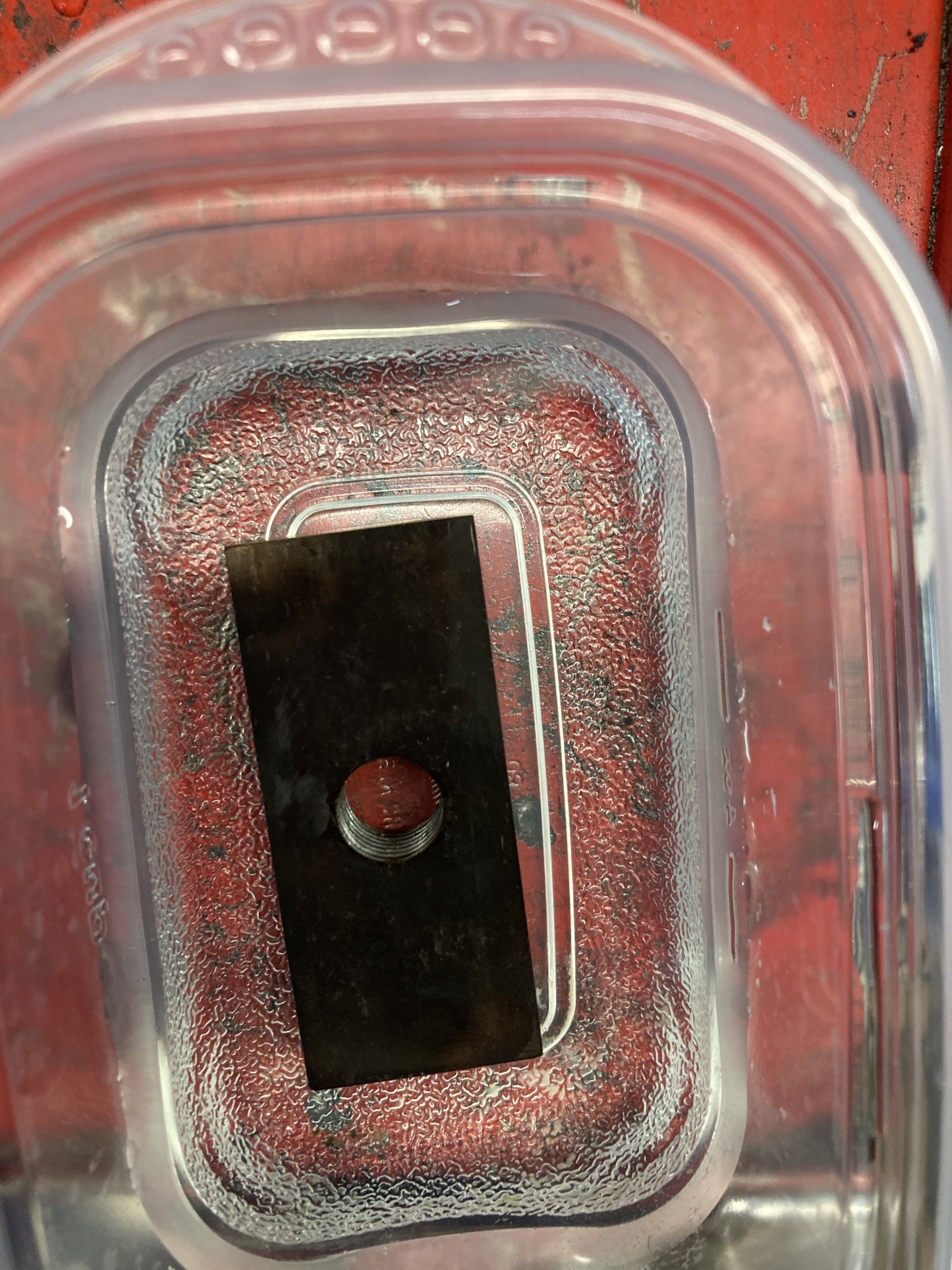

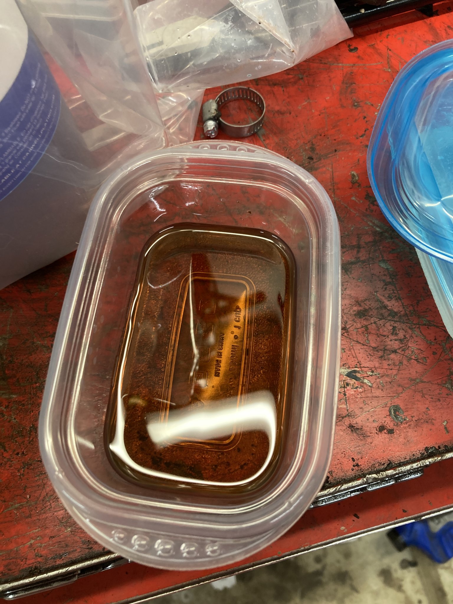

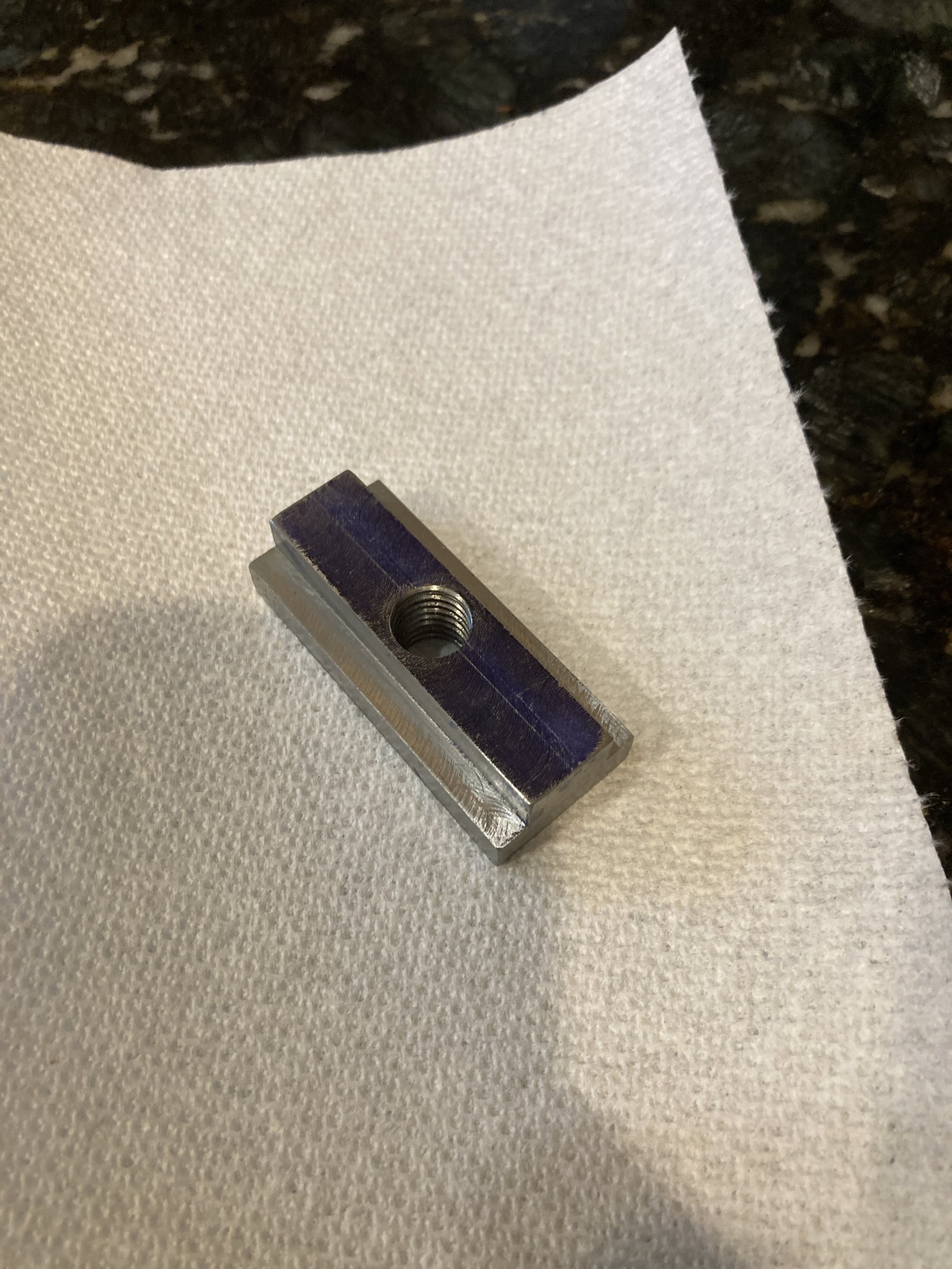

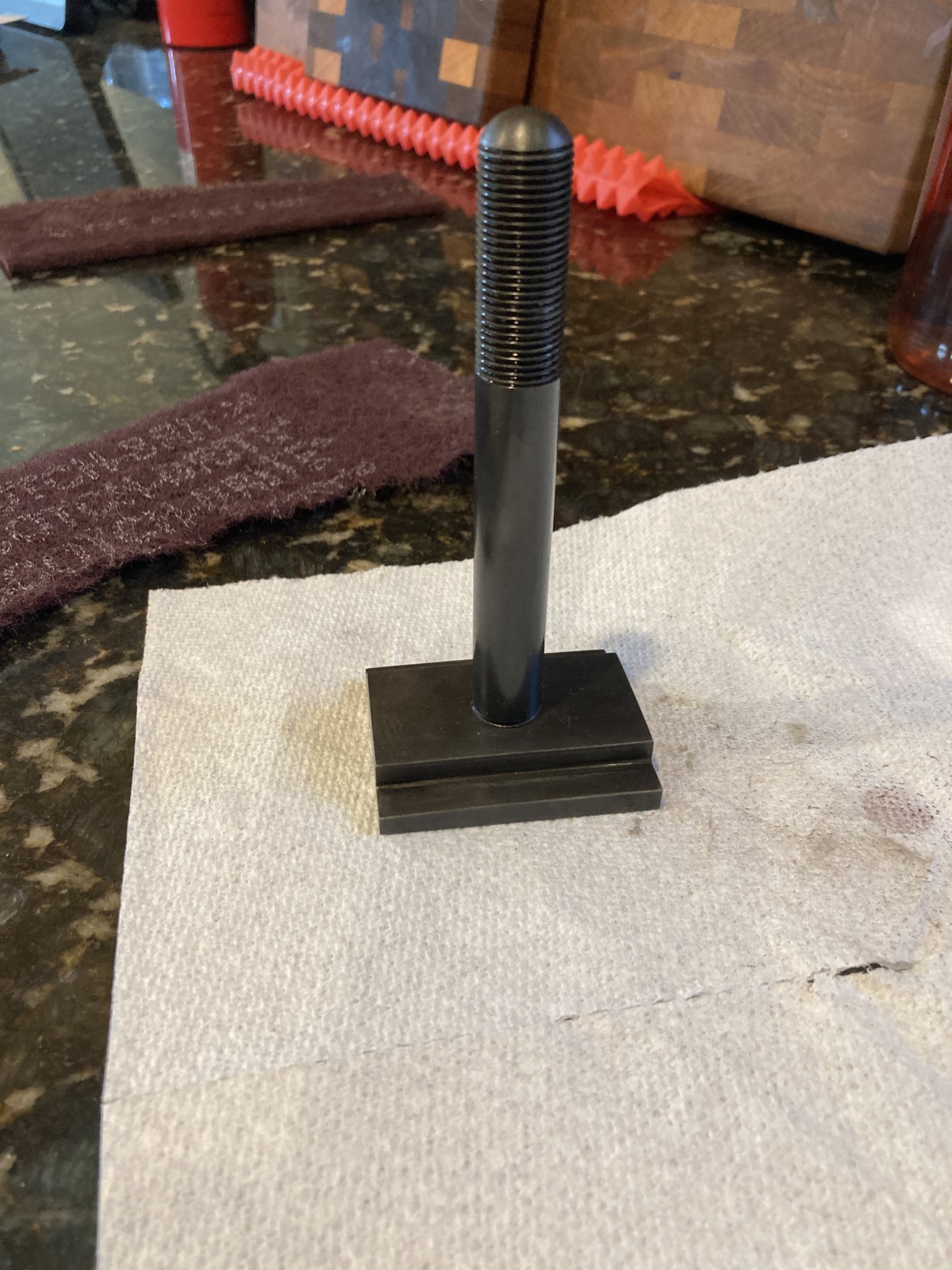

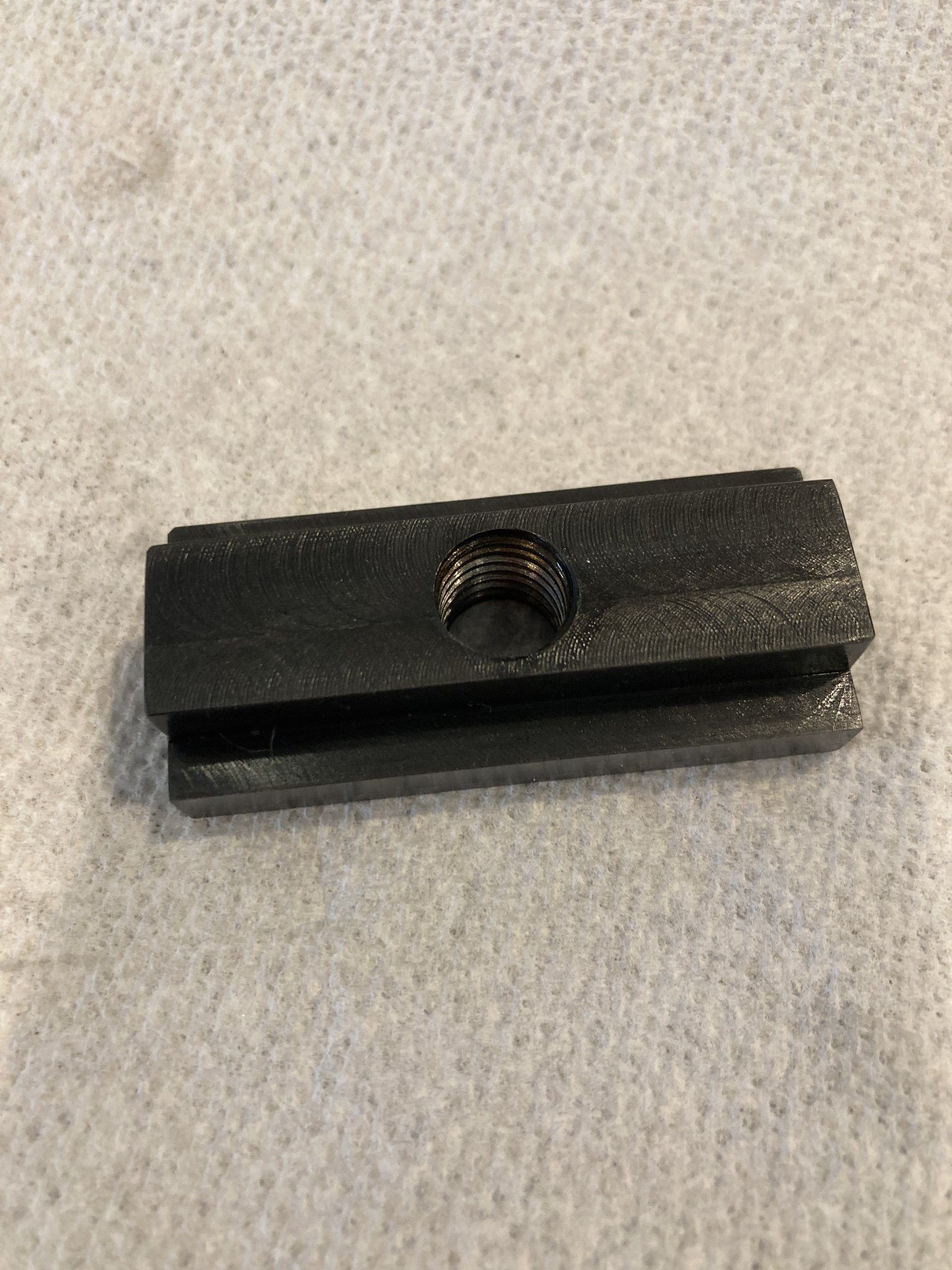

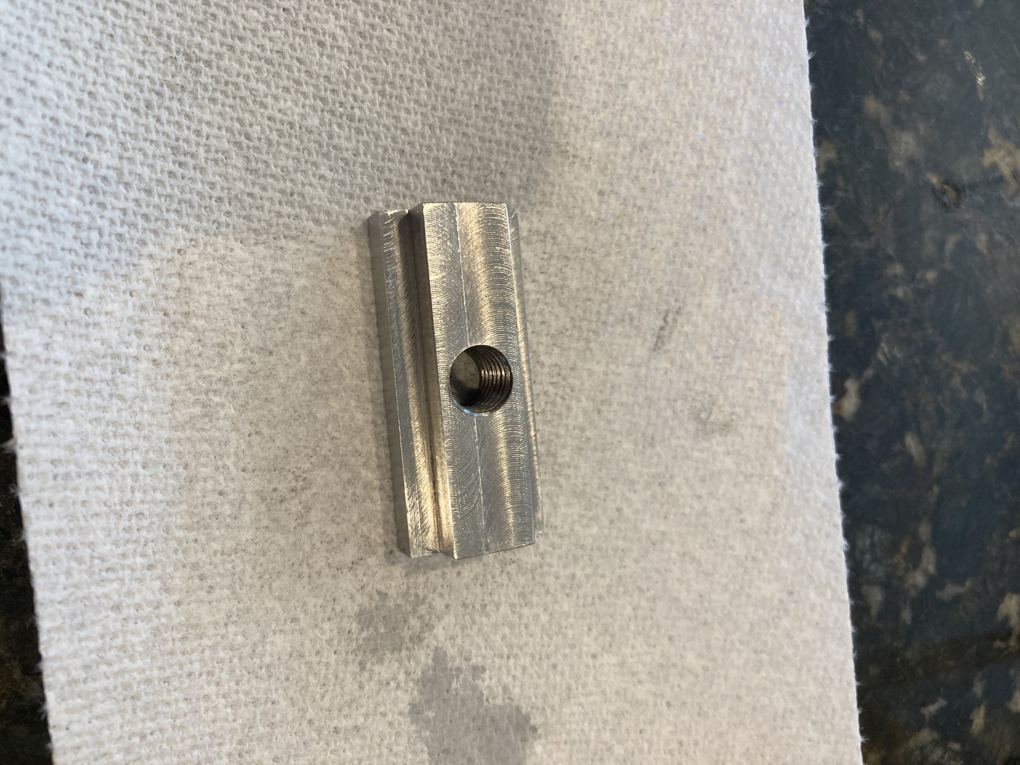

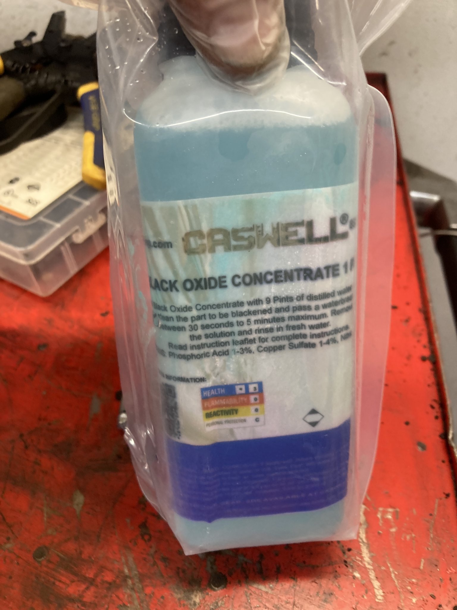

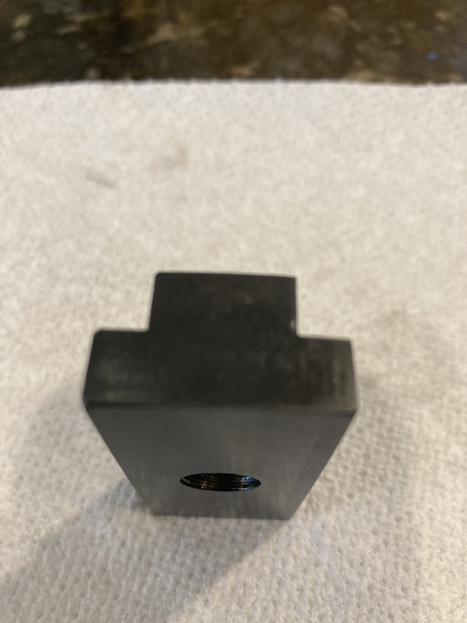

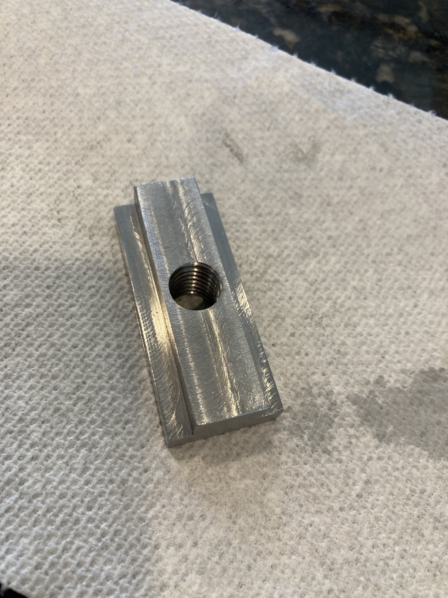

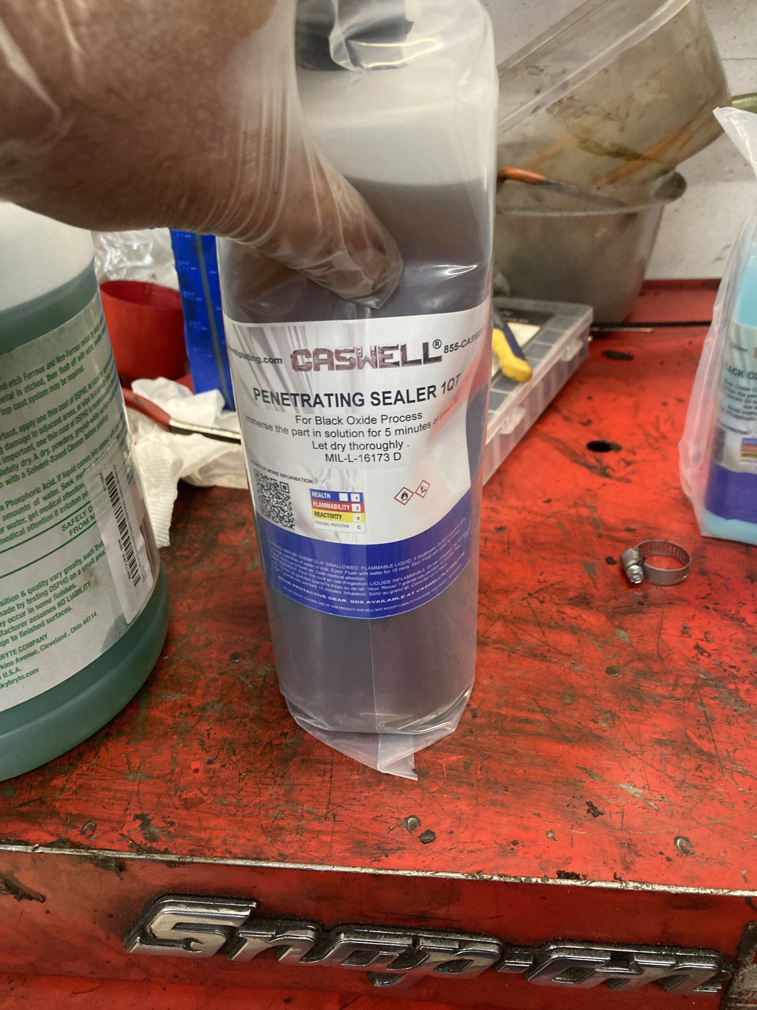

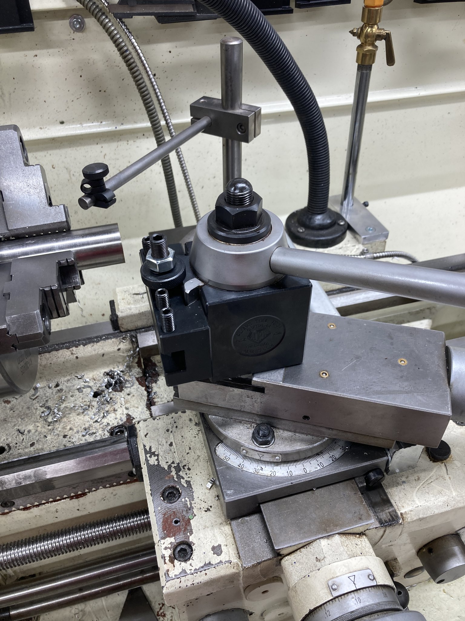

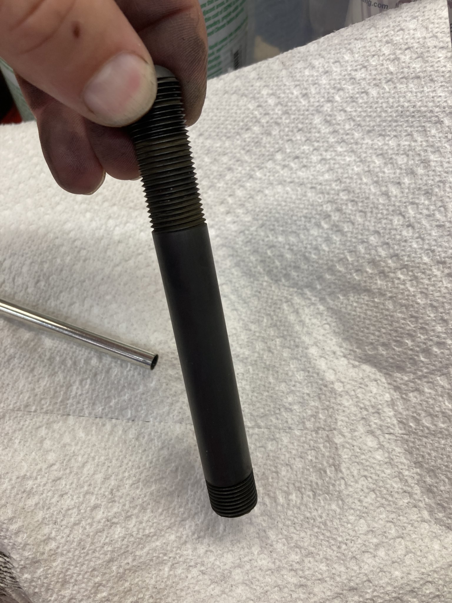

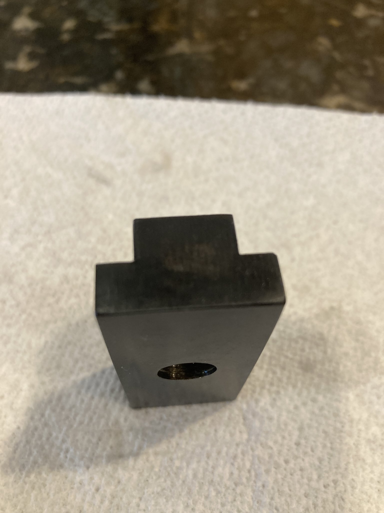

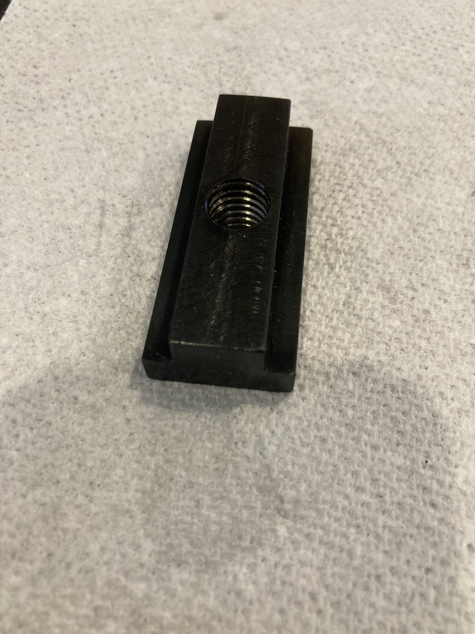

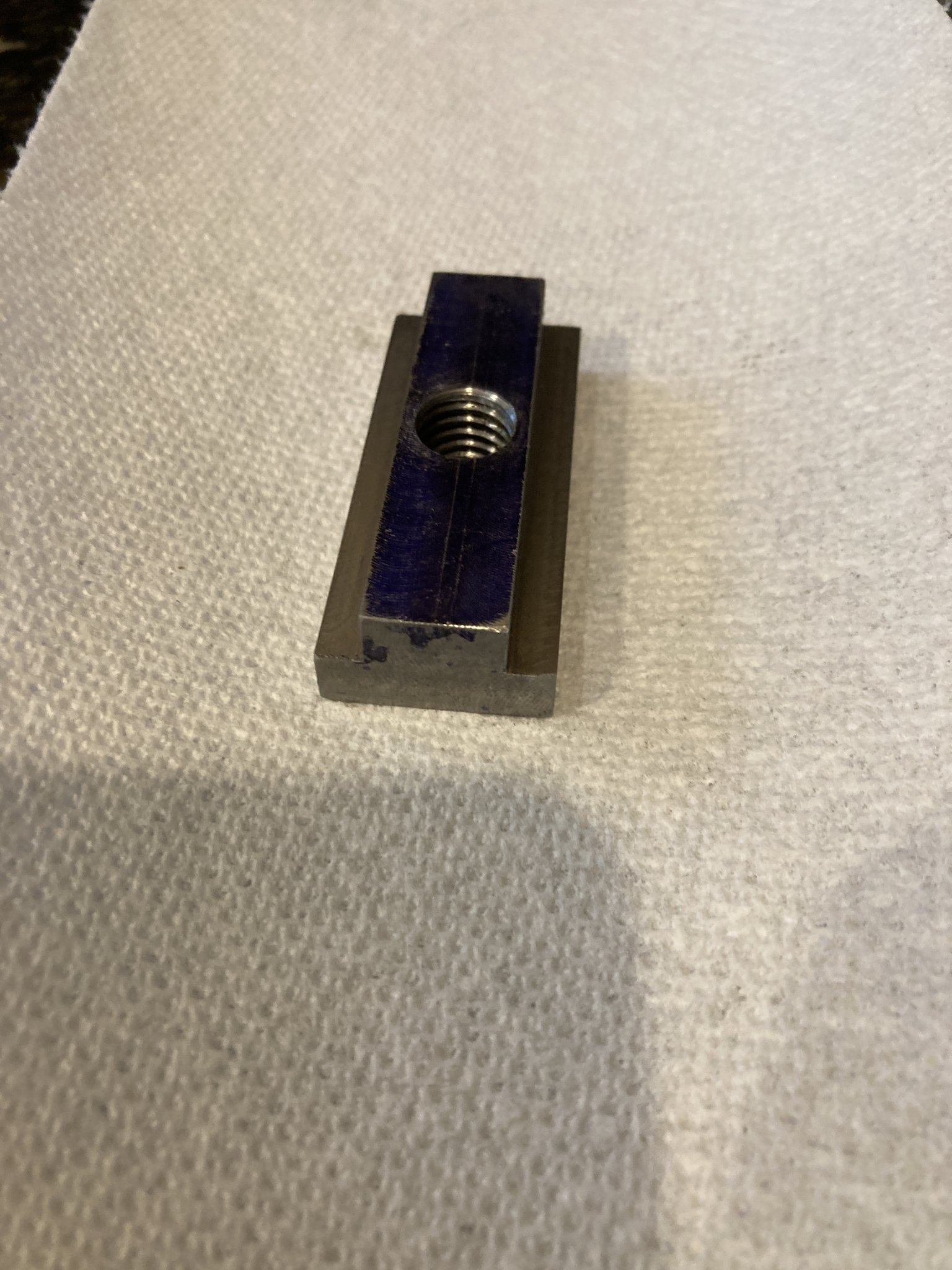

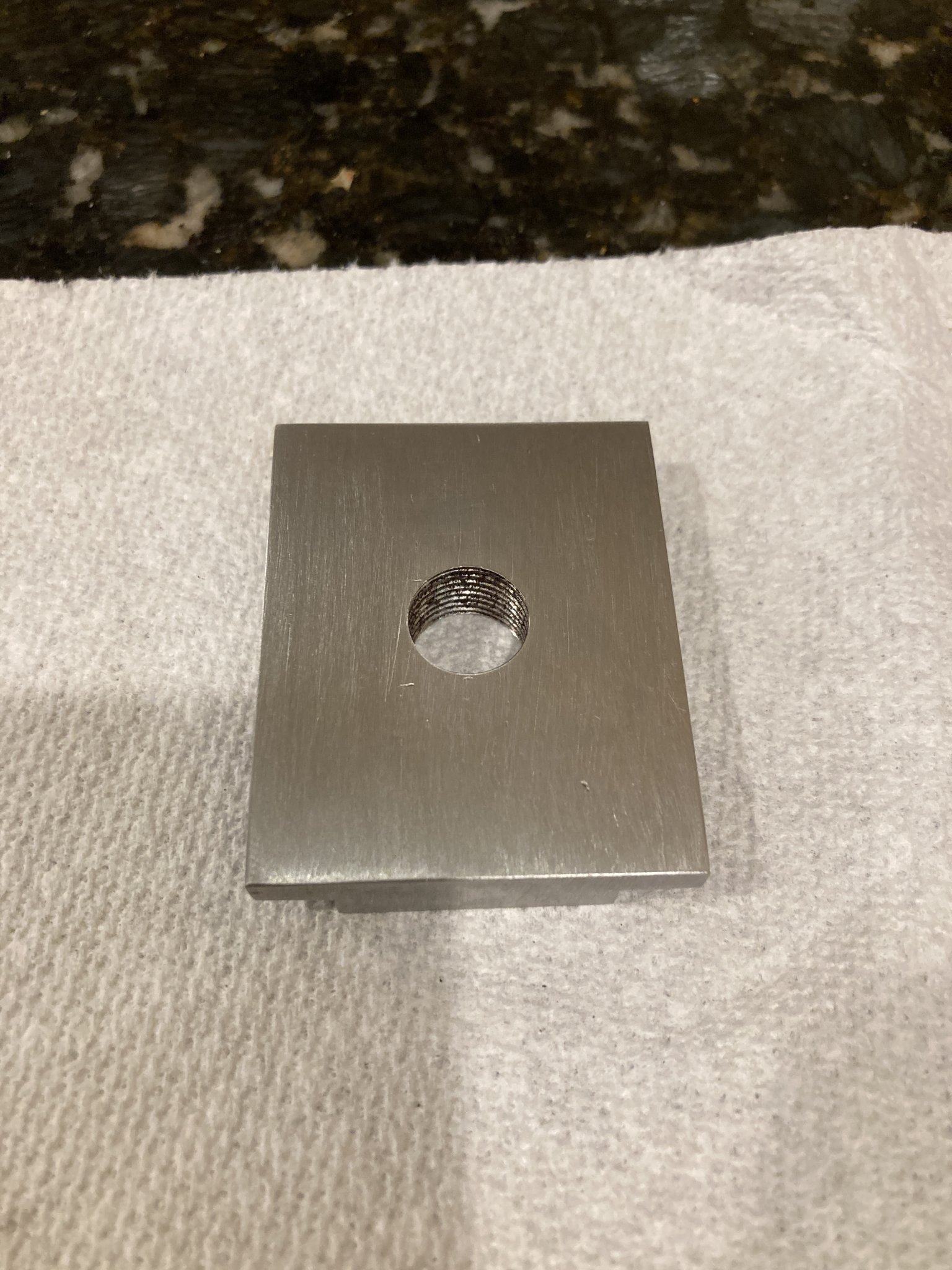

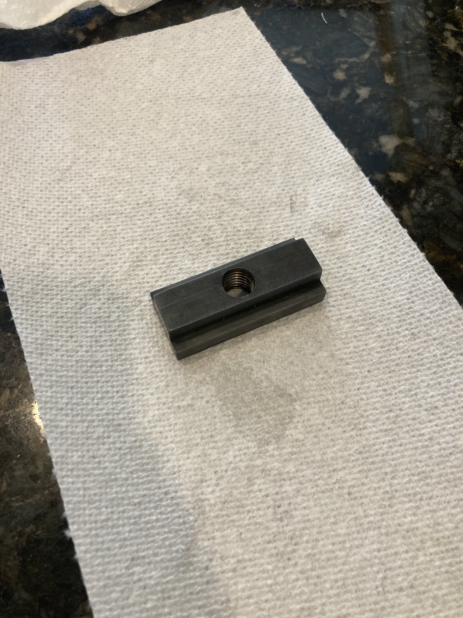

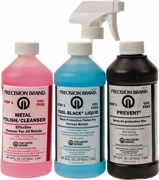

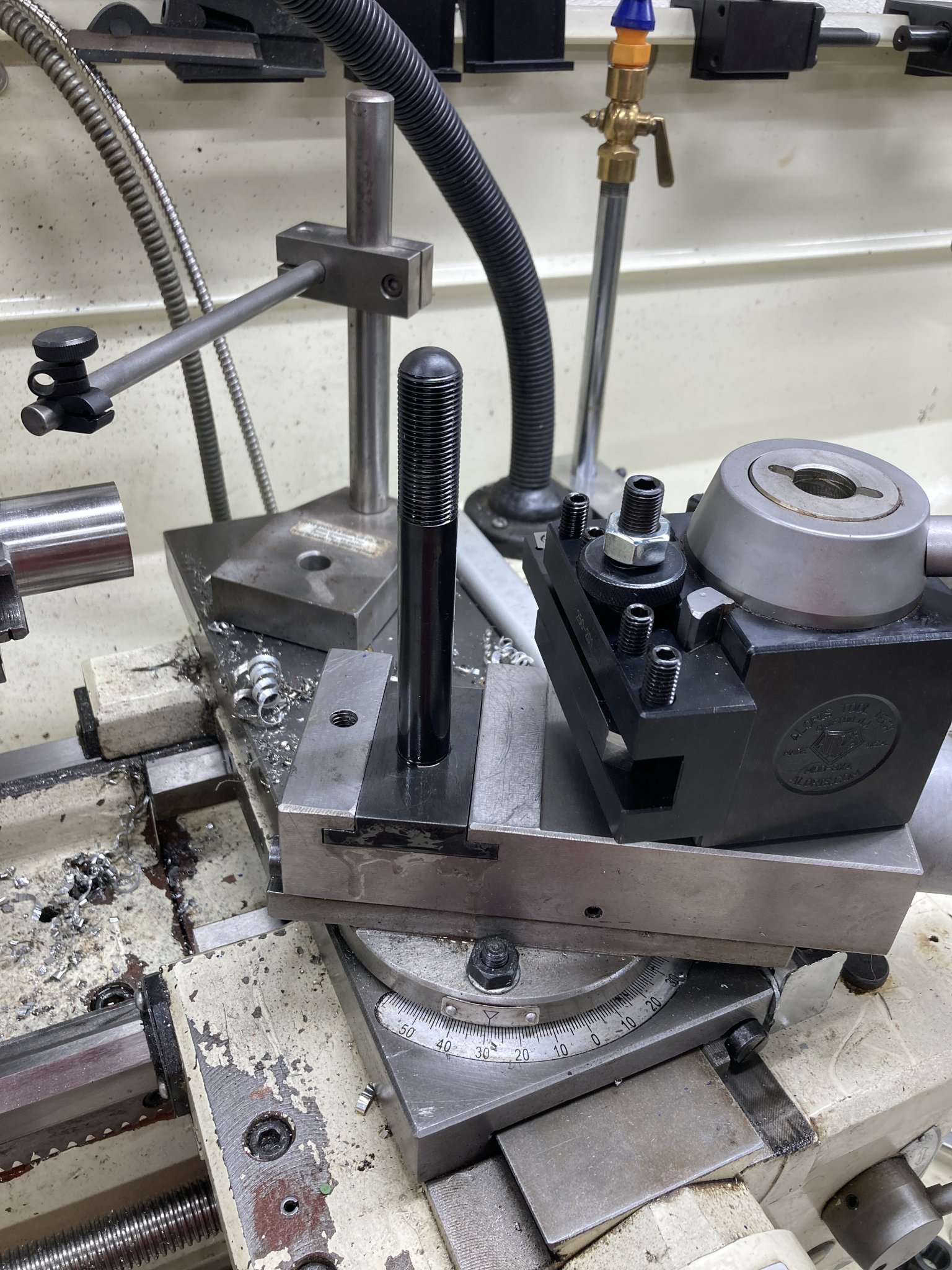

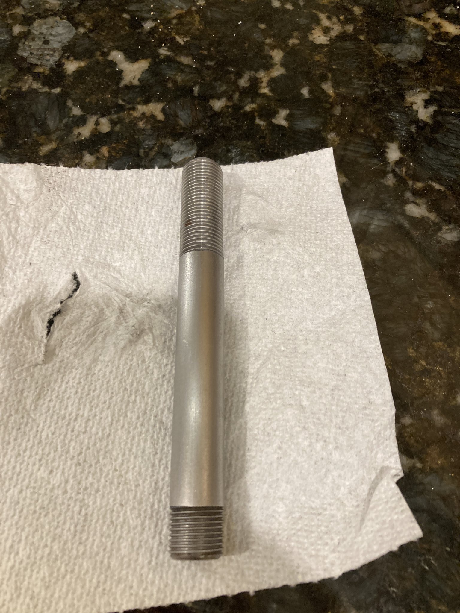

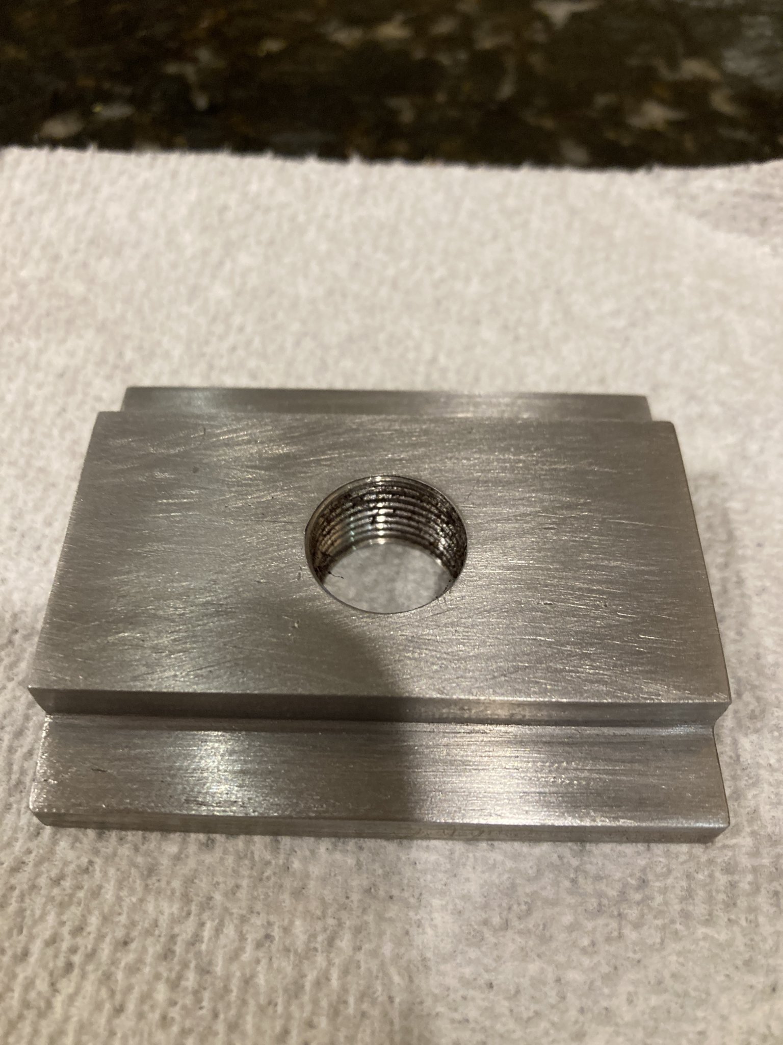

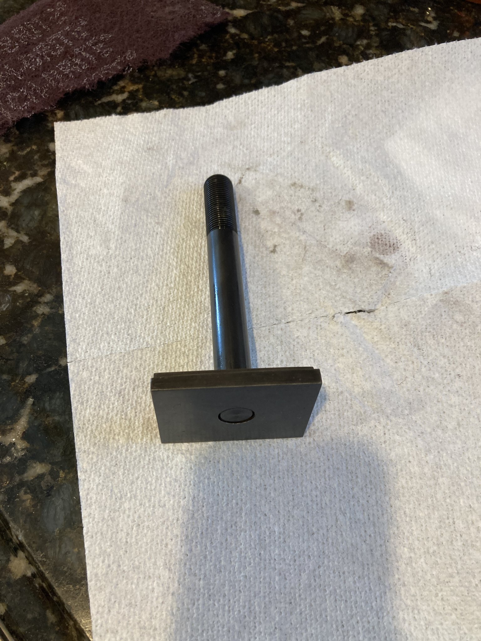

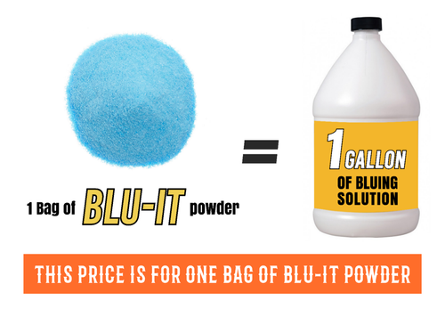

Well "Blow me down!"
3,011
3,740
I was perusing the inter-web the other day, when I stumbled upon a video of some guy doing this "Black Oxide" thing to some tool he made.
That piqued my interest.
Coating/painting/top coats/finish's have never been my "strong suit". For whatever reason, this has alway been my "Achilles heel" when it comes to just about any project.
Well before I know it, my CC jumps out of my pocket and I order this kit to try it out.
Well as luck would have it, I just made a T-nut for my Craftsman lathe (because I am replacing my Dorian AXA tool post with a bigger/better one....an Aloris BXA)
ASIDE: Thanks @Lil Foot for selling me that power drive...It has made a world of difference on my mini-mill. (y) :)
Well here it is
It fits "like a glove" and I am happy with it. (Although it took me a "stupid long time" to make it....i.e like 6 hours :confused:)
I am quite sure it would be "just fine" as is, but I reason that it would make sense to try out this new kit, just to try it on something that it will not make any difference on if I F it up.
So I spray it down with brake cleaner, then take it to the sink and wash it down with dish soap, rinse and dry it.
For the life of me, I can't figure out how to get rid of those milling marks.
I have tried all kinds of different combinations of speeds/feeds, but in the end this was/is about the best I can do.
The camera makes the milling marks look worse than they are, but whatever.........
So I mix up the concentrate as per the instructions ( 9 parts distilled water to 1 part concentrate).
As soon as I spooned in the concentrate, it immediatly reacted.
I had no idea it would happen that fast.
Here it is as fast as I could get the phone out to take the pic.....20 seconds'ish???
As per the instructions, I let it soak the maximum time of 5 minutes, then pulled it out, and rinsed it.
When you buy the kit you have the "option" of either a "oily finish" or a "dry finish".
I opted for the "oily look" , so I soaked it for another 5 minutes in the "finishing agent"
Per the instructions, after 5 minutes, I just hung it to dry. (no rinsing it this time)
Well I am happy to report that it turned out fantastic!!!
It looks very professional, and the best part is that it was "odorless"......
I know it is not an "end all, to beat all" solution for everything, but man it sure beats the hell out of painting.
Here it is before the "oily finish"
and here are some of it after the "oily finish" application.
Reactions: 8 users
3,011
3,740
I hit the 10 pic limit......so here are a few more
All in all, I super pleased with the results.......
Reactions: 9 users
edritchey
Ferris IS800Z - New Holland WM75 - John Deere X500
Jul 19, 2014
1,122
827
Wellsville, PA
Looks awesome I might have to pick up some and try a few small gun parts in it to see what it looks like. how do you post those pictures on here?
Yooper
3901 LA525
May 31, 2015
1,649
791
NE Wisconsin
Now you are going to have to buy a vibratory tumbler to get rid of the milling marks. See, this stuff never ends! Seriously, nice job on the tee nut and that black makes it look professional!
lynnmor
B2601-1
May 3, 2021
1,596
1,360
Red Lion
You need a surface grinder if you don't want the mill marks. Just mill everything a few thousandths oversize and grind to size. Just keep spending!
6,210
3,517
Linen wheel and rouge on a bench grinder will polish that right up. (I’ve also used a linen wheel to restore damaged CD and DVD discs. Works great.)
ken erickson
Nov 21, 2010
1,275
2,212
Waupaca Wisconsin
I would not lose a seconds worth of sleep over the "milling marks" on tee nuts!
Job well done :)
Black oxide finish looks good. I was a professional gunsmith 20 years and understand the challenge of metal prep and achieving a nice black oxide finish with methods other than hot caustic salt blueing.
I am curious , did you stop short of tapping the threads all the way thru to prevent the hold done bolt from contacting the bottom of the t-slot?
bird dogger
Vendor Member
Feb 24, 2019
1,699
1,629
North Dakota
@Runs With Scissors ..... there you go again!! Enticing me to spend more money on another fun system I didn't know I now need. :ROFLMAO: Your part looks great. And a nice alternative to heat bluing!!
7,867
3,100
Nicely done.
I've been using this stuff for years:
I keep the entire packet mixed up in an old gallon ice tea jug for large and multiple parts.
Warming the parts and the solution generally speeds things up and helps with some alloys that don't darken as readily.
Hugo Habicht
G1900
Jun 24, 2024
693
916
Ireland
Black oxide finish looks good. I was a professional gunsmith 20 years and understand the challenge of metal prep and achieving a nice black oxide finish with methods other than hot caustic salt blueing.
Is the chemical black oxide actually the same as hot salt oxide? Reason I am asking is that it is virtually impossible to gain access to those oxidising salts.
lynnmor
B2601-1
May 3, 2021
1,596
1,360
Red Lion
I have used this for many years:
1 Pint Bottle Tool Black Liquid Kit - 1 Pint Tool Black Liquid, 1 Pint Metal Polish Cleanser and 1 Pint Prevent
Precision Brand
1 Pint Bottle Tool Black Liquid Kit-1 Pint Tool Black Liquid, 1 Pint Metal Polish Cleanser and 1 Pint Prevent
MSC # 43420660 Mfr # 45126
It is not a professional product but is good enough for many jobs.
ken erickson
Nov 21, 2010
1,275
2,212
Waupaca Wisconsin
Is the chemical black oxide actually the same as hot salt oxide? Reason I am asking is that it is virtually impossible to gain access to those oxidising salts.
I doubt it very much. I did a quick AI and copy and pasted, saved typing time, plus I would have had to refresh my memory! LOLOL :ROFLMAO:
Key Chemicals in Hot Caustic Bluing
  • Potassium Nitrate (KNO₃): This is a key oxidizing agent that helps in the formation of the black oxide layer.
  • Sodium Hydroxide (NaOH): Also known as caustic soda, it serves as a strong alkaline agent that aids in the bluing process.
  • Sodium Nitrite (NaNO₂): Sometimes included in the mixture, it can enhance the bluing effect and improve the quality of the finish.
  • Water: Used to dissolve the salts and create the bluing solution.
