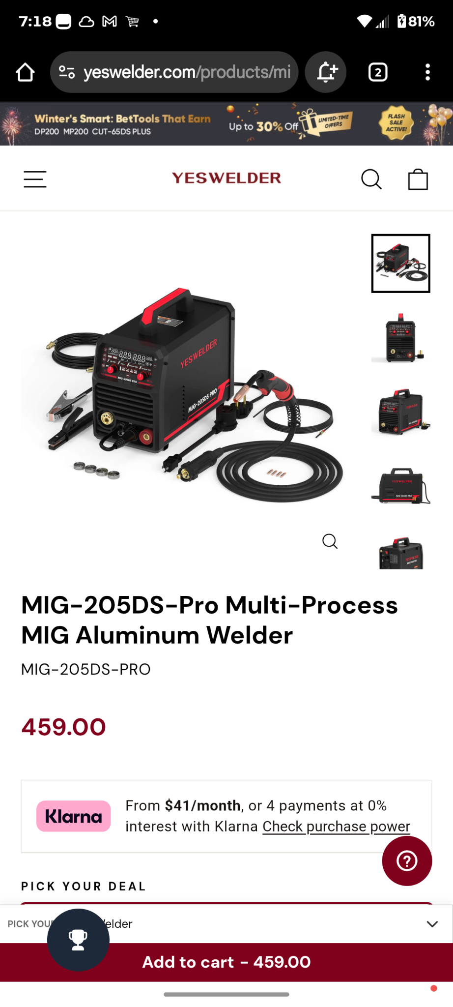

Here's two mail-order possibilities, they both have everything for stick, MIG and flux, except gas regulator. Harbor Freight

I wouldn't be surprised if a lot of the Chinese machines use components from the same factory. They seem to have the same features. Just a new brand every few years.
I haven't used my yeswelder a bunch, but it still works. I'm not enough of a welder to know, but it seems adequate. One place they save money is the case, they may roll out soup cans. They make improvements periodically, the current 'pro' model supports a spool gun, I think, and has settings for more wire (I'm not a big fan of synergy so far). They've gone to a manly black paint, mine sports baby blue. And mine has a 110 plug on the cord. Which means the adapter is a short cord with a 220 male plug on one end and a 110 female receptacle on the other. Better not plug your grinder into that! I understand they've reversed that on the newer rev's.
I looked at Miller, Lincoln, Hobart and ESAB. They make some fine machines, most likely better controls since they're designed by real welding companies. But for this hacker, I couldn't/wouldn't pay the price. And the multi-function machines are all made in China, I think.
