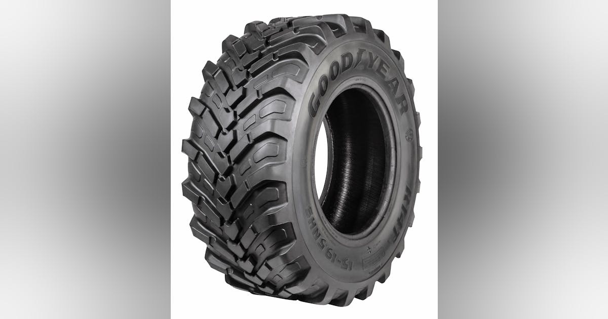

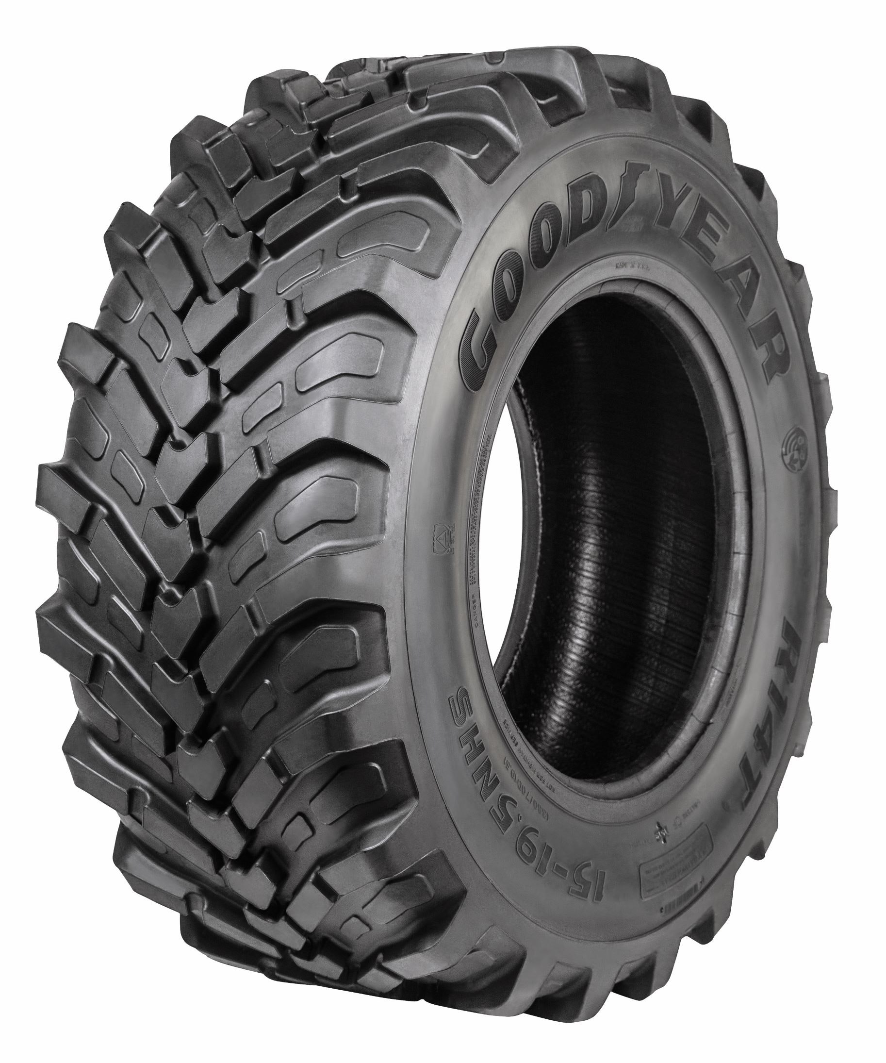

My B rad R4. My L3302 has the R14. I love them. I have big hills and they can be sandy. Good traction and I don't use it a ton in winter but should be better.

And, R4s are rated for a higher load capacity than R14s. Is it important? - probably, not. However, R4 tires are stronger/tougher than R14s, and they should last longer.

I think you have that reversed.
I may have been mistaken about an R4 tire being 4 ply but from what I can find the R14 is a 6 ply tire
