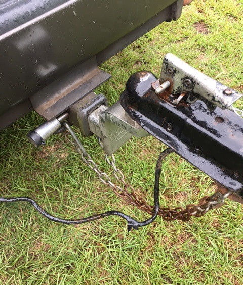

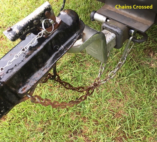

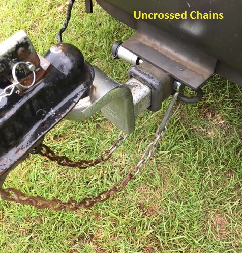

Having read through most of this thread and also having a small trailer of mine hooked up....I compared having the safety chains parallel and crossed. In MY case the loops for the safety chains on the receiver hitch are a whopping 3" apart. This is NOT enough to create a significant 'V' in the chain to which the trailer tongue is supposed to become 'cradled'.
There isn't one chance in Hell of that happening. In a purely unscientific way (admittedly anecdotal) I pulled the tongue back sharply and let it drop 6 times. And exactly SIX times it fell to one side of twisted portion of the chain. Then I did the same thing with the chain parallel and no surprise.... got the same results.
In all cases the safety chains kept the tongue off the ground (owing to their length)....but just barely.
It could be argued that chains connected to the vehicle farther apart might indeed create a 'V' capable of catching the trailer tongue. But not on any of my vehicles. So I am not arguing one way or the other for chain crossing, just saying you might want to look at YOUR set up and consider any laws requiring the same.

Exactly right. I am not in the least against good and provable ideas when it comes to safety. But some things required in the name 'safety' may not actually be achievable in the real world.
There isn't one chance in Hell of that happening. In a purely unscientific way (admittedly anecdotal) I pulled the tongue back sharply and let it drop 6 times. And exactly SIX times it fell to one side of twisted portion of the chain. Then I did the same thing with the chain parallel and no surprise got the same results.
View attachment 80664 View attachment 80665 View attachment 80666
