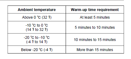

My concern with that chart is that it doesn't go far enough. Do I need 10 more minutes at -14 and 5 more at -20 F? Or is 30 minutes good for any temp below -4 F?
I live in Alaska and that is not necessary. You should not need more than 10 at the most and I am a warm up fanatic.

From my BX manual. Seems I am not far off the mark, for winter use....I might be a little bit agressive for the summer. Although I am sure it's correct for some situations and tractors, there's no way in HE-double-hockey-sticks I have the patience to wait >30minutes as someone else posted.

In my manual the sentence before this chart is for the hydraulic / HST oil and says to run the tractor at about 50% of the rated power for these times.
