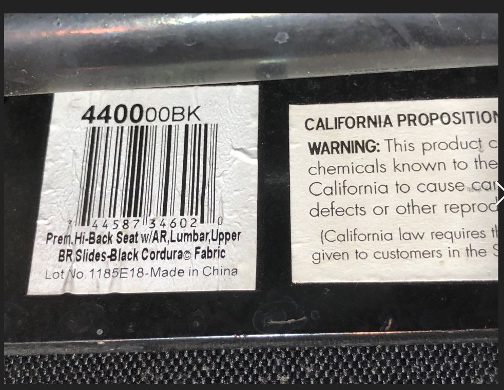

found the original order...you can use the P/N possibly?

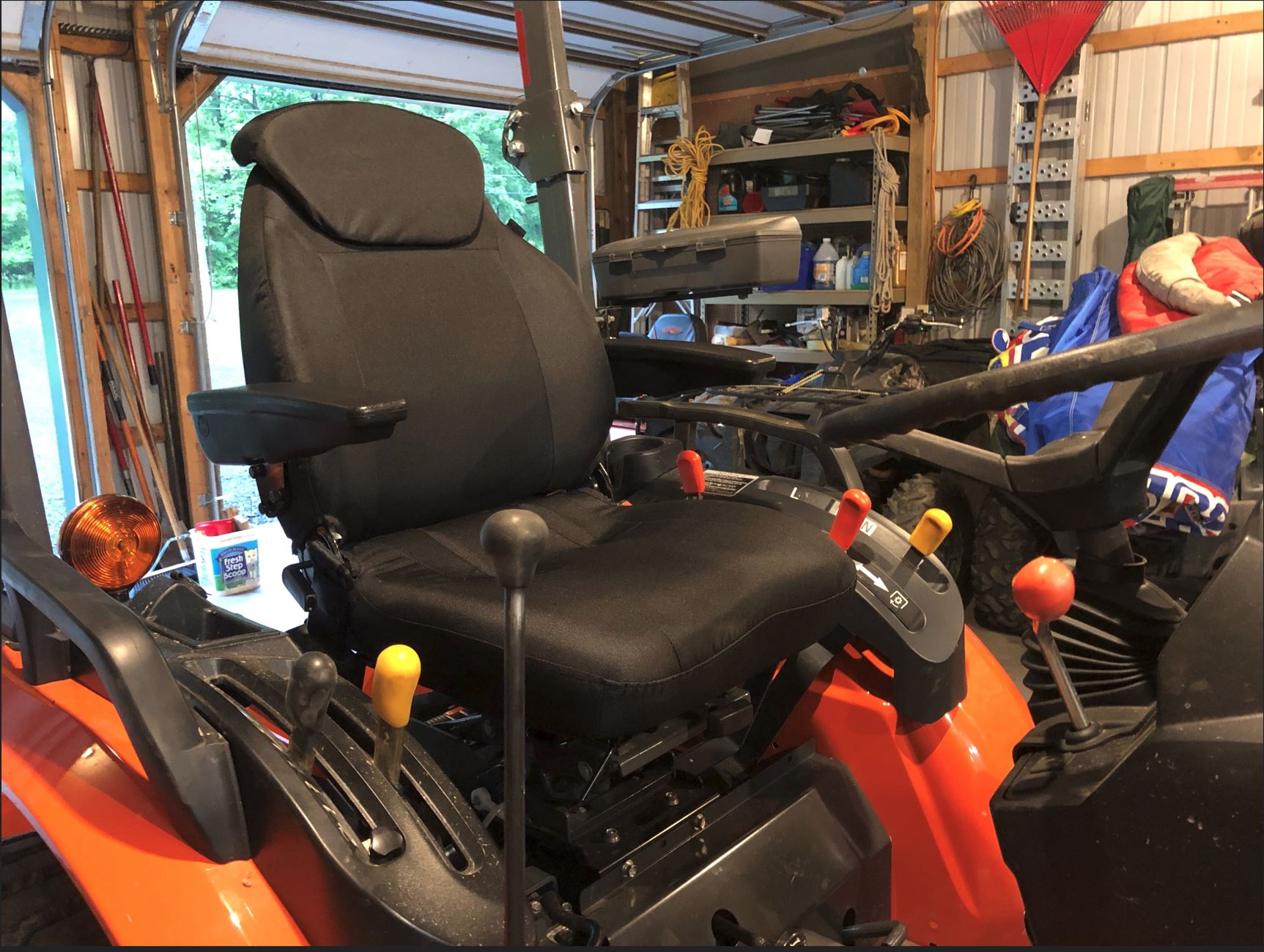

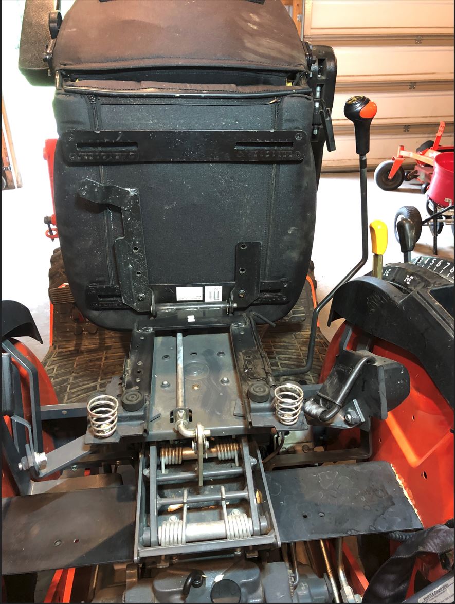

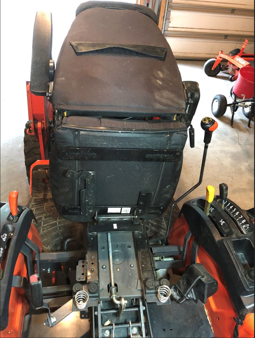

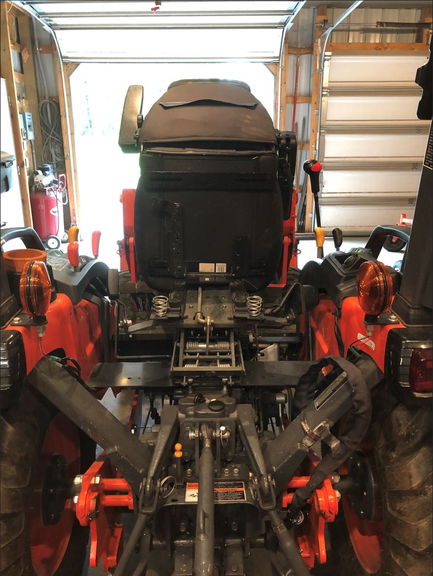

Matt,
Yes, it does. The seat has a removeable top section (like a head rest in a car) that I forget to pull off when I'm hoeing in a hurry (and kneeling on the seat facing backwards).
There's also a handy storage flap in the seat back.
Some pics posted below for you that you may find helpful? Last pic is only to show that I turned the hazards sideways to make more room for spinning the seat. One of these days I'll remount them to outside of the ROPS (maybe).

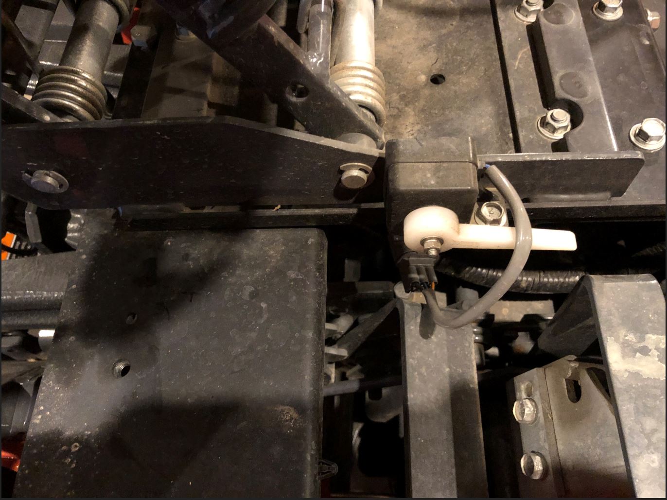

Not sure who you were asking...
Here's my safety switch fix (on B2650). The switch stays mounted under the flip and pivot hardware and does not need to be touched (but as you can see, I did...ever so slightly) ;)
