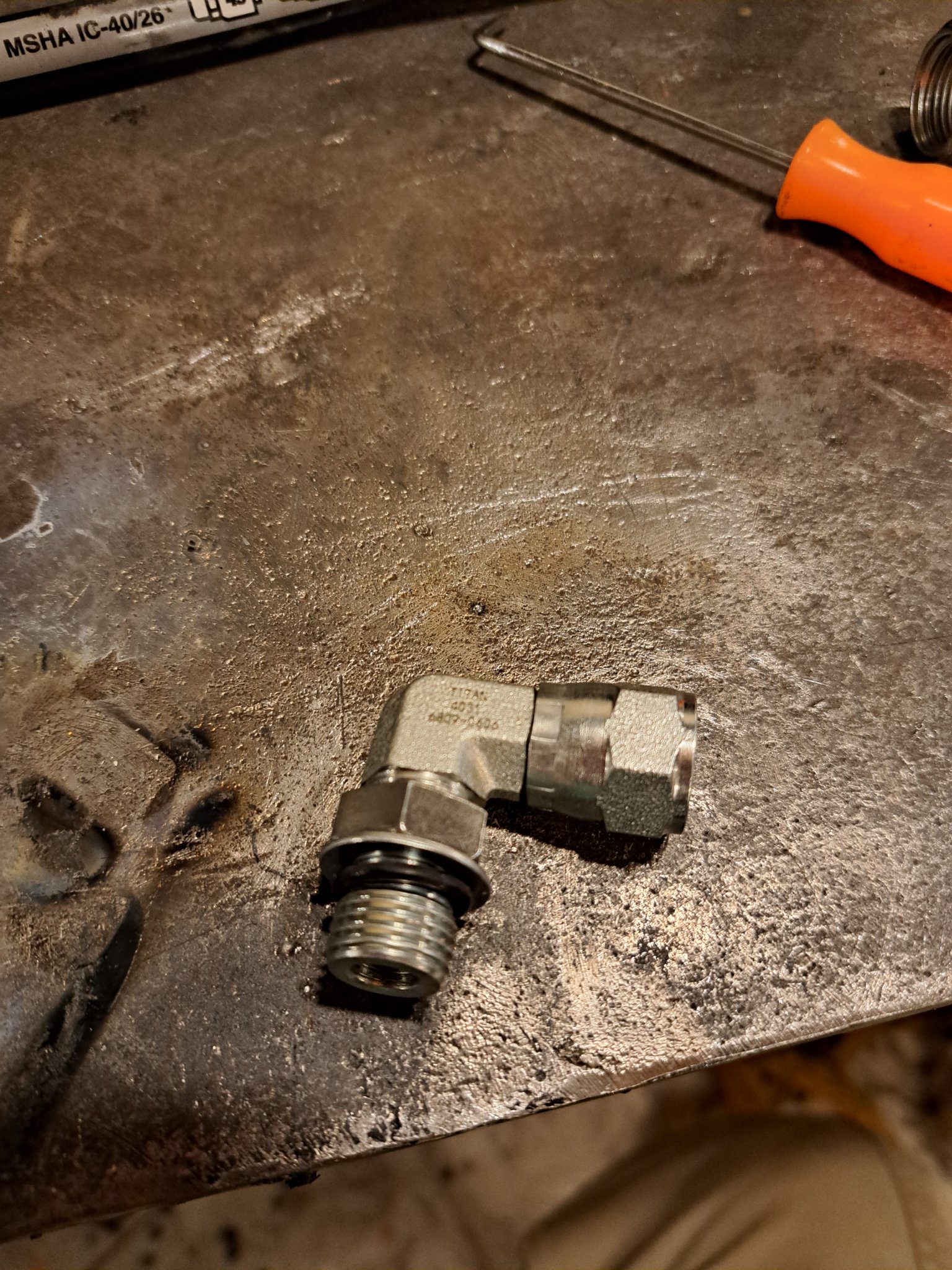

If you look at the fittings, I took the O-rings off so they wouldn't get damaged.
The problem here is that at the compression fittings, the tubes are so far into the fittings and since they are only inches long, there is absolutely no "flex" left. Pic 1
This leads to absolutely no way to undo the fittings and install the damn o-rings!!!!!
In the video I watched, the guy was doing a 2 or 3 foot long cylinder so he could "flex" his tube while turning the 90 degree fitting at the same time to get the tube in, in order to use the compression fittings.
He puts the tube in at about the 10:30 mark if your interested.
https://www.youtube.com/watch?v=g6NqbsbynJo
However in my case it lead to this "removal technique".......cutting the damn tube.

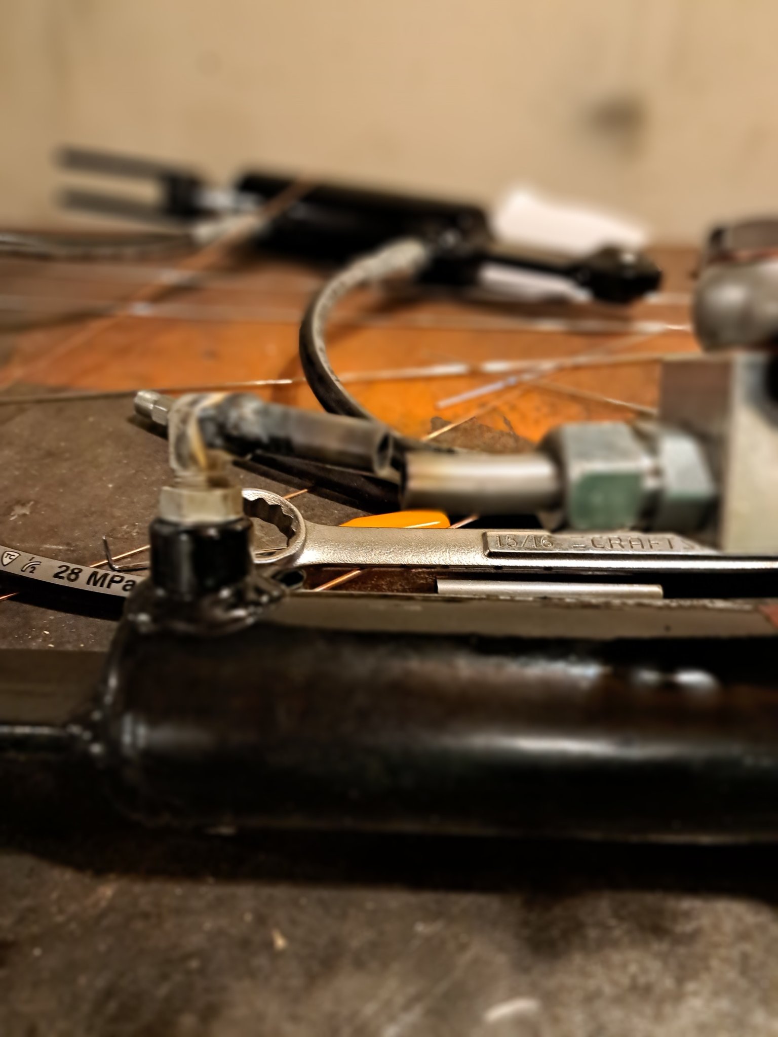

Lets do the little cylinder.....
The little one is not nearly as interesting though, cause it kicked me in the balls fairly quickly.
Since the CV was too long to fit in between the ports, I figure some "tactical geometric placement" is in order.
I'll just angle it.....
And since I just learned that I can't rotate anything, My hasty plan is too weld it with the o-rings on, BUT Just spot weld it, letting cool between tacks.
So with my remaining hydraulic fittings, I come up with a plan to angle it and "Quickly tack weld", letting the fittings cool between welds to protect the "innards"
So about 2 seconds in the first weld, ......POP!
Now I'm screwed, and I know it. Something didn't like the heat too much in the DPOCV.

Does anyone know if my cylinder ports will accept Banjo fittings?
Here's reminder pic of the original fitting style.

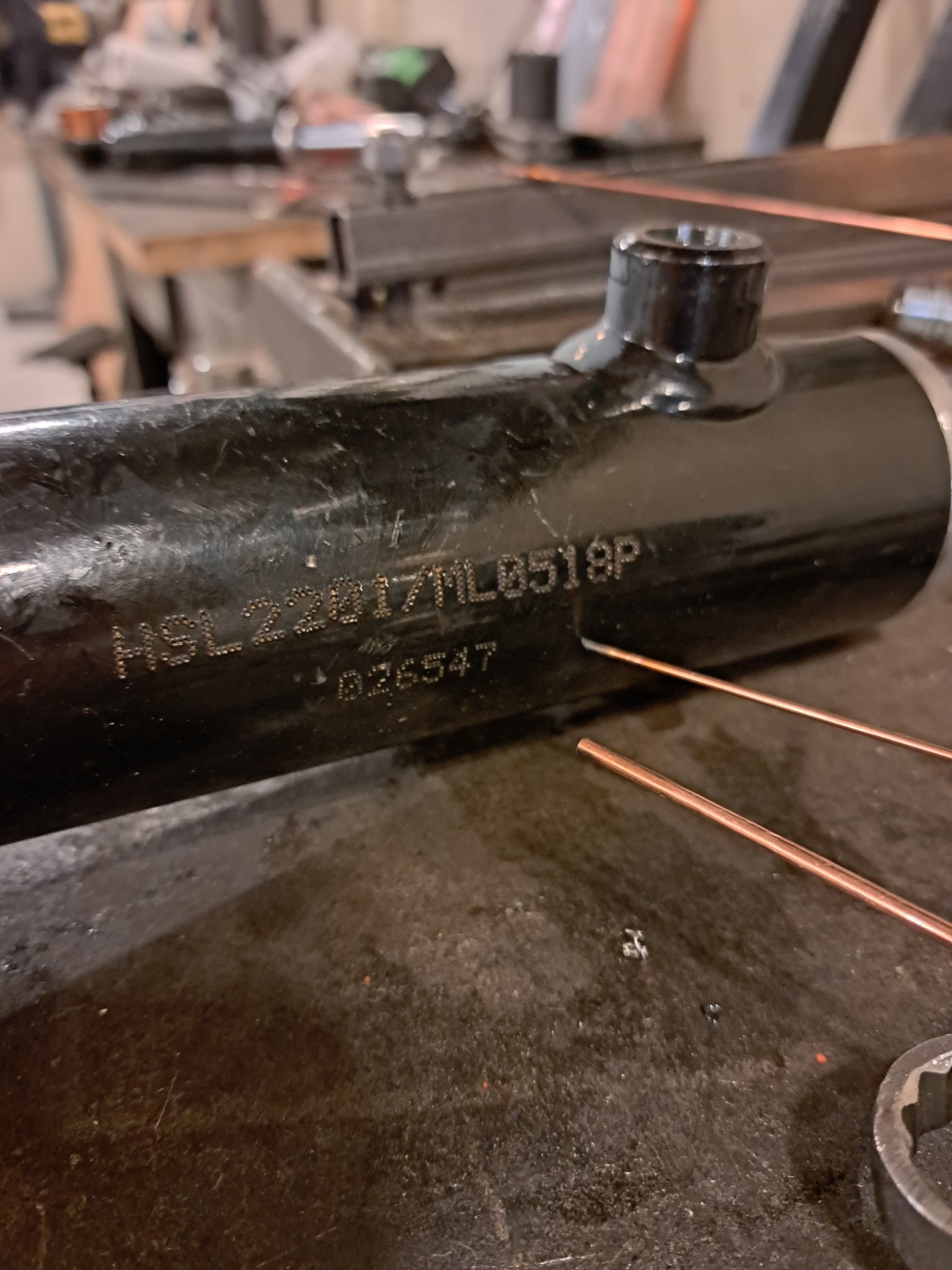

Here is a crappy picture of the port without the fitting. I can get a better one tomorrow if needed.

The ports are SAE o-ring ports and you can use a banjo fitting with crush washers in place of an oring fitting. You need to know the port size - I am guessing SAE-6 which is 9/16-18 UNF thread. Here is the bolt.
If you can't find a 9/16 banjo you can use it with a 14mm banjo to JIC adapter.
Compression fittings and steel tube to make up the proper over all length. These are handier than a shirt pocket for things like this. Pair them with steel tube cut to length and any male JIC adapter for a quick easy flareless makeup, They were pioneered by Aeroquip as VersilFlare fittings and I have attached the assembly instructions.

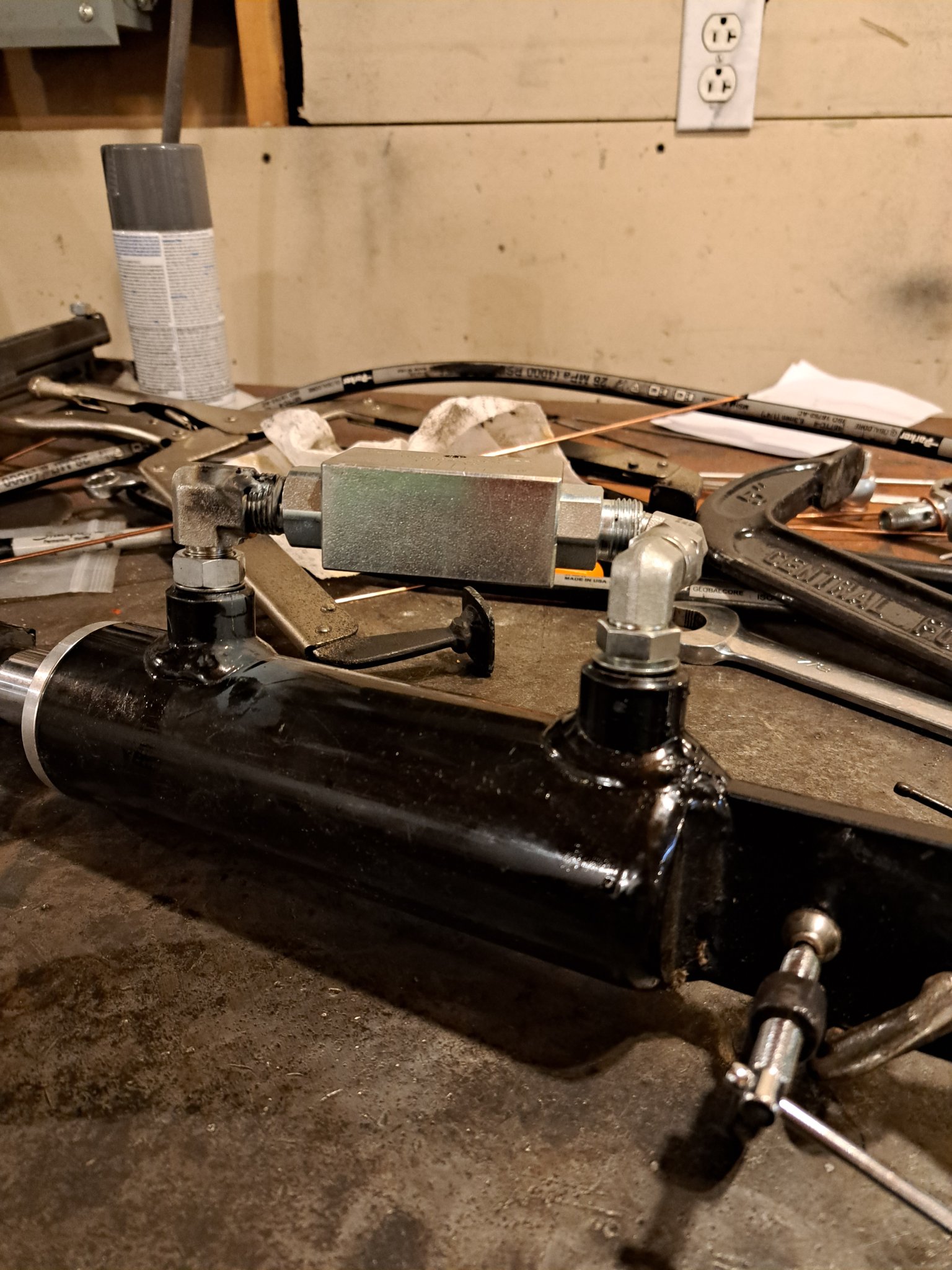

Ok, I've decided to tackle these one cylinder at a time.
I'm gonna order the parts for the top the link from the links that Dan provided for the top cylinder, then tackle the more problematic side cylinder.
The space between the ports on the side cylinder is only about 4 1/2 inch's so I'm having a difficult time finding one that will fit.
This one is about as close as I get and even then I will have to "offset" it somehow, I think.

One quick look but I think that valve is designed to bolt to a flange not hoses. Better double check the technical docs
I just got back from errands and had a longer look. My initial thoughtscare correct - that valve is meant for surface mounting which provokes an interesting thought. It would be very easy to make an aluminum subplate with bottom side ports to bolt to your cylinder with banjo bolts and top side ports to match the valve.....

You can use the valve you have.
You put it at an angle to the cylinder.
So 90's off the ports the 90 back to the pivot valve.

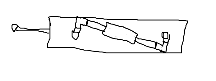

Here's a quick sketch of the subplate idea. Hopefully it does not remind anyone of Sponge Bob
