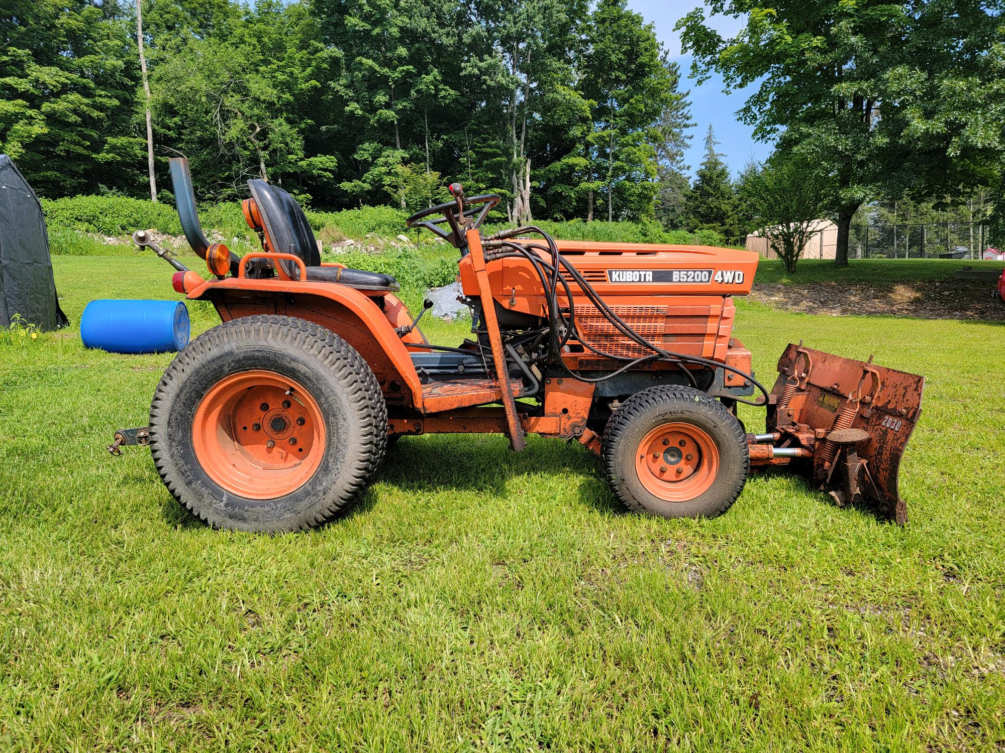

Fast forwarding another year! I still have the original Pillow Dia's on front and back. I feel pretty committed to buying the Kenda K513 (Front) and K505(Rear). Issues is to find the 20.5x8-10 in stock. I call places and they laugh at me for thinking they have stock. I saw that they make the K513 in a 20.0x8.00-10.00. I understand the tire is about 0.5" smaller and about ~0.5" wider. Does that a huge difference in control and maneuverability?
