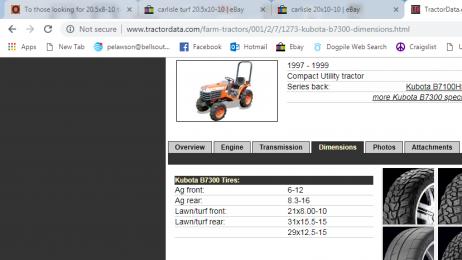

My B7300 has 21x8.00-10's on the front. I have read and read. Some state that the 20.5x8.00-10's will work and some state that the 205/65-10's have replaced the 20.5's. I like the looks of the Carlise tires Torch put on his because they would match the tread I have on the rear of mine. I guess I have a cross between turf and ag tires on the rear of mine now. The rear tires are probably about 60%. Can you guys give me piece of mind on what I can install? Thanks

From what I can tell, the OEM tire rolling circumference was 61". The allowable variance I've seen posted elsewhere was 2%, with a range of 59.75" to 62.25".
I measured the Carlisle All Trail 2 rolling circumference to be 60.25" @ 22psi, 50% filled with WW fluid, installed on my B7100, with FEL and counterweight. My rear tires are the OEM size, so the AT2 is suitable for my tractor.
You didn't mention brand or size, but it sounds like your tractor has aftermarket rear tires. I found a reference that the B7300 inter axle ratio is 1.475.
So what I would suggest is to measure the actual rolling circumference of your installed rear tires then divide by 1.475 to see which front tire has the closest rolling circumference to that value.
Measuring the rolling circumference is easy: mark the tire and ground where they touch. Roll the tractor forward until the tire mark touches again and make another mark on the ground. Measure between the two marks on the ground. (For greater accuracy, do several revolutions and divide the distance by the number of revolutions.)

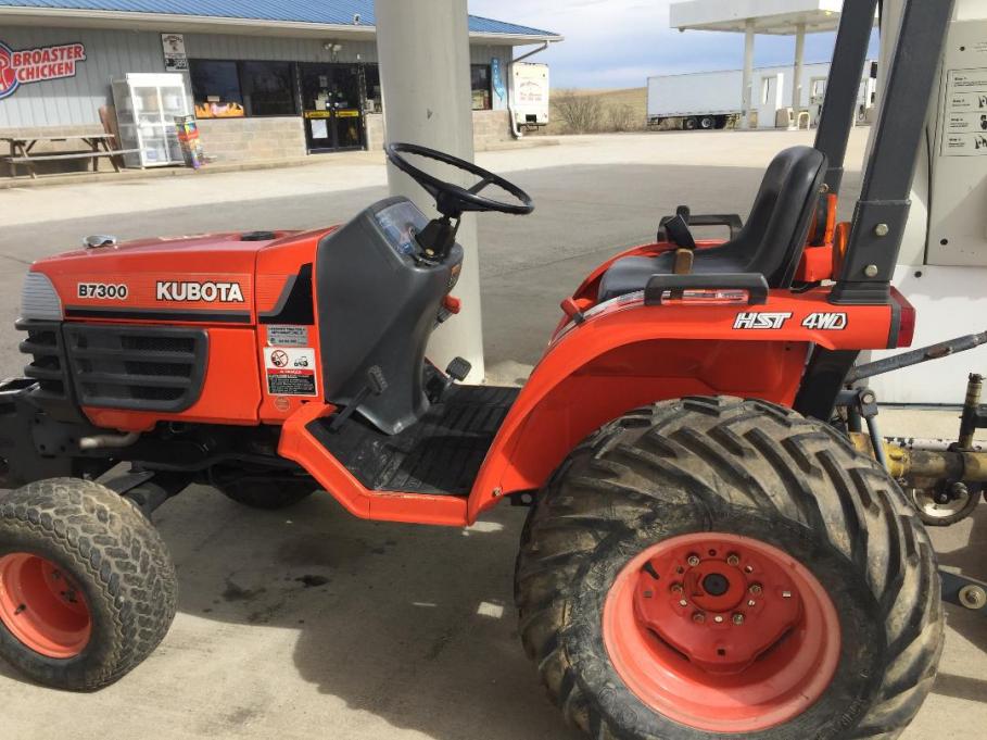

TractorData.com shows that my factory tire is the 21x8.00-10 size that is on the front of mine. Here is what the rear tire looks like on mine. I have seen several Kubota's with this tire on them. Don't know if they were factory or not. 7300.jpg

So (according to tractordata.com) agricultural style tires were available, but on a 16" rim. Two different turf tire sizes are shown, both on 15" rims. Possibly one of those sizes was for 2wd models, because the RC does not matter unless the front wheels are powered.
You have 15" rims, so I would guess your tractor originally had turf tires on the rear. You have an ag style (albeit fairly shallow) tread on the rear. Therefore your tractor seems to have aftermarket rear tires that may or may not have the same RC as the OEM turf tires, so you need to check.
(BTW: The rear tires shown in this thread have a similarly shallow ag style tread as yours. That same thread introduces the Kenda K378 as another front tire option -- 62" RC, but with an ag style tread for the front)
Once you know your rear RC, here is the formula provided by Kubota for calculating the allowable range for the front RC. Basically the range of:
(rear RC / 1.475) x 1.03 < front RC > (rear RC / 1.475) x 1.07
The target is in the middle of the range (ie: x 1.05) So for example: if your rear RC is, say, 88", you should ideally fit fronts with an RC of about 62.5" but anything between 61.5" and 63.8" is acceptable.
BUT, if your rear RC was 85", then your acceptable front RC range becomes 59.3" to 61.7".
In the first example, the AT2 (60.25") would be undersized for your rears and you should use the Kenda K513 (62.6") or the Kenda K378 (62"). In the second example, you should use the AT2, although that K378 is darn close.
All that said, the RC is dependent upon tire pressure and load, so you can cheat by adjusting the tire pressure a bit if you have to. (That's probably why Kenda told K.P. the K513 spec is +/-1.22"). My measurement of the AT2 RC was taken with a FEL installed, but unloaded. It's probably a bit bigger when not supporting the weight of a FEL and a bit smaller when carrying a full bucket of dirt.
Finally: none of this matters when you are in 2wd. My personal belief is that any one of them will work if you only use 4wd as needed in loose material and always use 2wd on firm ground or pavement. But that's just my 2¢.
