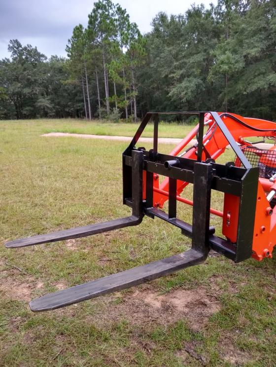

I bought these 36" Titan brand forks last month. They weigh 300lbs and are built pretty stout. Cost $454 that included shipping, they arrived 7 days later. Noticed they increased the price to $504 recently.
Railroad cross ties weigh about 200lbs each and the 2501 lifted everything with no problem.

Hey there Inthepines do I see a mod to your front grill guard? Looks like some sort of mesh wire covering. Could you elaborate as to why and what it is?
Thanks
Thanks
This my temporary solution until I decide exactly what type of welded guard to have fabricated. Only owned the tractor about a month.
With less than $20 in material (galv. 4 ga. hardware cloth 1" square wire x2 layers, 1/2" x 1" wire in between, paint, and zip ties).
It really works well for what it is. Just a quick fix until later.

Pretty cool for a temporary fix. This may help out when bush hogging. Are you thinking about installing lights on the ROPS if the wire distorts the tractor headlights? Thanks for the pics and info.
