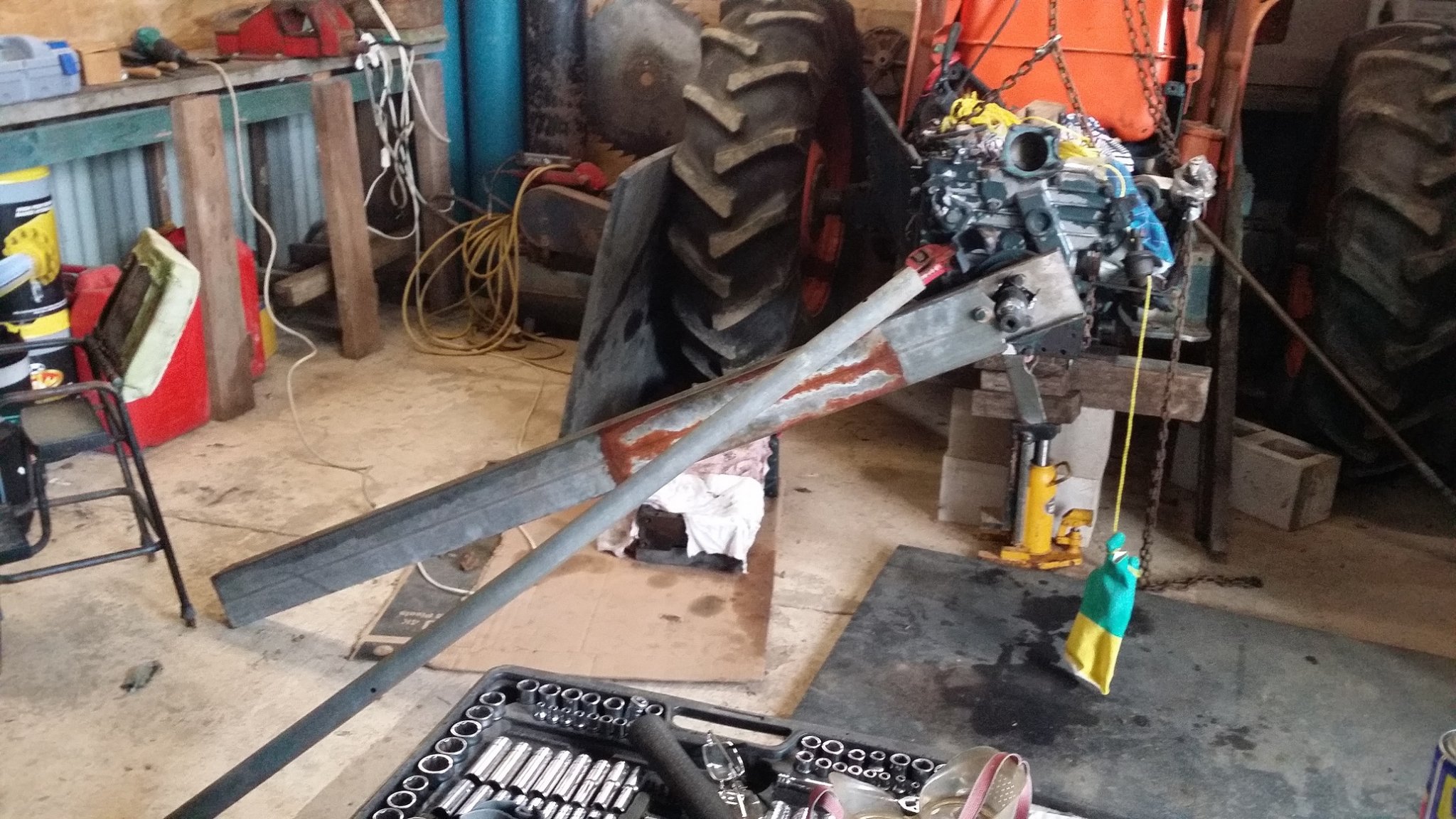

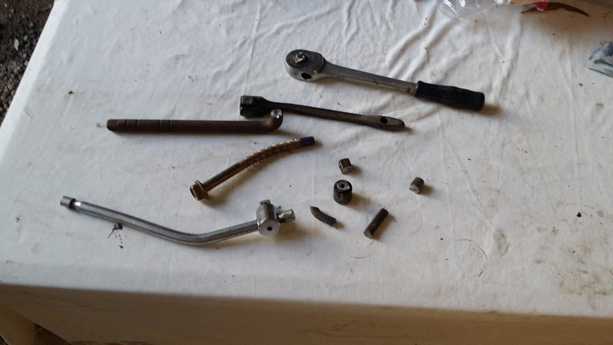

To Clear this thread. Thanks for the starter idea but I think this was too tight even for that. Sheared half inch drives, some hardened steel until I didn't want to ruin any more tools. Before I fixed the pulley solid it was still moving tractor even in high gear with handbrake on and chain and rubber grip around the pulley. So tight. Black socket is a hardened beauty but only 1/2 inch drive, so it kept snapping bars. 3/4 drive would have worked which I didn't have. Grind the socket because the pipe wrench would not grip. Six foot breaker bar and metal boxing bolted to pulley so it could not turn. Some emery paper on pipe wrench also. I didnt think it would work but it did. " Dont try this at home" brace yourself goggles on, lots of BF&i
P.S. Forgot to add this is a right hand thread if anyone wants to know

Quite impressed it was on that tight. You would have thought the threads, or nut would have given up at that amount of torque. Did it have locking compound on the threads? As far as breaking the 1/2 drives. I break them all the time. Too often for my taste and that is with snap on/craftsman. I wouldnt make it without a good tool warranty.

It did have some pink looking compound on the washer but it wasn't rock hard. The washer claw was not on the washer when I first looked at it. I think someone had sheared it putting it on. I could see the missing piece when the bolt was free. Possibly someone had sheared it putting it on or put some type of locktite on the washer and then did it up as tight as they could. Will get a new washer with my order. I found a supplier here in Australia thanks Kubotafreak. They are a bit dearer than the prices in the states but with freight and all the messing around it will be easier to get the parts here. Thank you so much for your help appreciated. About to post another thread, comment if you have advice. Cheers.
P.S. Greensville Jay, the tractor couldn't lift with the length of support on the boxed steel but I was aware I could break my back, ha ha. Chinese pipe wrench, I was ready for that to break also. It didn't crack the bolt it just slowly freed up, some surface rust on the thread but was not causing the binding it was the washer. threads are fine and screw straight in after a WD spray. Good old Chinese pipe wrench. They do make some good tools.
