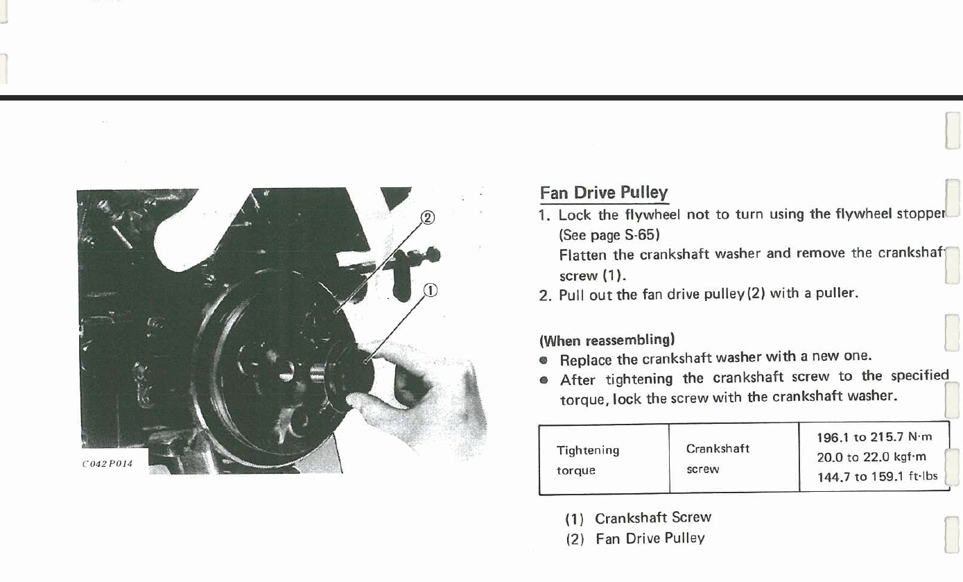

Its a big azz fastener tightened to 115 lb-ft (???) and possibly with some corrosion under the head. Get an impact wrench and put the juice to it. You are not going to twist it off. Just the opposite. With a fastener that size your gun may not be up to the task.

36mm socket with 16mm thread 159 foot pounds
Let me give you some context. I make special tools for Little British Cars. The rear axle hub on a TR4 is a taper fit and requires a special puller. My pusher screw is 3/4" and it rourinely stalls my 350 lb-ft Ingersol impact wrench. I have had a 3' cheater bar on the end of a 30" 3/4" breaker bar on that screw and still not wrung it off. However I did break my ankle when the taper did finally part and I was not prepared for it and took a nasty fall.
You are dealing with a hefty stubborn fastener. BF&I is a proven solution. A 1/2" impact wrench may well come up short.

The engine spins clockwise, when viewed from crank pulley end. Left hand thread would make sense in terms of engineering, but maybe the tightening torque of 145-160 ft.lb and the tabbed washer is Kubota's way of making sure that a RH threaded bolt is secure in that application. No thread direction is mentioned in the WSM so I'd guess its RH thread.
