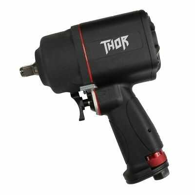

Thanks Dan, you are talking about an impact driver that you hit with a hammer aren't you and it turns as you hit it? That's what we call it in Australia. The other tool you might be talking about, here we call a rattle gun. That's what the tire shop guys use to put your car wheel nuts on?

I am talking about an impact wrench not an impact driver.

I don't have either tool but I just had a look and I can make a long steel plate that I can drill so the three pulley bolts will bolt it up then hole saw a hole through the center so I can get the socket on and breaker bar. If it still doesn't free and its still tight I will try a bit of heat on the bolt.
