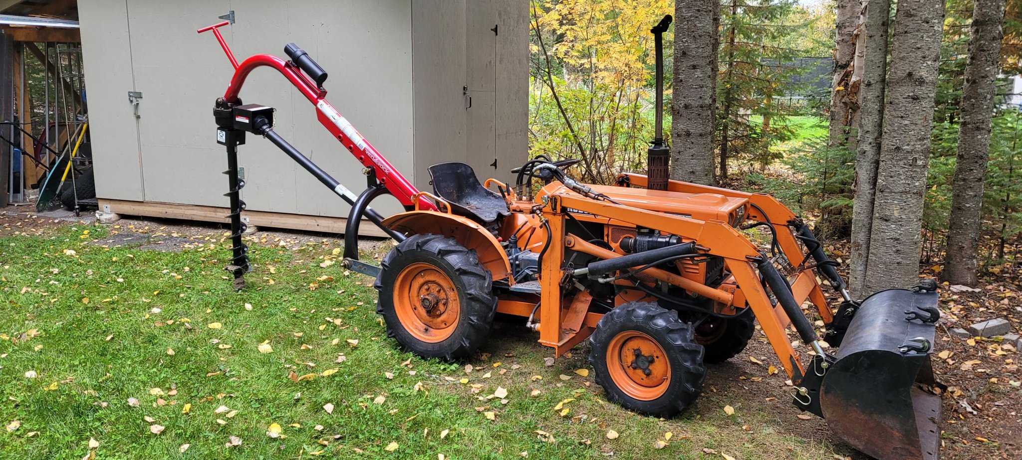

Ah, so this didn't work.

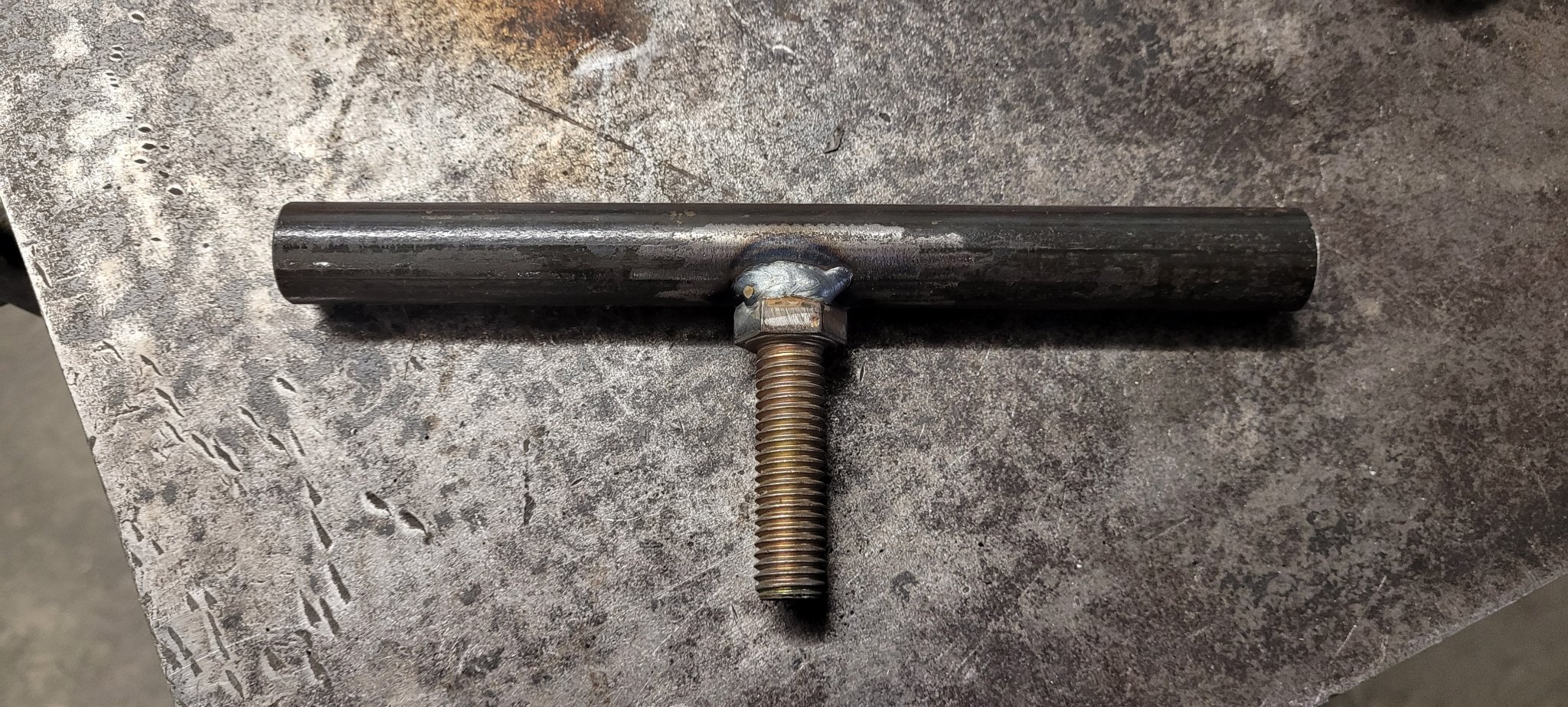

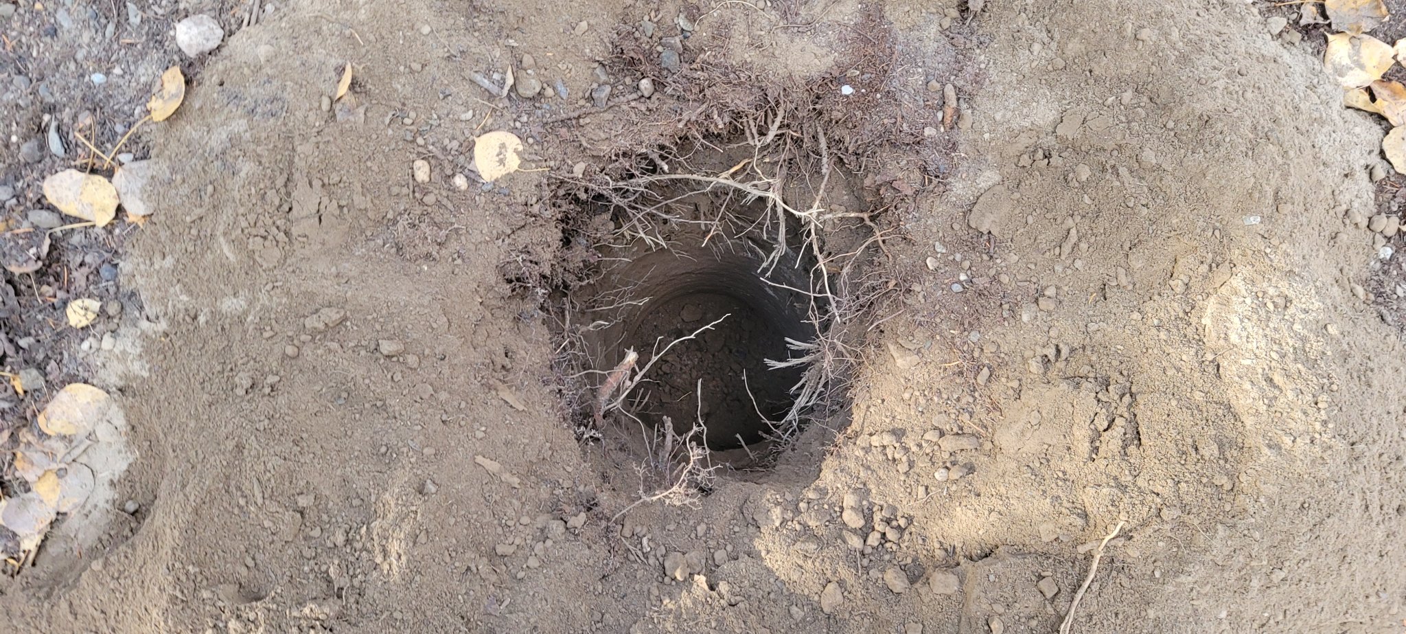

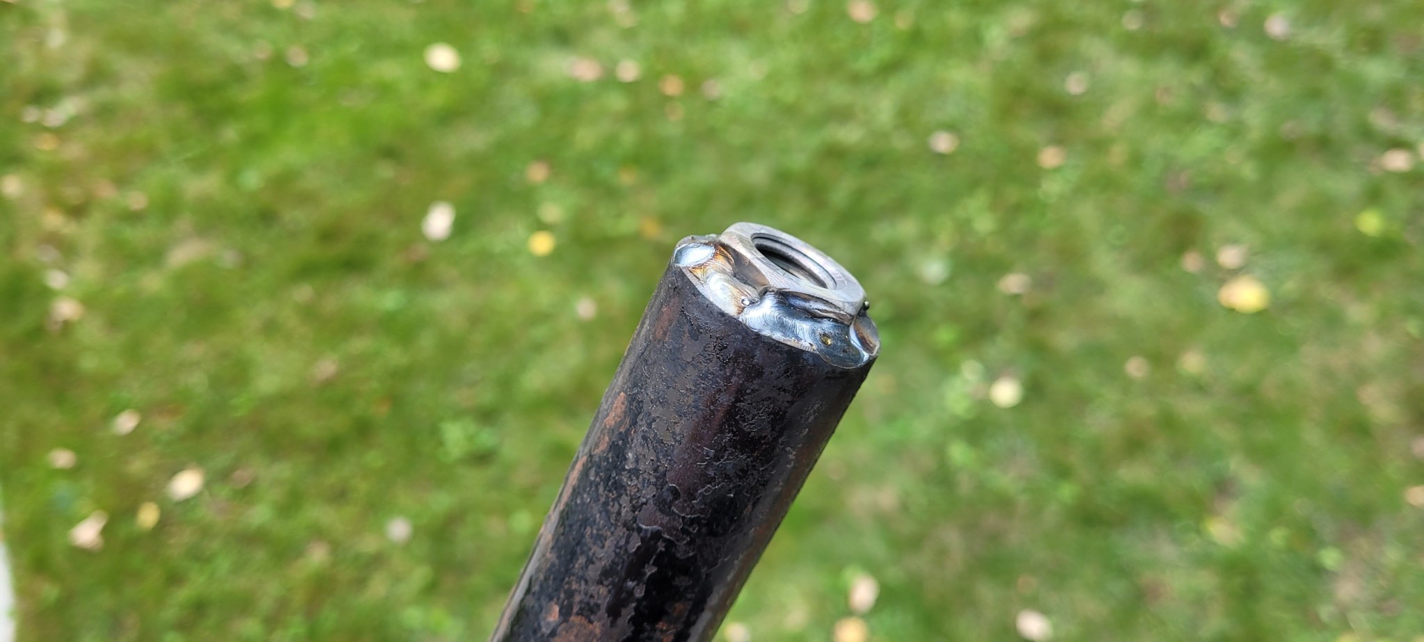

First hole, it didn't want to feed. I brilliantly figured it just needed a little more weight so I put my fabricobbler hat on and modded the thing up right stupid.
Basically just some 1" sch 80 that I welded on with a nut in the end and a T bolt to safety it. I threw a discarded brake drum on it and some old rotors.

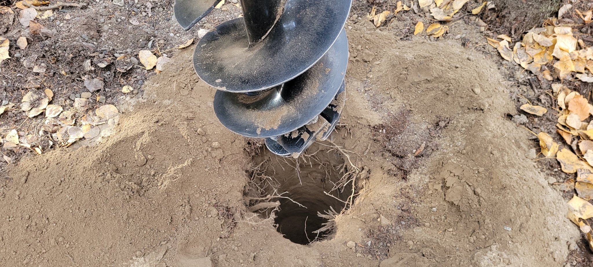

Turns out there was a massive root in that hole. Hmm. Next hole it dug like crazy. But, can't pull the auger back out. Ditch the weight. Can't pull it out. Jackall it out. Try again, sticks again. Jackall again. Make sure I only go one revolution this time, still can't lift it. Jackall again, half turn, stuck.

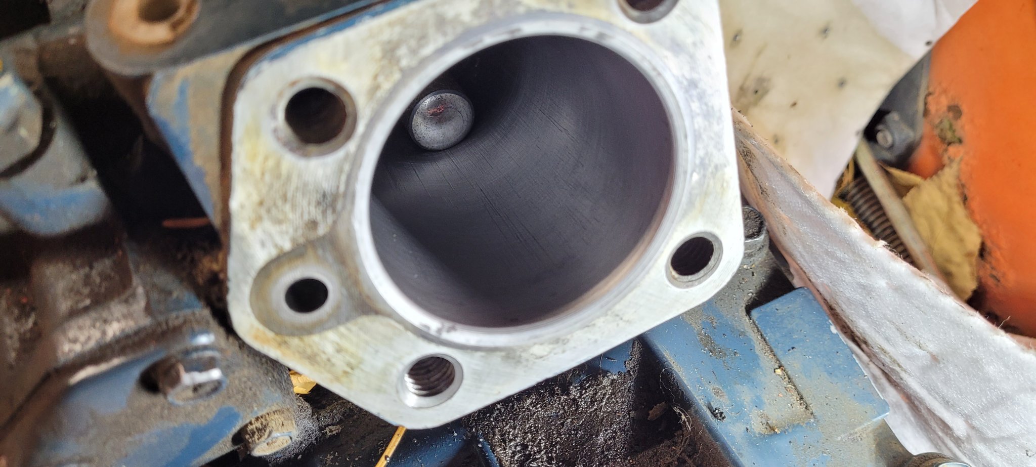

Ahh. I guess I should have known since the piston is bypassing some for the 3 point lift. Or I assume so, it drops on its own.
So, I'm going to do something else and order some seals for the 3 point and try again later.

Hmm. That's too bad.
Picture had me realize it's on a B7100.
Take your shoulder destroying hand held auger, and fab a mount for it to mount to your loader. To the bucket, or forks, etc. Bolt that sucker on. Start it's little motor and go to town. Drill some holes in your forks and clamp it on. Etc. It will be dangerous. Have everyone stand back.
Just a thought I was considering for myself in the future.
Return your 3 point PHD.
Or go really slow as others mentioned with your 3 point PHD.

The funny thing was I initially debated attaching the 2 stroke auger to the bucket or making a mount for it. I unfortunately do not have a fork attachment that fits this tractor, which is too bad as making fork compatible attachments is generally easiest. I decided not to pursue it as the auger was on its way to destruction, part of it had already come off on a previous hole, and I figured with my luck the Chinesium engine would seize immediately after I finished fabricating the needed parts. In retrospect it would have been smarter, maybe, as my ability to fabricate real versions of bad ideas is pretty decent. I can't exactly return the 3 point PHD, as I welded a mount onto it, or at least I can't ethically return it.
Regardless, I have to fix the lift piston for the 3 point anyway. So I will do that before I do anything else. I think.
Or maybe I should just buy a bigger tractor. Hmm.
Edit, the other issue with the 2 stroke auger is that the auger wasn't long enough without putting an extension on, which causes problems with actually evacuating the material from the hole. But either way, what's done is done, I now own a 3 point PHD, so either I make that work or do something else, the world is my oyster to accidentally crush with my own stupidity.

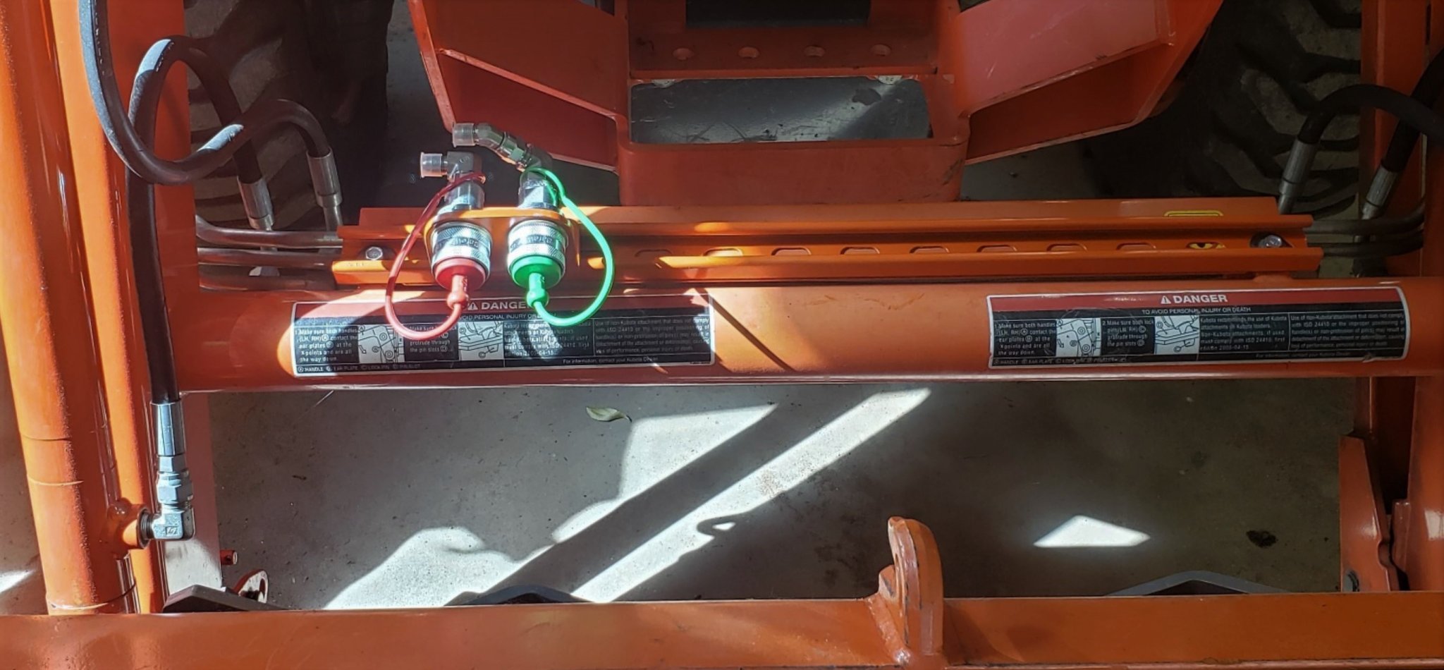

or you can use one of your rear remotes, if you have them
Soopitup
BX23S
Oct 25, 2018
369
164
New England
You know, I never thought of that. Thanks!
I have a backhoe so I could probably run it off those?
May get a little awkward but it's worth a shot.
I'll have to get custom hoses, right? Or is that something I can find off the shelf?
ctfjr
L3800HST
Dec 7, 2009
1,977
2,523
central ct

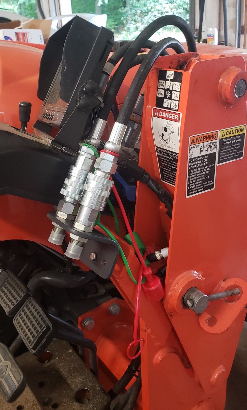

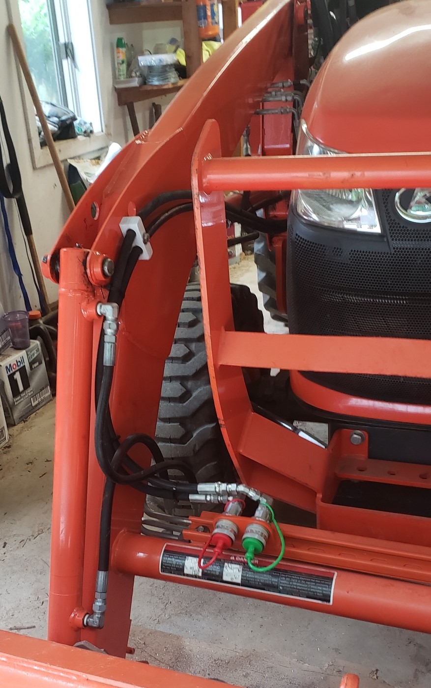

I have 3 rear remotes. I just ran a pair of hoses under the tractor to the fel. 1st mounted a piece of strut to serve as an anchor point for fittings.
Then
and a place to disconnect if I ever want to drop the fel
The valves are mounted on the right fender with the levers facing forward

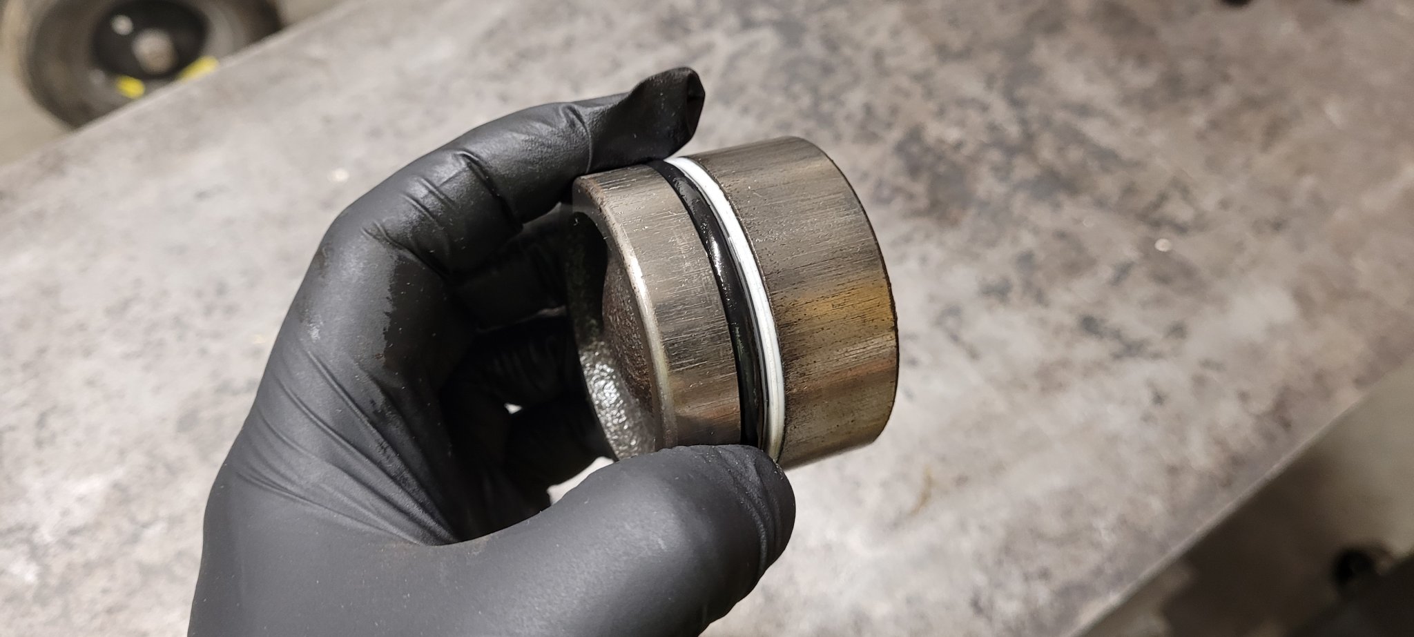

I put new seals in this thing and went back to augering holes.

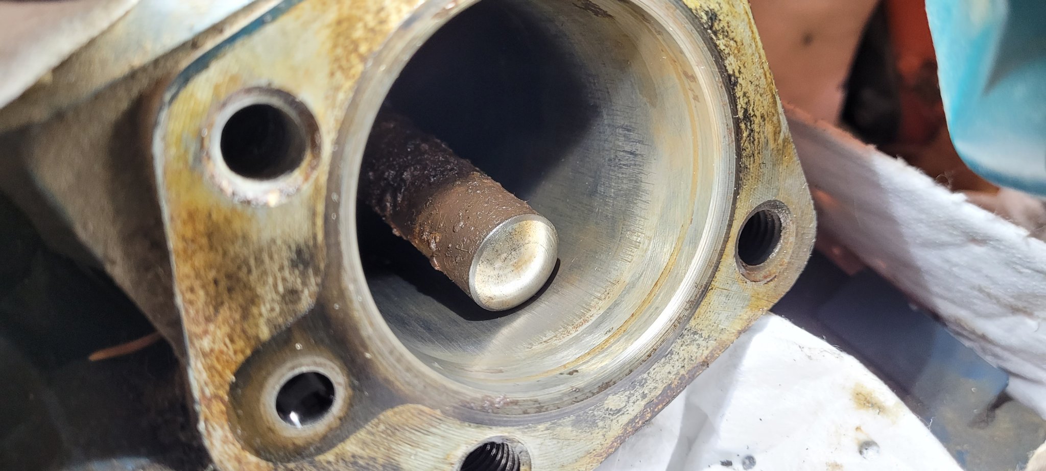

I did try to clean the bore up with some 400 grit and sandpaper, but ahh, it probably needs to be bored/sleeved/chromed or whatever is the appropriate repair to last. It didn't statically bypass with the basic hand cleanup and new o-ring and backup ring.
It did okay with the 6" auger to do post holes. It still didn't like to eject the material, and I realized the design of the auger is poor. You do need to run it fairly fast and go up and down a few times to help clean it out. Overall I was reasonably happy with how it did with the 6" and I think I could tweak (with and angle grinder and welder) the auger to be less stupid, and it probably would work pretty well. I finished up all the posts I have, and all I plan to do this year, then switched to the 9" because I needed to do some Sonotubes. It struggled.
I had to clean the holes out by hand partially after they were about a foot deep, and it got progressively worse at pulling the auger out as I went at it. After 6 of the 9" holes I noticed the 3 point was back to creeping down on its own. It did however go a lot better than digging them by hand, having done that a bunch in the past.
I don't think that the 3 point has the jam to work the 9" auger, it's just too heavy, plus having 20-50lbs of weight on it would have really helped and that was not even remotely possible. I may try sending the transmission top case out for repair, or even worse do it myself (I think I can fixture it in my mill, but ehhh) if I can find a suitable sleeve. I don't think it will matter though, it needs an external lift cylinder to help it out, and if I do that it might as well have power downfeed. There was no issues with the engine not having enough power though.
Bottom line, I firmly believe a B7100 can do this, it's just that you might not want to deal with it, and it might be pretty hard on the ol' girl.
