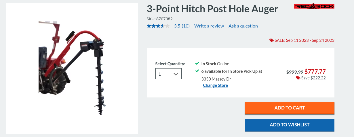

I'm putting in a fence and currently using a hand held auger with a 62cc 2-stroke. My shoulder has had it. It wasn't too bad until I hit glacial till, and then some stuff with fist sized rocks.
The local junk store has a 3 point post hole auger for 777 Canadian Copecs, which is probably about $600 US. A 6" auger is another 140 units of our plastic currency.
My quick questions for people who have used these things is, firstly will this thing auger through that stuff? I know about adding weight if needed, but I'm not sure if I will have any more luck with the rock versus what I'm already doing. Also it doesn't have a clutch on the PTO shaft, so will I break my orange baby when I do get into the rocks?

No real specs given on this. One star reviews are always reassuring. It has a better screw design on the tip of the auger than what I was using. I don't know if that's a reputable brand, but there's not much to one of these things.

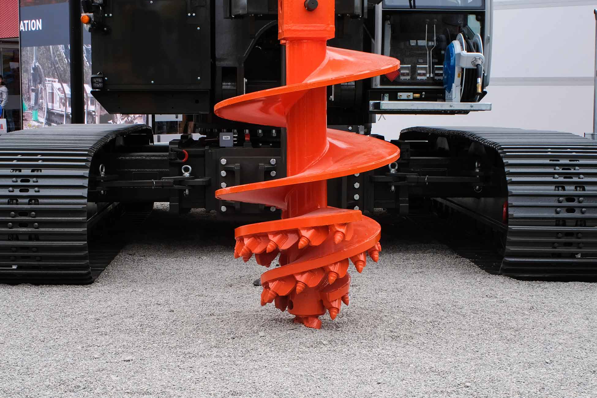

At least a few teeth like the big orange one posted above (not necessarily that many but at least a few) are preferable for rocky soil.
How much HP is required for a PHD? Well that depends on several things. Soil (yours is tougher than something like sand or loam), quantity of roots/size of roots, and size of bit being the primary factors. With about 17hp on the PTO you can probably run a 6” bit but your not going to run a 36” bit.

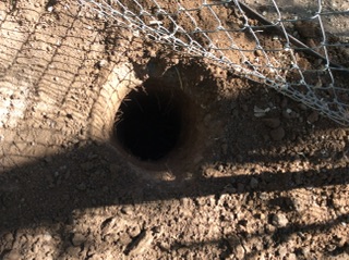

Hi 2drx4,
I have run a PHD with my B7100. No problem digging down, but go slow and lift up often. I’ve gotten the auger stuck a few times when it went down too far too fast.
My ground is hard clay, not glacial till. No rocks but some roots. IMG_0356.jpeg IMG_0357.jpeg IMG_0360.jpeg IMG_0361.jpeg IMG_0349.jpeg
