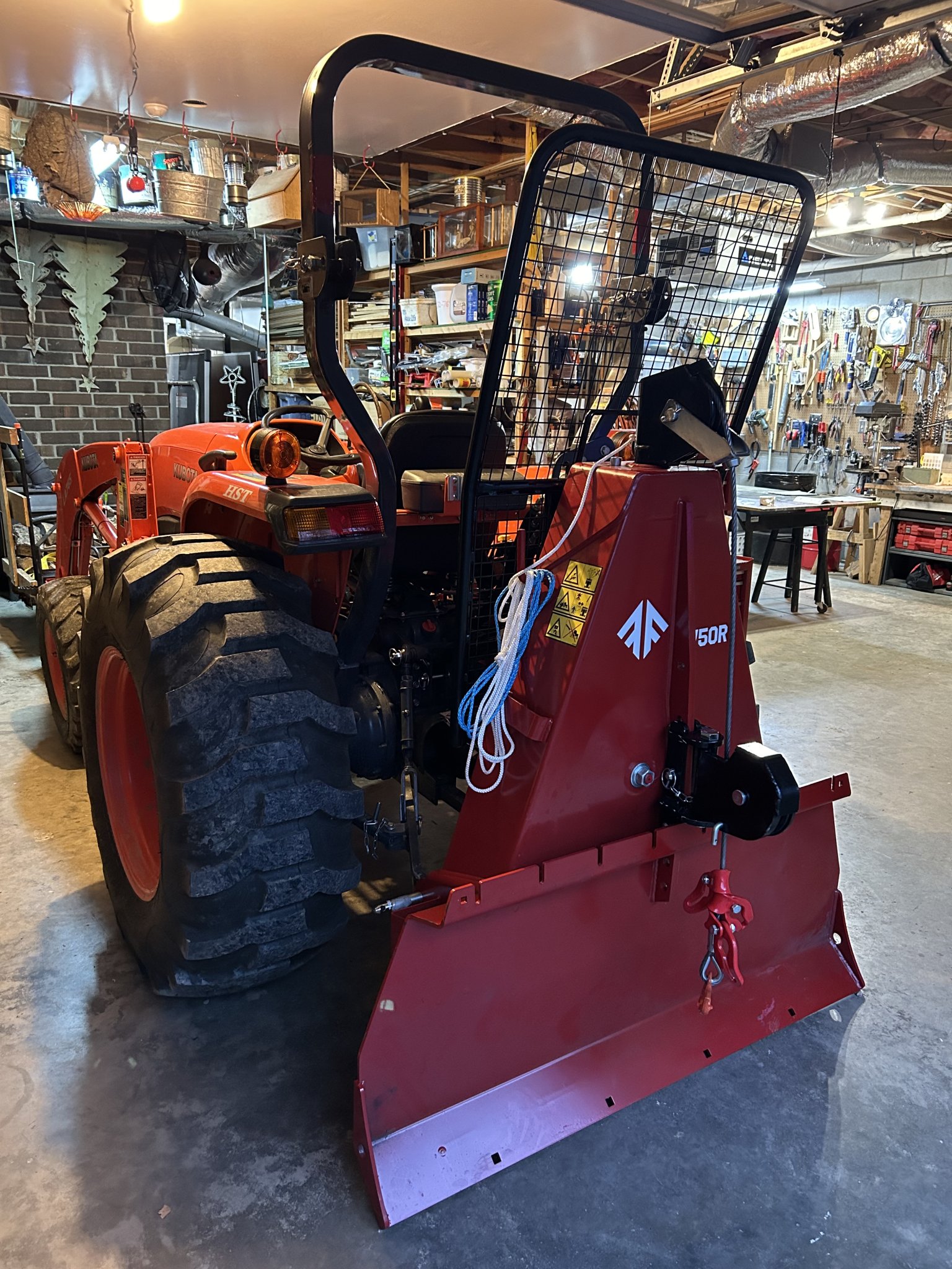

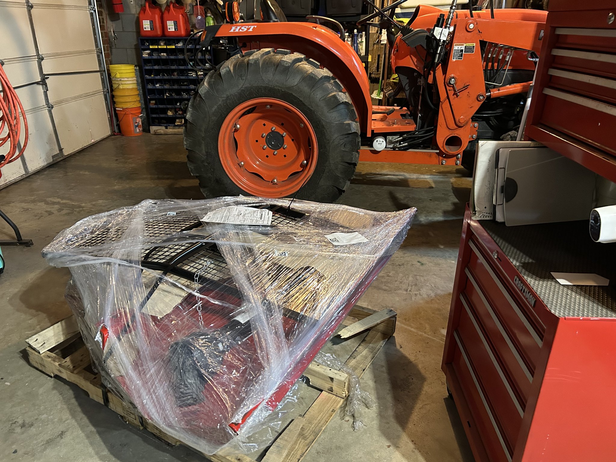

Wife and I went on a brief road trip today to pick up a Farmi W50R from the nearest XPO Logistics hub. Mike with Northeast Implement (https://northeastimplement.com/) was very helpful. Provided detailed dimensions on the 50R and 35R (50R was clearly a better fit). Provided a quote that was substantially less than the Wallenstein FX85.
Didn’t have time to do anything past getting it off my truck and into a shop bay. Supposed to rain the next several days so should be a good opportunity to get it set up and make some sort of storage dolly for it.

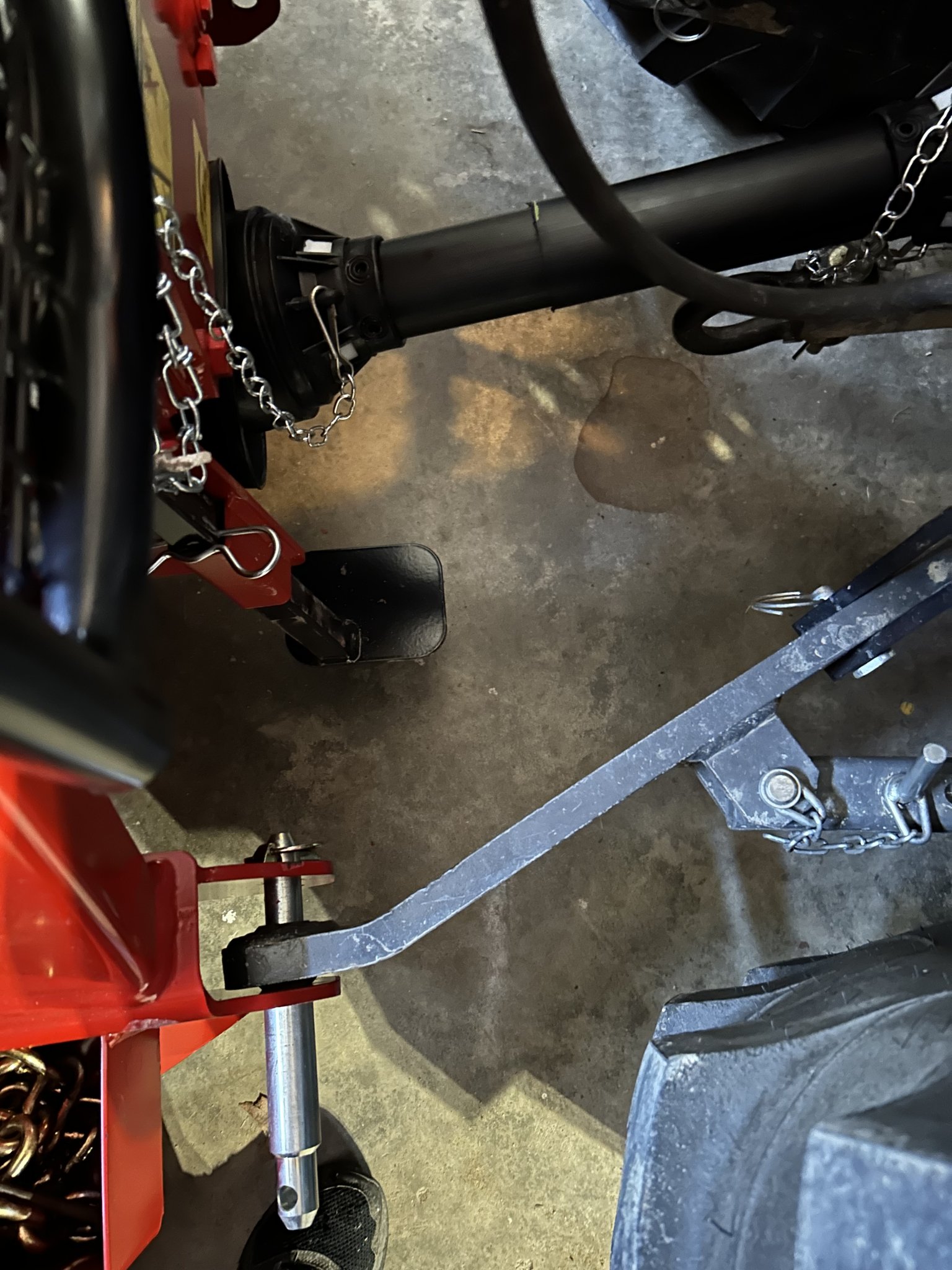

I have two questions:
1. In the pic of it behind your tractor in the shop, it sort of looks like the lower arms are not on the pins of the implement? Am I looking at that correctly? (Post 19). Are you link arms holding something inbound that not visible in pic? (Yes that’s more than 2 questions😂)
2. What are the square holes used for at the bottom edge of the rear blade potion of the implement?

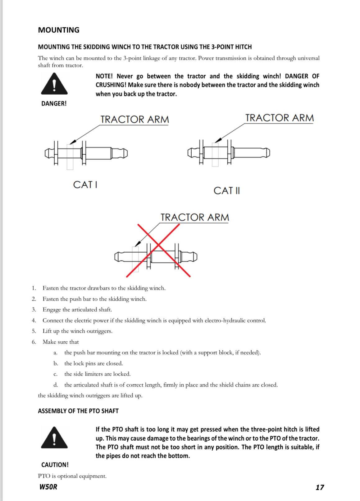

1. It’s hitched up by this Cat 1 or Cat 2 pin. (Maybe this is common but I’ve never seen anything quite like it.) The hole on the inside of the implement yoke is Cat 1. The hole on the outside is Cat 2. If you insert the pin the way I have it, the Cat 1 part is inserted into the lift arm. If you turn it around the other way, the fatter Cat 2 part that’s sticking out is inserted in the lift arm and the Cat 1 part is left hanging out.
Explanation from the manual:
2. I really don’t know unless they’re just to provide an option to bolt on a cutting edge in case of damage or wear.

As far as the pins I don’t know that it is uncommon….i have 4 different pin set ups across the implements I use on the MX. most use a shoulder pin, some add a sleeve also. The one on my brush cutter looks similar but I don’t have the long pin it in the pic there. I am not sure it’s the same set up you have but that seems pretty convenient or flexible what you have there. 👍
