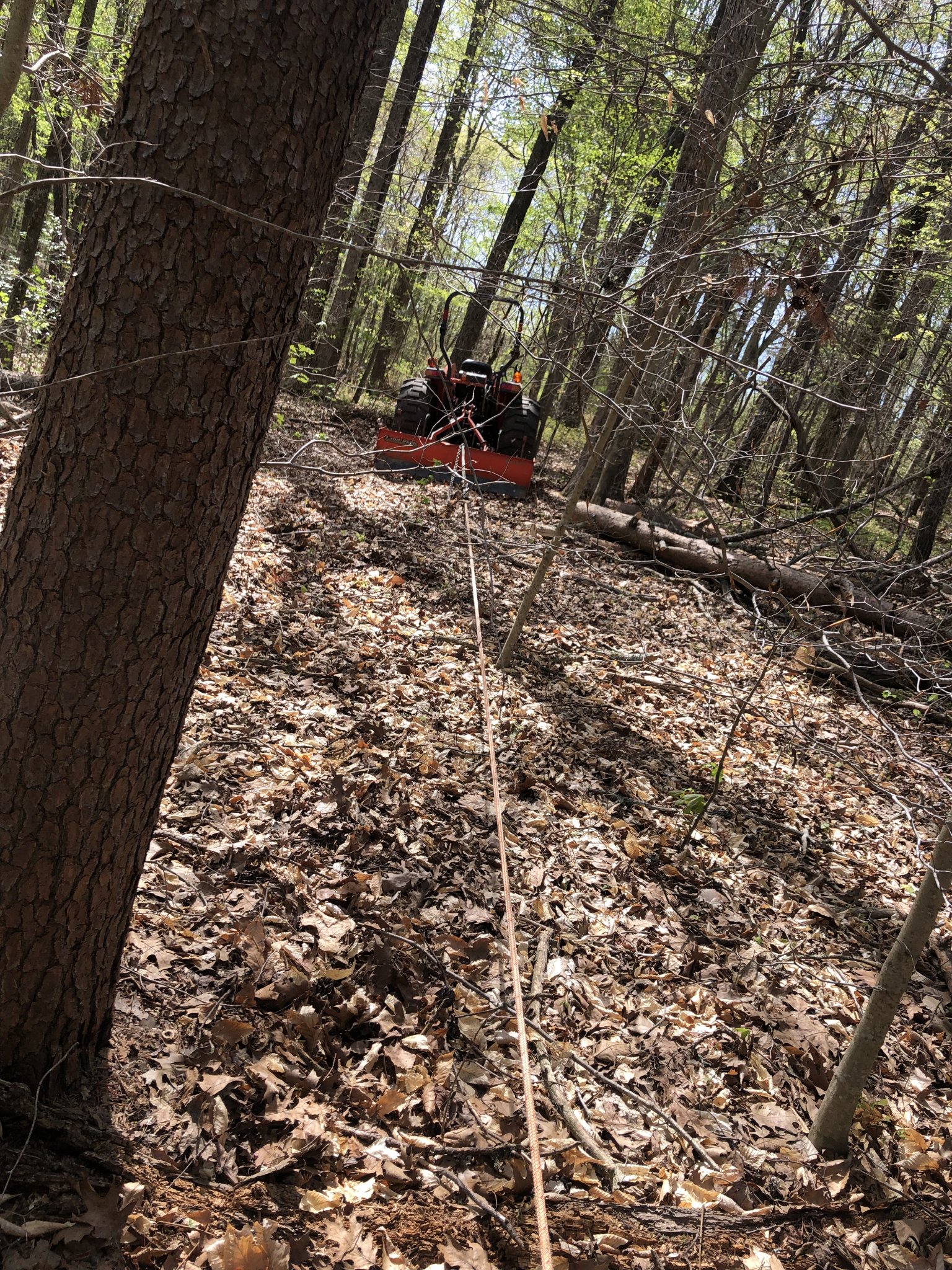

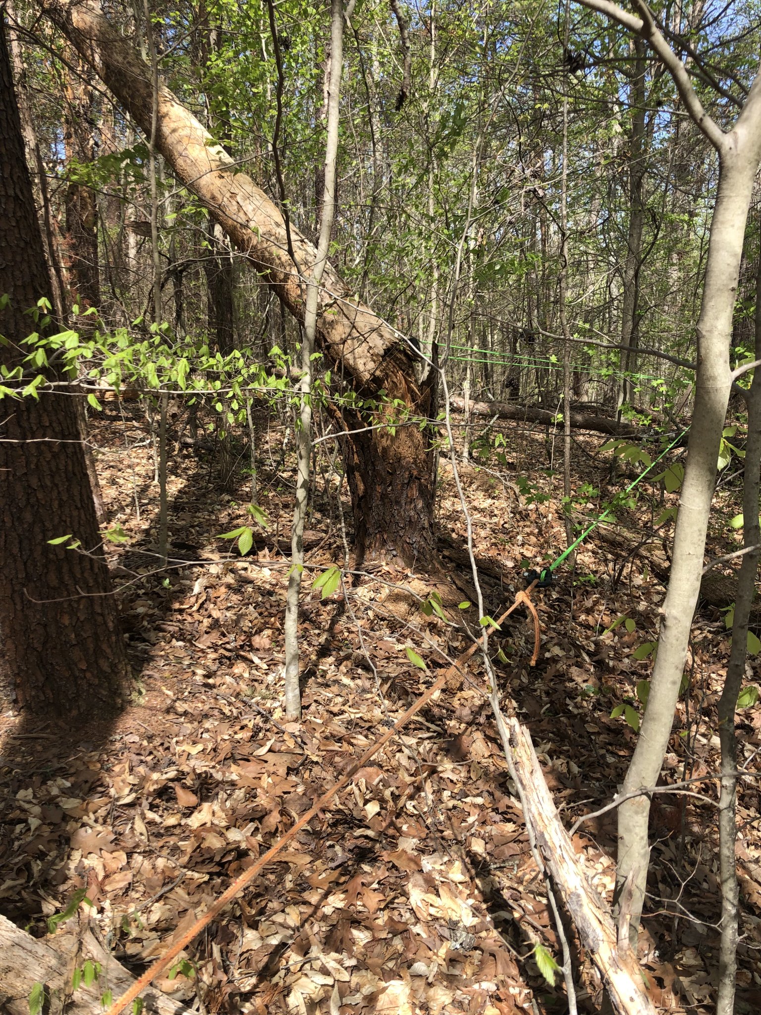

Example of one of the routine problems.

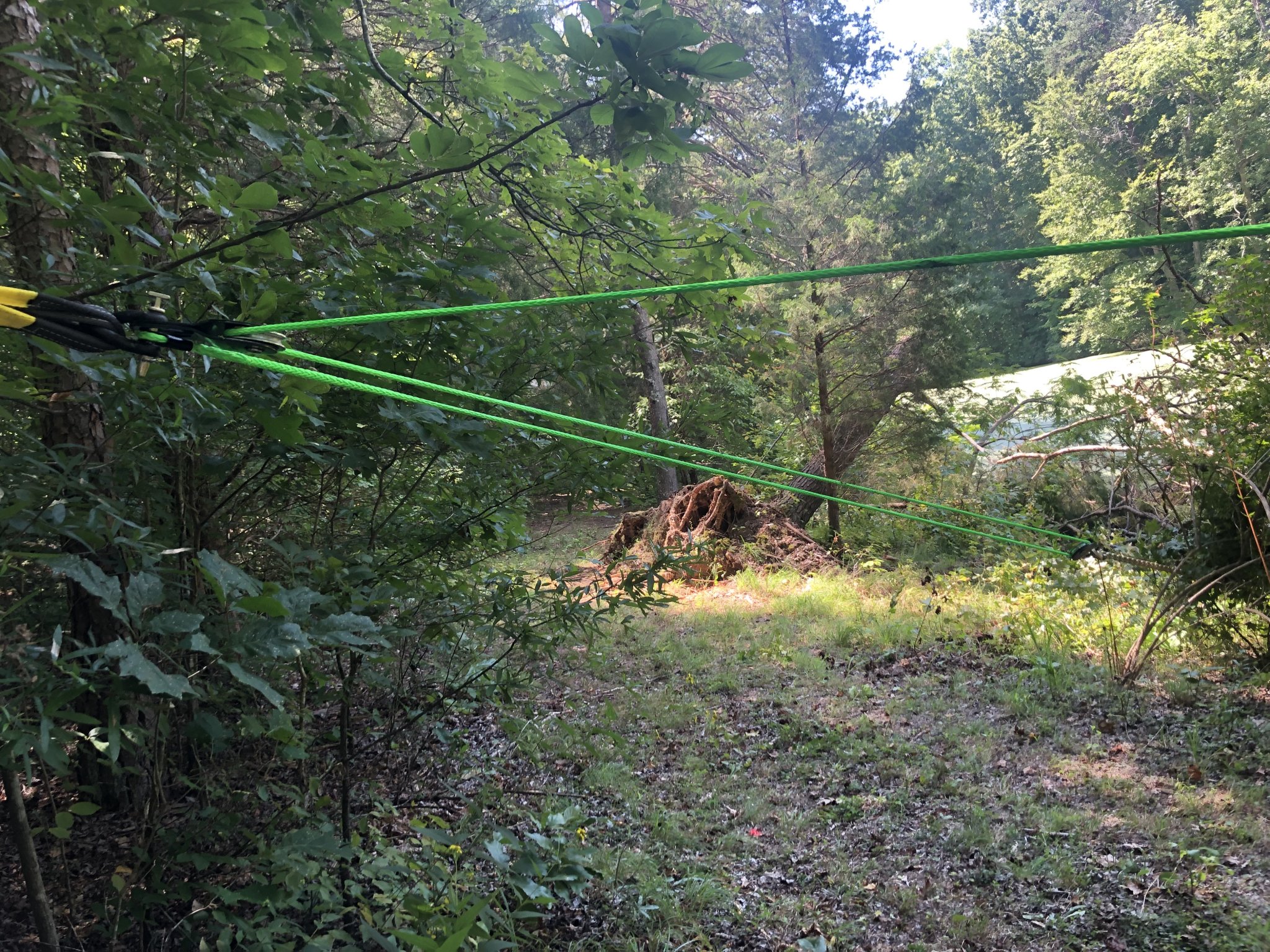

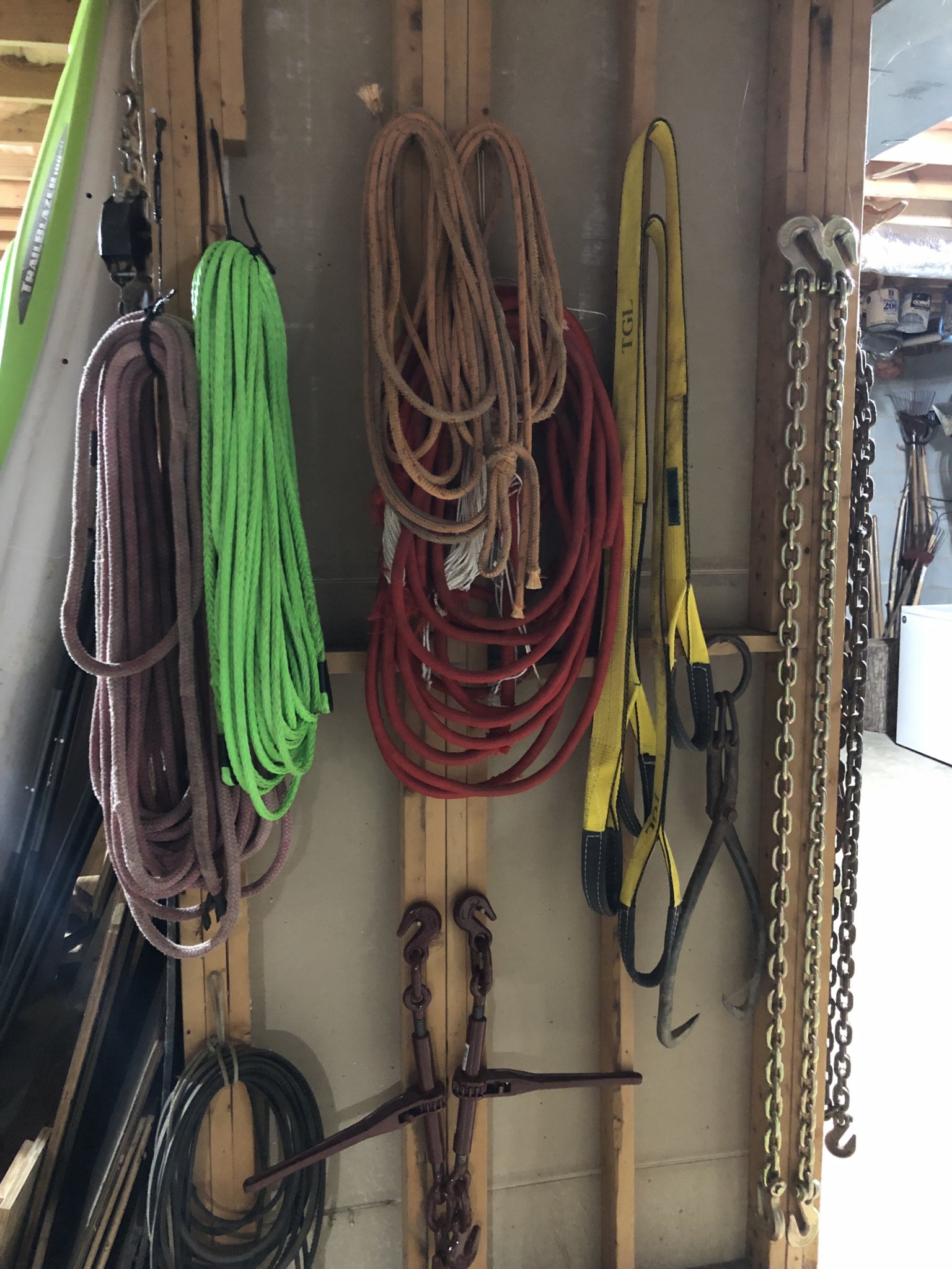

Sample of some of the rigging I’ve been using.

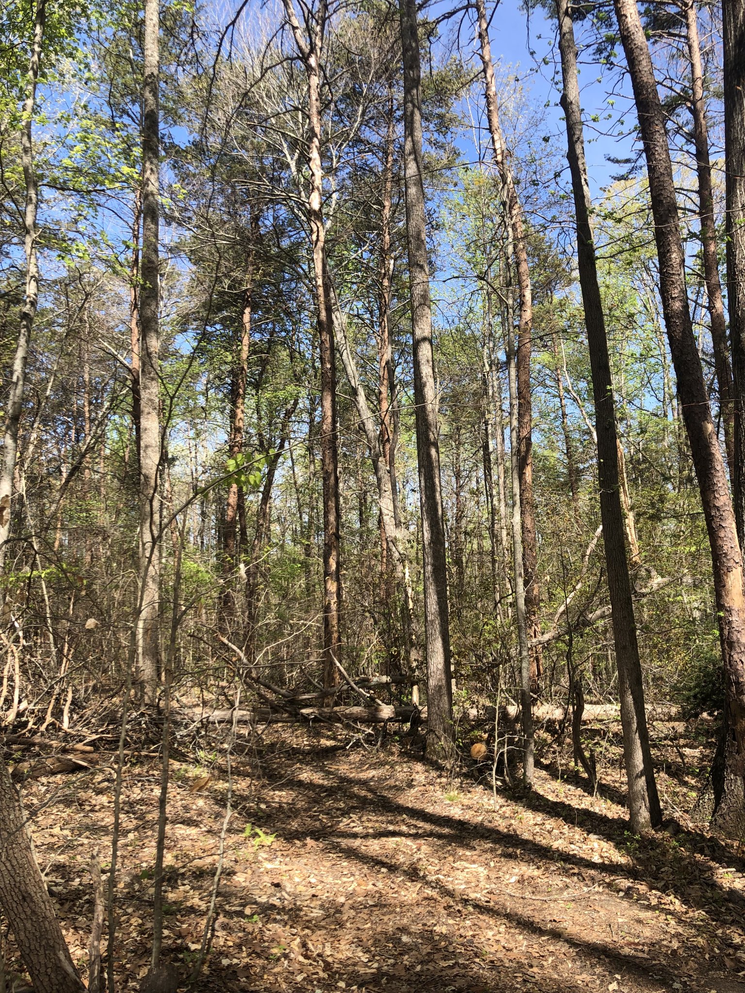

We have about 70 acres, most of which is forested. I have probably 20 acres that includes Virginia pines, like those pictures, interspersed with other trees. Problem with the Virginia pines is they live about 75 years, the place was logged off about 75 years ago, so they’re dying out and falling into these hanging pick up stick messes. My SOP for dealing with them is to keep everything well back from them, hook to the butt end, and pull them from the bottom until they hit the ground, then at least get them out of the trails and anywhere people might wander. That works great but the length of pull is limited by how far I can drive forward so sometimes it works great and sometimes it’s kind of a logistical problem unless I take out a bunch of healthy trees to create a driving lane, which I much prefer to not do. The above tangle resulted in rerouting one of the trails because there’s just no good way to get to the back side with the tractor or even a redirect with a snatch block. Yes, I’m aware of the dangers of dealing with a mess like that. Been doing it for years. Just looking for something more efficient.

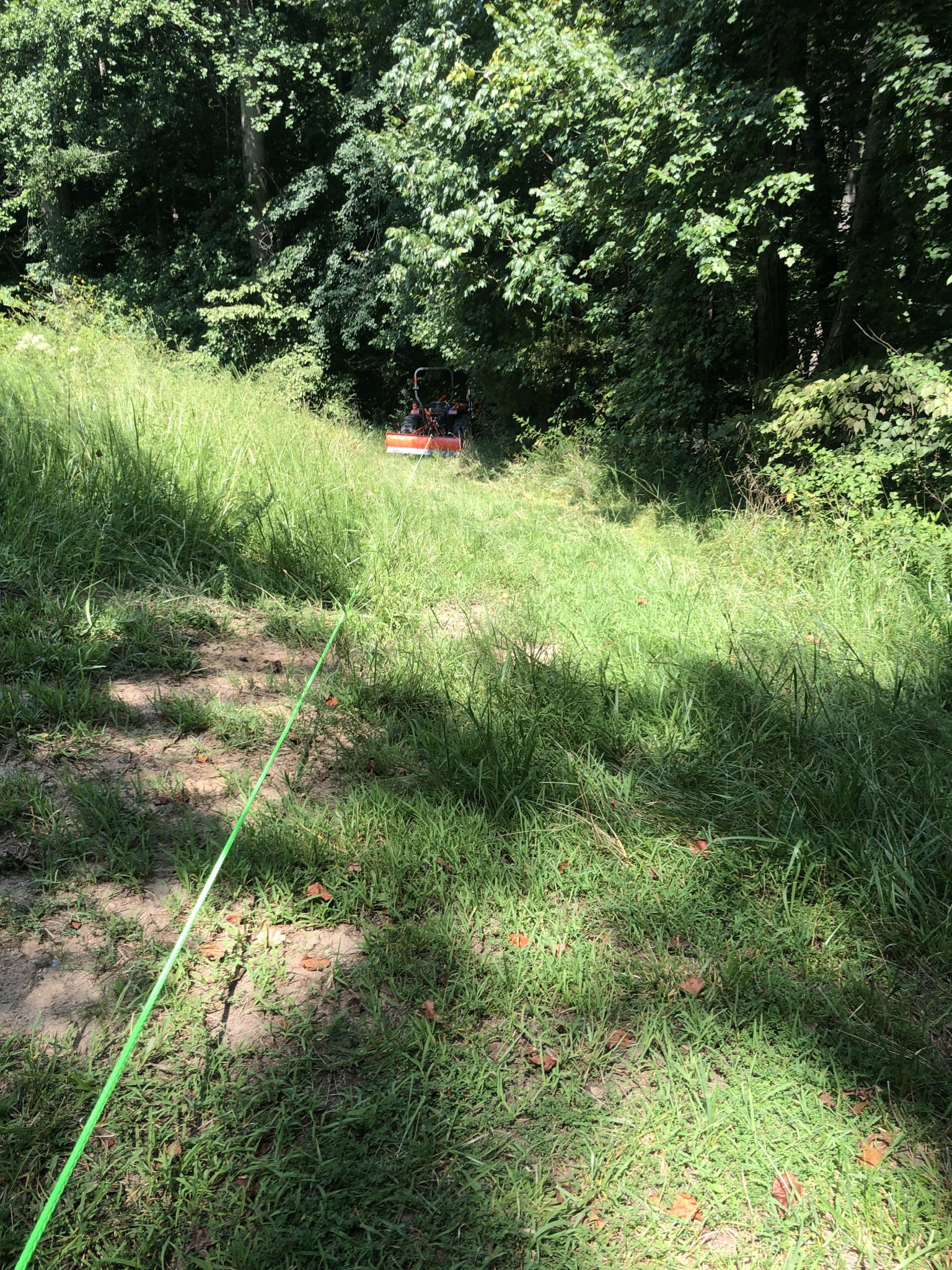

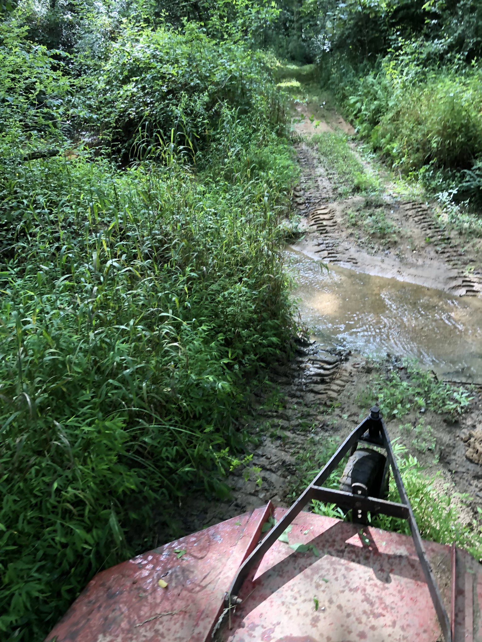

Another issue is skidding logs through the soft bottomed muddy creek cuts.
Final issue is we heat half of two houses with wood. We have plenty of wood, but it’s kind of wasteful when I have deadfall or storm felled trees that are perfectly good for firewood but they’re across a creek, down a slope a bulldozer couldn’t handle, or otherwise in unhandy places.
So I’m thinking a skidding winch might be worthwhile to address all three of the above problems, but I have no experience with 3 point winches. Plenty of experience with 4WD truck type winches and limited experience with cable skidders. I’m aware a L4701 isn’t a Timberjack and I don’t expect it to be.

From looking at your first picture, I see the need for forestry 'management'. Start close to home/barn and clear out 1/4 to 1/3rd of what's in that picture. You don't need a lot of trees to make a forest,but you do need healthy trees. Over 20 acres , it'd be a full time job for several years for a crew to just properly 'thin the forest'. Maybe consider a 50/50 deal with a 'firewood' service company as you heat with it. They make money, you get free heat. How many cord ( bush cord ) do you burn per year? If the trees can be milled into lumber, maybe a sawyer 'deal' can be made. You have to decide if it's just a 'weekend hobby' or if you want to 'work smarter, not harder'

Yes, there is forestry management needed, particularly in the areas where the Virginia pines are prevalent. Last year we entered a forestry management plan with the NC Forest Service so we do have a written plan proscribed by a professional forester. It’s a ten year plan with a variety of stuff to be done in various areas based on what is growing and going on in different areas as it’s not all homogenous.
So I have a choice when I retire at the end of the year. I could pay someone a stupid amount of money to do what needs to be done to comply with the plan (although of the three companies I have spoken to only one would even quote it due to difficulty of access and difficulty of terrain) or I can spend around 2 to 4 months doing it myself. I currently have most of the equipment to do it and I have the experience to do it. I don’t have a skidding winch, and I need one.
Edit: And admittedly I’m not a forester. Learned a lot dealing with a professional forester and I was quite impressed with the NC Forest Service spending many hours on our little plan for a very nominal price; likely not enough to cover their cost.

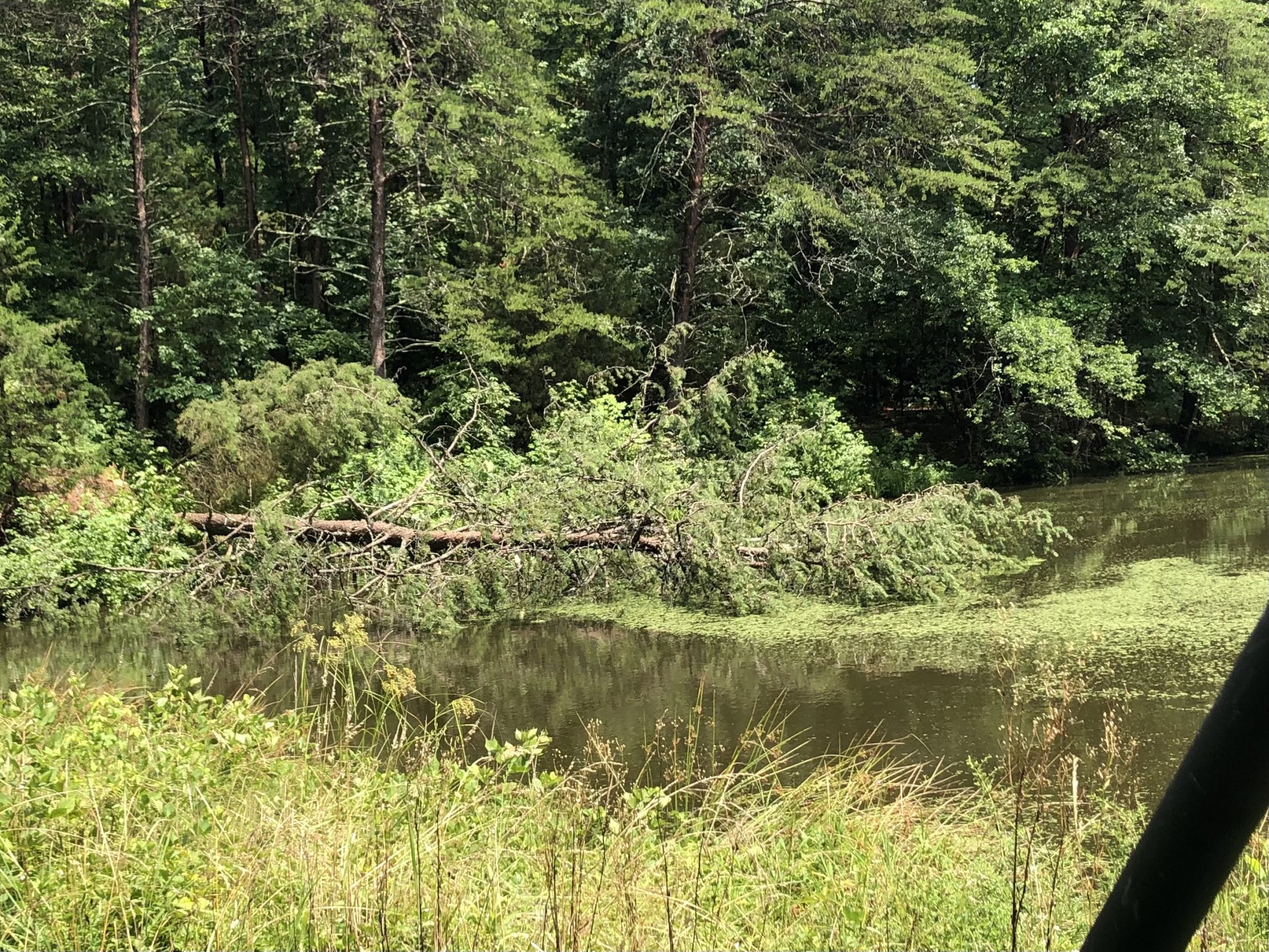

So can it be done without a skidding winch? I pulled this tree out of our pond without a skidding winch so maybe depending on where it is.

I also have a couple of these to cross to access 40 of the 70 acres.
That may not look all that bad but there isn’t a rock in sight anywhere in the two creeks and, as is common in pictures, it’s quite a bit steeper than it looks. The bottom is soupy sand on this one and soupy clay on the other. I was thinking with a skidding winch I could skid a log up to the crossing, release the winch clutch to drive the tractor across, then winch the log across after the tractor is back on solid ground. The Farmi W50R user manual even describes that process as a recommended use.

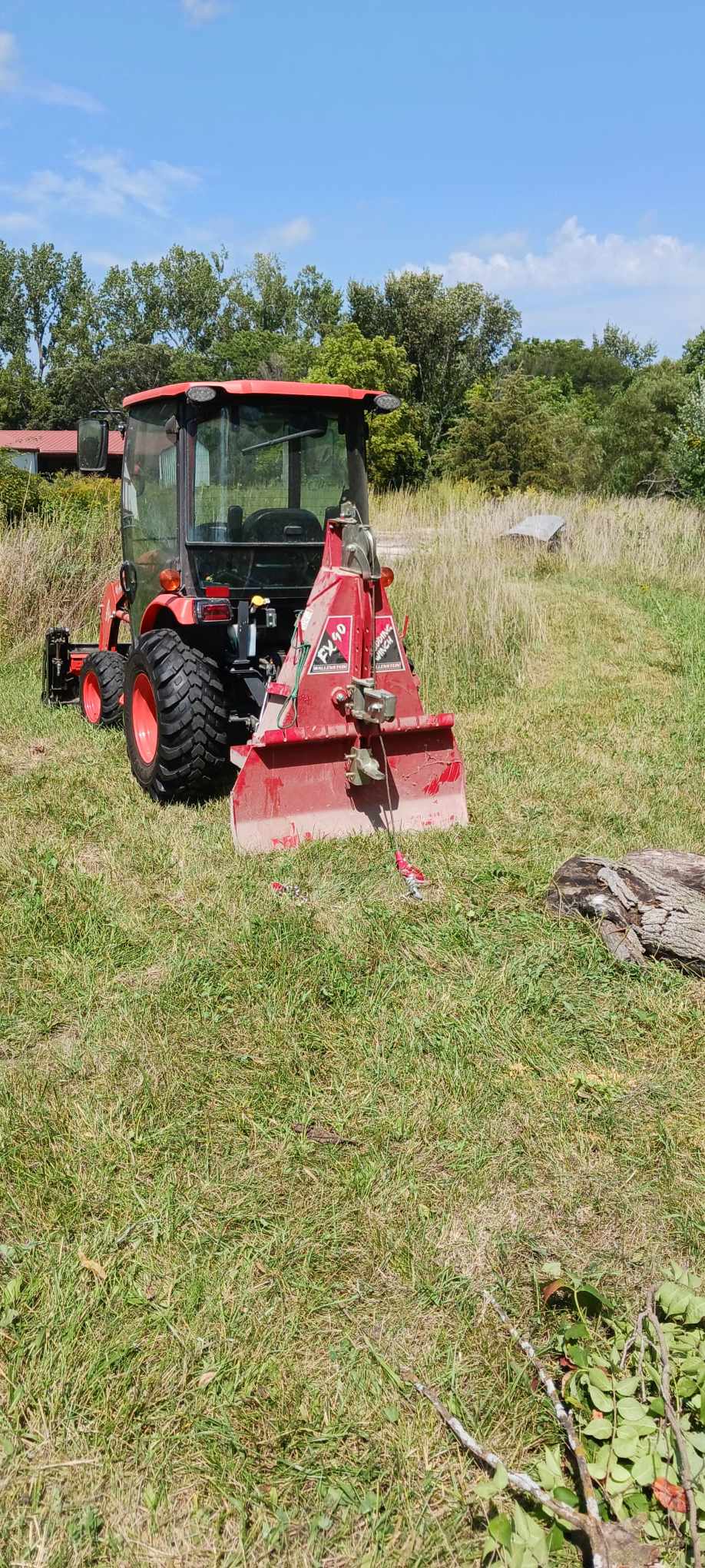

Wife and I went on a brief road trip today to pick up a Farmi W50R from the nearest XPO Logistics hub. Mike with Northeast Implement (https://northeastimplement.com/) was very helpful. Provided detailed dimensions on the 50R and 35R (50R was clearly a better fit). Provided a quote that was substantially less than the Wallenstein FX85.
Didn’t have time to do anything past getting it off my truck and into a shop bay. Supposed to rain the next several days so should be a good opportunity to get it set up and make some sort of storage dolly for it.
