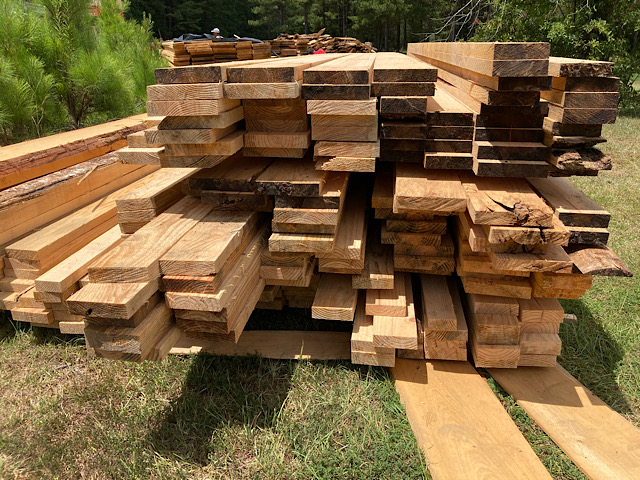

I have been using 2-3 oz of liquid Cascade (light green jug) per gallon of water for 20 years. It does not make suds so it's easily mixed. I have sawed well over 2 million bf using Cascade.
2412 bf of Southern Yellow Pine framing lumber sawed yesterday morning.
